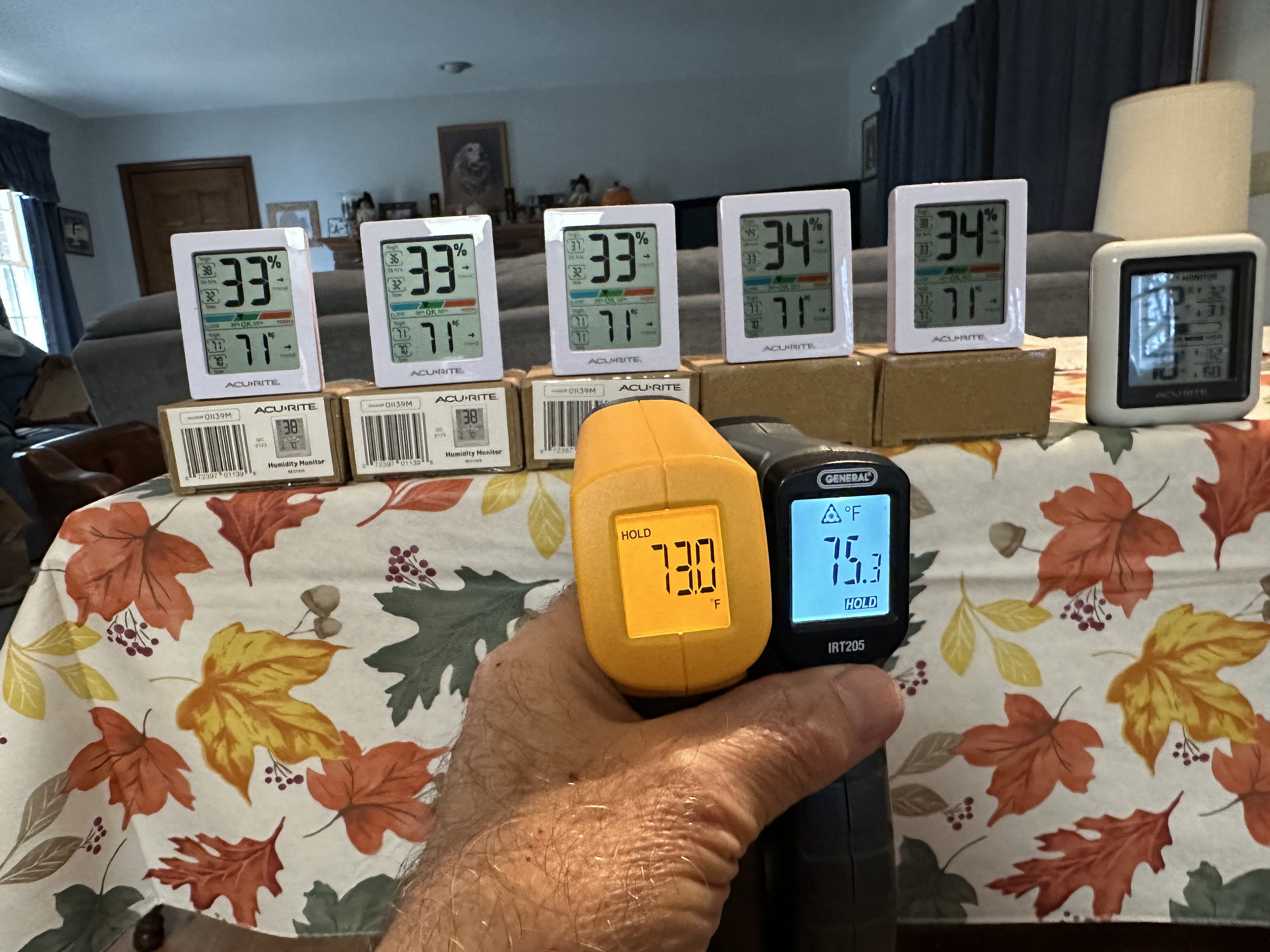

    Because of a similar imbalance situation, I installed a GoveeLife Smart Thermo-Hygrometers in each of my 4 apartment living rooms, plus the basement. You can buy additional sensors. The set shown is very affordable.
    I have it set up so I can monitor all the sensors on my phone. I haven't bothered to set it up on a computer, but I am sure it is possible. These sensors are a newer style with larger batteries for longer life between changes. Don't get the older smaller ones.
