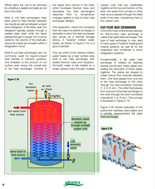

    hot_rod Posts: 28,585
    An indirect WH tank is basically a tube and shell, or AKA shell and coil, heat exchanger. To get efficient, or quick recovery requires a lot of surface area exposed to the transfer fluid. Also having two moving flows greatly increases the heat transfer. That is why flat plat HX are generally 5 times better heat transfer. Lots of surface and two counterflow fluid streams. Everything you want to know about HXers here, and plenty of math to make your eyes water.
    https://www.caleffi.com/sites/default/files/media/external-file/Idronics_29_NA_Heat%20exchangers%20in%20hydronic%20and%20plumbing%20systems.pdf

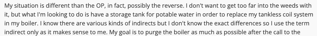

    Pardon me if I muddy the water of the OP question, but I think the original discussion is fairly over/wrapped up.
    My situation is different than the OP, in fact, possibly the reverse. I don't want to get too far into the weeds with it, but what I'm looking to do is have a storage tank for potable water in order to replace my tankless coil system in my boiler. I know there are various kinds of indirects but I don't know the exact differences so I use the term indirect only as it makes sense to me. My goal is to purge the boiler as much as possible after the call to the indirect, and store all that hot water in a better insulated place than my boiler, and not get a low limit call just because someone decides to wash the dishes on a summer day and have the whole system fire up for a few degrees.

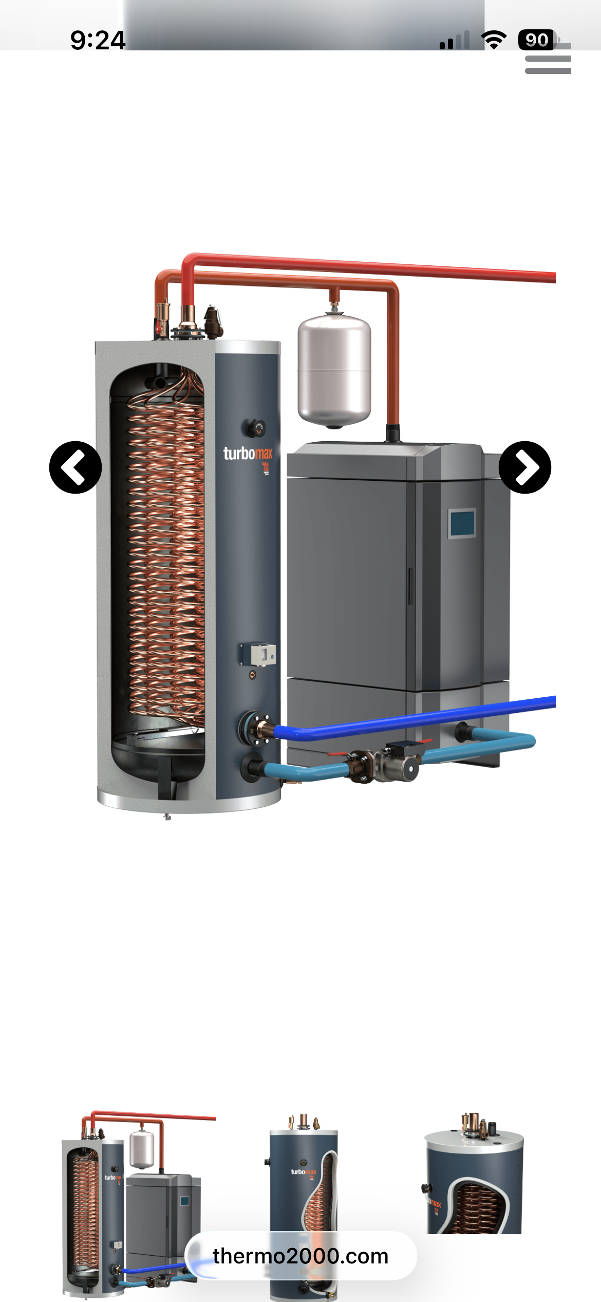

    Is the OP trying to eliminate the tankless coil completely (a wise move) and use an indirect?

    Yes in this post Roger explains it quite well, although I don't recall any links but I need to look at his previous replies to my posts. I think I have all the info, (maybe twice now) 😞 guess I'm getting old and forgetful!

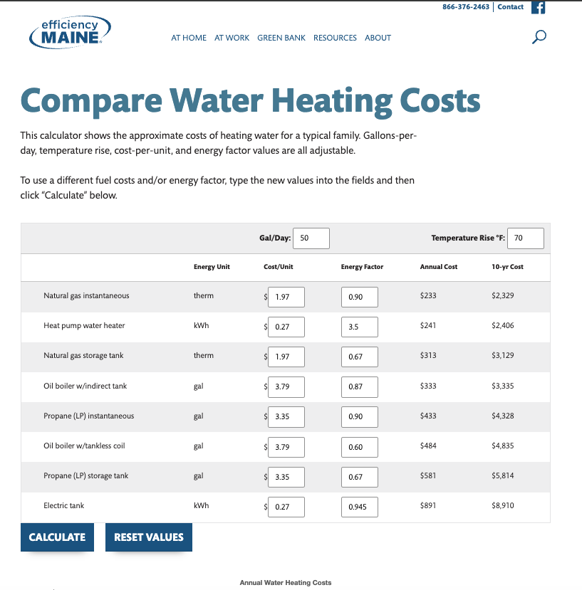

    Too many variables to quote a number for resistance DHW cost per year.
    How many gallons, temperature rise, Kwh cost.
    This calculator can tighten the numbers. Try it with a 80° rise which would be accurate in cold climates where water is stored above ground.
    https://www.efficiencymaine.com/at-home/water-heating-cost-comparison/?
    50 gallons at .27 Kwh is closer to 900 bucks a year
    But look at the HPWH annual cost!
    ethicalpaul Posts: 9,046
    edited March 16
    I was going by Energy Star (my recollection of which admittedly might be a little out of date).
    Your .27 is pretty much the highest rate in the US (except for Hawaii) so you are showing basically the worst case scenario.
    And I agree with you that heat pump water heating is the absolute champion.

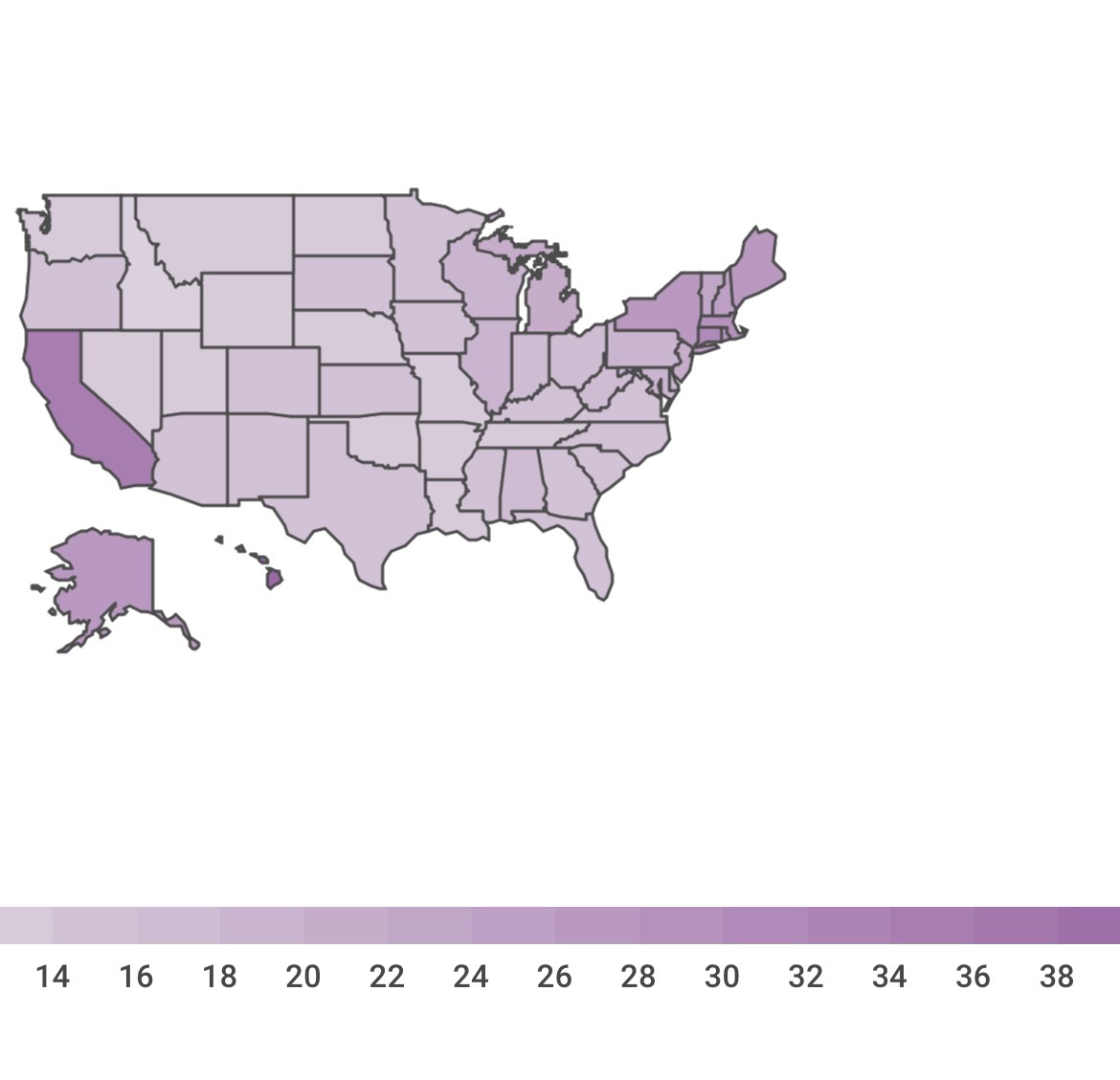

    the average costs in the US is .17. More and more areas hitting the high .30’I think @Jamie Hall pays in the mid .30’s?
    AI and crypto farms will continue to drive electricity costs up.

    My goal would be to purge it down to about 155 after a call from the indirect. I do this in my baseboard zone with great success all winter.
