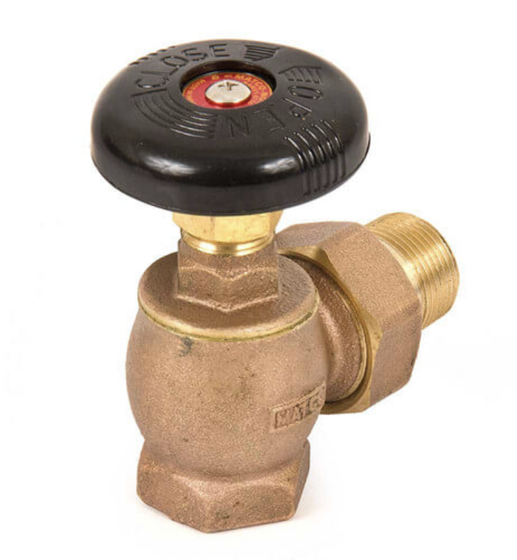

    Radiator Valve: This is an actual valve with a handle that you turn to open and close. It is installed on the steam pipe that just at the entrance to the radiator. On a one pipe system, it must be either fully open or fully closed. There is no throttling of the valve at some midpoint in order to reduce the steam to a lesser amount that full open. Doing that will often block the returning condensation from the radiator to the piping system.

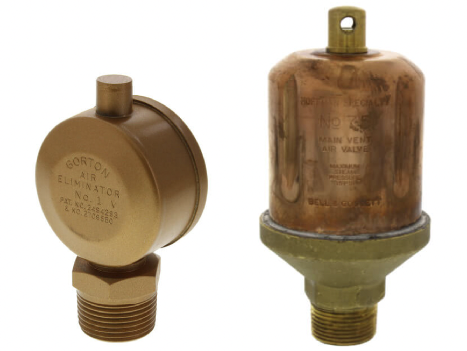

    Radiator Vent. Here are two typical radiator vents one is adjustable and the other is a fixed orifice. the idea of this part is to allow air to leave the radiator so steam can enter the radiator. Where there is air there is no steam, so removing the air is an important factor in getting the radiator hot. once the steam is in the radiator, the vent should close as a result of the high steam temperature.

    Main Vent. These vents are located at the end of a main steam pipe after all the branches to the radiators. The idea of this vent is to remove all the air in the steam main out so the radiators can all get steam from the main at the same time. In some larger systems you may find more than one of these vents on a tee fitting at the end of the steam main, just before it turns down to the condensation return piping
