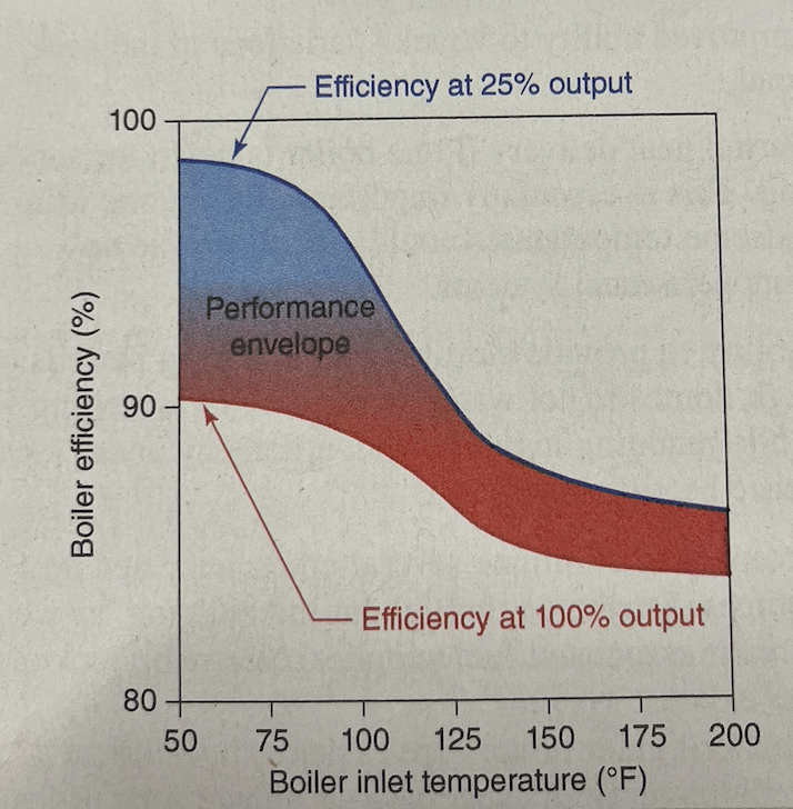

    hot_rod Posts: 28,704
    that boiler can be limited to any btu output between 15,000- 150,000 so it would not be oversized even if the load is more like 50,000
    The modulation us good to have with a zoned system
    You will need two temperatures, high 140-160 perhaps for the fan coil, maybe as liw as 100 for the radiant
    If you can get a great deal on it I would buy it. While it is oversized it does actually run a few % higher efficiency when locked down to a lower firing rate.
    See this graph to explain how 25% firing increases efficiency. At any supply temperature actually.
    You expose a larger surface area to a smaller flame, so more surface area.
