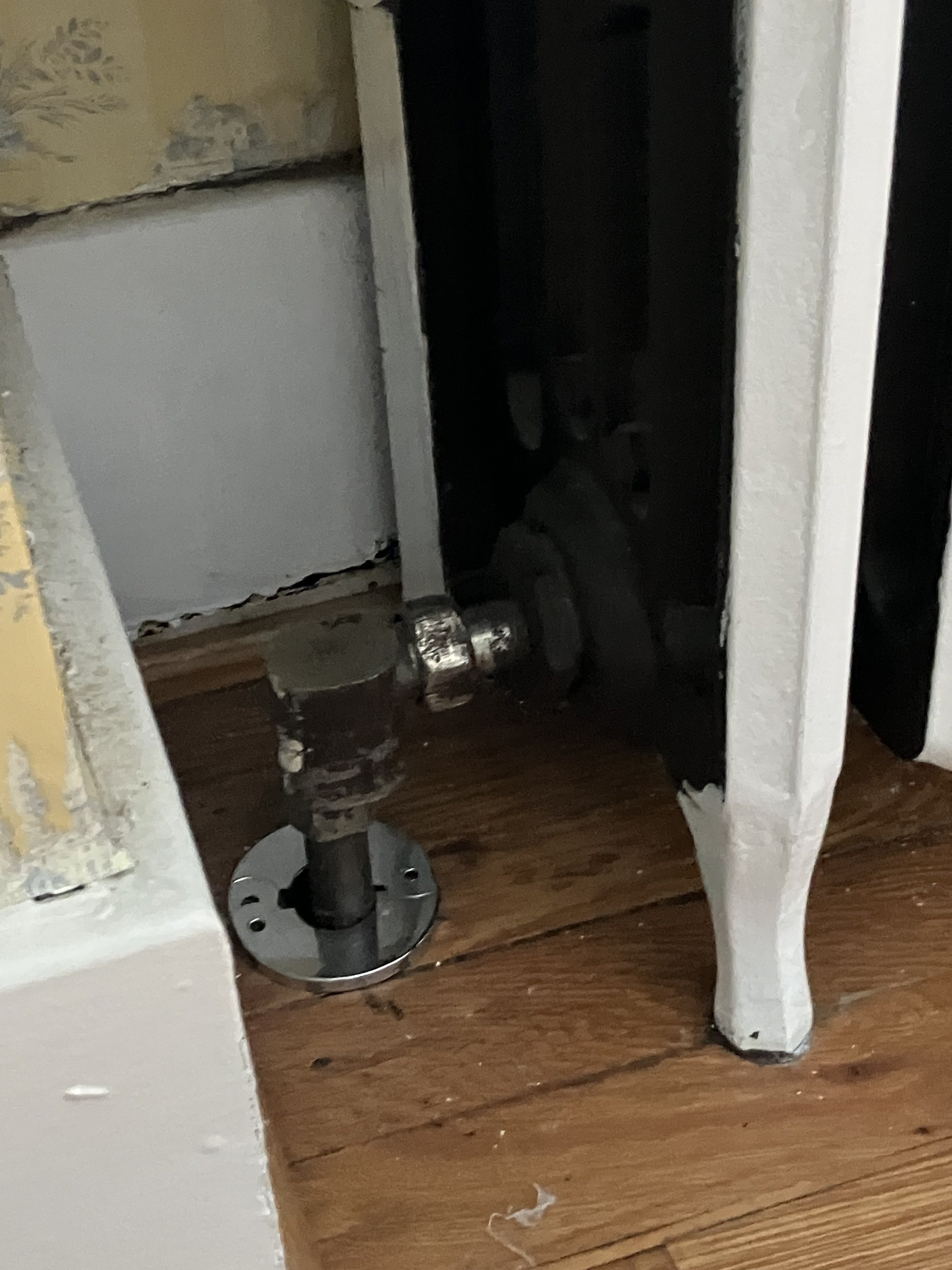

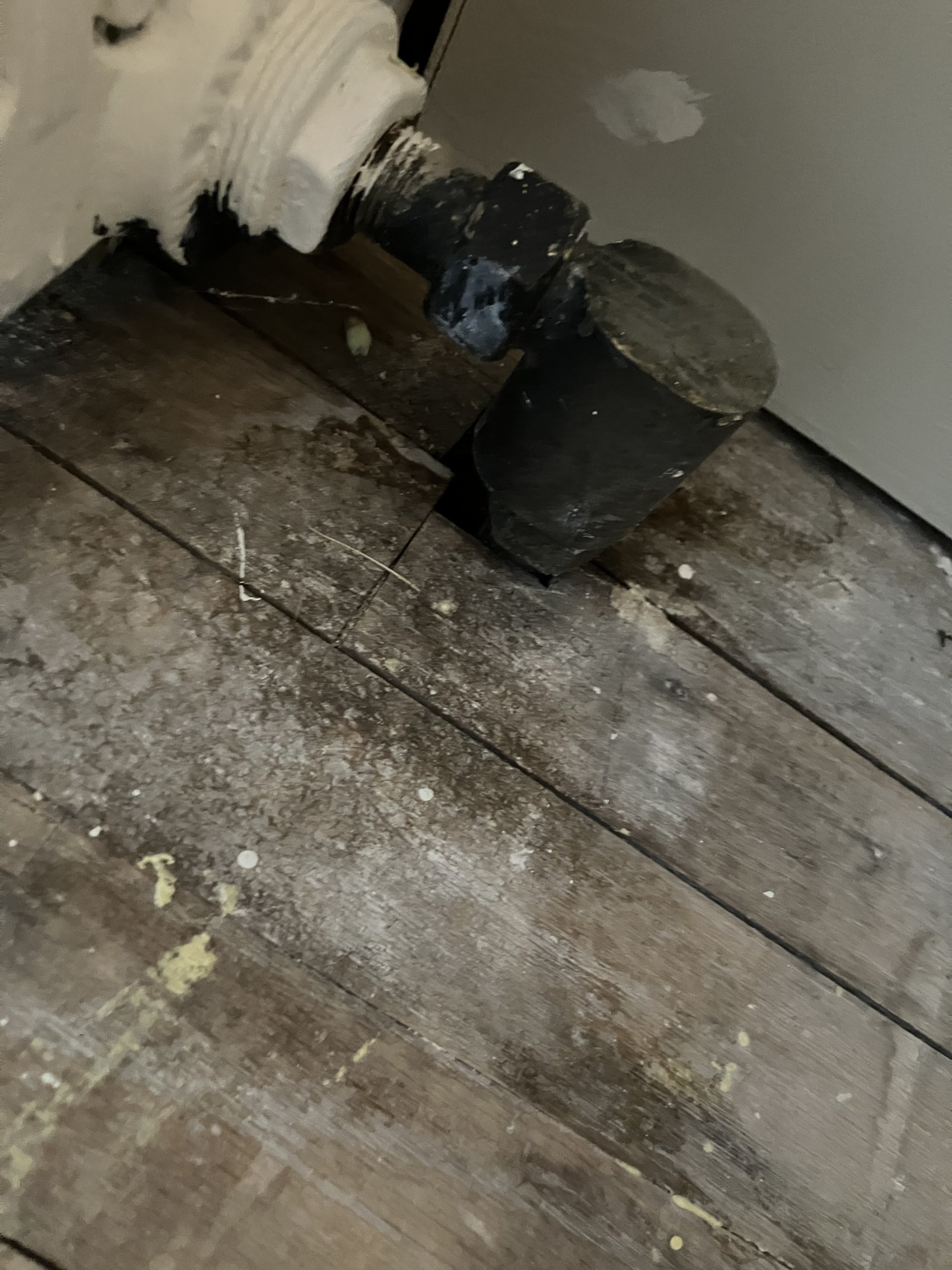

Is this a Steam Trap?
    A little hard to tell…
    mattmia2DaironHvacTech
    pecmsg Posts: 7,634
    Definite
    Possibility
    of a
    Maybe
    Yes — but I honestly don't know the make and model. Any markings on it?
    what does the supply valve look like? i bet it is some sort of water seal or ball type seal for a vapor system.
    109A_5 Posts: 4,759
    According to the video it is not a trap, but a water seal.
    Certainly not a thermostatic steam trap.
    Mouat water seal movie
    https://youtu.be/8KisKrAaywQ
    that makes sense
    oh that is @gerry gill 's video?

    neilc Posts: 3,213
    ultra low pressure, correct?
