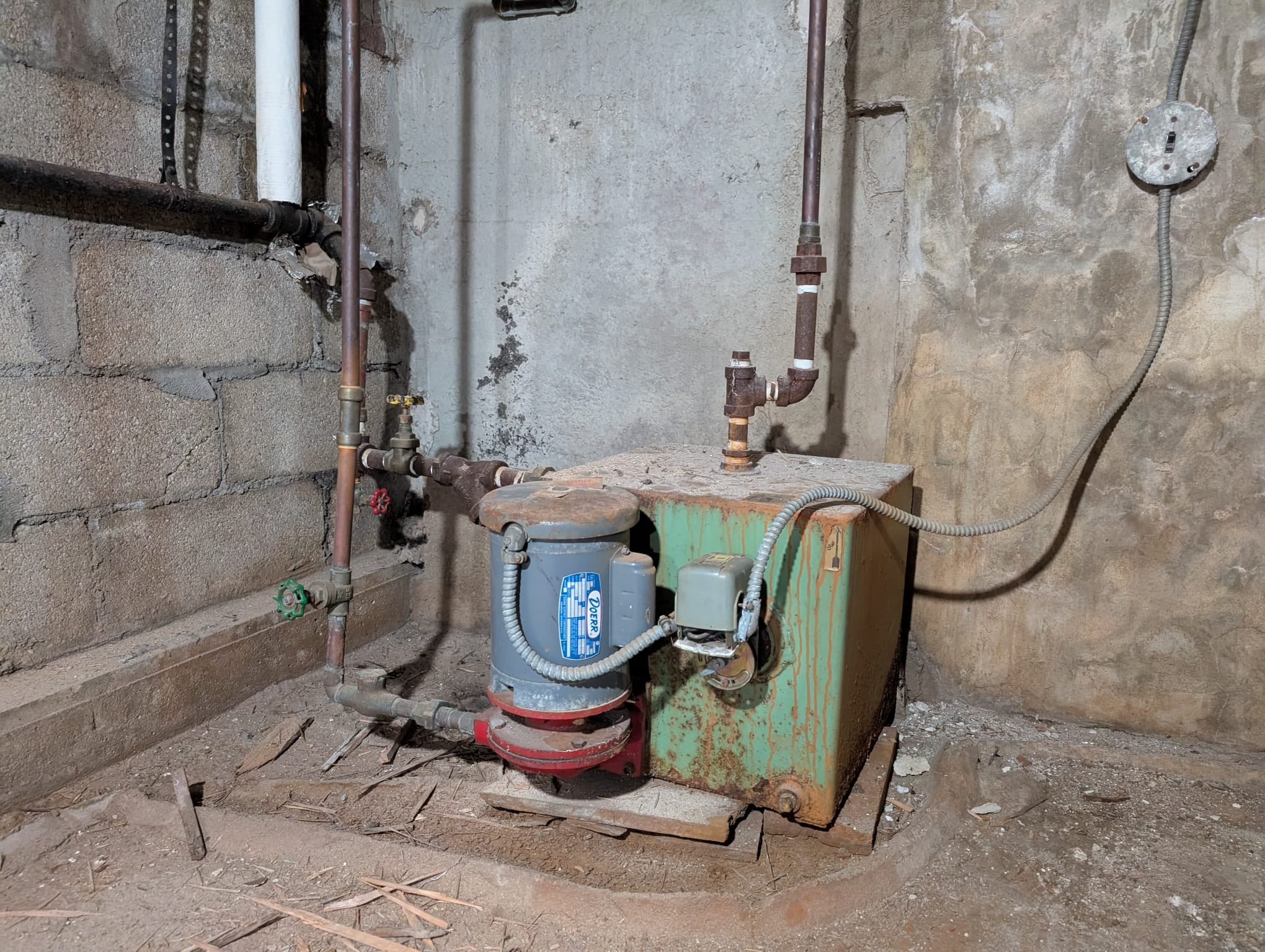

I’m a new homeowner and still learning how my steam heating system works. I recently started running into some issues with my steam boiler, and I wanted to explain the problem step by step to get advice and feedback.
How my system is supposed to work
My home has a steam boiler with a condensate return system. When the boiler runs, it produces steam that travels through the pipes to heat the radiators. As the steam gives off heat, it turns back into water (condensate). This condensate flows into a condensate tank.
Inside the condensate tank there is a float switch. When the water level in the tank rises to a certain point (I’m not exactly sure what level), the float switch turns on the condensate pump. The pump then pushes the collected water back into the boiler so it can be reused.
What actually happens during a heating cycle
When the boiler starts and the heating cycle is running, steam leaves the boiler and the water level inside the boiler naturally drops. This seems normal at first because some of the water is out in the system as steam and condensate.
However, before the condensate has time to fully return to the tank and get pumped back, the boiler water level drops too low. At that point, the Low Water Cut Off (LWCO) detects a low-water condition.
Once the LWCO senses low water, it shuts off the boiler for safety. The boiler stays off for a few minutes while it waits for water to return. During this waiting period, the thermostat is still calling for heat, but the boiler cannot run because the LWCO has stopped it.
If the condensate return is delayed, the LWCO then signals the automatic water feeder to add fresh water to the boiler. This happens even though condensate is still on its way back from the system.
As a result, the boiler ends up with too much water. This causes water to be carried into the steam piping, leading to loud water hammer noises and water spitting from radiator air vents.
Turning off the auto feeder
To stop the hammering and vent spitting, I turned off the automatic water feeder. Doing this immediately reduced the water hammer and improved system noise, which confirmed that overfilling was a major part of the problem.
New problem: long boiler shutdowns and lack of heat
However, with the auto feeder turned off, a new issue appeared. When the LWCO detects low water, it shuts the boiler down and keeps it off until enough condensate returns naturally. In some cases, I’ve observed the boiler staying shut off for a very long time sometimes more than an hour even though the thermostat is still calling for heat.
During these long shutdowns, the system does not produce enough steam, and the house does not heat properly.
The main problem seems to be timing and coordination. The condensate pump, LWCO, and auto feeder are all working individually, but they are not coordinated properly. Condensate takes time to return, but the LWCO and auto feeder react faster, which leads to overfilling and water hammer.
I’m trying to understand whether this is a control issue, a design issue, or something that can be corrected with better settings or updated components.

    It sounds like the condensate is having trouble getting back to the pump. Have you checked the wye-strainer on the inlet side of the pump housing?

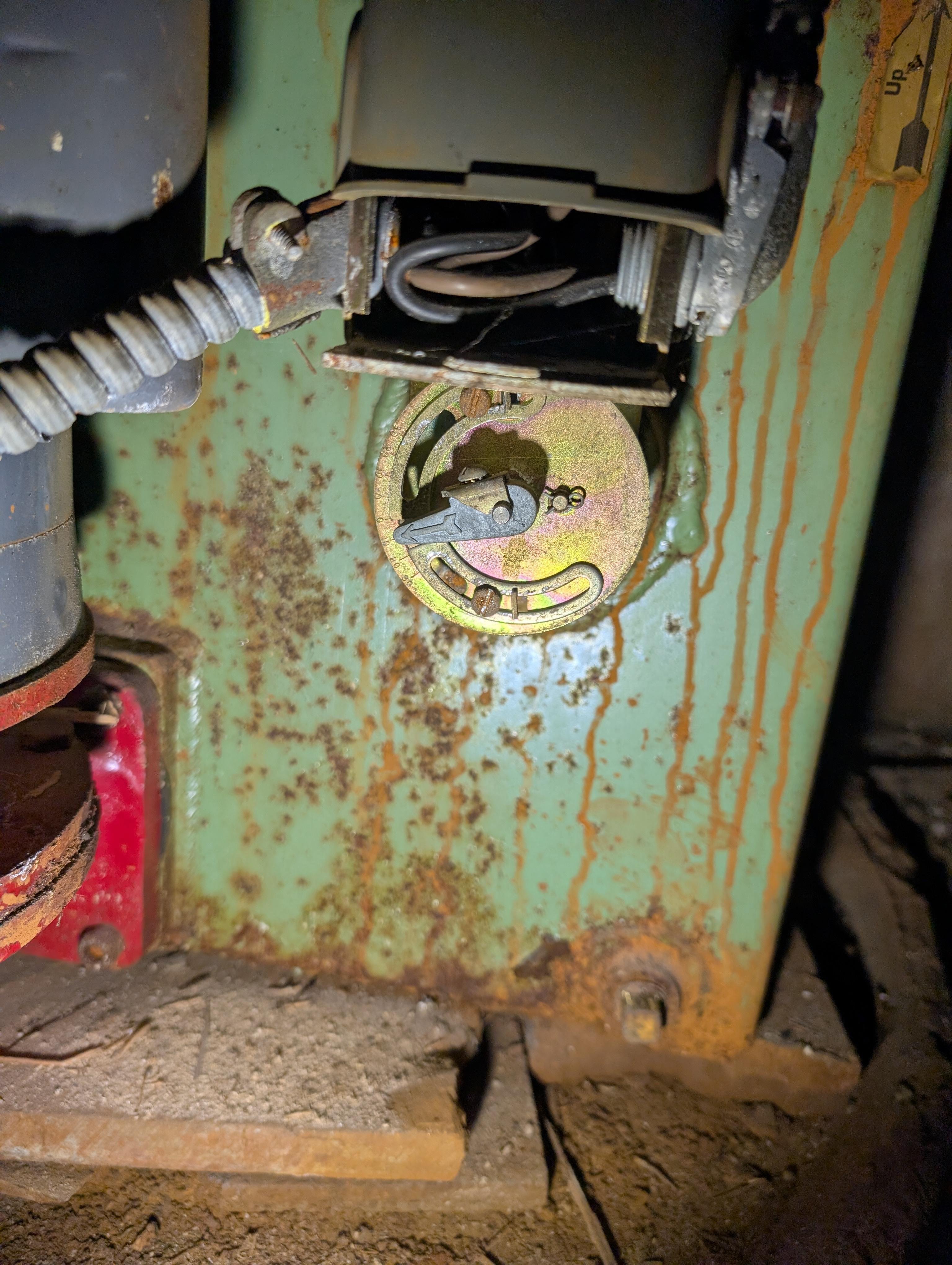

    Is there any sight glass on that condensate tank to verify that it is full to nearly the point where the float switch should activate the pump? At that point even the slightest amount of condensate from the radiators should trip it.
    What happens when you jumper out the float switch? Does the condensate pump get power and pump condensate into the boiler? How much does it add in height on the boiler sight glass before shutting off?
    Jamie Hall Member Posts: 27,237
    Condensate receiver tanks are OK, I guess, if your system really needs them. However condensate return pump arrangements are, in my humble opinion, a contrivance of the devil.
    Is there any way , as @Captain Who asked, to check the level of the condensate in that tank when the condensate pump turns on? It should be at least two thirds full, maybe more.
    Second, is there a check valve on the outlet from the condensate return pump and is it working?
    Third, is the float switch in the condensate tank working reliably? The float is free?
    The fundamental problem is, most likely, slow returns — if they can be flushed out in some way it may help. However, the real problem is the whole condensate return pump thing. It's just wrong — though common.
    Fortunately, if you have a good technician, there is a work around, and it may even be "no parts required". What needs to happen is to rewire the system so that when the low water cutoff asks for water(which it should do at a slightly higher level than shutting off the boiler) it turns on the condensate return pump, not the automatic water feeder. Then rewire the float (you may need a relay here) in the condensate receiver to the automatic water feeder so that it turns on the water feeder when the water in the receiver is low. Now reroute the pipe from the water feeder so it goes into the condensate receiver, not the boiler.
    This simple modification will eliminate the problem of overfilling the boiler.
    Fundamentally this rewiring is rather simple, but needs to be done carefully and thoughtfully. Depending on the voltages of the LWCO and the feeder, you may need a relay in there. A good technician will know.
    Now however… with the slow return problem, it will probably overfill the condensate receiver. You will need to provide an overflow from the receiver to a floor drain. This overflow must be below the boiler water line elevation!
    Fixing the slow return problem should eliminate the overflow problem, but in the meantime the boiler will operate as it should and give you the heat you need.

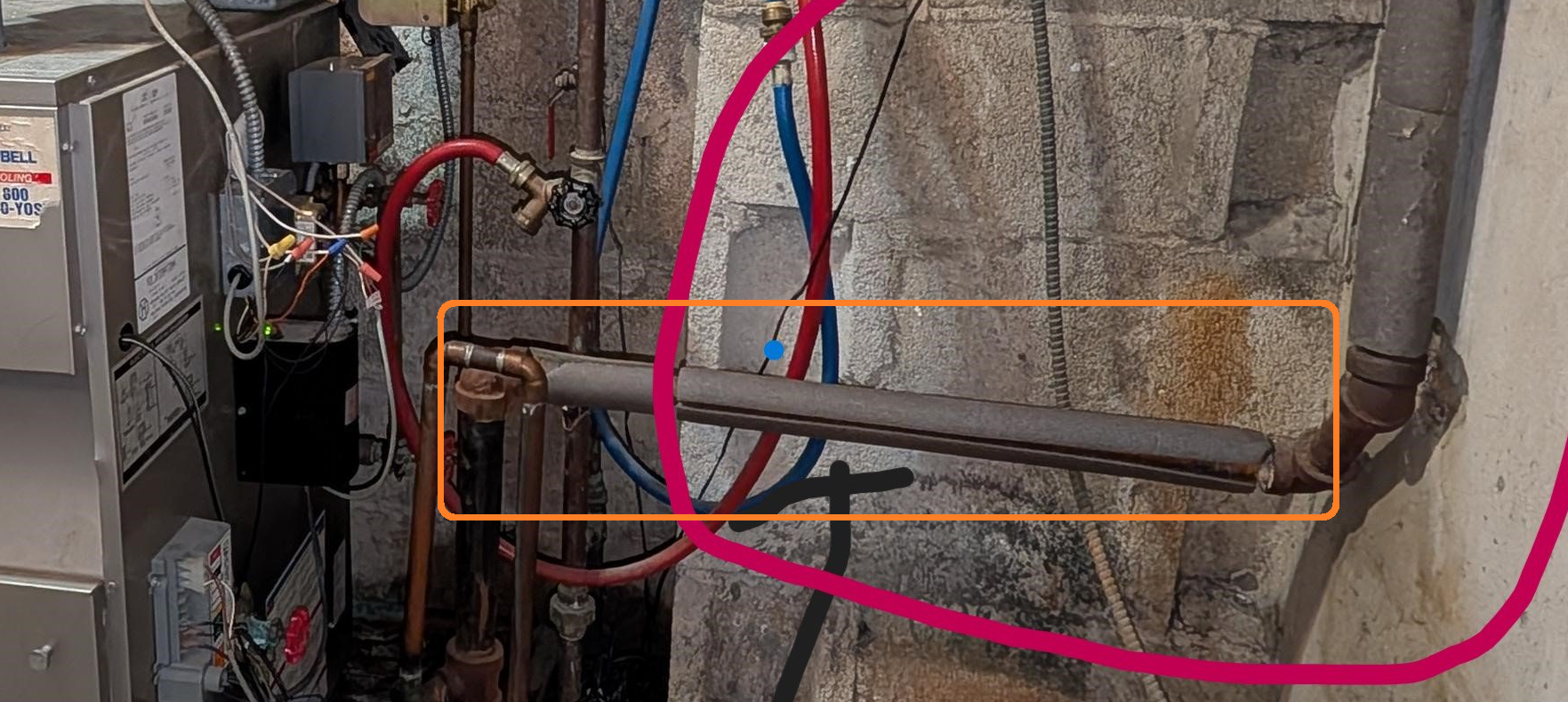

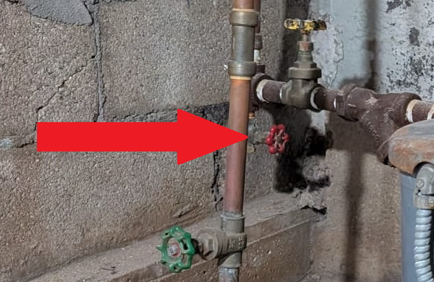

    I would check that wye strainer and the gate valve for the inlet to the pump tank.
    Also it looks like there is a drain down valve on the return line before the strainer.
    That should be checked for free flow.

    The cond pump may have been added to try to correct the problem of slow cond water return.
    The return looks high enough to be gravity return without a pump.
    The pump tank makes more water available for the system but the return is still too slow for even that.

    @4GenPlumber Yes I checked wye strainer and it's working fine. Water comes back to tank fine.

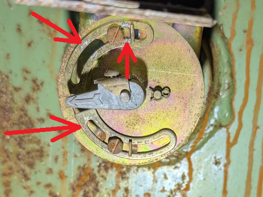

    @Captain Who there is no sight glass on the tank. But when pump pushes water once it's full It goes all the way up.
    Typically in that level lwco shut off the boiler,which is strange. In most boiler I see this is enough water to operate.
    And when pump pushes the water often its above blue cycle in the below picture

    @JUGHNE I checked wye strainer and did some cleaning. Also checked both red and yellow velve. Red velve is just for draining out the water that's my understanding.

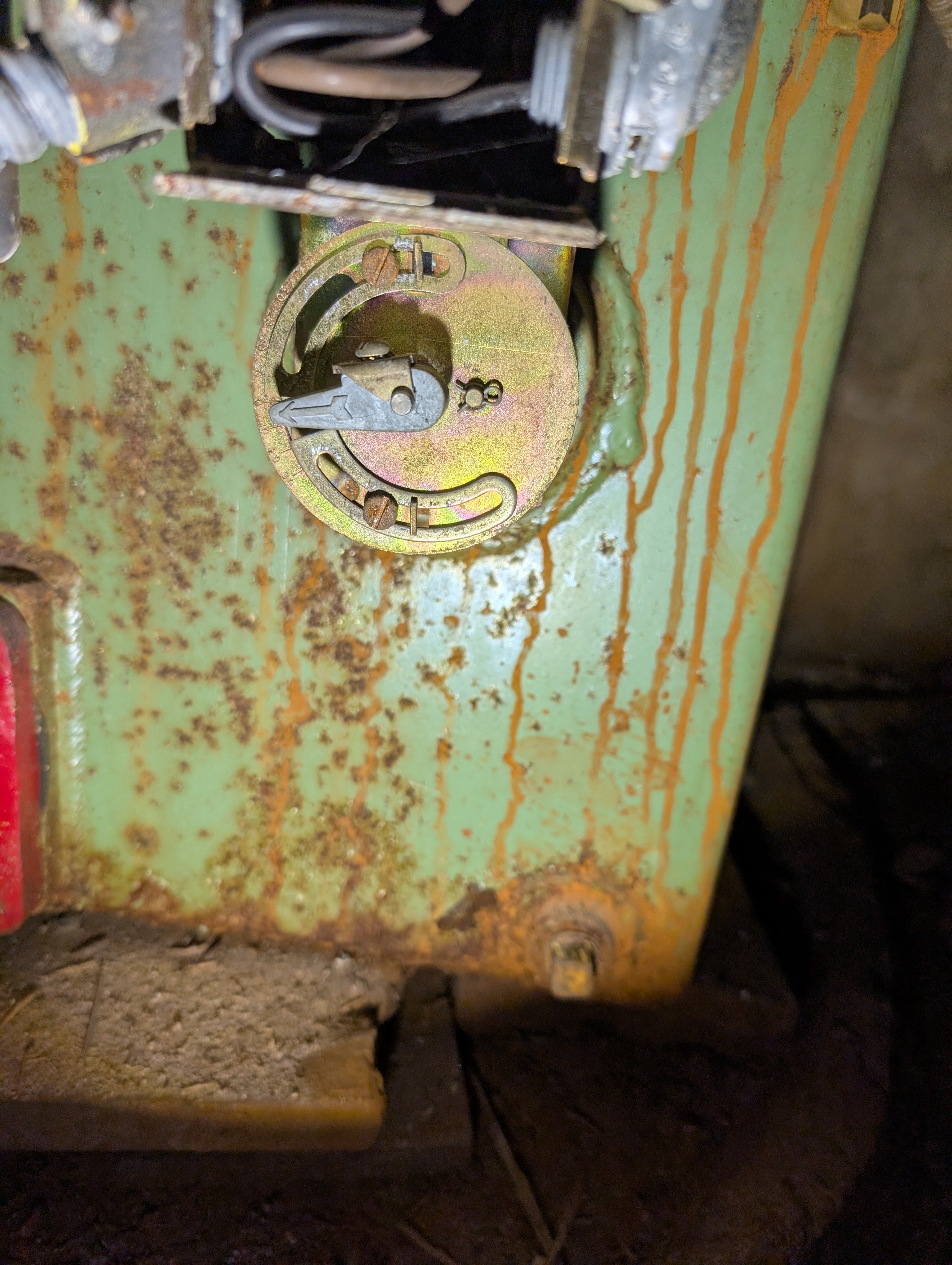

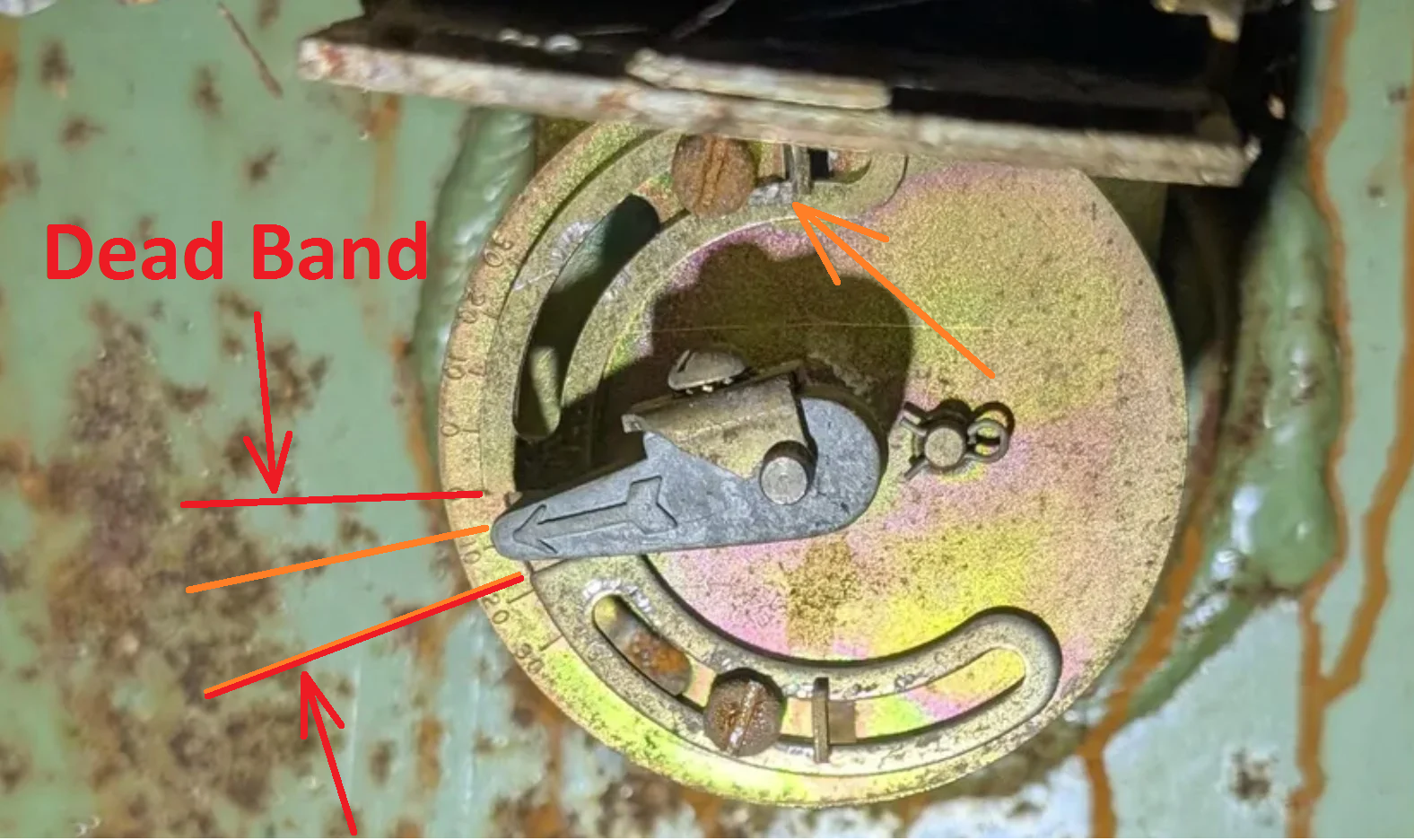

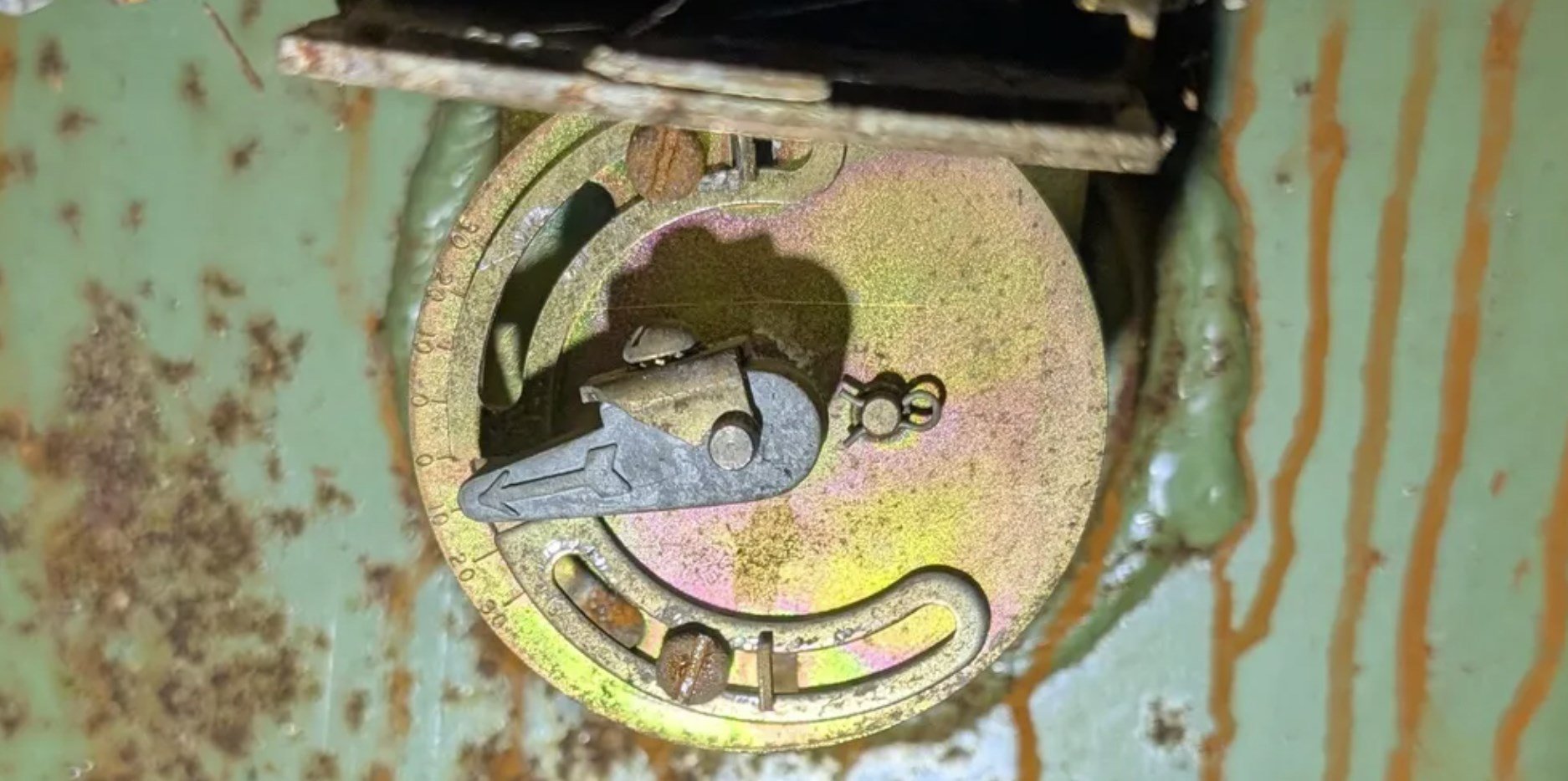

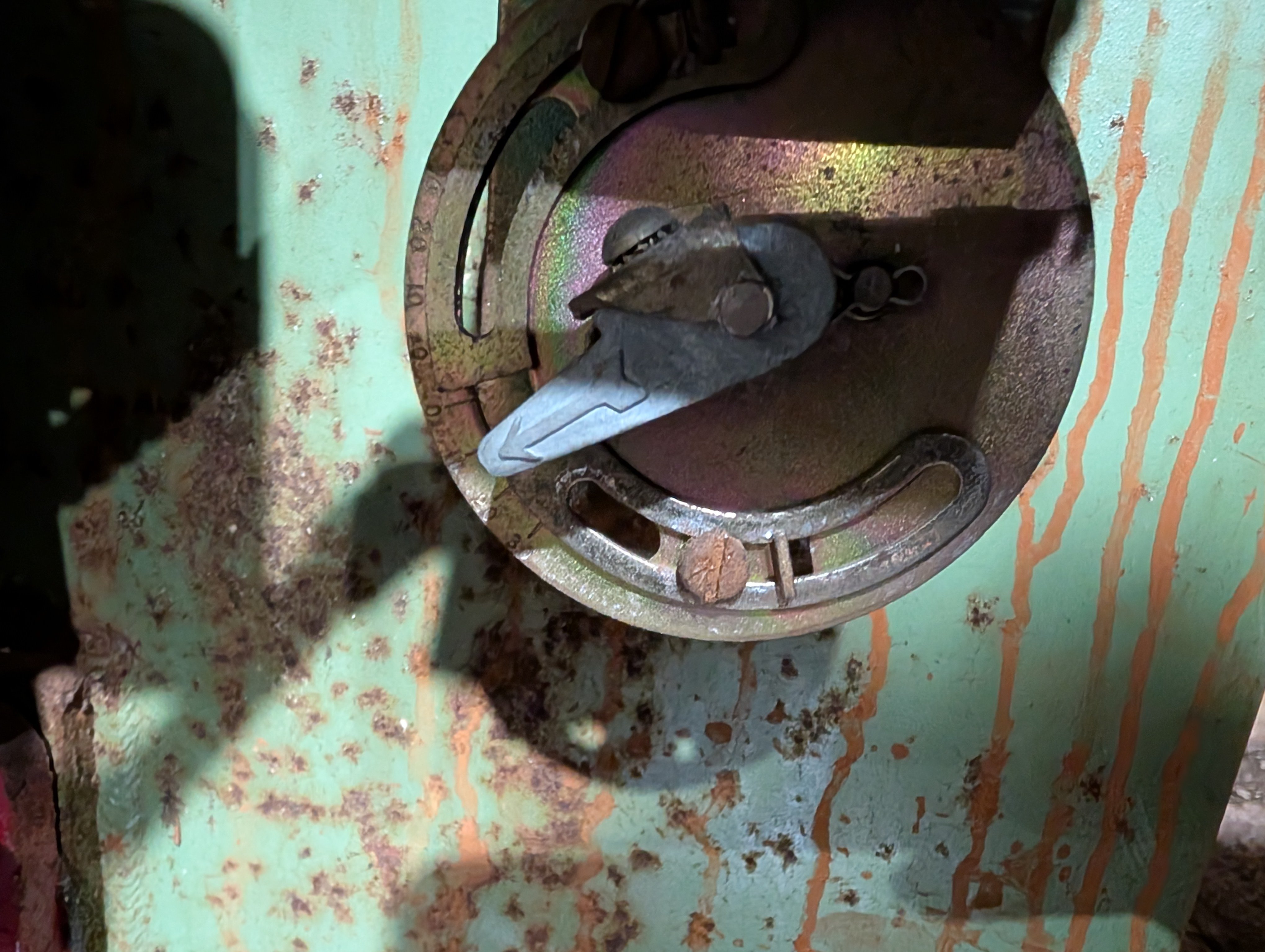

    Have you played around with the adjustment of this? What is the position of the arrow when 1) the condensate pump starts pumping, and 2) when it finishes pumping

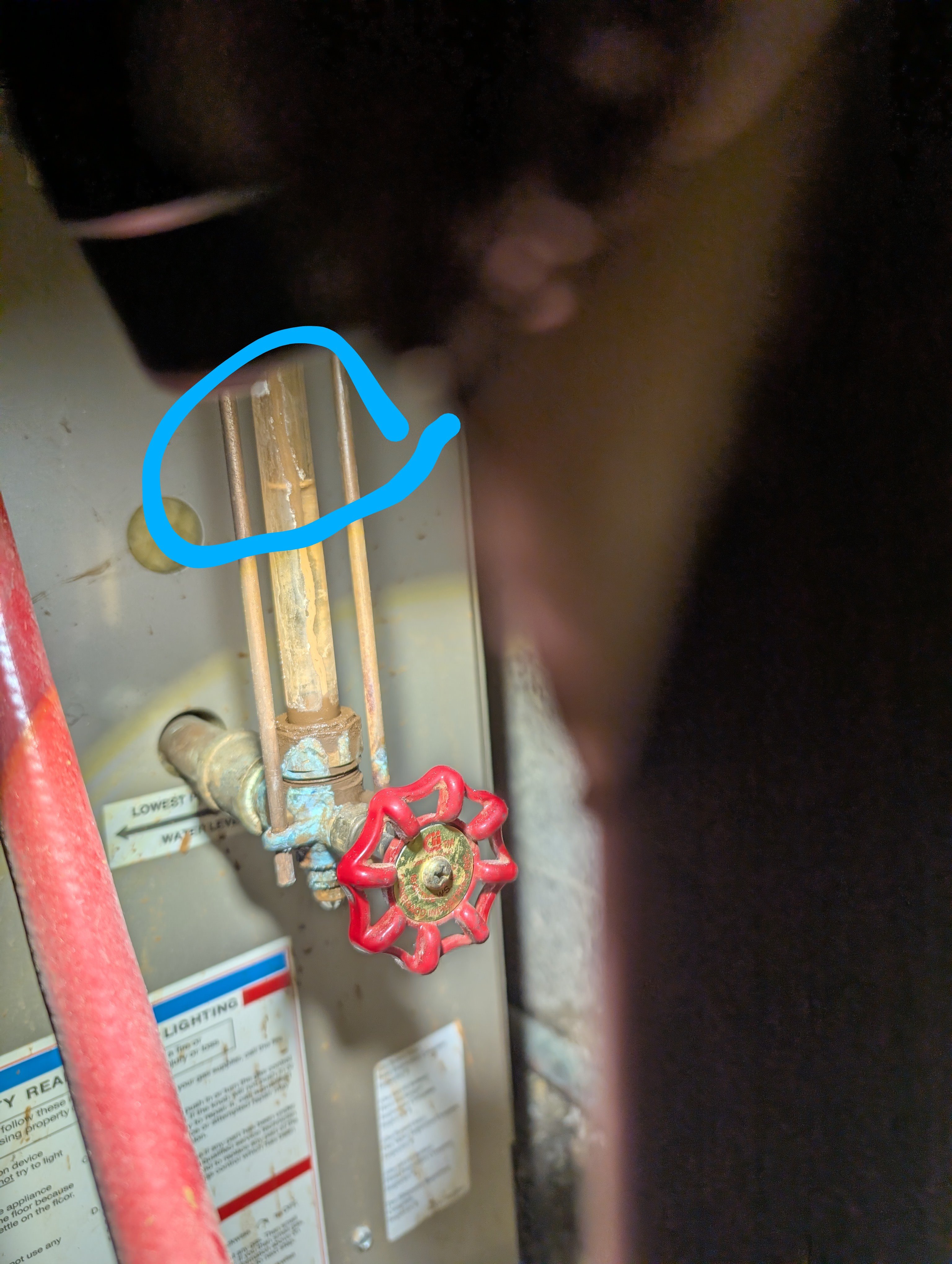

    Show us the LWCO device and it's location relative to the floor and sight glass.

    @Captain Who Below is picture of when condesate pump start
    And here is the picture of after condesate pump finish pushing water to the boiler

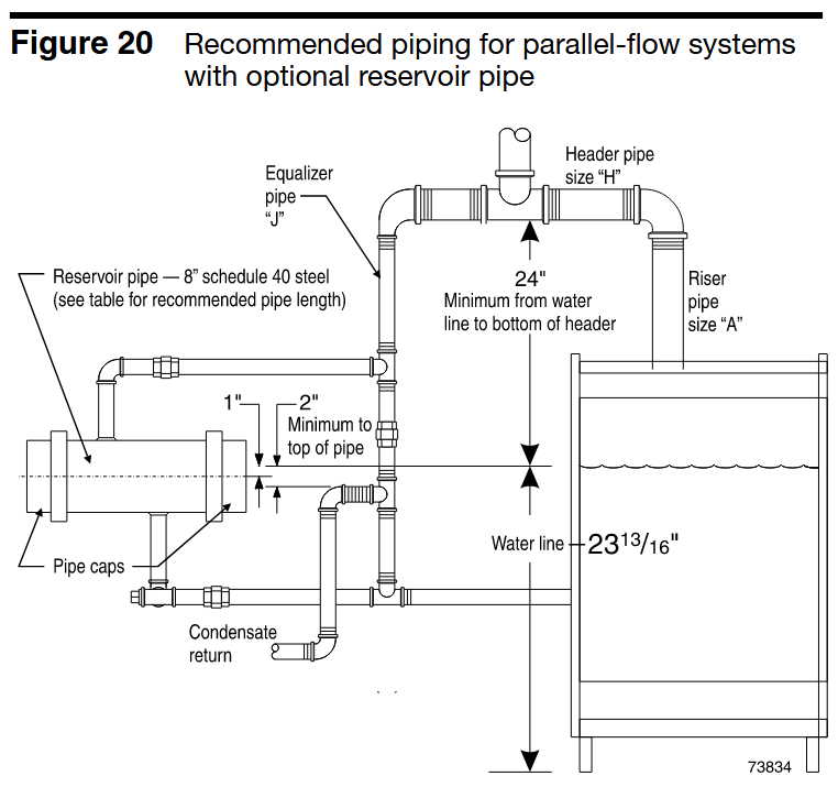

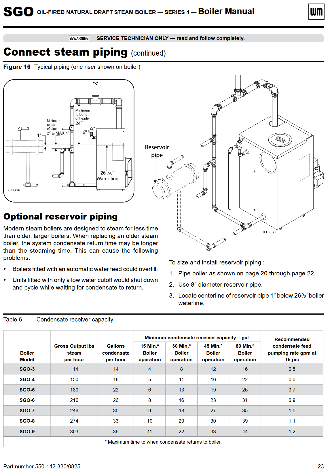

    EBEBRATT-Ed Member Posts: 20,084
    You need someone that knows steam to look at your system to find the problem. The fix could be a boiler feed tank
    or a surge tank as shown in the Weil Mclain piping diagram.
    A surge tank would be less $$ if that is the correct fix.

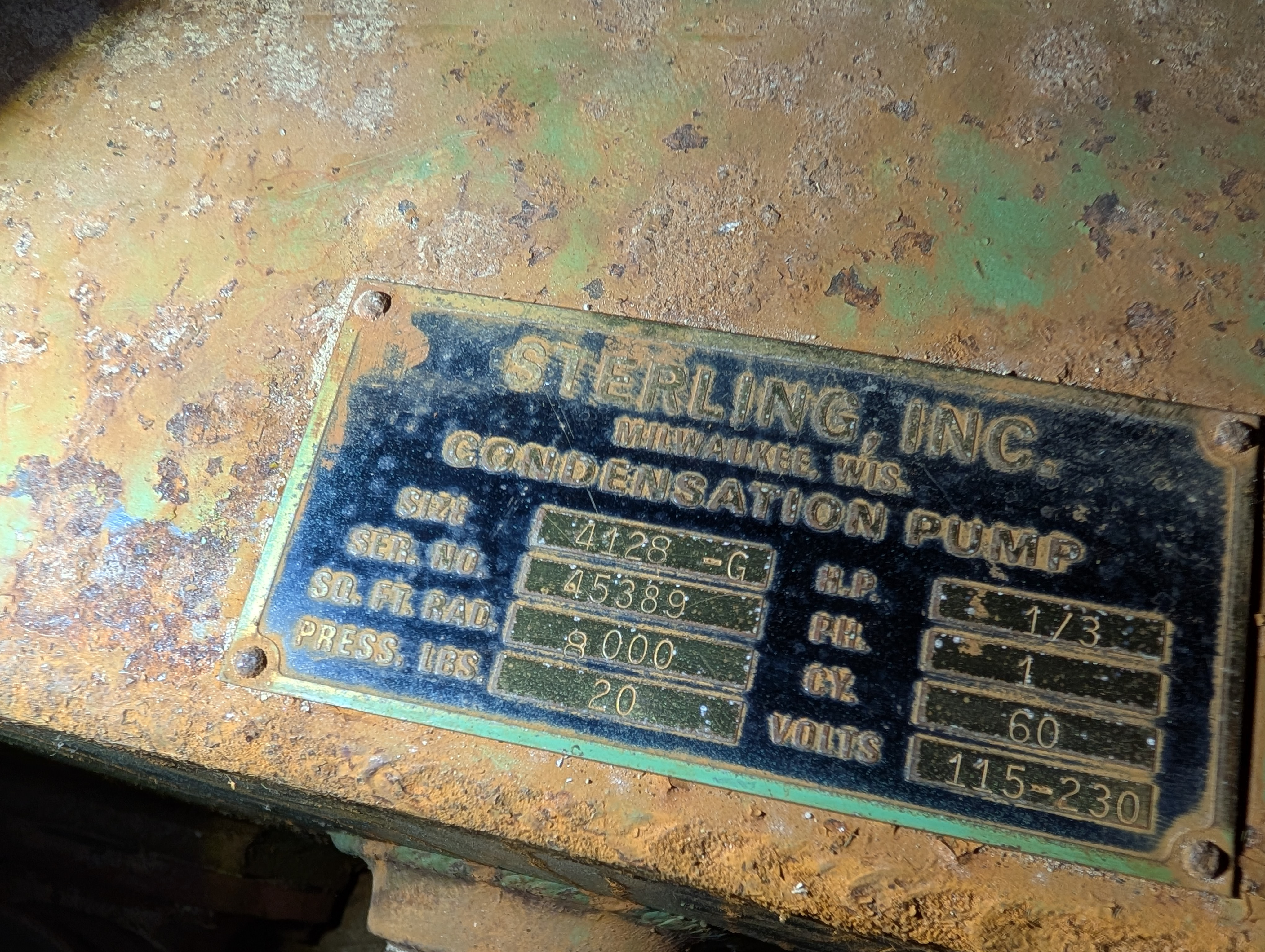

    Ah… with some ingenuity you don't need to replace either the tank — or the pump or the float switch you now have to activate the pump. Nor the low water cutoff which activates the automatic water feed.
    That's a pretty good size pump, though, so you will need a relay — maybe two relays, depending on the voltage of your auto feeder and your low water cutoff.

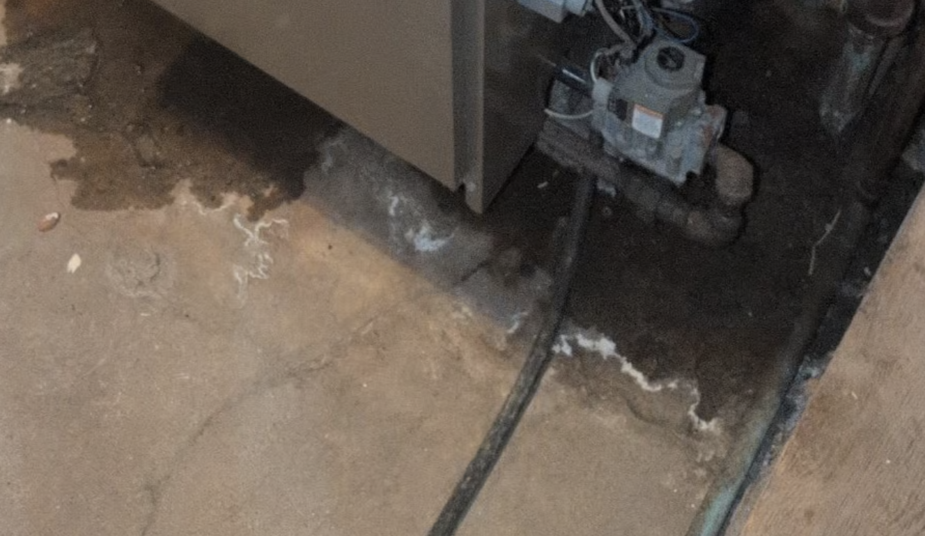

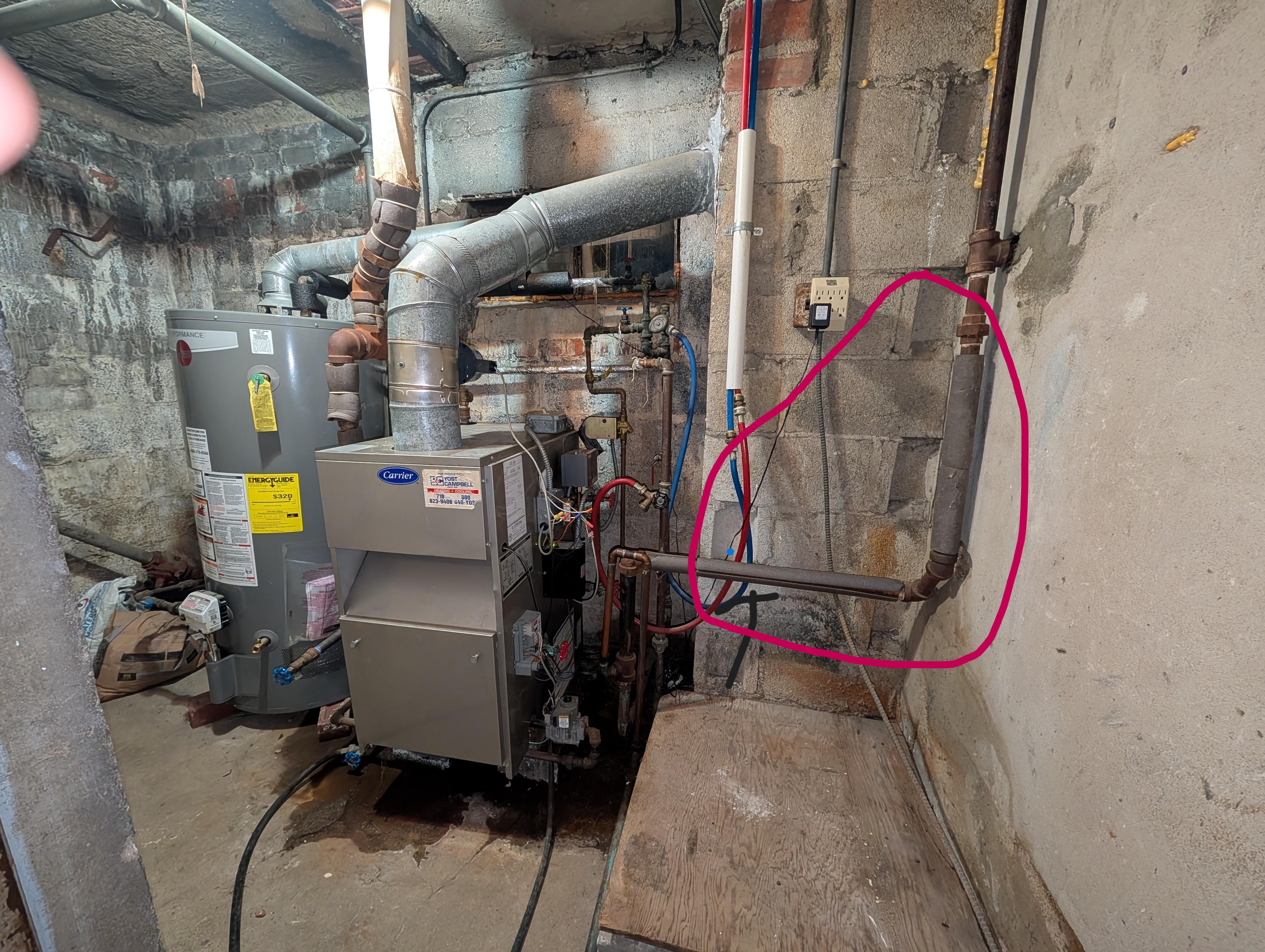

    is there often water on the floor under the boiler?

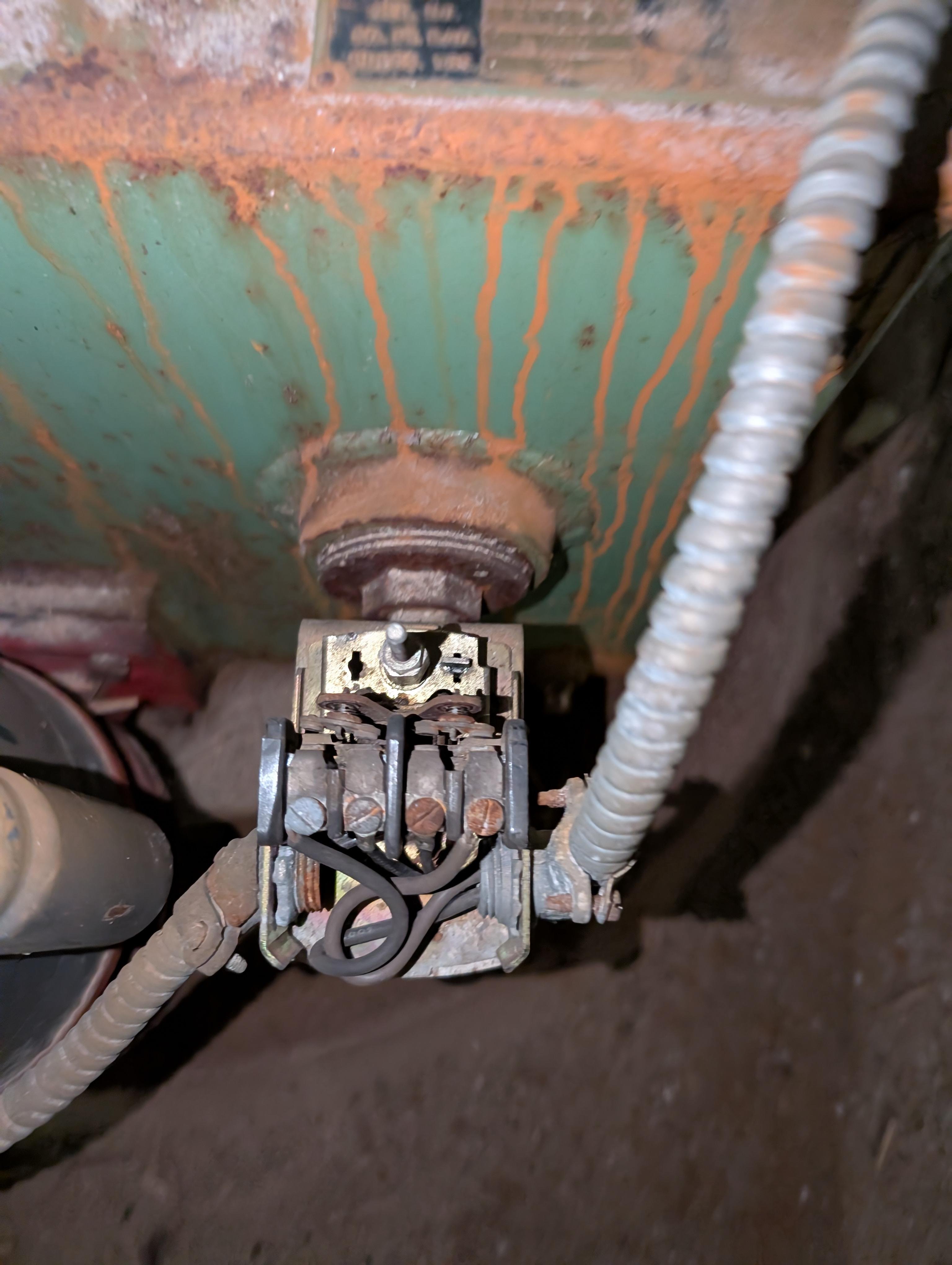

  • JUGHNE
    JUGHNE Member Posts: 11,547
    Yes, what is the water on the floor from?
    Your LWCO looks to have a probe into the boiler water.
    That probe may need cleaning. Also the pigtail loop under the pressure control can plug over time.
    You will benefit from the book "We have Steam Heat" from this website.

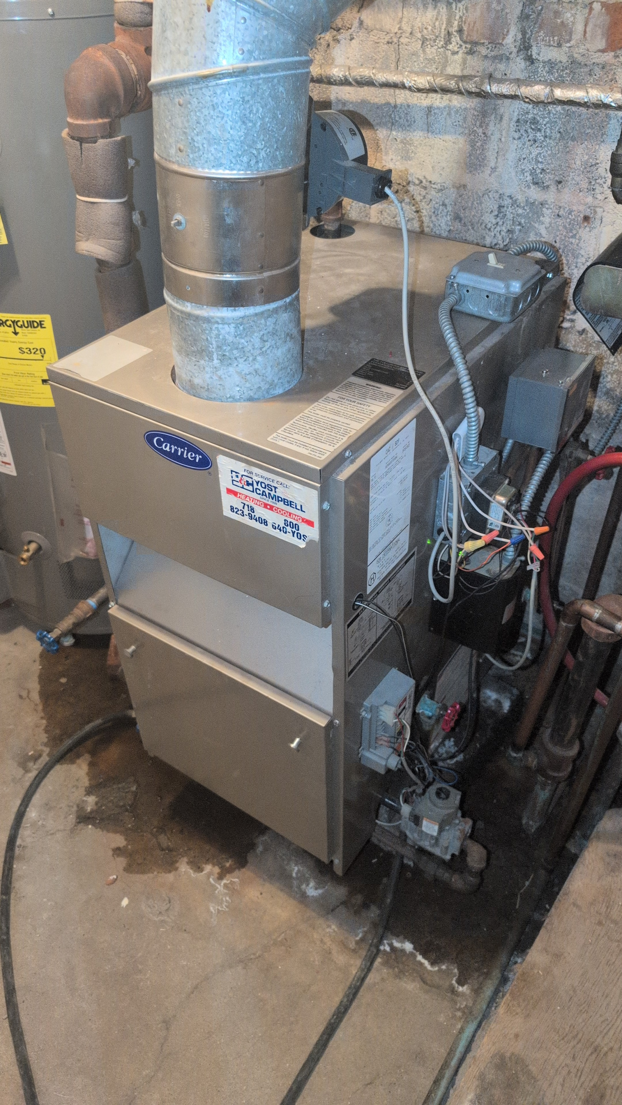

    A picture showing the right hand side of the boiler…..full on full side will help.
