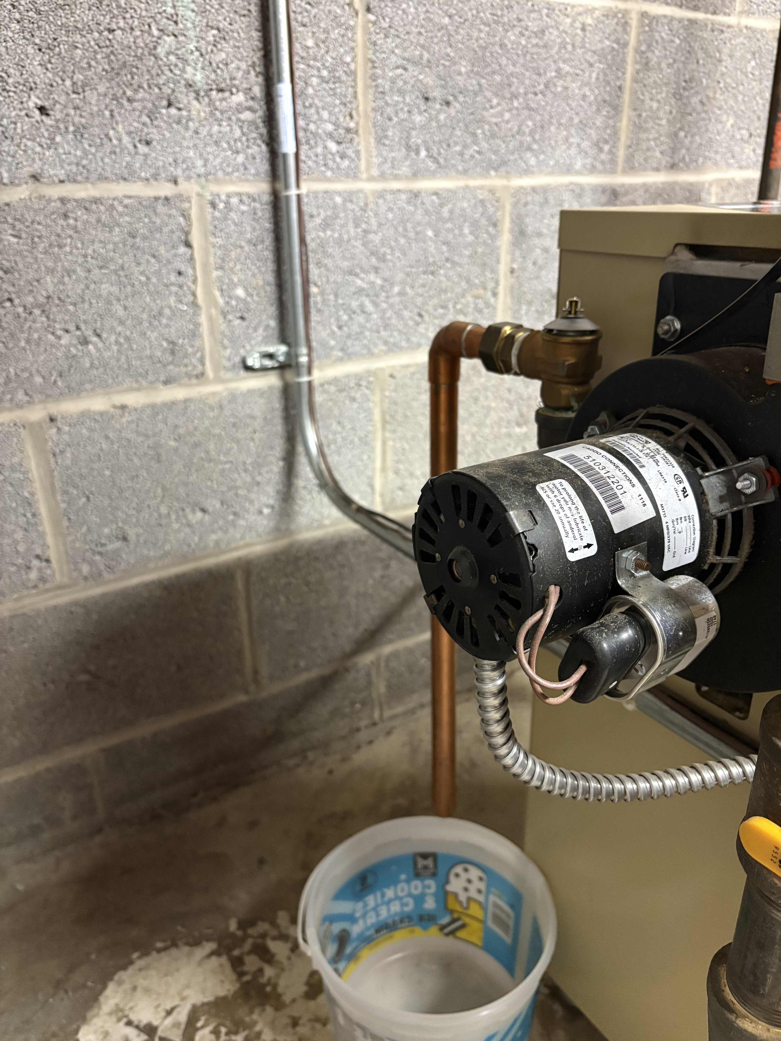

Hello all. My expansion tank failed this morning in my gas fired hydronic system. In an effort to save a some hard earned cash, I changed the tank myself since it was easy to isolate with shutoff valving. I did not however replace the PRV valve and after flushing Im still getting a very slow drip. Any chance it may totally re-seat or is my only option to replace? This does not as easy to isolate as the tank was. Appreciate the help in advanced.

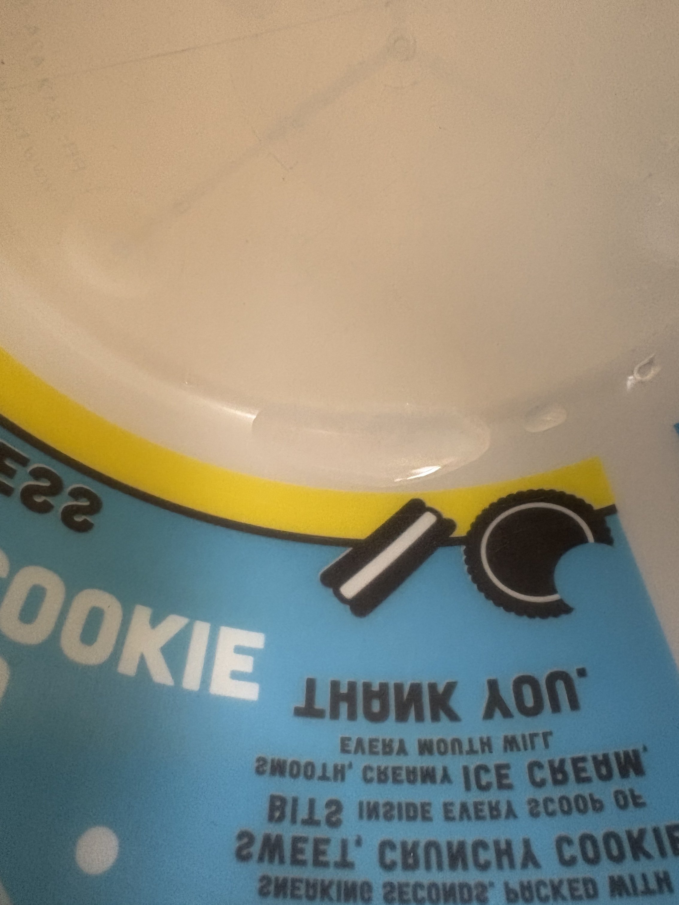

    Sorry all. I should have been more clear. Pressure relief valve. Checked on it this morning (now) getting ready for work. Boiler pressure right at 15psi with the circ pump on and indirect tank zone valve calling for heat. Very minimal water in the pail I put under the relief valve to monitor. Pics attached. This amount of water is about 9hrs as I wiped the pail out at 7PM. 4AM now.

    PRV is generally used when referring to the Pressure Reducing Valve (automatic fill valve). I believe you're talking about the 30 psi boiler relief valve. There's some confusion.
    You don't need to drain the whole system. Isolate everything you can. Close air vent caps if any. Drop boiler pressure to 0 psi. Have the new one prepped and ready. Pop the lever on the old one before removing to verify no pressure. You might need to purge. Check the zones.

    Intplm. Posts: 3,160
    When changing your expansion tank, something got caught in the relief valve that has slightly damaged it not allowing it to seat water tight. The only thing left is to change it.
    If it were my house, I would give it a chance to right itself. Why? Because the amount of water it is losing is very little and might just stop or heal on its own. Ive seen that happen quite often. Monitor it and see.

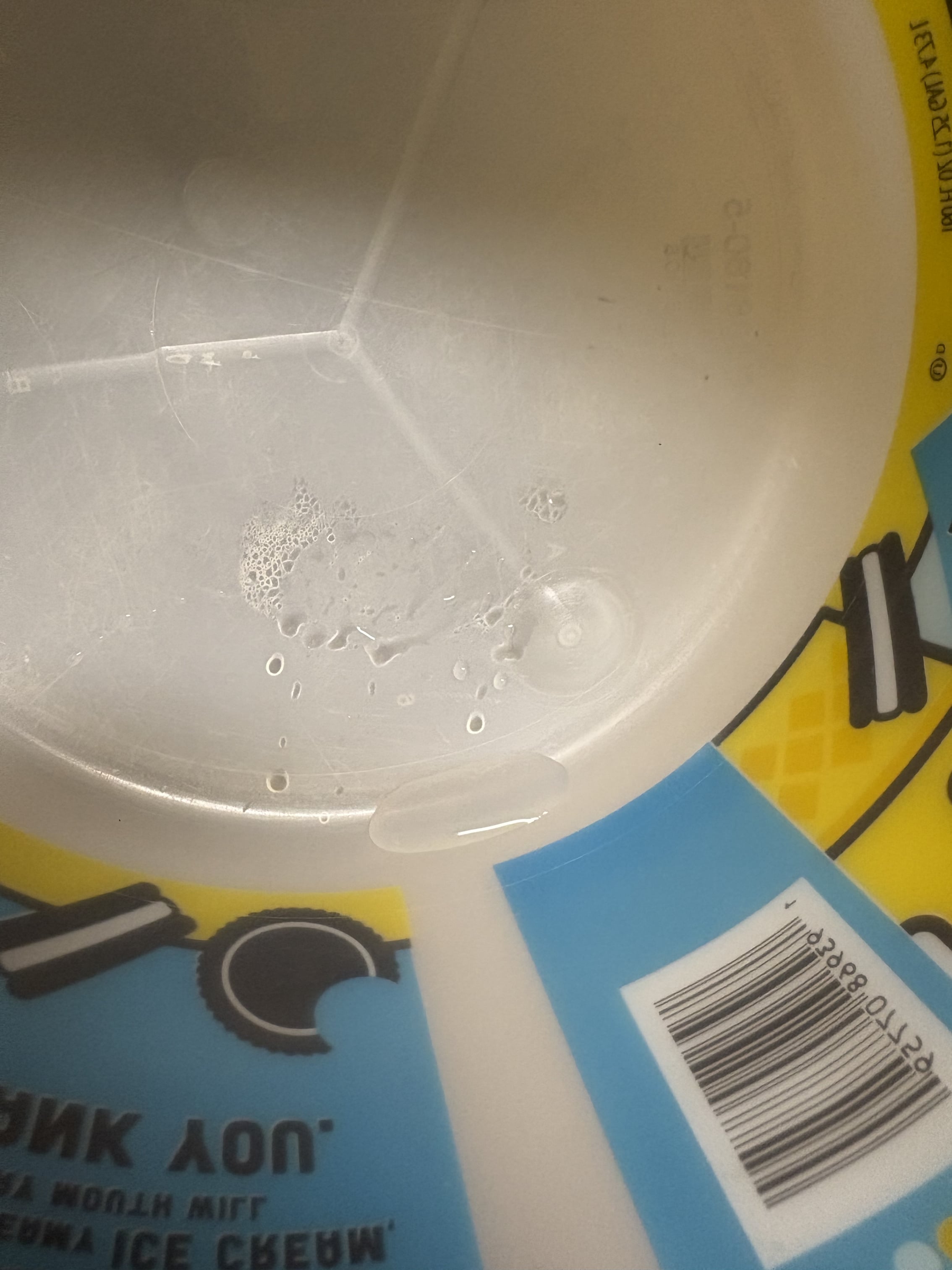

    I’ve been checking on it daily. This morning, similar to yesterday. There was a minimal amount of water that wept by. See pic below. This was just about 12hrs of worth of collection.

    pecmsg Posts: 7,633
    if that’s it I wouldn’t worry about it.
