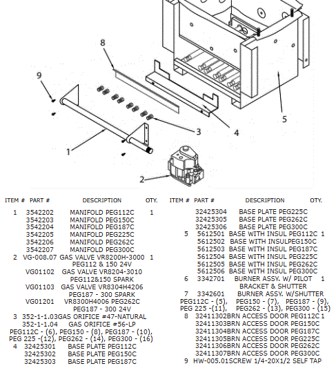

My daughter has a Utica PEG112CDE running on natural gas. yesterday I performed the annual maintenance and noticed two items missing when I looked at the manual. (I did not notice this previously)
It looks to me like Item 4, Base Plate and Item 8 Burner Access Door are missing. The manual does not show a picture of the items installed, just the exploded view.

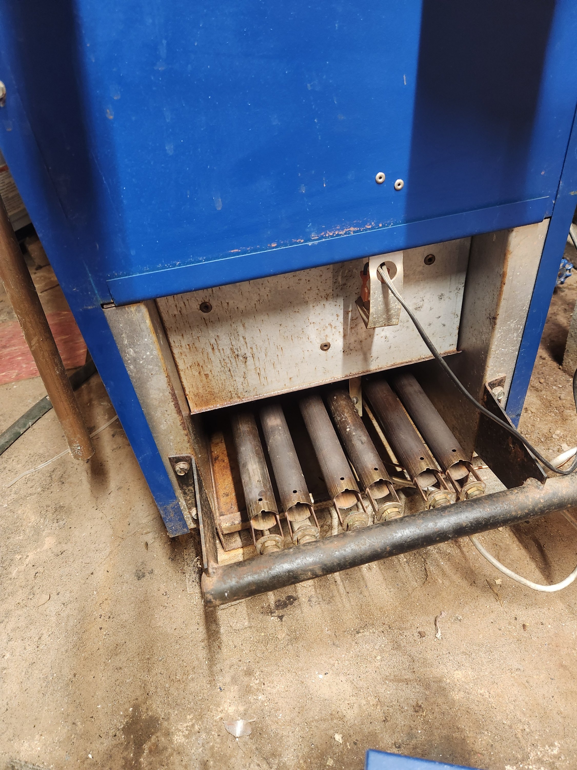

In the following picture the manifold cover is removed but no other parts.
its been this way for the three years she's been in the house. I clean the HX and burner tubes each year and test combustion, in addition to the steam side maintenance. I would think these missing parts would allow more excess air/O2 into the picture but combustions numbers are in spec. (correct me if I'm wrong)

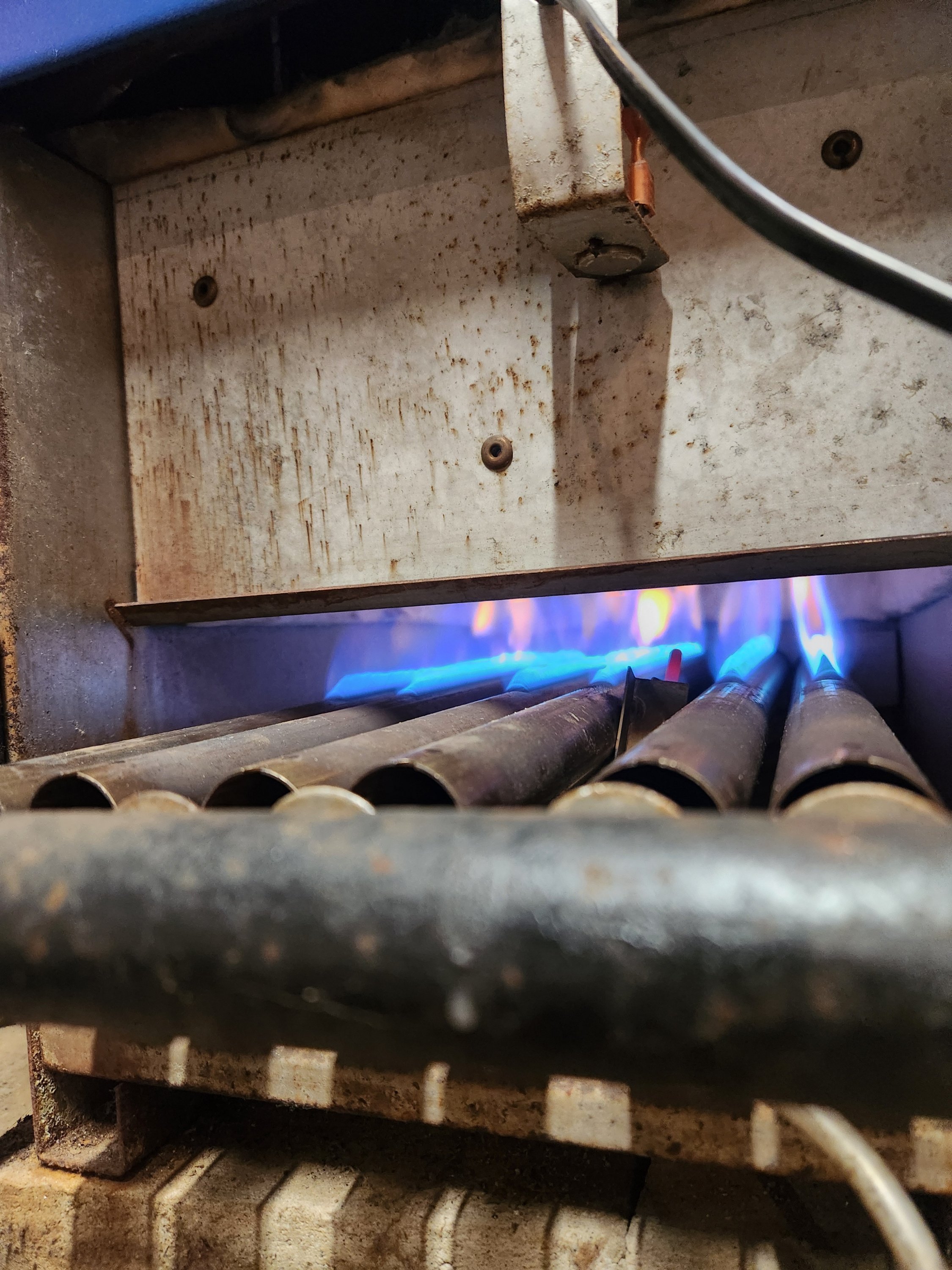

Lastly here is a shot of the flame
I'm finding the parts available at a reasonable price, so its a no brainer.

    You would need #8 for designed combustion . That would be easy to make .
    Steamhead Member Posts: 18,735
    This. And the other name for that part is "Rollout Shield" since it keeps the flame from coming out of the front of the boiler, where it can ignite the gas going into the burner tubes. So this is a safety issue as well.

    The piece right above the opening that has the three rivets on it has a little lip for it to hang on how far down does it need to hang? Im assuming, just above the tubes…

    I’m not surprised you are seeing ok numbers even without these parts. Atmospheric gas burners are not exactly in a tightly controlled environment. Thanks for sharing that info

    The top plate should stop along the top of the burner tubes . That boiler also had a cover that hung on that top lip and covered the burner .. Like Ed mentioned , look around the cellar for the missing parts ..

    That cover with the louvers is there, just removed for the pic
