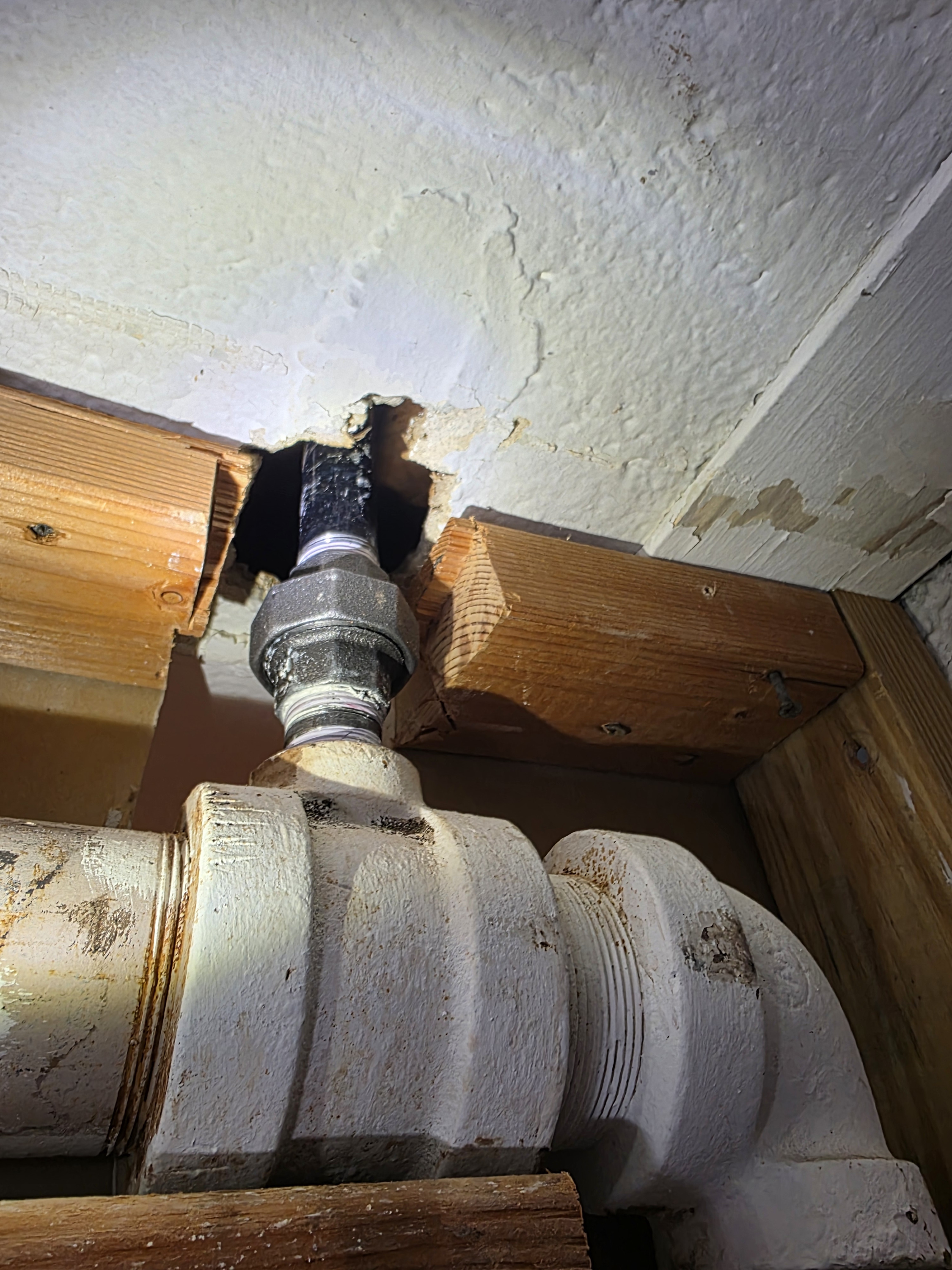

What's the professional way to raise this vent?
Want to raise this vent above the main into the ceiling. Easy peasy. Maybe one day I'll put a #2 up there. Aside from just putting a 3/4" nipple into the main, what's the way a future person wanting to replace the vent would be like "now this was done right"

    I like the vents as high as possible, but that's just one of my quirks is to keep it up out of the water.
    You could use a close nipple and a union coming out of the tee to make a replacement easier.

    If you want to cushion the blow of water hammer, you don't have to raise it, although that is preferred. You could tree it off to the side with a 45 and an Ell and a couple nipples and the extra volume in those will give the vent an air cushion. Ideally it should be located further away from the elbow to the return but try that.

    like @EBEBRATT-Ed said, i'd put a union in there right off the main so you can pull the whole thing down by just breaking the union but other than that nipples and couplers are the way to go. I think there is even a male-female union that could thread directly in to the main and eliminate the nipple there.

    ratherbfishing Member Posts: 45
    So like this
    Gorton #1
    3/4" Coupling ← service joint
    3/4" Riser Nipple (6")
    3/4" Union ← removable assembly
    3/4" Close Nipple (1–2")
    Steam Main Tapping
    I'm guessing the close nipple will become permanent basically.

    you can remove the close nipple with an inside pipe wrench or sometimes you can grab it between the sets of threads with channelocks without damaging it. you certainly can remove it with a pipe wrench but that is likely to damage the threads.

    Is it bad practice to use something like this instead of a close nipple? It was really really tough to get the old vent loose.

    Just make sure that you don't have water hammer, and you'll be okay. If you have enough water hammer to damage that valve, then you have bigger issues than valve replacements.

    Well, the way to do this right is to build in a finished recessed box on the ceiling between the floor joists. Then you can use a union and a regular nipple to get the right height. This way the vent is always accessible.
    Instead of a recessed lighting cavity, its a "recessed venting" cavity.

    You can use any length nipples you want. I mentioned a close nipple because I don't know how much room you have. Use any length that works for you.

    teflon tape and teflon dope will make things easier to get apart later.

    Thanks, everyone. Went from a gorton D installed on the main with a 90 elbow to a gorton #1 on a 10" riser with a serviceable union. Takes about 3:10 for me to feel heat at the end of the main. Just a dumb home owner over here but definitely improved what the installer did 30 years ago.
