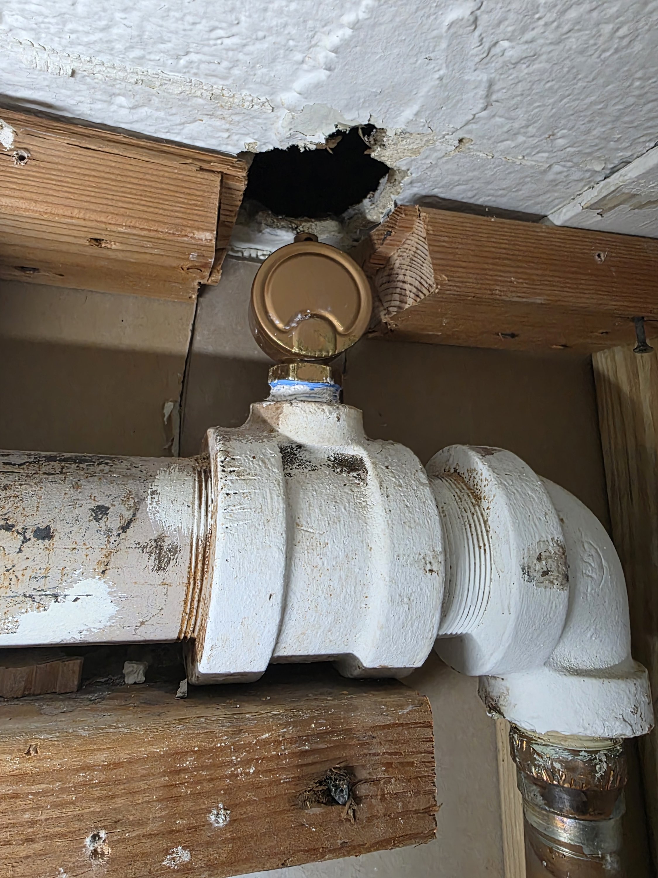

What's the professional way to raise this vent?
Want to raise this vent above the main into the ceiling. Easy peasy. Maybe one day I'll put a #2 up there. Aside from just putting a 3/4" nipple into the main, what's the way a future person wanting to replace the vent would be like "now this was done right"
If you want to cushion the blow of water hammer, you don't have to raise it, although that is preferred. You could tree it off to the side with a 45 and an Ell and a couple nipples and the extra volume in those will give the vent an air cushion. Ideally it should be located further away from the elbow to the return but try that.

like @EBEBRATT-Ed said, i'd put a union in there right off the main so you can pull the whole thing down by just breaking the union but other than that nipples and couplers are the way to go. I think there is even a male-female union that could thread directly in to the main and eliminate the nipple there.

So like this
Gorton #1
3/4" Coupling ← service joint
3/4" Riser Nipple (6")
3/4" Union ← removable assembly
3/4" Close Nipple (1–2")
Steam Main Tapping
I'm guessing the close nipple will become permanent basically.

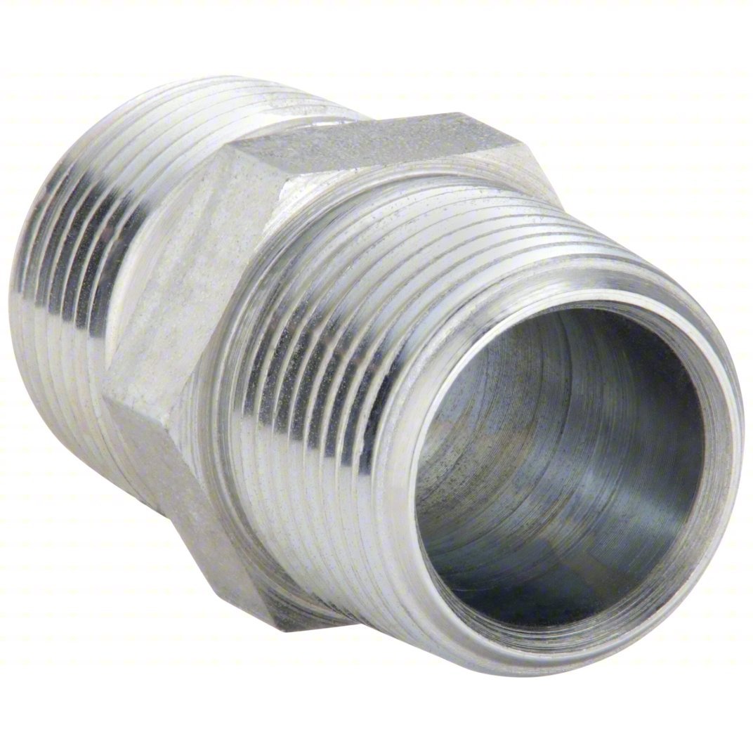

you can remove the close nipple with an inside pipe wrench or sometimes you can grab it between the sets of threads with channelocks without damaging it. you certainly can remove it with a pipe wrench but that is likely to damage the threads.

You can use any length nipples you want. I mentioned a close nipple because I don't know how much room you have. Use any length that works for you.

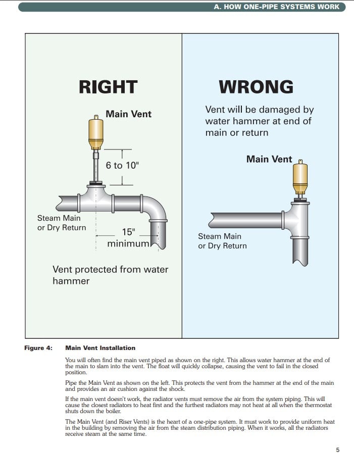

It's a shock wave, due to the fact that there is approx. a 1,700x volume change in going from liquid water to steam and vice versa. If it is severe enough it is audible. If it is severe enough it can do damage to vents, especially the float.
I heard it in this system 21 years ago when I first moved in. My varivalves weren't damaged by it afaik probably since they are only at the radiators, but it was quite disconcerting. My longest main had a large puddle at the last 6 ft or so of it, due to incorrect pitch. I also didn't have enough downward pitch in my dry returns. My main vents aren't at the 180 deg turns into my dry returns but are at the end of the dry returns by the boiler.
Thanks @Captain Who I can see it if there is a pool of cool water due to sagging. I'm familiar with what causes steam/water hammer generally and have experienced it with a sag in a radiator runout, but lots and lots of people say "raise the main vent to avoid water hammer" but there is not water hammer in a properly pitched main that I can picture.
If you have water hammer in your main, that is the problem… not the height of the main vent, and I, like you, would work hard to fix it. Thanks again.
People word things wrong sometimes. The reality is that raising the vent helps prevent damage to the vent in the case of water hammer.
