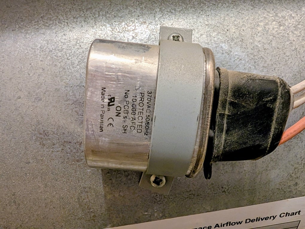

Based on the following can anybody help me find a motor and capacitor. And if so is there any reason I can't replace it myself?
Any help offered is GREATLY appreciated.
    did you try just replacing the cap? that is usually the cause of it humming but not turning. if you get it spinning in the right direction and turn it on it will usually sort of run although if it is capacitor run it won't get up to full speed. get the made in usa caps like the titan hd.

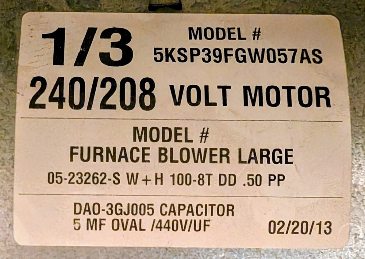

    if it says 5mfd under the clamp this is the right cap:
    https://www.supplyhouse.com/Titan-HD-POCF5A-5-MFD-Oval-Motor-Run-Capacitor-440-370V
    does it spin freely? is there play in the motor shaft up and down or front to back?
    if it is the motor we can help you match it up but we will need to see the motor ratings plate and the shaft size and how it it mounted. there are universal parts that will let you mount a new motor in there.

    You need the information off the actual motor.
    HVACNUT
    HVACNUT Posts: 7,784
    Show the label on the actual motor. A standard Rescue motor would probably work, as long as its not a welded frame to motor.

    OK new Capacitor came today. Simple installation. Motor still buzzes but doesn't spin. Tomorrow I will begin attempting to extract the blower motor.

    You must use the capacitor that the new motor calls for, not what was used on the old one - even though it may be new.
    A lot of the newer motors use larger capacitors than the old ones to achieve higher efficiency or cover a wider horsepower range.

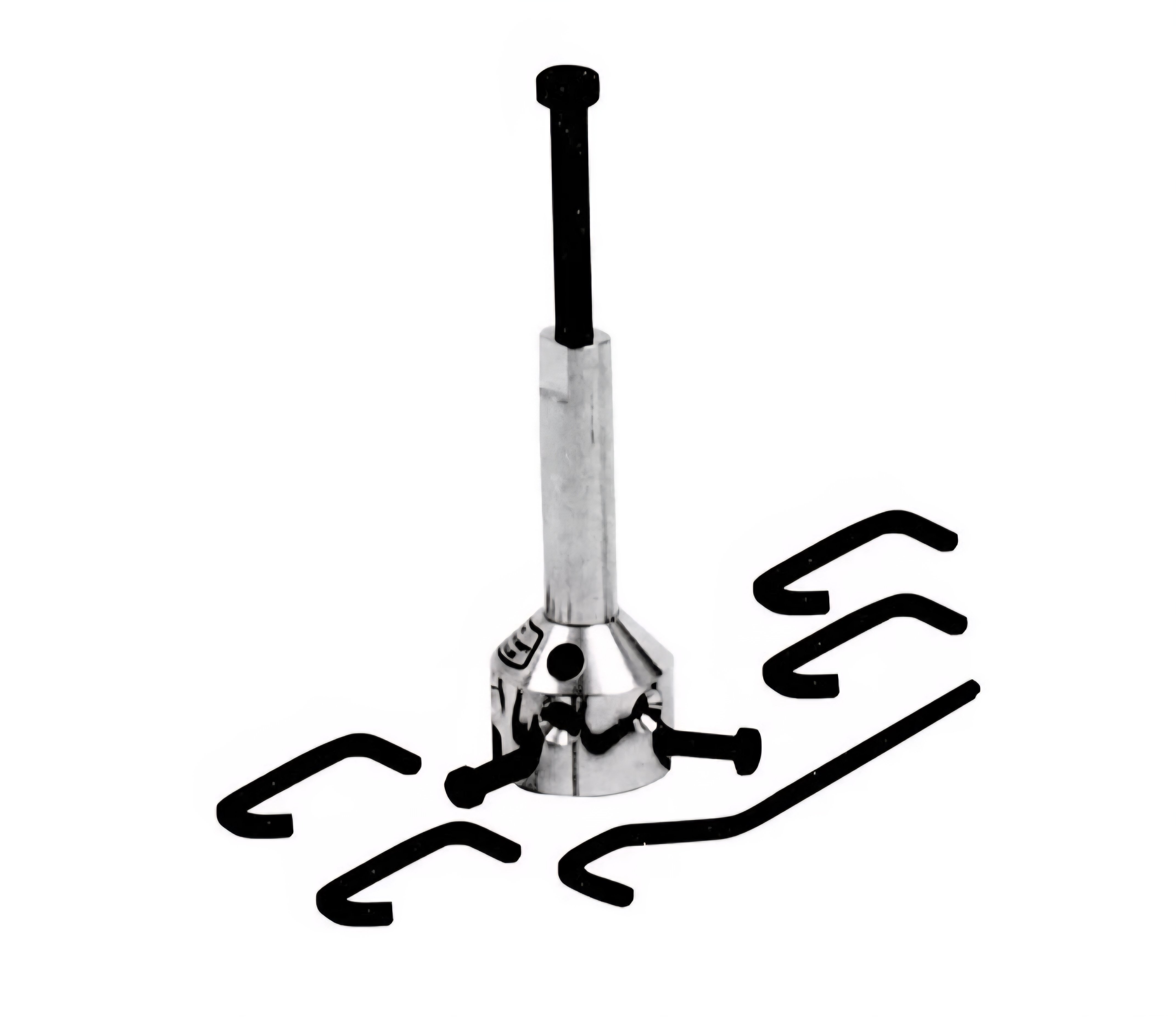

    Got the blower housing out and the fan is stuck solid to the shaft. Per a video I saw been using an impact drill to try and knock it loose. No way to support the motor to impact on it except to let the fan rest on the motor side of the blower housing with the motor dangling underneath. So I am concerned about possibly unbalancing the fan.
    Also saw this in a video, For $60 it's worth it if it works. Plus I'll have another piece of unused stuff to clutter up my garage.
    https://sensibleproducts.com/ultimate-puller/
    Anybody have any experience with this tool?

    Regardless I drilled a center divot in the motor shaft and am using neighbor's electric impact drill not a chisel. There are undoubtedly more powerful impact drills out there.
    you could probably clamp a hose clamp and something to hook with a standard 2 or 3 jaw puller around the hub after you remove the setscrews. Unless it is rusty it will likely com free pretty easily once it moves a little.
    looks like the supco branded version is much less expensive. if it works or not depends on how stuck it is.
    https://www.supplyhouse.com/Supco-FBP100-Fan-Blade-Puller

    I saw the impact drill on a Youtube video. It worked great there. Not working for me. Guess I didn't understand what a wheel puller was in your post. Regardless, whether the fan is good or not I have to separate it from the motor. Do you have a link for the puller you pictured above?
    Is this one OK? https://sensibleproducts.com/ultimate-puller/
    i think it is the same one. if you do some searching you can probably find one used on ebay. there appear to be 2 designs, that one with the narrow body above the hub and one that is a tall cylinder with a nut in the middle

    If you use that puller shown you want to be sure that one of the 3 set screws on the puller do not go into the opening for the hub screw(s).
    This might mess up the threads of the wheel hub.
