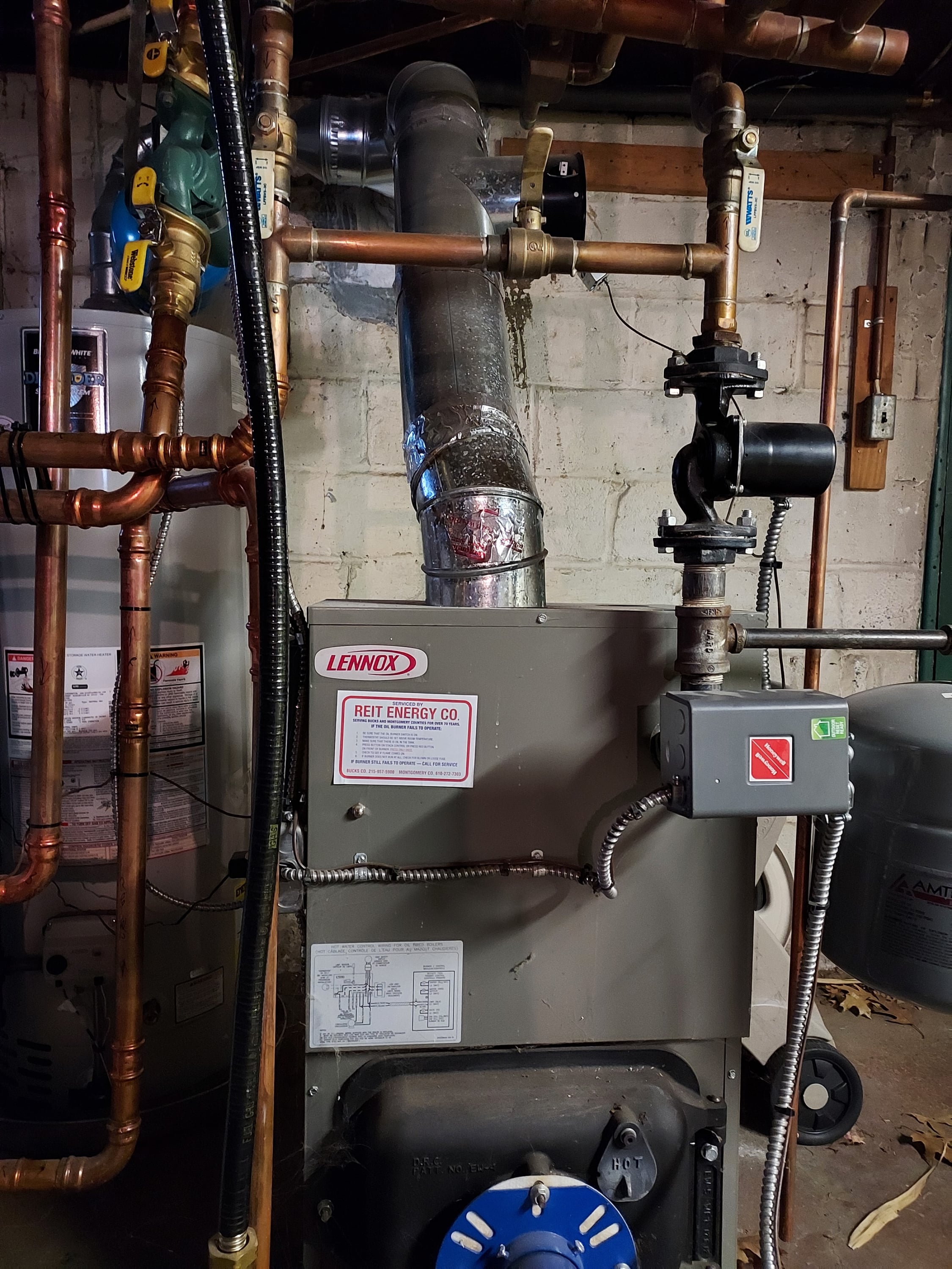

    You mentioned the boiler is about 10 years old and was originally oil-fired. You bought the home in 2019 and converted the boiler to natural gas in 2023.
    If I understand correctly, you have a Lennox COWB3 series boiler with a gas-fired power burner that replaced the original Beckett oil burner. At the same time the gas burner was installed, a buffer tank was also added. Correct me If I am not understanding your system.
    Does the Lennox boiler provide domestic hot water at all? In other words, what supplies your hot water for showers and faucets?
    To confirm that the tank is truly a buffer tank and that it’s installed correctly, could you provide the brand name and model number of the tank? Also, please share a few photos taken from far enough back to clearly show the boiler, the tank, and the piping from floor to ceiling. That would be very helpful.
    Based on how you described the system operating, it would waste a lot of fuel if it were actually set up that way. I don’t believe someone would intentionally design a control system like that. A proper setup would have the boiler operate as a cold-start boiler using an L8148A control, which only fires the burner when there is a call for heat.
    Because your system has two small (micro) zones, a buffer tank can make sense. Without one, if only a single bedroom zone calls for heat, the boiler water temperature will rise very quickly, hit the high limit, and shut the burner off. The zone then sits idle while the water cools, and the burner restarts for only a few minutes at a time. That short cycling never allows the burner to reach efficient operation.

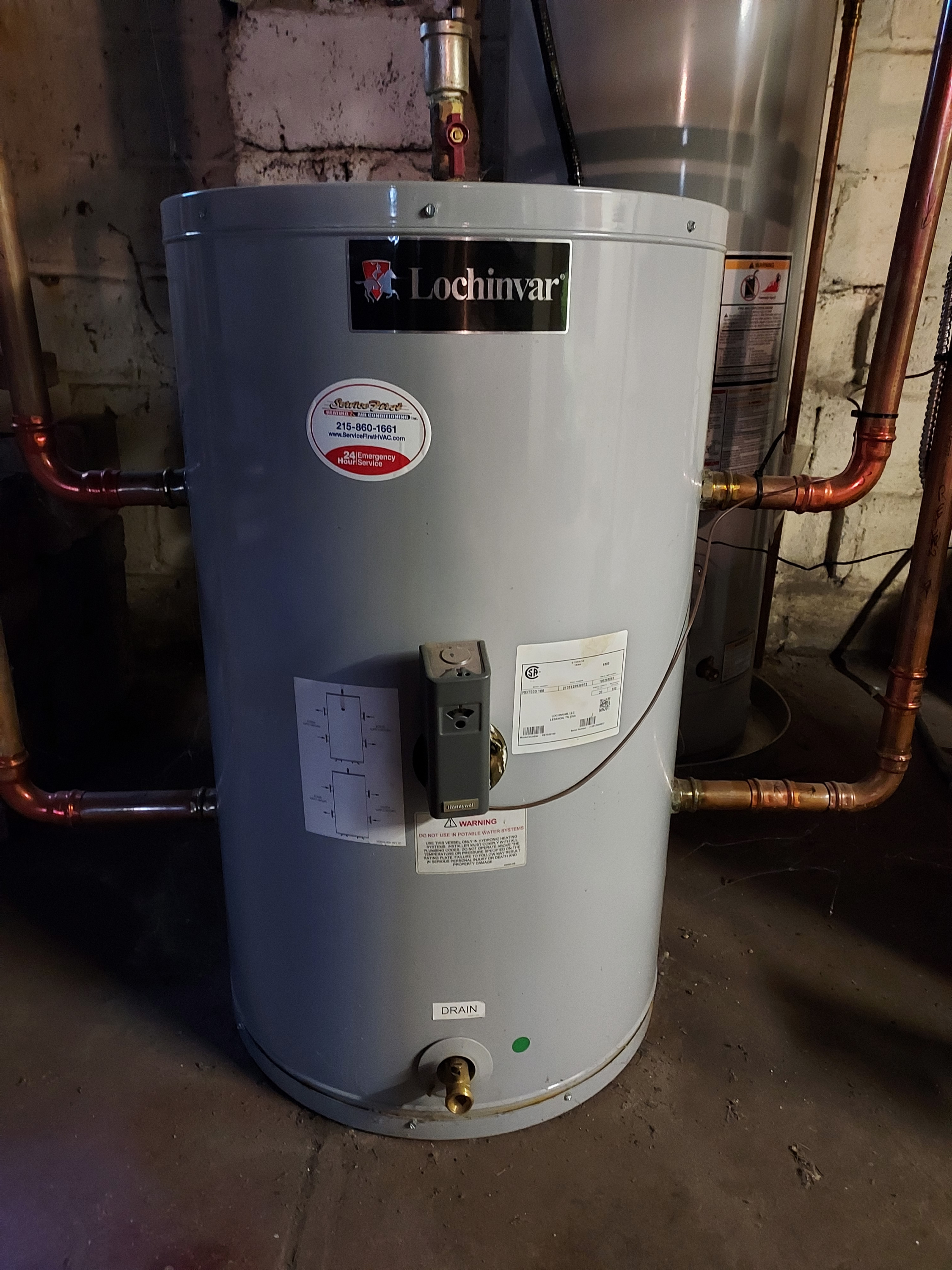

    There is a separate water heater for domestic hot water. The boiler outlet goes through the black pump to the upper right connection on the buffer tank, and the lower right buffer tank returns to the boiler. The left upper tank connection goes to the green pump and to the baseboards. The returns come through 3 zone valves and to the lower left tank connection.

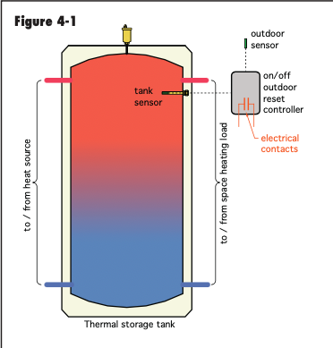

    there are a number of ways to control that system. Commonly the control on the buffer tank runs the boiler to maintain the tank at say 160-180 degrees. So the buffer is always hot, ready for a heat call.
    When a zone calls, the system pump pulls from the tank, as the tank temperature drops to 160 the boiler fires to bring the temperature up to 180
    In some cases the boiler is controlled by an outdoor reset control, so the tank temperature varies a bit depending on outdoor temperature
    Do you know what that tank control is set to, maybe 180? Also if it has a set or adjustable differential under the cover?
    Also check the temperature settings on the boiler control aquastat, it should be set higher than the tank control setting. It may also have a differential setting.

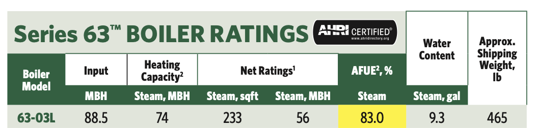

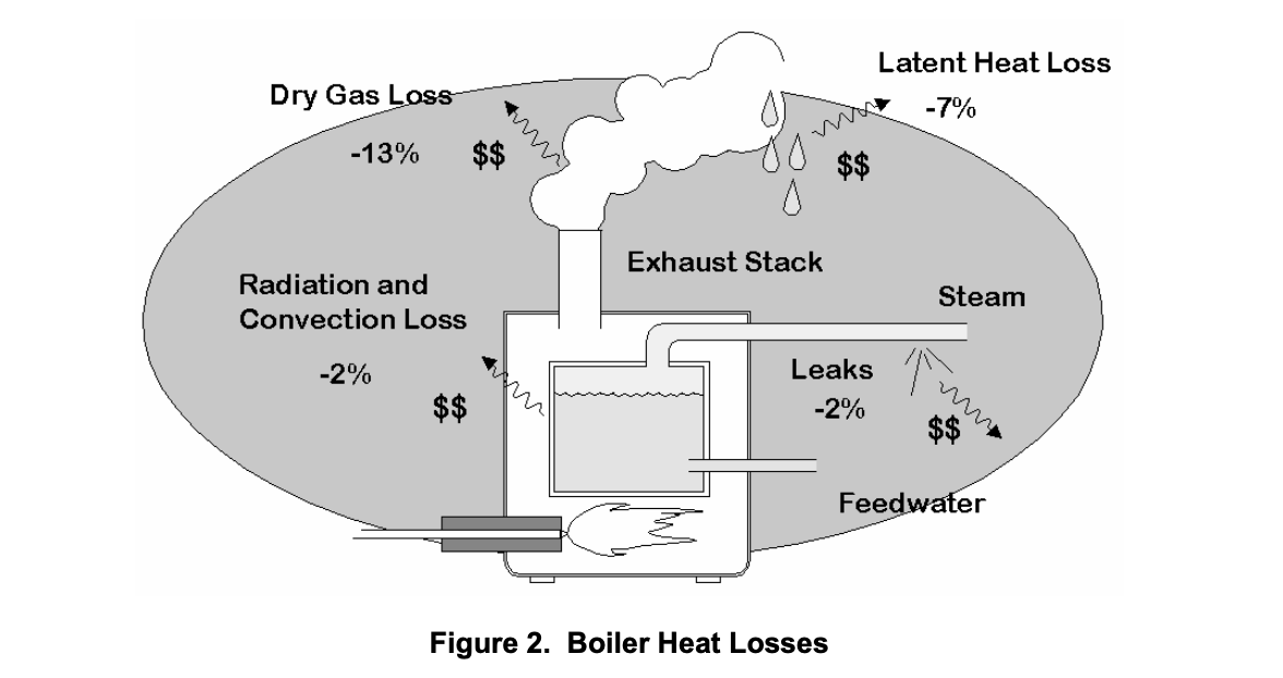

    I looked at your post @jesmed1 about Dry gas efficiency and latent heat loss in the flue gas. If you read the information throroughly you will see and understand that a combustion analyzer that the industry uses for testing combustion efficiency of a cast iron boiler will give you the combined dry gas + latent loss for a total combustion efficiency. This illustration clearly demonstrates that a 80% efficient combustion includes the 13% Dry Gas Loss and the 7% Latent heat loss for a total of 20% stack loss
    In your statement, it looks like the 80% combustion efficiency was combined with an additional 15% latent loss to arrive at a 65% effective efficiency. That can be a bit misleading, since the 80% combustion efficiency already accounts for latent heat losses based on the standard test methods and equipment used to establish that rating. Adding the latent loss again ends up double-counting it. Your earlier post bears that out with a 13% Dry Gas and 7% latent loss for a total combustion efficiency of 80% (See illustration from your post above)
    The specialized laboratory equipment needed to separately measure dry gas and latent losses is very costly and not something that’s practical or necessary to use in the field on a regular basis. For most real-world evaluations, the published combustion efficiency numbers are sufficient.
    There are, of course, other losses that combustion efficiency doesn’t capture. These include standby losses when the boiler is connected to a chimney, where draft can continue to pull heat from the cast-iron sections after shutdown. There are also jacket losses to the boiler room, along with potential losses from leaks, makeup water, and piping or pickup losses in unconditioned spaces. All of these can affect overall system performance and are worth considering.
    My main point is simply that efficiency losses can be easy to overestimate if we’re not careful about how the numbers are applied. Sticking with established testing methods and documented performance helps keep the discussion clear and accurate.
    I hope this better explains what I meant regarding your numbers.

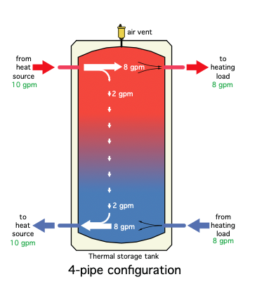

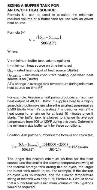

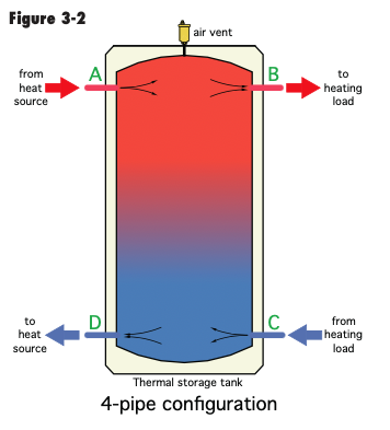

    At some point the tank temperature will reach the control setting. If there is no heat loads being pulled off the tank will stratify. So with your tank control mid point in the tank, them upper portion of the tank will be close to whatever the high temperature setting is on the boiler, call it 195°.
    As you start pulling heat out of the tank, the cooler return starts blending with the hot in the tank, so that outlet tempetature starts dropping. When the control on the tank drops to say 170° the boiler trips on.
    Now the flow through the tank gets more complex. It depends on the gpm that the boiler pump is moving into the tank vs the gpm going to the zones, so you have more temperature mixing and the stratification level breaks up, the tank will be fairly consistent temperature from top to bottom as both pumps mix the tank.
    The very best way to maximize a tank drawdown is to pull the heating loads off the tank with a outdoor reset control. So on a mild day you may pull 150- 160 from the hot 195° tank. So you get a longer drawdown.
    If you know the heat load of the various zones you can calculate an approximate time for the tank drawdown, boiler off cycle. Examples of the math below.
    Is that an 80 gallon tank?

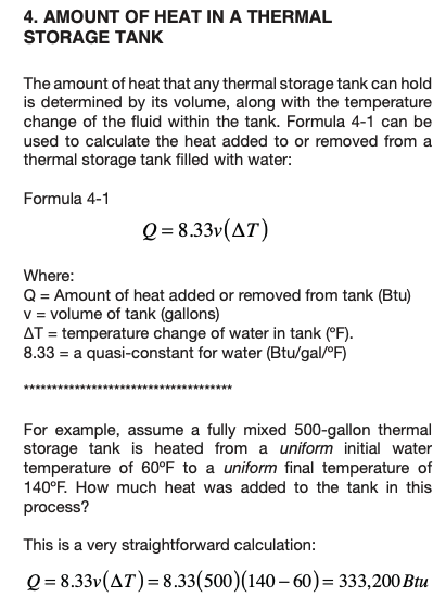

    8.33 X 80 X (195-170)= 16,660 BTU stored in tank
    You have about 100,000 boiler output. More than twice what you need!
    84 total feet of fin tube X 500 btu/ ft= 42,000 btu/hr of heat emitter
    Smallest zone of 12'? or 6,000 btu/hr
    So for a 10 minute boiler run or on time
    10 minute X (100,000- 6,000) = 940,000 ÷ 500x25 tank differential= 75 gallons of tank
    If your tank is 80 gallons you should get around an 10-12 minute boiler run with just one small zone running.
    With all zones calling 42,000 load, should be 15 minute or more boiler run time.
    This is with the tank control set to a 25° differential.
    It could be you tank control has a fixed differential, that could be 15°? You want an adjustable differential control to fine tune, or lenghten the boiler on/ off cycle.
    Remove the cover on the HW tank control, there will be a small notched wheel to adjust the differential.

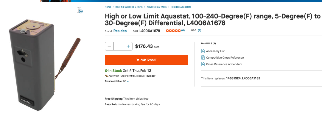

    Here is a pic of a common Honeywell indirect tank temperature control. This model has an adjustable differential from 5- 30°
    The white dial at the bottom, below the two brass screws is the adjustmemt. Probably labled 5- 30
    I would set this to 180- 185 and the differential to 25 to see how that changes the run times.

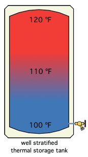

    A 10 minute on cycle is good to shoot for, even 8-9 minutes. But the longer the cycle the better. There is only so much you can do with a buffer on a high temperature system.
    On low temperature radiant systems, for example, you could heat the tank to 180, and pull it down to 110-120. So you have a large 60° delta to leverage.
