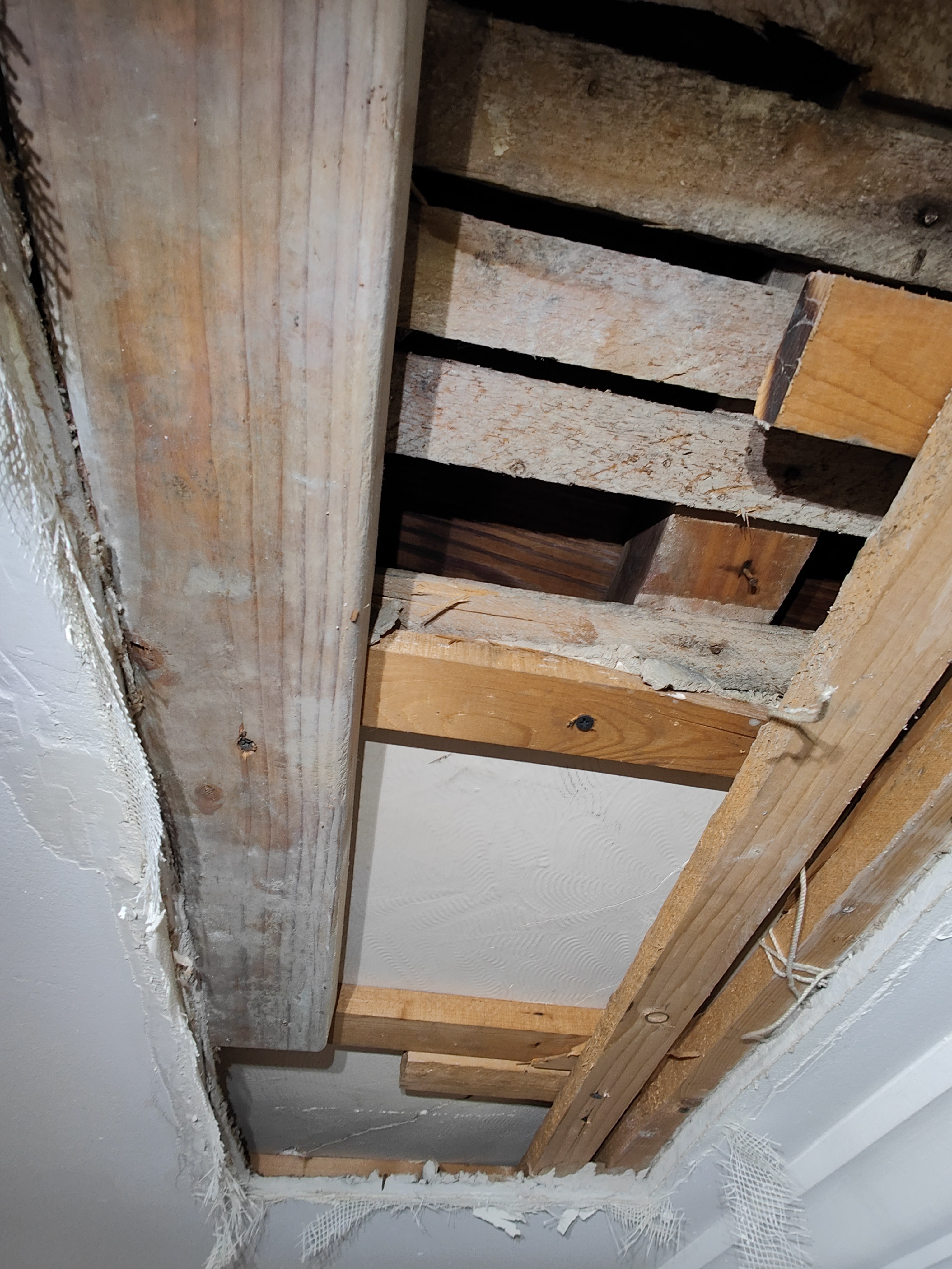

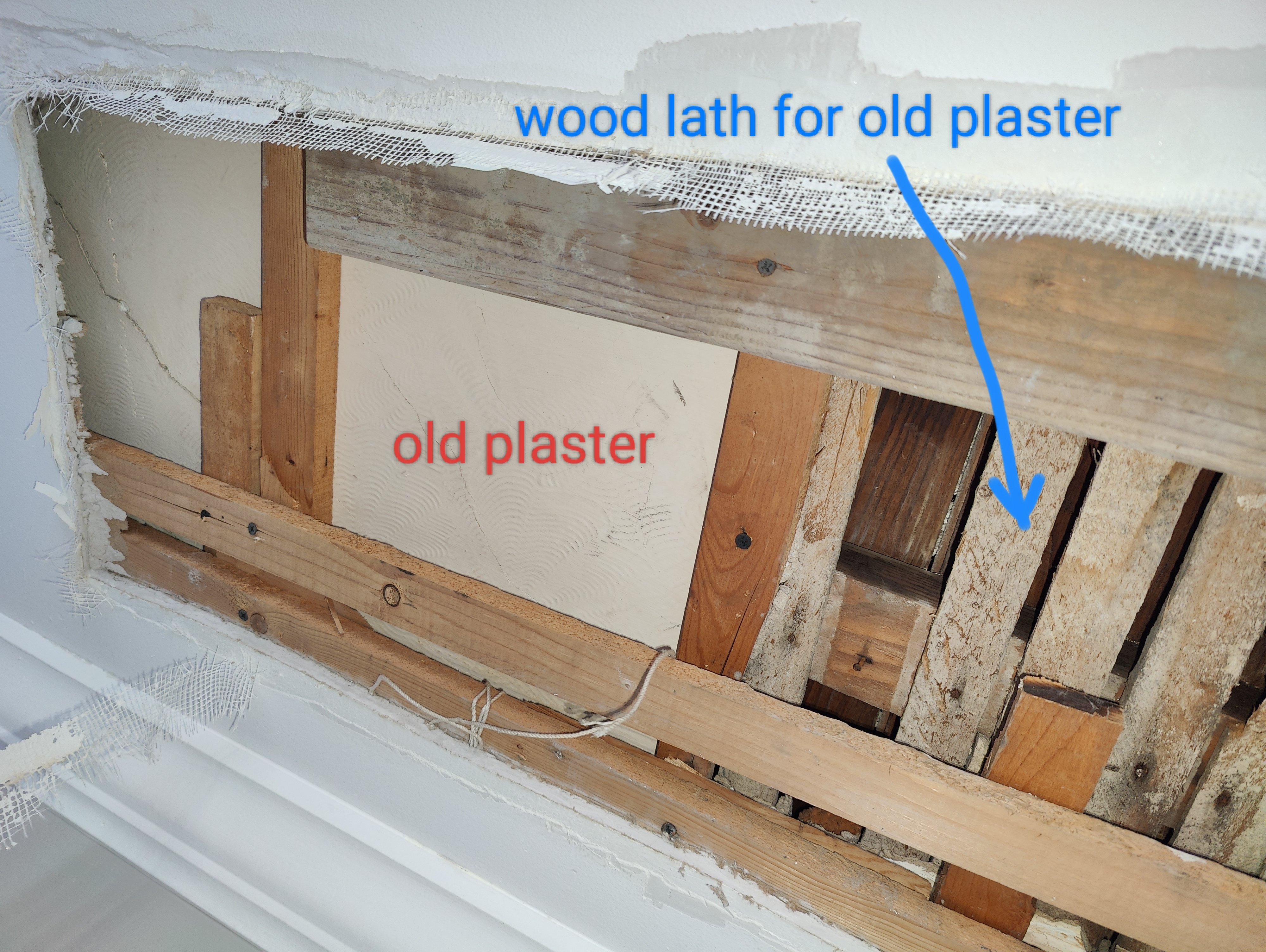

    Here this post is about working on washer drain that is on the 2nd floor, so it's possible to work from the ceiling on the 1st floor, and there are two existing access points that were cut earlier.
    However, after removing the two sheetrock plates, I saw some complex structures that look like the original plaster ceiling. I need to cut away some of those lath and plaster to figure out where the PVC pipe is. Need to first decide if they are safe to cut
    The lathe is safe to cut. It held up the original plaster; the drywall should be screwed into the joists, not into the lathe. If they did it right…
    But. Was the water visible on the floor? Or was it noted staining the ceiling below? If it was visible on the floor, it did NOT come from plumbing below the floor.
    that new ceiling looks like blueboard (drywall with a special coating that lets a thin coat of plaster to be troweled over it)

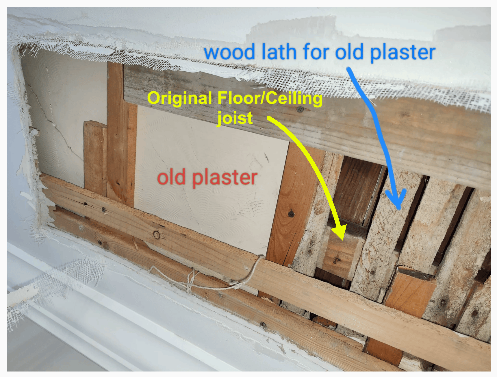

    But the joists .. the real joists are above the old plaster, the real joists are not visible when they framed the new joists that serve as the mounting base for the new sheetrock.
    From top to down:
    Old joists - wood lath -plaster - new joists - sheetrock
    The new joists could as well be fastened to the wood lath through the plaster, correct?
    That's why I have pushed back cutting away the lath and plaster. Want to understand the structure fully before doing.

    Good grief. I wish renovators wouldn't do that sort of thing. Without carefully examining the entire structure, you honestly have no idea what the new joists are held up by. They could well have been just screwed into the old lathe — which would hold things up, after a fashion for a while… but won't take any additional load. Or there is a chance that the new overhead assmbly was properly designed an build as, basically, a whole new ceiling not really connected to the old one at all. You have more investigation to do…
    If it were mine I might well take the entire new ceiling down and repair the old plaster as needed… but that's me.

    I think someone may have added stringers to mount the new sheet rock over the plaster ceiling…
    …and at least one of the support screws missed the joist @Jamie Hall.
    It's so easy to repair old plaster… sigh.
