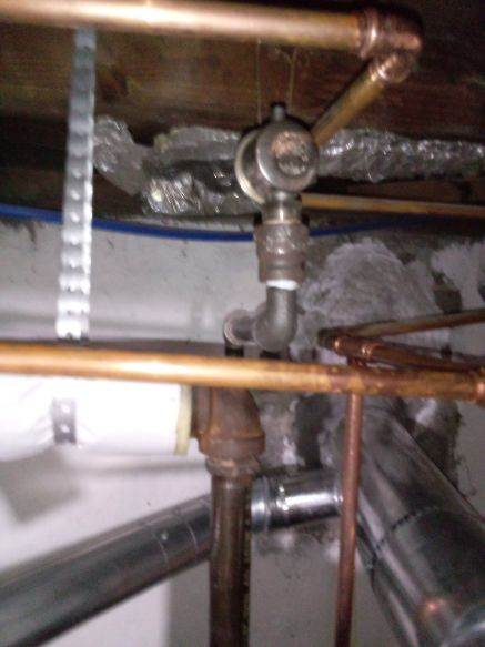

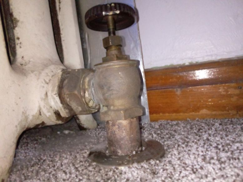

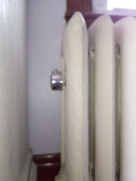

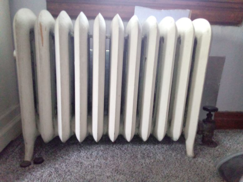

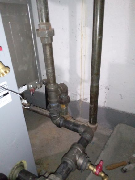

Radiator only heats first 3-4 fins. Vent is MOM with size venting removed. During heating vent puffs. Valve is frozen I believe in open position. Tried WD40, no movement. If you notice the radiator is connected at top with no steam path. The pitch is minimally away from valve. My guess is clog, probably requiring flush in off season. There is a wooden cover which I removed to get improved heat, which worked, but not at ideal level.

    What happens if you remove the vent ?

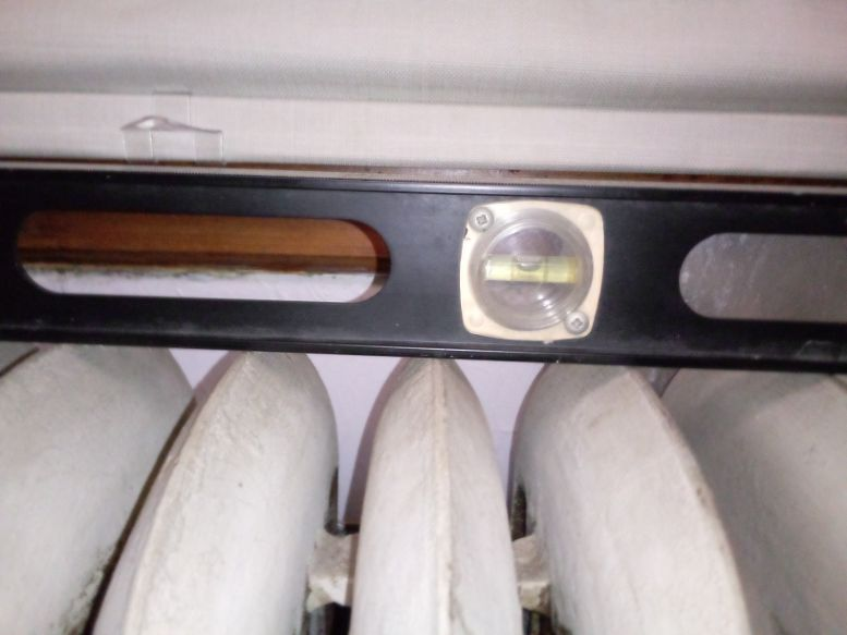

    You might have too much tilt in light of what you mentioned, that the steam has to pass through the bottom section where the condensate can pool up, especially if the supply valve has failed and isn't allowing full passage. I've disassembled the upper bonnet and checked some of mine. I even removed the gate on one that needed all the help it could get; a very small radiator in an upstairs bathroom with some poorly pitched piping.

    A puffing vent is a classic sign of water pooling somewhere in the piping to that radiator, probably due to an incorrectly pitched pipe. Buildings settle and structural materials deflect over time.

    oved vent 10 min ago, temp is 3, windchill -13. 4th fin got hotter. Still puffing.

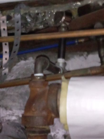

    Fizz, is this a 1st floor radiator where you can go down in the basement and get an idea of the pitch of the takeoff from the main that could tell the whole story? If it is not 1st floor it still won't tell you about the pitch of the pipe within that floor/wall by the radiator though. You could try raising the radiator up a bit to see if you can get more pitch. One way to do that might be to disconnect it first and see if the supply valve can be raised and how much. Then raise the radiator by that amount one end at a time and reconnect, or try raising without disconnecting but you won't have a good feel for anything.
    Also, panting can also correspond with a surging waterline in the boiler which you can see in the sightglass, in additon to pooled water in the pipes. The pooled water is more likely your problem. 1/4 in. of pitch per foot would be good. You don't hear any water chugging type sounds as the radiator attempts to get filled, just panting?

    The pitch of the supply pipe is very important
    The pitch of the radiator is not important

    The pitch of the main is good. I agree, the pitch of radiator is not so important, unless extreme, which is not the case. If you see my earlier posts of poorly pitched pipe you can see that the feed to this radiator which is on the 1st floor begins about a foot after feed to it.

    Not real clear what you are saying. Are you saying the supply pipe to this 1st floor radiator is only 1 foot long and has plenty of downward pitch back towards the main?

    Two mains run from boiler, one to front and one to back(Cape Cod)with each having 4 radiators attached. The back has 3 down and one upstairs(end of run). All work well. The one going to front has 2 up and 2 down. visualize the boiler centered on left side of house, the main going to back runs 12' to back feed which runs about 30' to end of run. The main to front runs about 15' to feed line which runs 30' to left end feeding 2 radiators on 1st floor(the 2nd one is problem one) and one on 2nd floor(end of feed). The 4th radiator is on the 2nd floor which is fed by a 2' feed to right of 15' feed. They all work well but trouble one.

    Boiler off……… Open up the radiator shut off and pour water down it …Wrench off the top valve bonnet .. Best way to find the problem …. Problem is there if the other rads are heating fine…

    I believe he meant that when you remove the bonnet from the input valve, you will pour the water in there and see if it will back up or flow out into the main.

    If water runs out then the piping leading to the radiator isn't pitched the wrong way. If it accumulates and doesn't run out then there is a pitch problem and/or a low spot in the piping between the radiator and the main. This wouldn't rule out a rare but possible clog in the radiator itself, or other weird problems like underpowered boiler causing balancing issues etc..

    Whoa.. If the radiator heats the first two or three fins, steam is getting to it. No blockage. But if it only heats that far, air isn't getting out of it.
    Before you try paying games with the valve — which can cause problems — try this: with someone at the boiler and in communication with you (cell phones are handy!), take the vent off completely — it should unthread without too much hassle — and fire up the boiler and see what happens. Be prepared to shut off the boiler, as if it is a vent prooblem, you may get steam coming out of the hole and that can burn!

    maybe the vent is too fast for the rad and pressure, and the steam is rushing across to the vent and closing it before the rad can fill completely,

    I've had air vent completely out with boiler running(0 degree temp outside), no change. Cold air comes out hole. It's a mystery.

    As to air rushing across top, not possible, there is no passage up top.

    I would also try @Big Ed_4 's suggestion of disassembling the valve and seeing if there's a partial blockage in it.

    did you compare the connected edr to the boiler size? did you clock the meter if it is natural gas? this could be one of the rare instances where the boiler is a little undersized and you are going to have to slow the fast radiators way down to get this radiator to heat
    could be mains that don't connect individually to the header so the steam prefers one over the other too in addition to trapped water.

    you need to get the mains balanced to have any hope of balancing the rest of the system. either the lengths /sizes of the mains are different or you have trapped water in the slow main or both.
  • Fizz
    Fizz Posts: 580
    The length and size are the same. Attached radiation is about 35sf difference.
    also could be an issue with the near boiler piping, that can also make the mains unbalanced.

    here's the latest on problem rad. As stated earlier, I increased venting on upstairs rad, and partially taped fastest heating rad downstairs. Results are problem rad is heating at 5th fin and as quickly as reduced vent rad. The upstairs is now quickest heating. I believe Jamie was correct, that radiator is not the problem, also, I don't think there's puddling in the main since rad in question is 16 or so feet from other downstairs rad, and there's no hammering, also, the last rad at end of line upstairs works fine. I don't think there'll ever be balance in the mains. The vents in mains are at end of returns which drop 90 degrees. I've used bigmouths and Gorton#2's without improvement or speeding steam to returns. Currently have MOM#1 on one and Gorton#1 on other. Tried all combo's with same results. As it stands now, I'm satisfied wiith these results. Will know better as cold ramps up again.
