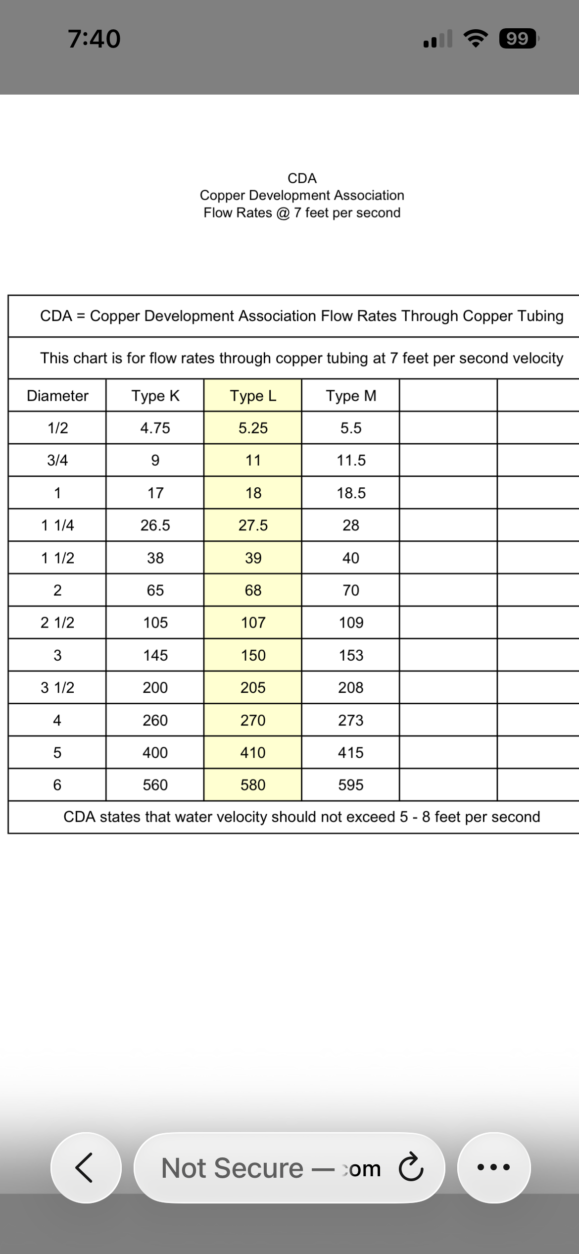

    i think you need a really high flow to pressure purge a diverter tee system. I doubt you can get enough flow thru a fill valve, even in fast fill mode.
    If you have a 1/2” bypass around the fill valve you can get around 10 gpm if you have at least 50psi in the building.
    To move air and heavy particles well you need to get over 5 fps velocity. A 1/2 hp pump cart gets you 8 gpm or so with washer hoses. With 3/4” washer hoses you can get 10 gpm.
    The Caleffi pump cart jumped from 8 gpm to almost 12 gpm by increasing from standard 1/2” washer hoses to full 3/4 hoses
    This CDA chart shows that you need 11.5 gpm to get velocity of 7 fps in 3/4 M copper.
    A short garden hose connected to your house pressure should get you close.
    i made hose with 3/4' hardware store vinyl tubing and 3/4 hose barb to garden hose thread adapters.
