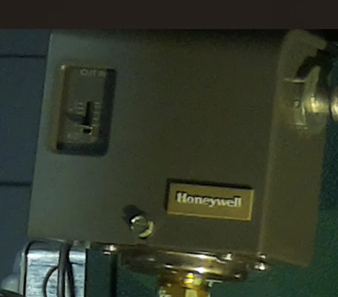

    I wanted to thank everyone for their input, especially the detailed information that @EdTheHeaterMan provided.
    My system has some version of the Honeywell Pressuretrol PA404, but I've not been able to dig to find the exact model. Photo:
    It also has a a 'Cycleguard' low water cut off system.
    I set up a camera to follow the system during a recovery and get some timing.
    From a fairly cool start, it takes about 6 minutes from when the thermostat calls for heat until the pressure gauge just twitches, and 19 minutes from the cold start to the first pressure cut-off (with one LWCO cycle in that period).
    When I watch the sight glass first the water level rises and then falls after the system starts firing; is this fall an reasonable indication that the boiler is 'making steam'? If so, then it is about 1.5 minutes from first fire to first steam.
    Once the system is firing in steady state, the pressure fluctuates (by the pressure gauge) between 2.3 and 4 psi. In steady state it takes about 115 seconds for the pressure to climb and 105 seconds for the pressure to fall, so once the system is in steady state the burner is running a bit more than half the time.
    On the thermostat cycling, it looks like I have some room for adjustment; right now the temperature swings 2-3 degrees, and heating cycles are 1.5-2 hours apart. So I can improve that by tightening the deadband of the thermostat.
    The flue has a new stainless liner if that makes a difference for suggested adjustments.

    If you could get your cutout pressure down your whole system would be happier… There is a screw on the top of your pressuretrol which is used to adjust the cutin. Turn that screw so that the cutin pressure — the metal bar on the scale — is just above the lowest marking (0.5 pounds).
  • dabrakeman
    dabrakeman Posts: 1,038
    Yes I would tighten that deadband and adjust down the pressuretrol. If you are doing recoveries then I might suggest that you try breaking those up and if it is very cold outside even eliminating them.
