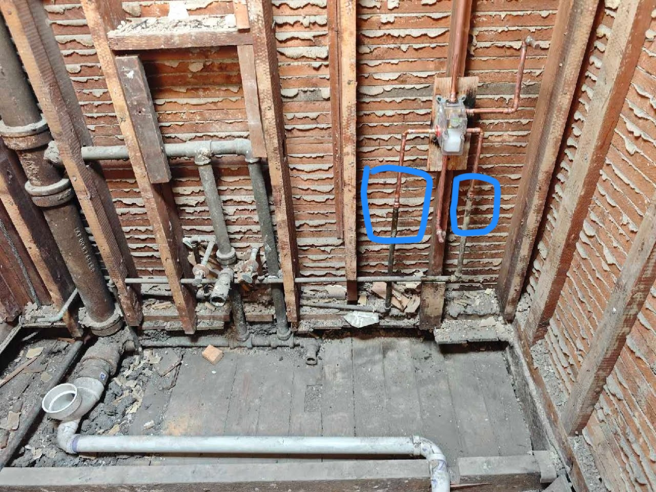

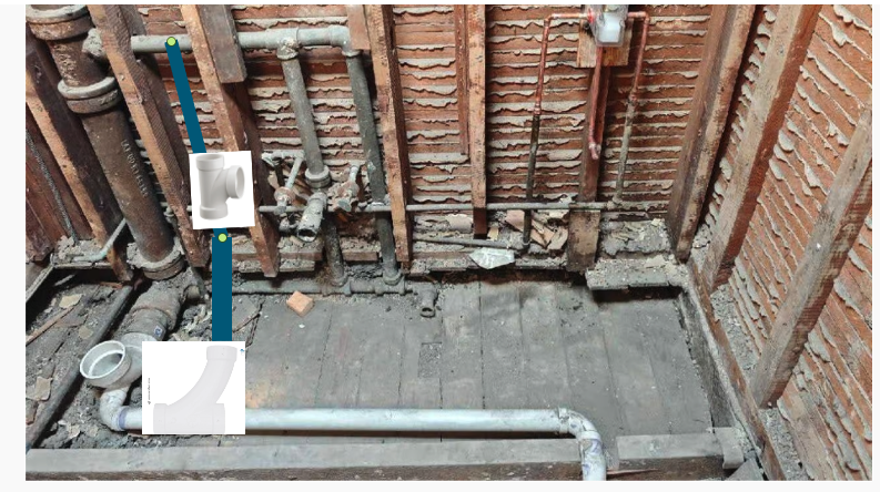

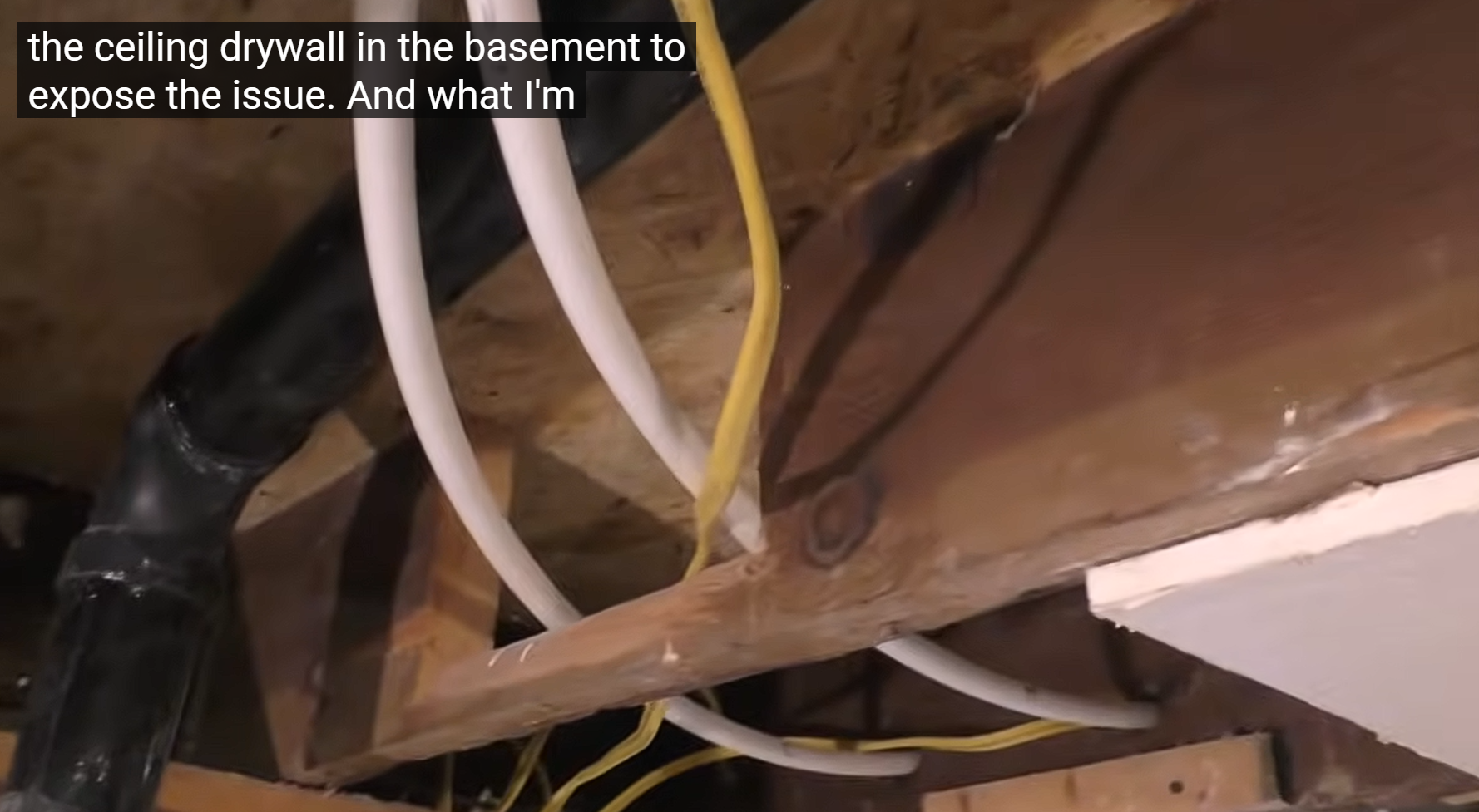

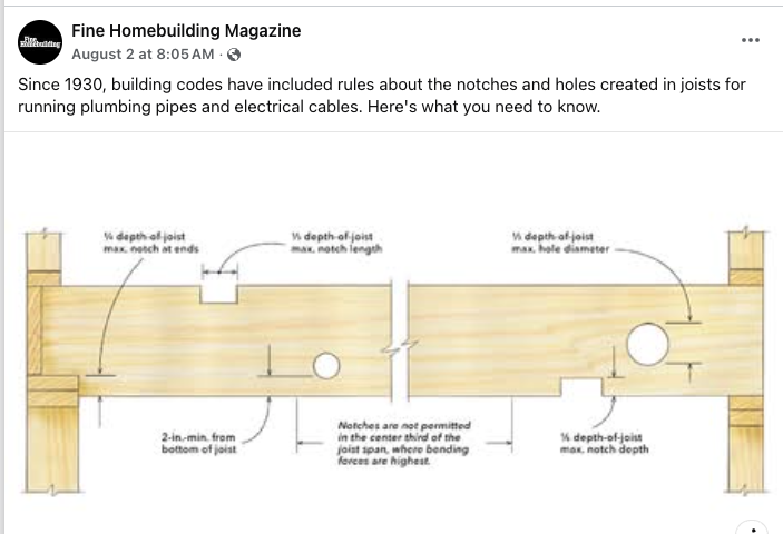

    It is acceptable to notch the top of a joist following the rules. But that notch with the pex is way beyond legal, or safe,
    The top of a joist is under a compression load, the bottom under tension.
    A piece of 1/8" thick x6" steel with another 2x6 against that makes for a strong repair. Sandwich the steel between the wood. Better than just another joist against the notched one.
    You have room above that notch to do a repair with a steel plate.
    The steel when pinched between two joists adds a lot of strength.

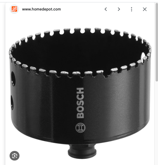

    Never Notch.
    Hole saw only. Even a little wood on top or bottom is better than none.
    Nothing about that job is going to be easy!

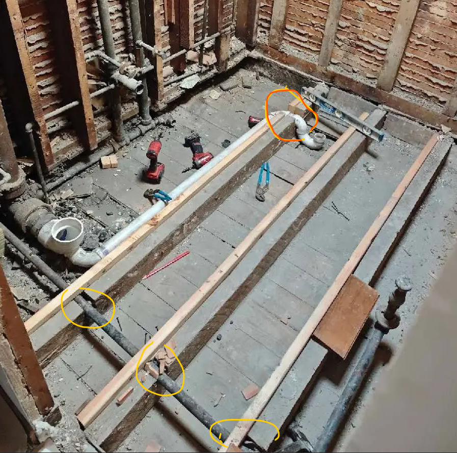

    How long should the steel and 2x6 extend on either side of the notch?

    A 2 x 6 is only 5 1/2" wide. If you run 1 1/2" through it you need a 2" hole. 5 1/2"-2"=3 1/2 divided by 2= 1 1/4" on each side of the hole. That's not very good.
    What about sistering up the joists with 2 x8s or 2 x 10s? You would have a step up going into the bathroom of either 1 3/4" with the 2 x 8s or 3 3/4" with the 2 x 10s.
    That would allow room for the plumbing and cutting holes or notches.

    "Is the new notch a concern? Should I open the floor, move the shower drain over to the left joist bay, and glass the notch?"
    The notch is already done. The structural support of that horizontal joist is no longer as strong as it was before the notch. Glassing that notch over will not add the structural support that the joist had before the cut. So, opening the floor at one small section to move that shower drain and adding some glass to that notch will not solve the problem—if there even is a problem.
    Now that the notch is there, live with it. If you find that you develop the problems that everyone has mentioned, then you will need to deal with them at that point. Is it easier to fix from the ceiling of the floor below, or is it easier to fix from the floor of the bathroom? You will need to expose the entire joist from one support to the other in order to replace that joist with one that will not have a notch in it.

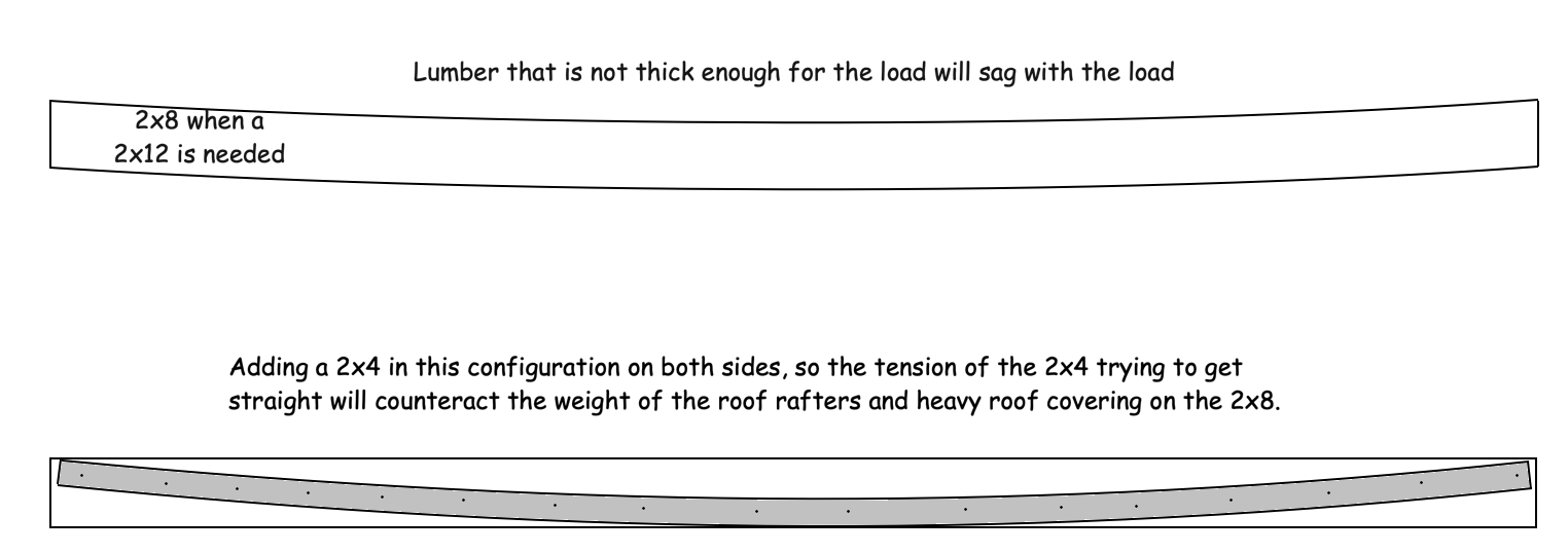

    I remember seeing a home with a terracotta roof (now that is some heavy material) where the top beam that held all the peaks of the rafters was not sufficient for the load by design. To compensate for the narrower piece of lumber, the builder used an old shipbuilder's trick illustrated below:

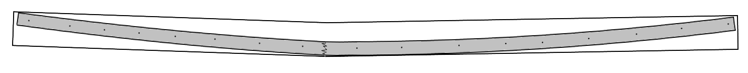

    This was in the attic of a 50+ year old home, where there were 4 identical roof lines (a cross gable roof). They were in the same attic and three of them were perfectly level using this design. The fourth one had a sag as a result of the 2x4 that was supplying tension had failed somewhere in the middle. and this is what it looked like:
    That experience has helped me get things to work, fit, plumb, or level in more than one situation over my lifetime of getting stuff done.
    You may find that you can't get the floor tile to stop cracking in a few years. If that happens, opening up the ceiling below and using this method to get that compromised support back to level may help.
    Or you can try it now.

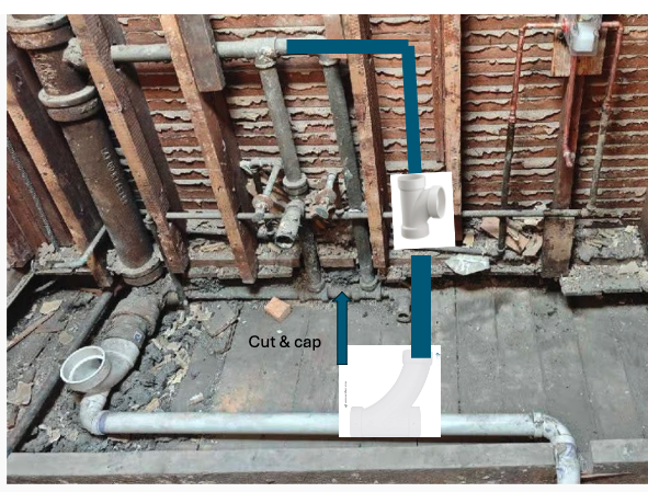

    If the shower drain is relocated, the pipe no longer go through that joist

    They allow minor notching because they expect flooring to be nailed / screwed across that notch. I'm sure it's also allowed because code also assumes the framing is done correctly and technically has a lot of fudge factor baked into it.
    Of course, a notch also doesn't mean a 4" x 6" opening in a 2x8.
    Sadly, certain trade(s) are known for hacking huge chunks of joists and even just cutting them off and leaving them hanging. We've had at least one person on this forum admitting to knocking out crossbracing because "It doesn't matter" and then arguing that everyone else is wrong.

    Back in the day of diagonal strip subfloor, I don’t know the strips added much integrity to a notch?
    Bottom line, avoid the notches, follow code guideline if it is unavoidable.

    If possible I would get the steel over the bearing point on one end, past the notch a few feet. No harm in going the entire length.
    This is not an engineered solution!
    More of a common sense solution in that steel plate on edge, if supported from deflecting (in the sandwich) is a strong upgrade.
    An engineer would look at span, joist dimension, type of wood, floor load to give a more exact calculation and fix.
