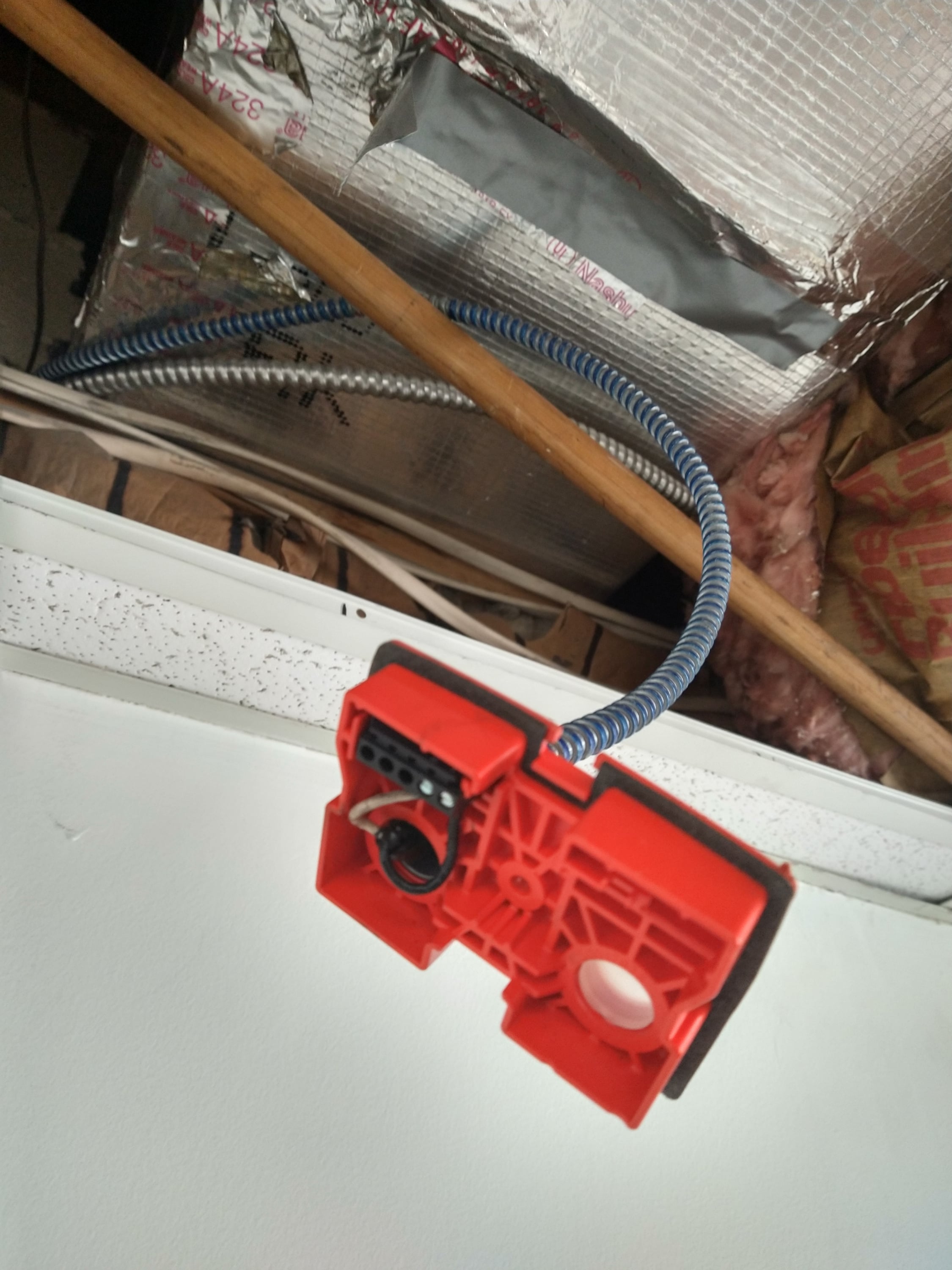

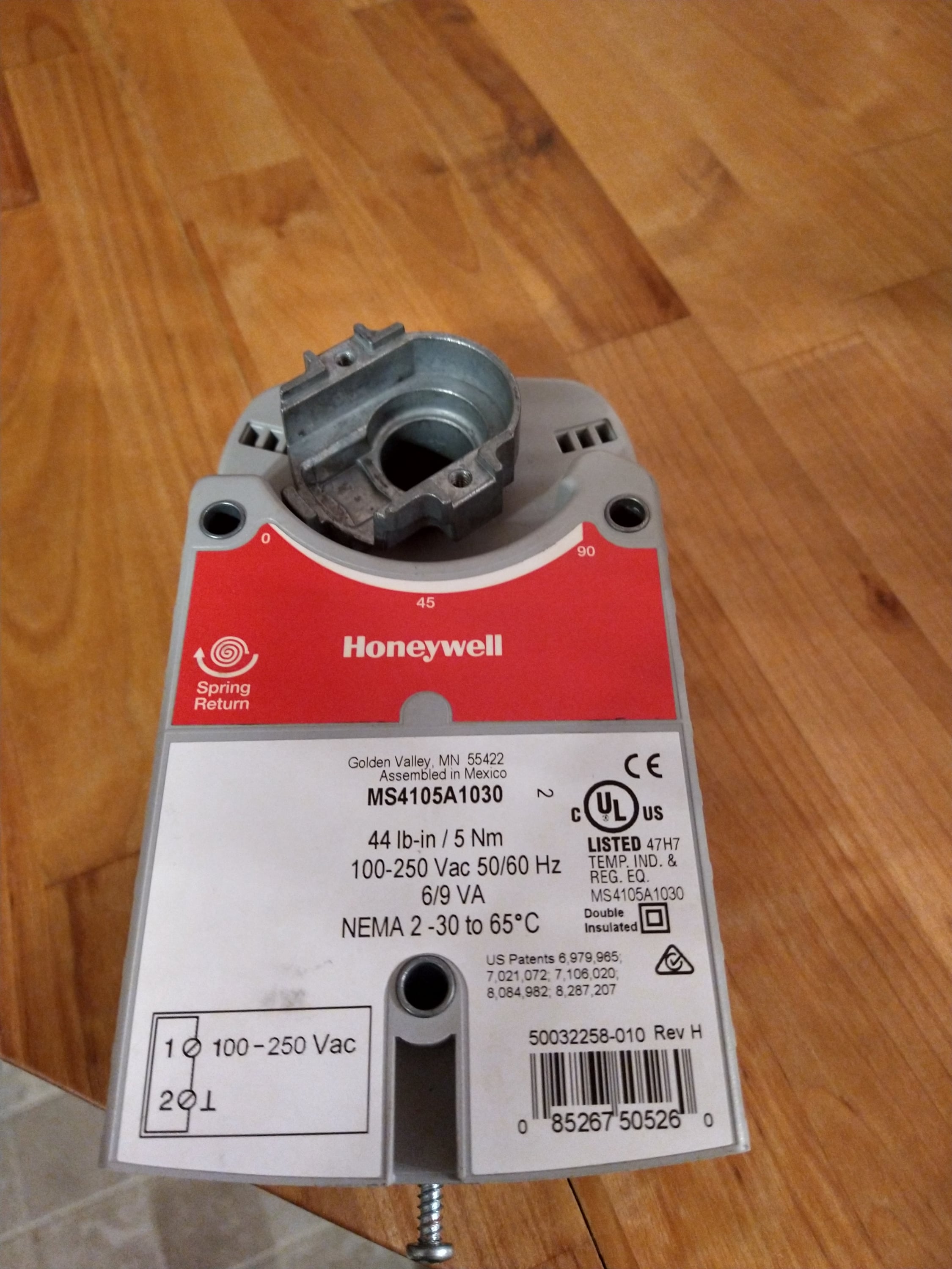

Our church facility uses forced hot air for two zones, we have had problems in the past with the damper controls and they just get replaced.
This one on the second zone is stuck shut and does not respond when the thermostat calls and instead the hot air just dead heads against the damper and some overflows into the other zone. Is this damper repairable? If not, is the replacement as simple as the removal and install of a new one of the same make model? Our service company is very busy with frozen pipes and all the common things this time of year so we'd like to make it easier and just do the replacement ourselves.
I'm reasonably mechanical and technically inclined and it seems to me that a swap is straight forward but I don't want to assume too much, any advice?

    Shut off the power it should spring open . If it opens it could be the thermostat .. If it stays shut something is jammed ..
    EdTheHeaterMan Member Posts: 12,534
    Looks like a line voltage motor and it has a spring return that appears to be in the (ZERO) 0 % or closed position. Dors the motor open when power is applied? If yes, then the actual damper may be stuck. Can you adjust the actual damper by hand? You may be able to operate the system manually until you get the motor working.

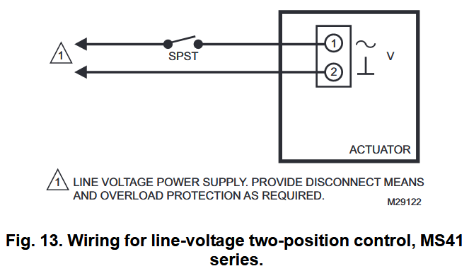

    Looks like it would be fairly easy to independently test. Make sure it is the problem. Is it under any warranty ?
    https://s3.amazonaws.com/s3.supplyhouse.com/product_files/MS4105A1030-Install.pdf

    Does the damper move freely now that the actuator is out? Do you know if the problem is the actuator or the linkage?
    If you were to order a new damper complete, when you order it, the second measurement is the side the actuator is on. Example, if the duct is 24x36 and the actuator is on the 24, you order the damper as 36x24.

    Thanks everyone, yes actual duct damper is movable by hand. I'll verify power and then plug it in and see if maybe it isn't receiving power when the thermostat calls

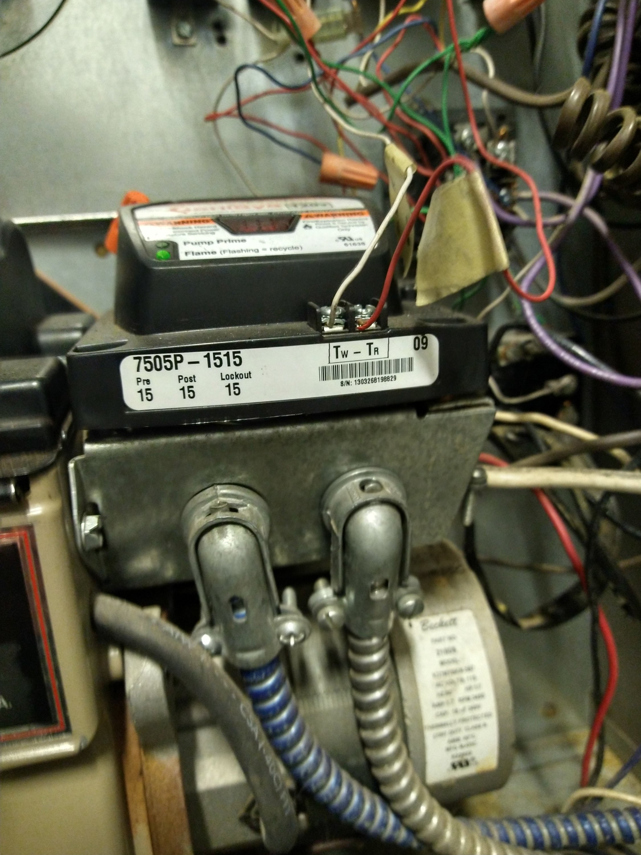

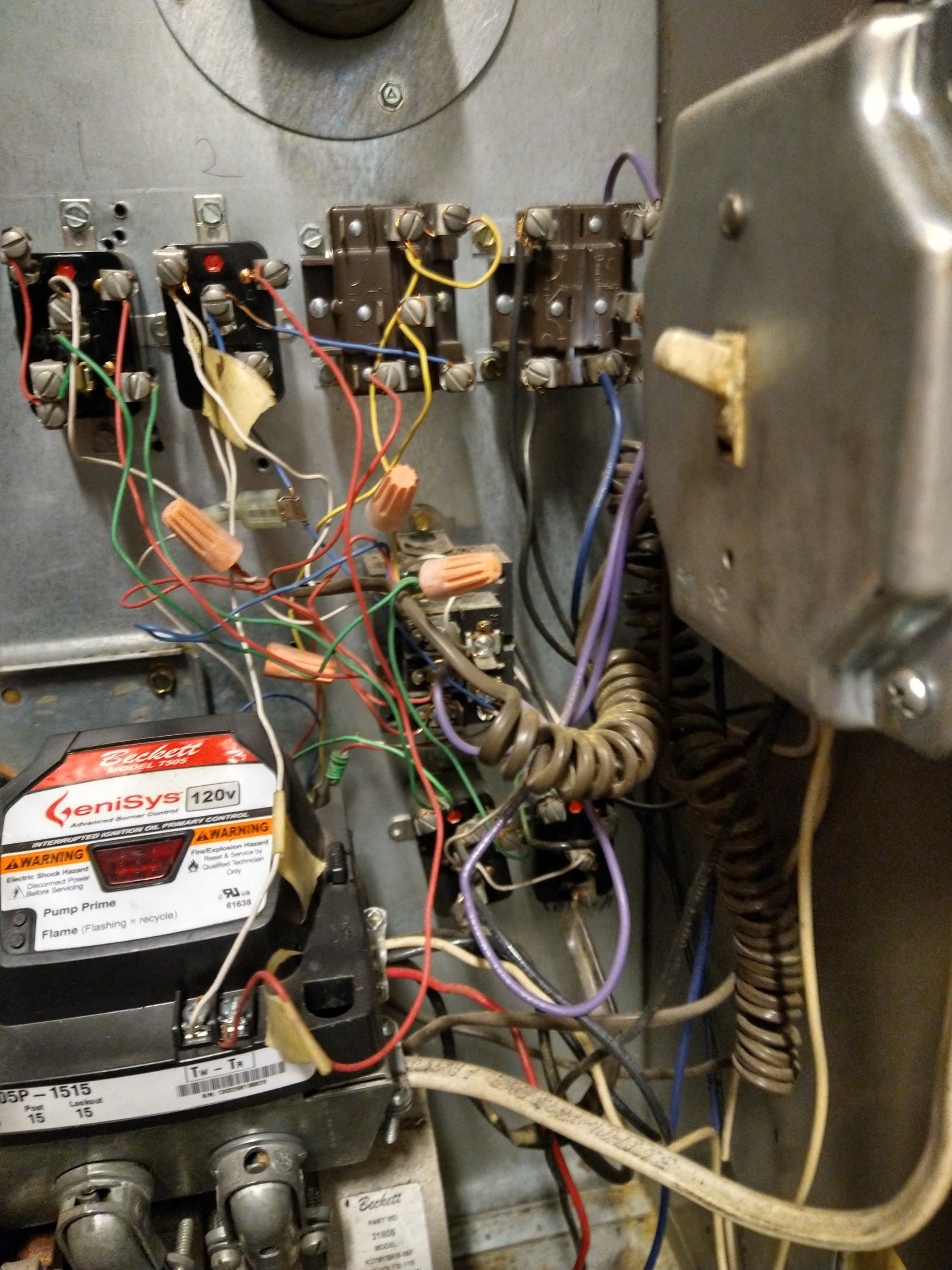

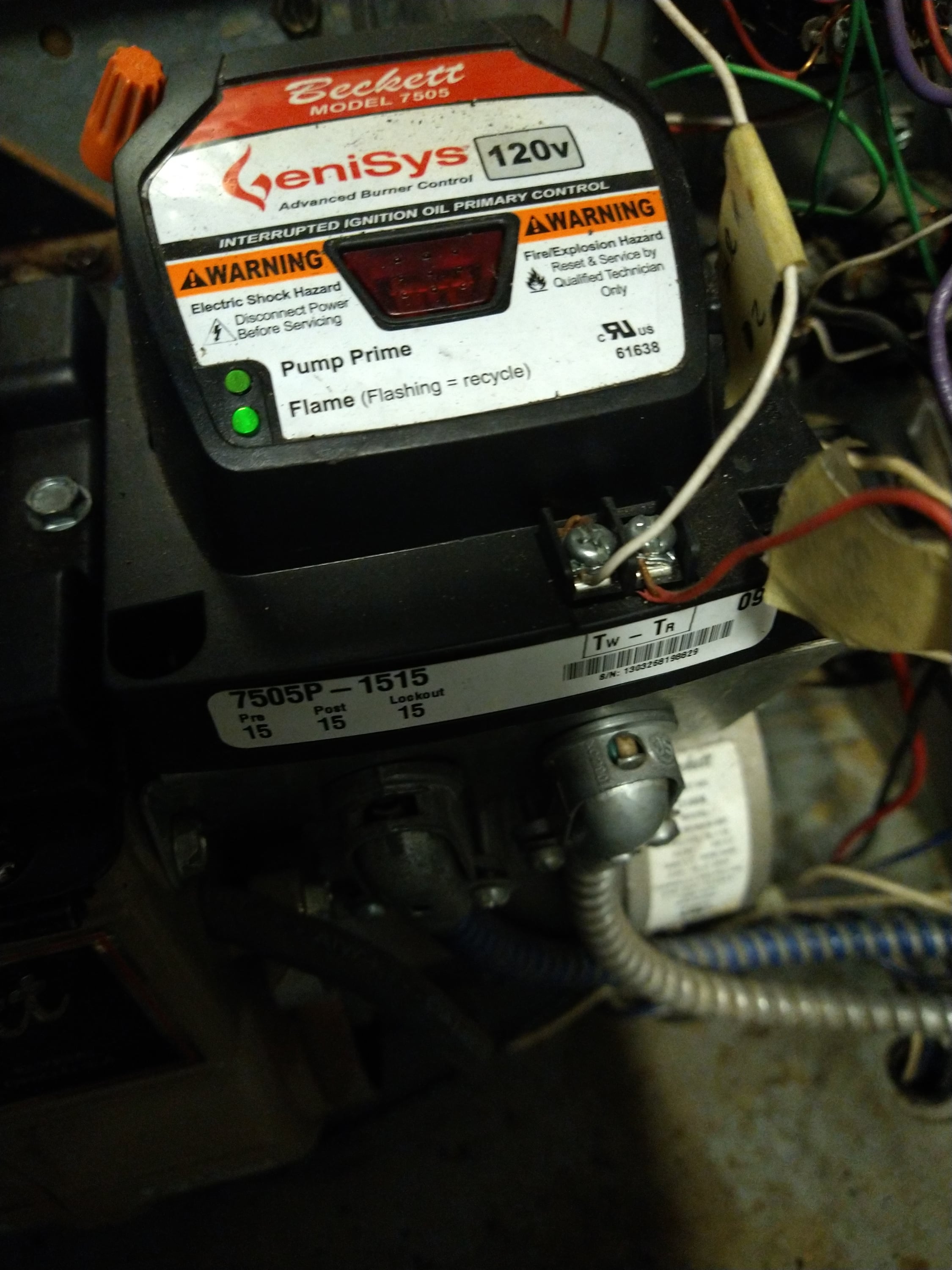

    I took the access panel off the burner control where the BX cable goes in and there's a mess of wires there, I'll take a picture tomorrow but it appears they are using the t t end switch terminals. Also a smattering of external relays to activate stuff that looks like it could be simplified with a single controller. More pics tomorrow

    The damper motor wires would be connected to the damper controls , can you post photo of the control used ?

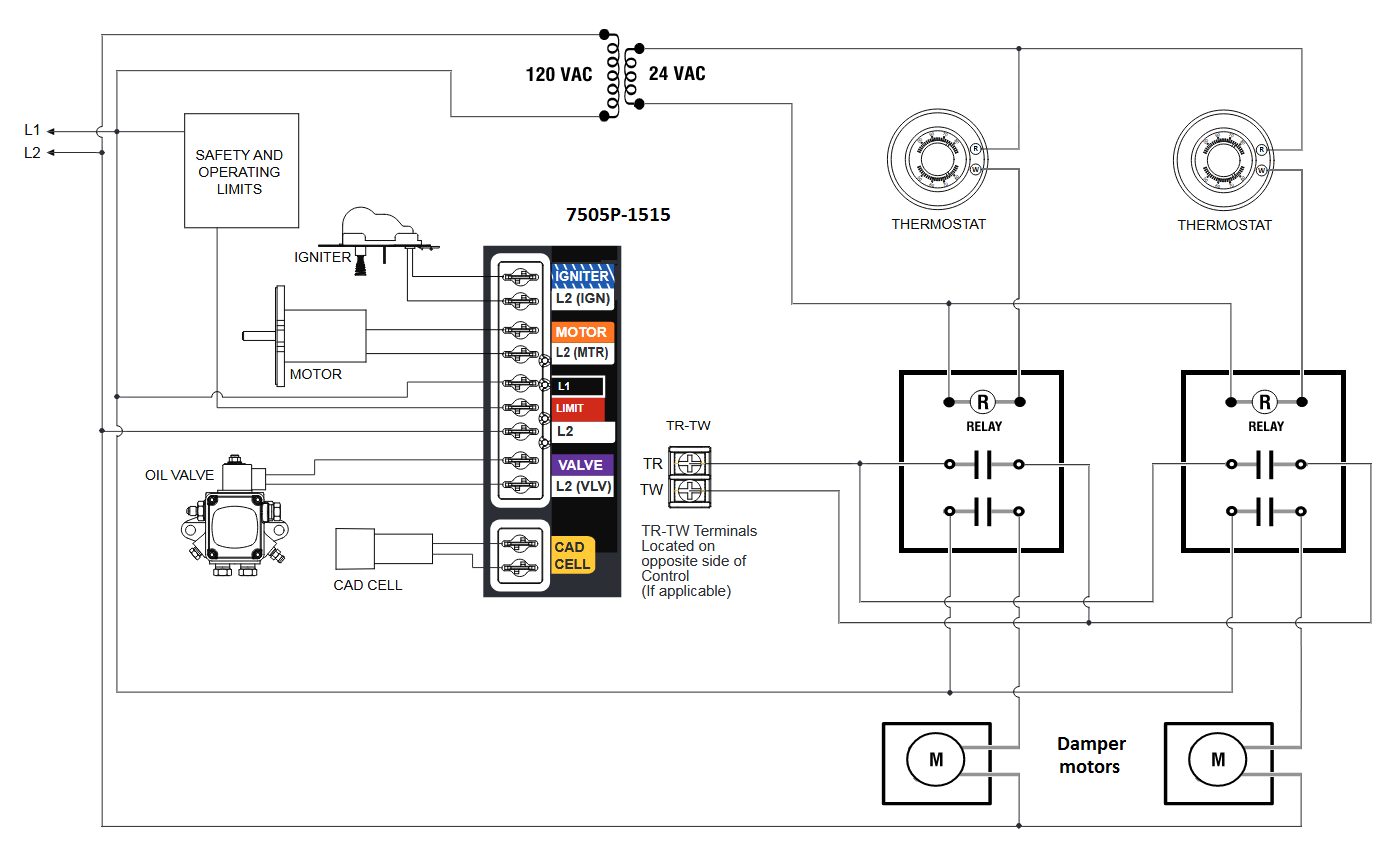

    More pictures of the wiring may help, with a wider view.
    I would suspect two thermostats.
    If no Damper zone control, two relays with DPDT (Double Pole Double Throw) or DPST (Double Pole Single Throw) contacts.
    A set of contacts of each relay are paralleled and connected to the T-T of the burner control. The other set of contacts on each relay sends the power to the appropriate damper motor. No real 'End Switches' are involved.
    The thermostats and the relay coils are probably 24 VAC.
    Since I presume the other zone works OK and the problem zone works OK, except it just does not open the damper due to no power to the damper motor, I would suspect a bad relay or a loose connection at the relay, or a loose connection under a Wire Nut maybe in that junction box.
    I suspect they ran the wires for the Damper motors into the junction box since that was a convenient place to get the 120 VAC to power the Damper motors.
    Neater wiring would make troubleshooting much easier with or without using a Multimeter.
    109A_5 Member Posts: 4,226
    edited February 8
    I suspect it is wired something like this. There could be a blower thermal switch in the mix somewhere also.

    Yes I think that looks pretty close, this system has AC as well and so I think all that wiring found it's way here to.
    Definitely ideal setup. Haha, I should be able to trace wires and find the loose connection or failed relay. The only thing I will need is a suggested replacement, if they are sized the same I will pilfer one used for the AC for the time being but still unsure if they are duplicates.

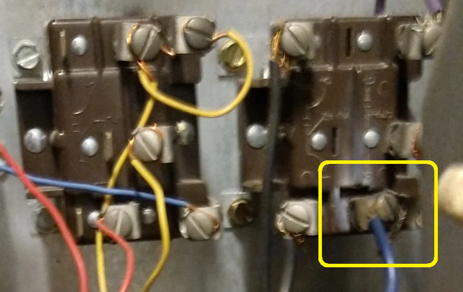

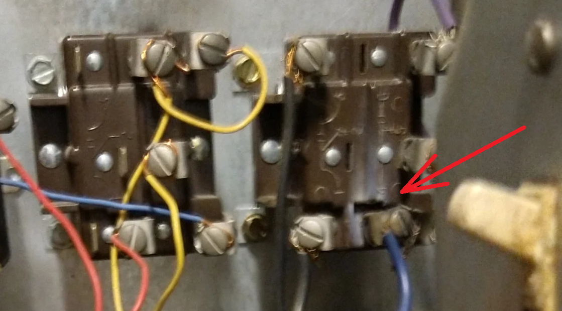

    This does not look very healthy.

    that’s a mess!

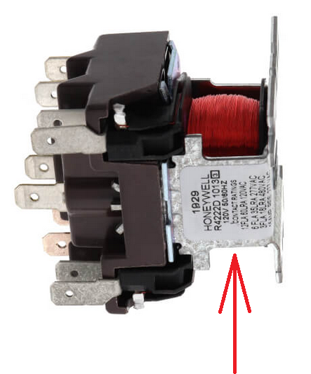

    To help get the correct replacement relay the part number and specifications may be on the side of the Relay's coil frame.

    Also the screw terminal adapter looks like it got hot, so it may need cleaning up and the securing tension to the relay's terminal verified or replacement.

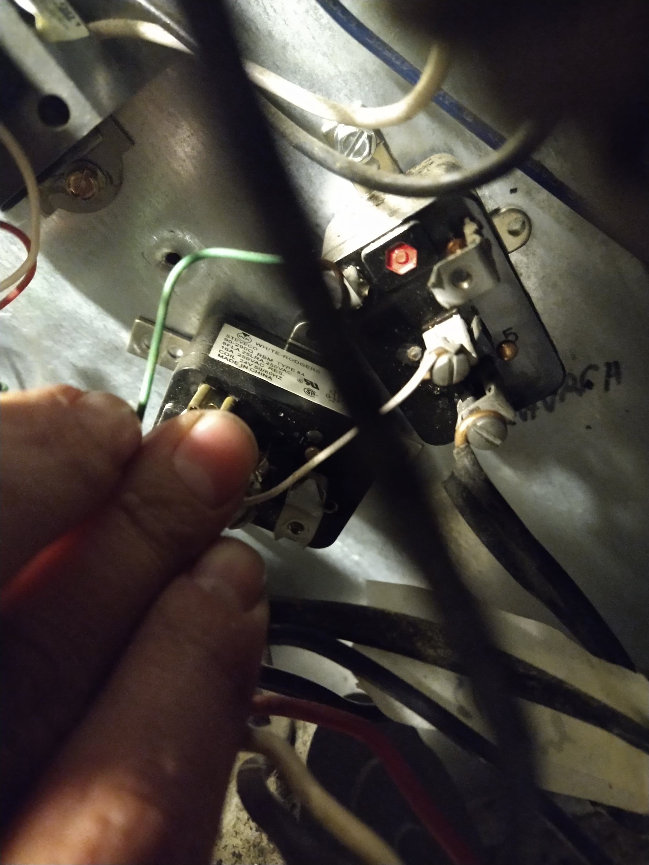

    I found a relay I suspected to be bad, swapped a wire and sure as shooting I got 120v at the wire connection for the suspected damper. So I'm sure at minimum this relay needs replaced.
    I believe this is the replacement https://www.supplyhouse.com/White-Rodgers-90-290Q-Fan-Relay-Type-84-24-VAC-Coil-SPNO-Coil-Data-90-Ohms-DC-Resistance-125-mA-Nominal-3-VA-Nominal-4-VA-Inrush?utm_campaignid=590335651&utm_adgroupid=1228155606737651&utm_targetid=pla-4580359302591893&utm_product_id=90-290Q&utm_matchtype=e&utm_keyword=default&utm_adtype=&utm_adgroup=Power%20Distribution,%20Supplies%20%26%20Transformers_X_X_X&utm_searchquery=white%20rodgers%2090-290q%20relay&utm_category=Electrical&msclkid=136ceeb8560017e1bada8732d6fd1baf
    For this:
    As much as I whine about smart phones it sure is nice to be able to snap a picture and then zoom in to read what the label says. Please advise anyone if I should buy a different relay.
    Something like this may work and there are others. You still may need 2 relays to interface to the 120 VAC Dampers.
    For the present I would just replace the defective relay. Then in much milder weather when you don't need Heat or A/C dig into it then. In the mean time do the compatibility / feature research for unit you desire with your system.
