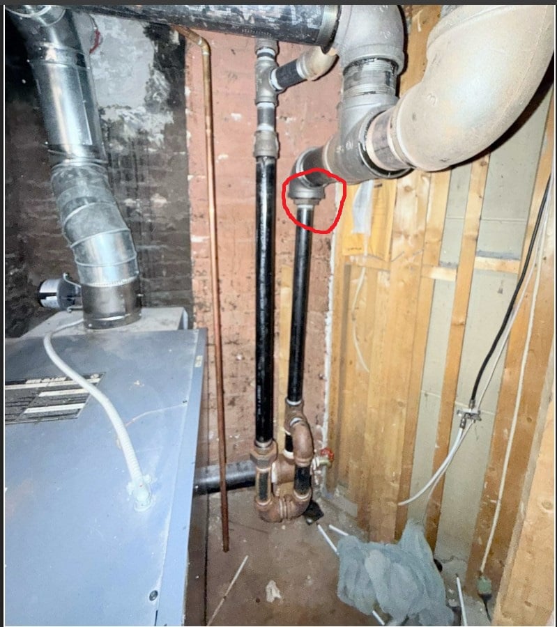

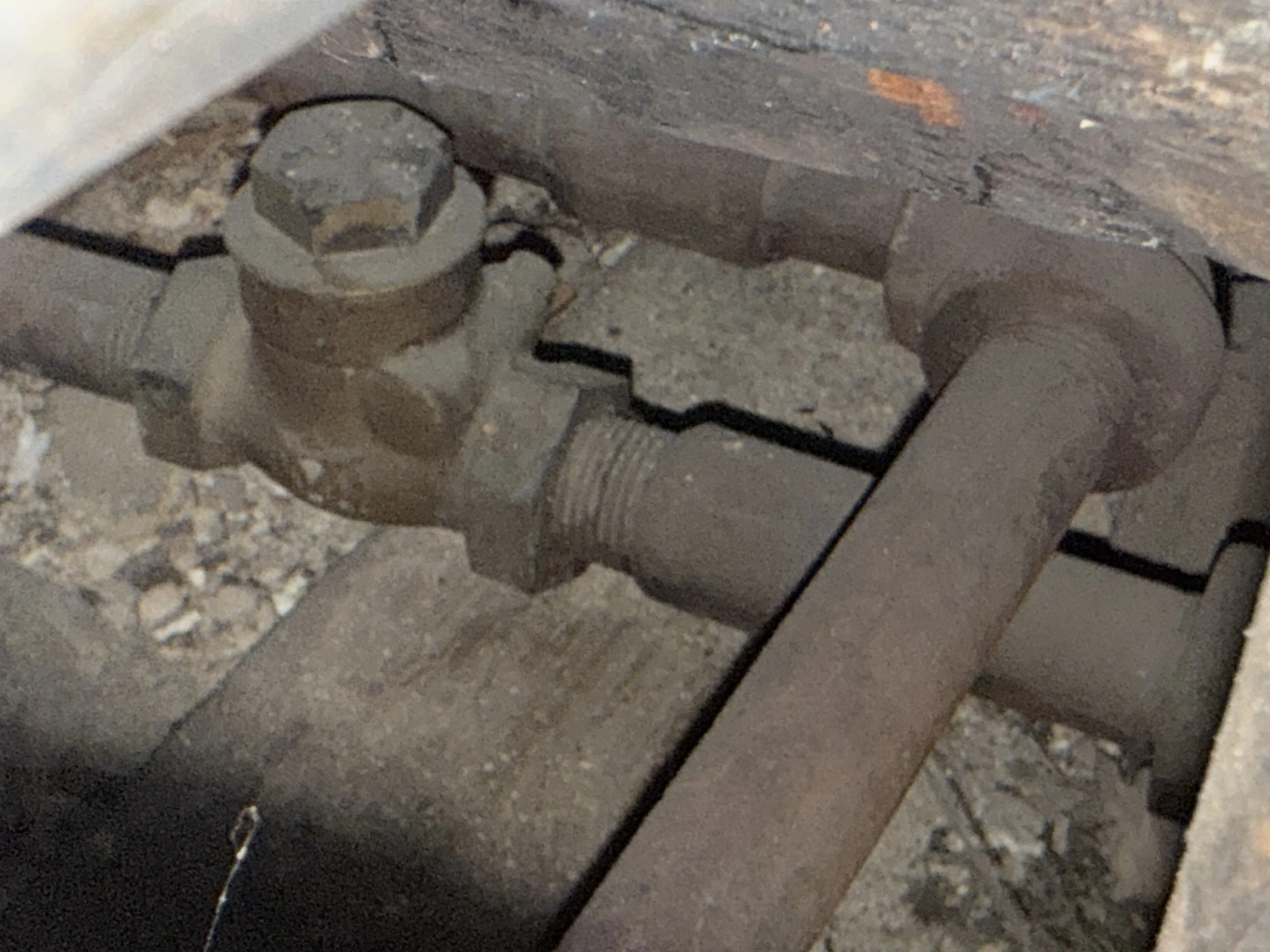

Home built in 1900. I’ve had near boiler piping repiped, but it still bangs tremendously. It is: two pipe, gravity return, no traps, I have found check valves at the returns of the radiators underneath floor boards, one main vent in basement (Hoffman 75H), boiler running .5 psi, each radiator has one Hoffman 1A vent. The boiler is toward the front of the house. Banging is only toward the rear of the house with the longer main. The shorter main has no banging. Shorter main is 15ft, longer is 40ft. There is clicking at the radiators and the banging from the longer main comes up through the pipes. Banging is at the beginning of the cycle. All radiators properly pitched. I have not found any traps or other vents. 15ft main return pipe mostly stays cool except for the pipe closer to the boiler. Long return pipe with Hoffman 75H vent is piping hot and I think that is the issue. What can I do to stop the banging? Water line to wet return is 5”, water line to main vent is 58”, water line to headers is 45”.

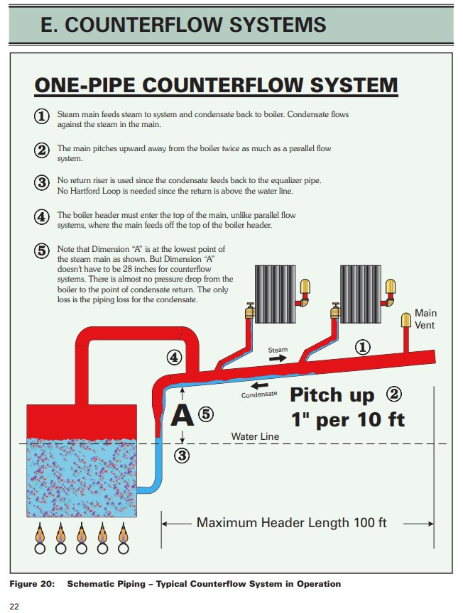

    I think we need a couple more photos from different angles. That's a mess (sorry). So it is counterflow mains? My understanding is that in a counterflow system, the condensate in the main should flow back into the boiler through the equalizer only and the header should be located higher than the equalizer (your parallel header) and elbow into it from above and before where the two mains tee off of it.

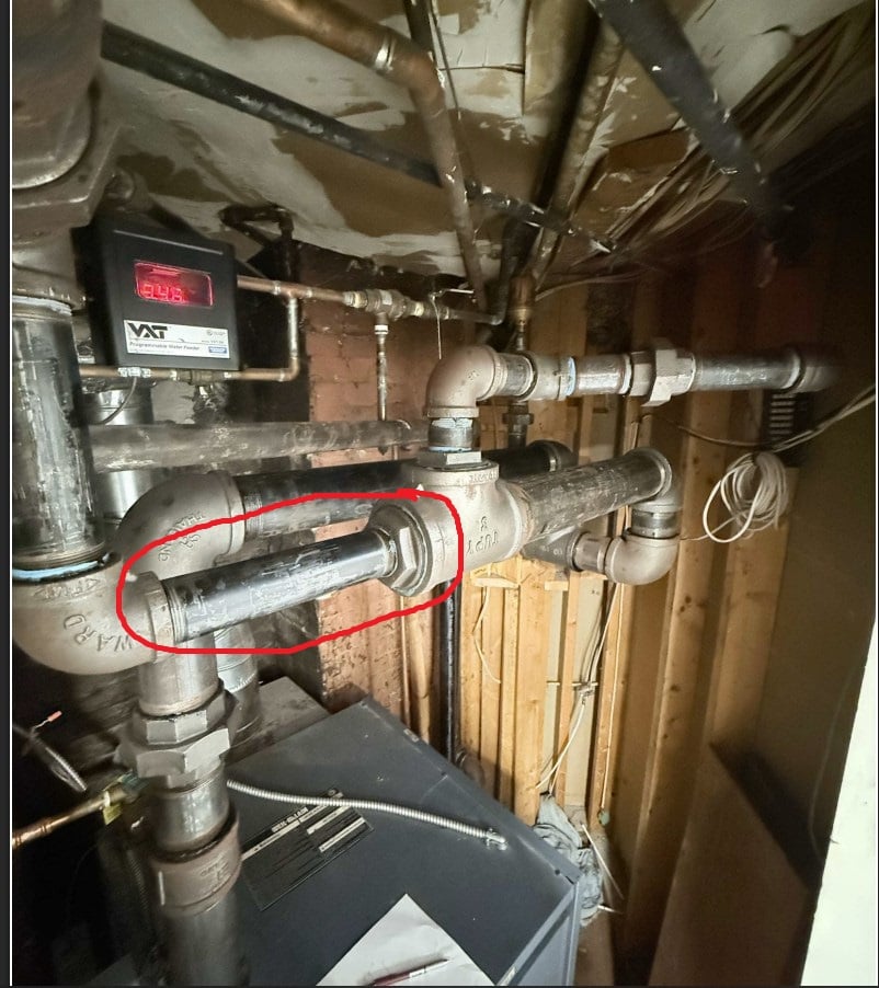

    Somebody really liked bushings (which cause puddles). Hartford tee looks low from that angle. The boiler has a pressuretrol which means when it's under pressure its running at 1.5 psi (lowest possible cutout). Need more pics, and pics of rads.

    Why is this bushed down to such a small diameter from the Tee and then the reducing elbow brings it back up to a larger diameter?

    This, the vertical section of equalizer, should be more like min. of one pipe size smaller instead of being bushed down so small. Seems like in a counterflow main situation this might be all the more critical:
    ethicalpaul Posts: 9,076
    Just trying to narrow things down for the OP instead of widening things out here—the equalizer size is not causing the banging.
    The header sure is weird.

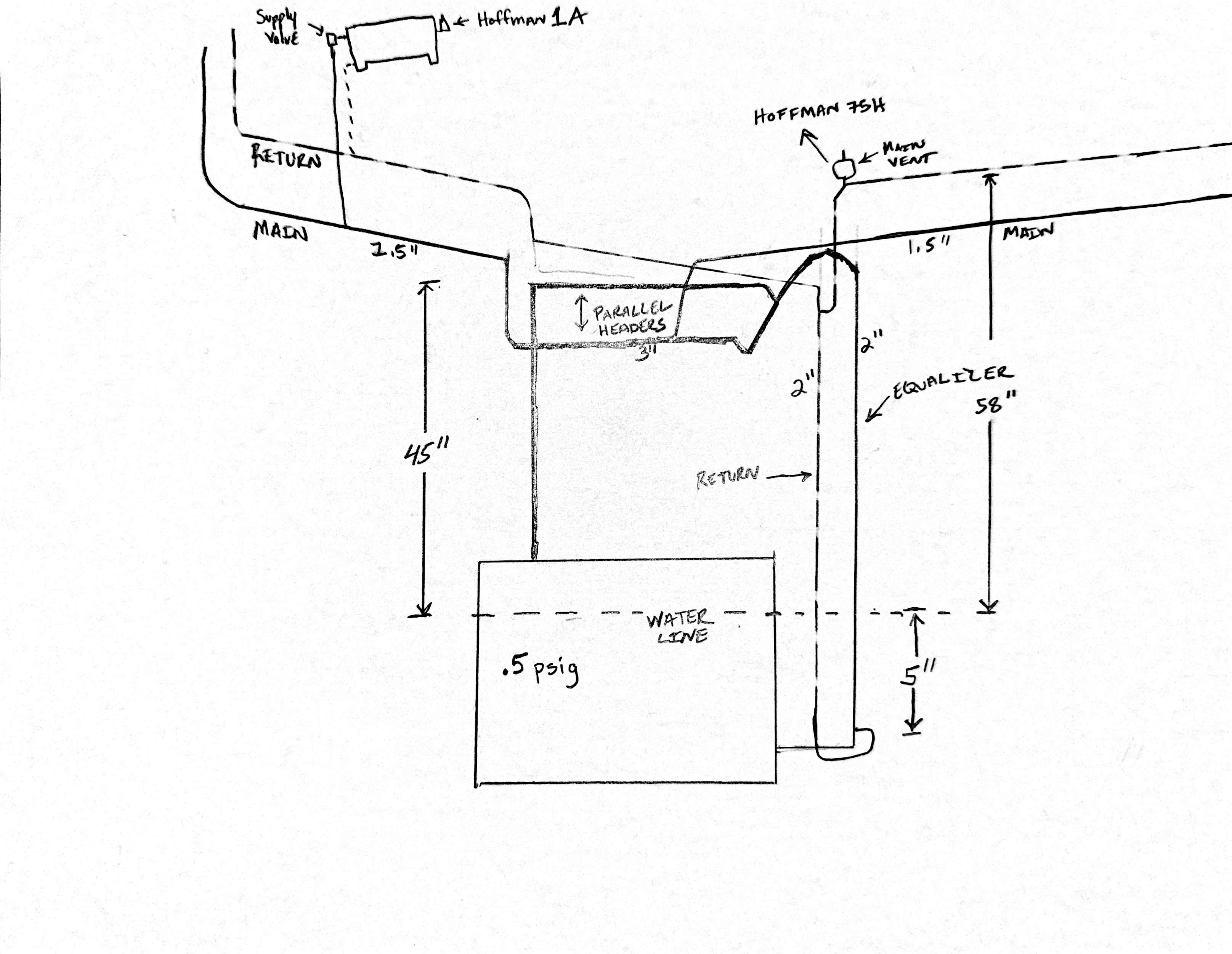

    Above near boiler piping issues were not intended as an all encompassing solution to the problem by any means. We need some more information. Here's a few questions I have. All pipes need to be properly pitched in the system of course, so that there is no pooling of condensate. Wet steam and near boiler piping issues will make things worse but is by no means the main cause of what you are experiencing.
    What is happening at the sight glass when the banging occurs? In other words, is it bouncing up and down dramatically? Has it gone down lower than the initial level and how much has it gone down? What is the exact height of the Hartford Loop close nipple relative to the normal water line? What is your water quality like, ie. is it filled with rust particulates when you drain some from the bottom of the boiler?
    What boiler manufacturer, model, and size do you have?
    header is wrong. i don't think the reducers are a problem but the equalizer should connect after the mains so any carryover returns to the boiler thorugh the equalizer, not gets propelled up in to the main. your equlaizer connects in the opposite direction of the mains.

    @2pipesteam You drew your pen and paper sketch as a counterflow main situation. Is that correct, ie. the pitch of the mains goes downhill towards the boiler?
    What is the pitch of both the first header and what you referred to as the parallel header? If the other parallel header is not pitched downwards towards the equalizer, and you have counterflow, then you are going to have a problem.

    Yes the mains are counterflow and the mains are not connected to the dry returns. There are no drips on the mains. Is it a problem that the return pipes get so hot? So with this setup will the equalizer prevent steam from entering the dry returns? My theory was that steam was entering the dry returns and making them bang around, but the pitch of the mains could easily be a problem as Captain Who and Jamie Hall pointed out. The long main is encased in drywall, but sounds like that could be the culprit. The short dry return towards the front of the house does not get as hot as the long return and does not bang. There is no banging at the near boiler piping, all the banging comes from the long main at about 20 feet from the boiler where it is encased in drywall. There is a slight pitch of the header toward the equalizer. I don't know the reason for the bushings other than to match the diameter of the mains going out. As Mattmia2 pointed out, in the drop header, steam to the main goes in one direction and steam toward the equalizer goes in the opposite direction, can that be done? Won't the steam hit the waterline in the equalizer and stop? Also, I think the carryover will drip into the drop header and drain back towards the equalizer right? All radiators are setup the same way, as attached. Hoffman 1A, gate valve for supply at top, return on the same side at the bottom with radiators pitched toward the return. No traps.
    If the dry returns are getting warmer than warm, steam is getting in them — and that should NEVER happen.
    Possible causes. Failed traps, number one. Excess steam pressure, number two. In your system, where there are no visible traps, my money is on excess steam pressure. Anything over 8 OUNCES per square inch is too much, and half that is better.
    You may need a vapourstat to control your steam pressure.
    You need to find out why and how steam is getting into the dry returns, and fix that. Then go back and work on the banging.

    Just so I'm clear. Both of the parallel headers are pitched downwards towards the header? By how much? For one pipe counterflow it should be 1" per 10 ft. to the equalizer at least for the one with the takeoffs for the mains attached to it.

  • Vaporstat is a great idea. I will check the pitch of the headers, right now they produce no noise. If I have counterflow mains where the mains don’t connect to the return, the system would be trap free right? The Hoffman 1a effectively act as a trap because they stop letting steam into the radiator once the steam hits the last radiator column.
    Now I'm confused. On the one hand, you say there are no traps. On the other, you say there is (are?) steam vents.
    The one radiator in the photograph .pdf above is piped as a two pipe radiator, although a bit oddly — but with a steam vent, which will accomplish exactly nothing, assuming that the return is vented.
    What the vent won't do is stop steam coming in — it will, if the pressure is great enough, go right back out the return pipe.
    Are all the radiators like that?
    Now if they are, and your steam diagram .pdf is correct (further up), you do have a two pipe system. Why someone put vents on is beyond me.
    And I will go back to what I said: get the pressure down. If the return pipe gets steam hot, more drastic work may have to be considered… probably orifices, since the valve at least in the picture is unsuitable for being a metering valve.

    that near boiler piping is not a drop header, it is an abomination of fittings put together to put the pipes together with no understanding of what those pipes needed to do.
    the steam is flowing toward the mains so depending on what the velocity of the steam is, it could be pulling the water wit it and up in to the mains, too much velocity and the water can't get to the equalizer, that is why the equalizer is supposed to be beyond the main connection, not in the opposite direction. since that piping is all pretty small my bet would be on the velocity being enough to prevent the water from running downhill and pulling the water up in to the mains.

    After doing some more digging and rereading the Art of Steam, I think that this is a vapor system given the house was built in the early 1900s. There are check valves (see picture) on the return side underneath the floorboards (not visible from the pictures of the radiator). I think that this is a Donnelly weighted swing check valve. The check valve won't open to discharge condensate into the return until a half-pound of pressure is present in the radiator. Once open, the steam pressure moves into the return piping and combines with the "A" Dimension to put the condensate pack in the boiler. There is a tiny hole to allow air to pass, but only a tiny amount of steam can pass through the tiny hole. Maybe the check valves stopped working so the way they tried to fix it was by adding the Hoffman 1A vents? I have only been able to find one main vent in the basement at the ceiling of the dry return right before it drops down to the boiler. Without a vaporstat, I will continue to get the banging as the system was design to use just ounces. Is there anything else I should add with the vaporstat? Also, if it is a donnelly system, should it have a lever handle valve sized to allow only 80% the amount of steam that the radiator can handle? At the same time the system was repiped, all new gate valves were installed at each radiator. Is this a situation where I should consider removing the check valves and installing traps?
    If I crank down the pressure even more, won't that increase the velocity and run the risk of putting more water in the mains?

  • The system heats the house very well. The return pipes get hot with the radiator, but I think the check valves should stop the steam there. So sounds like I need to buy appropriately sized handle valves?
