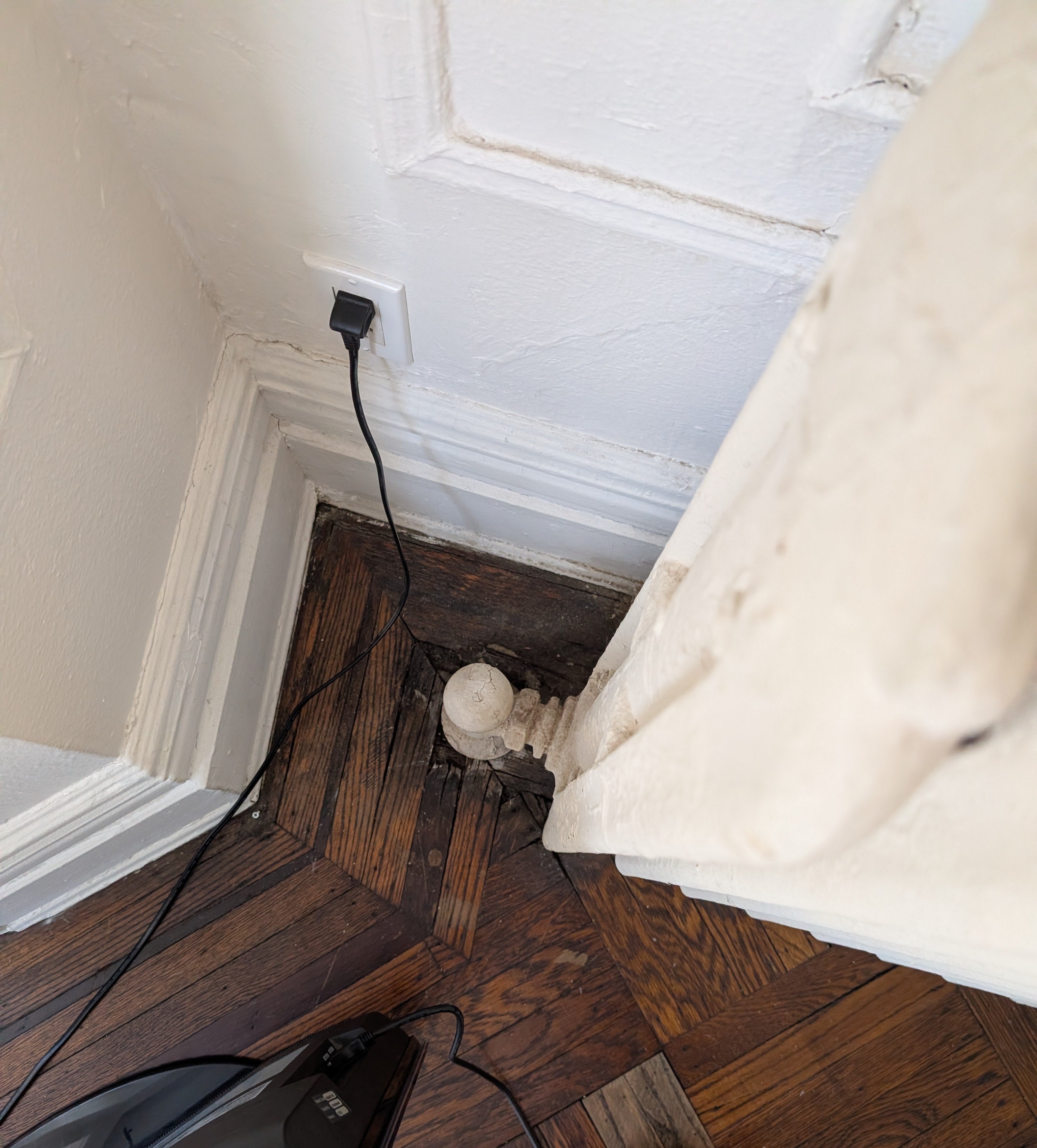

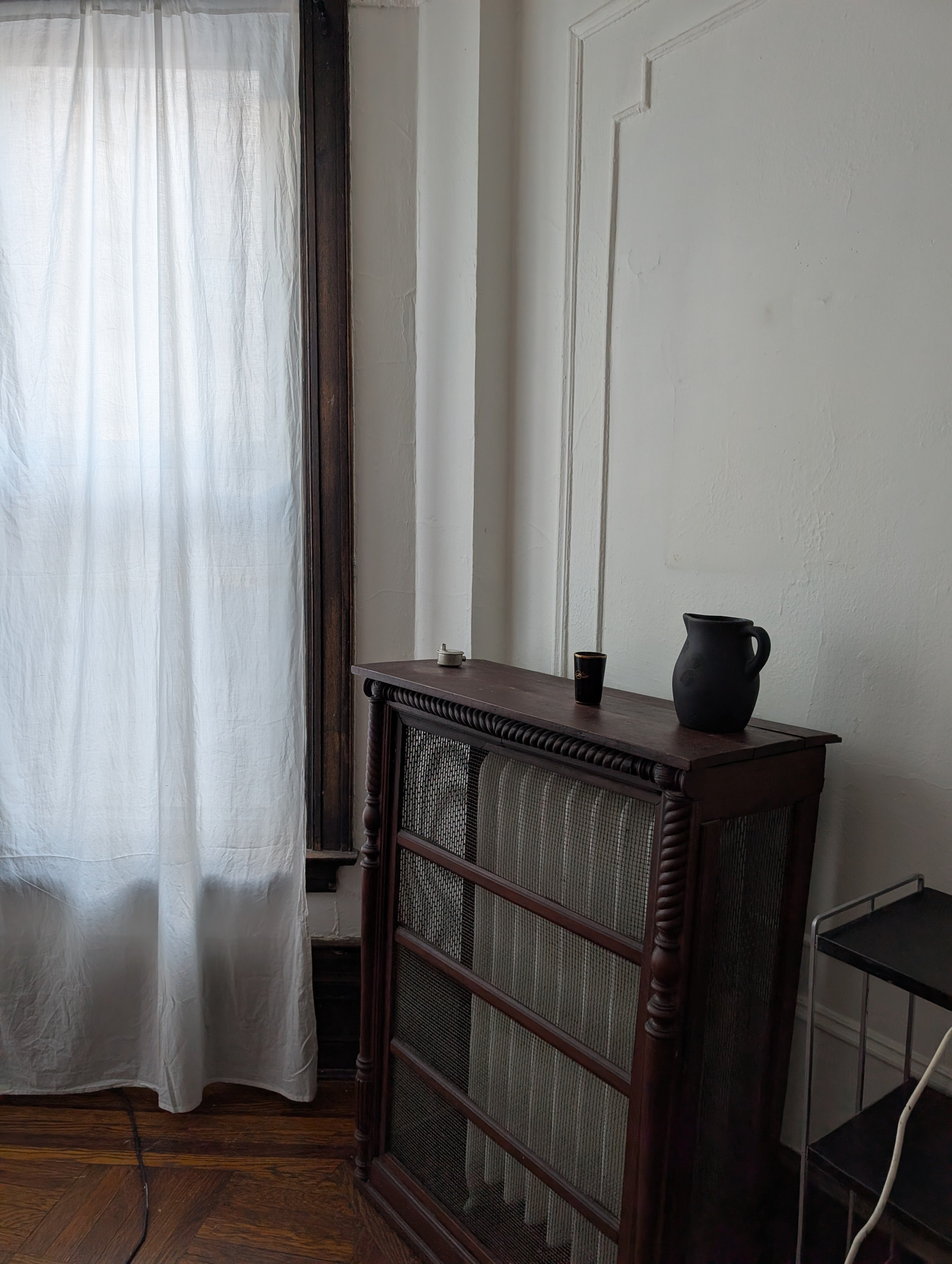

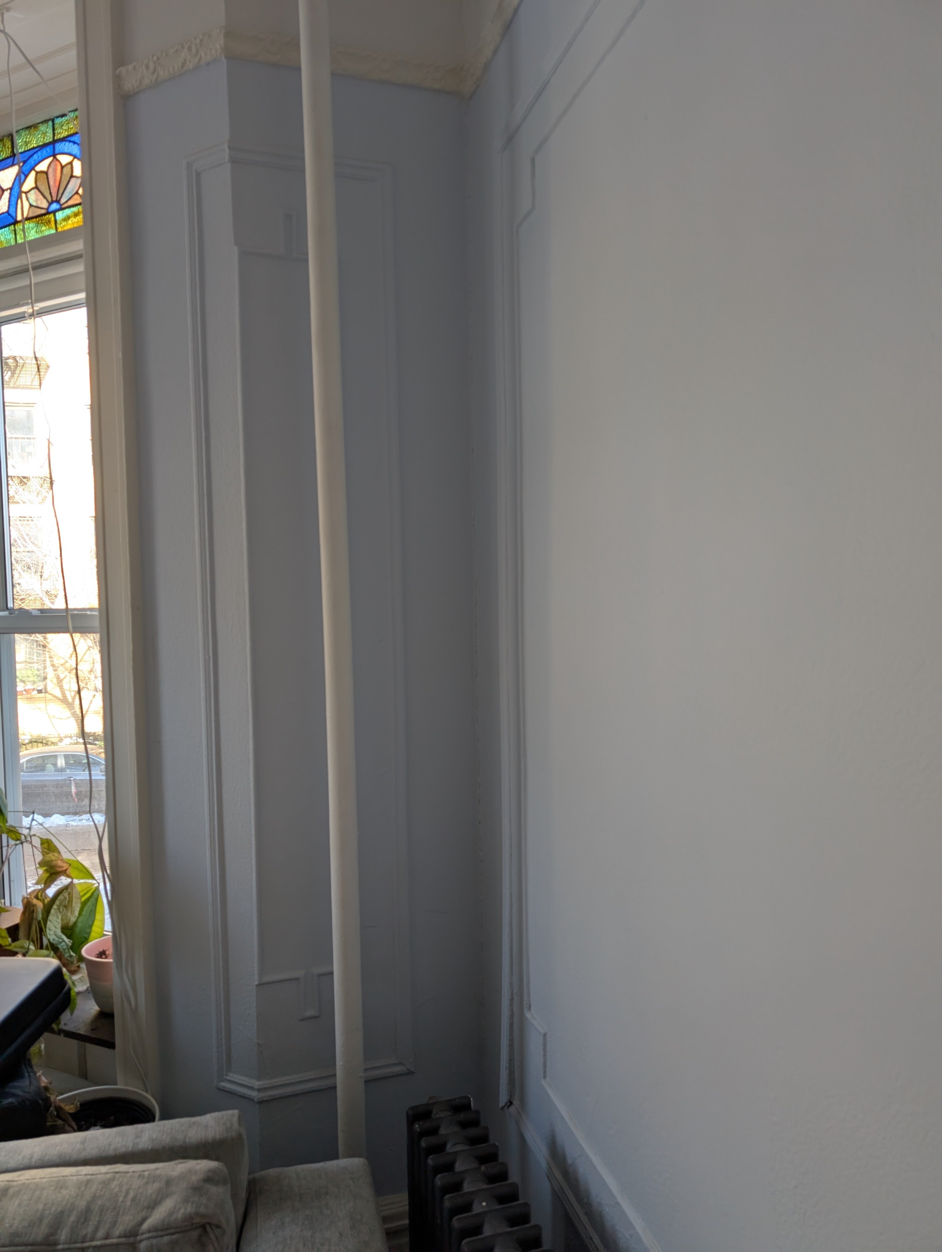

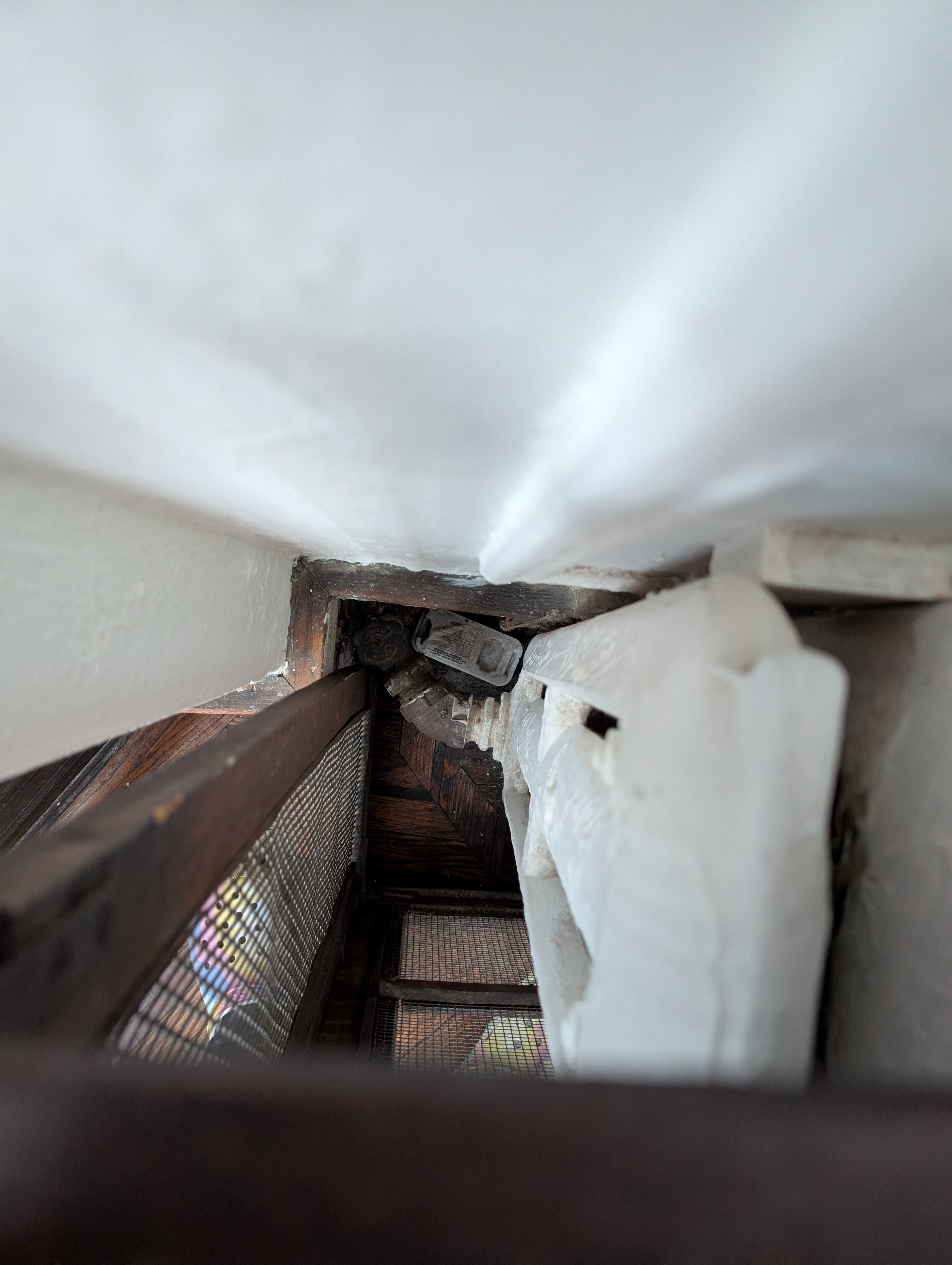

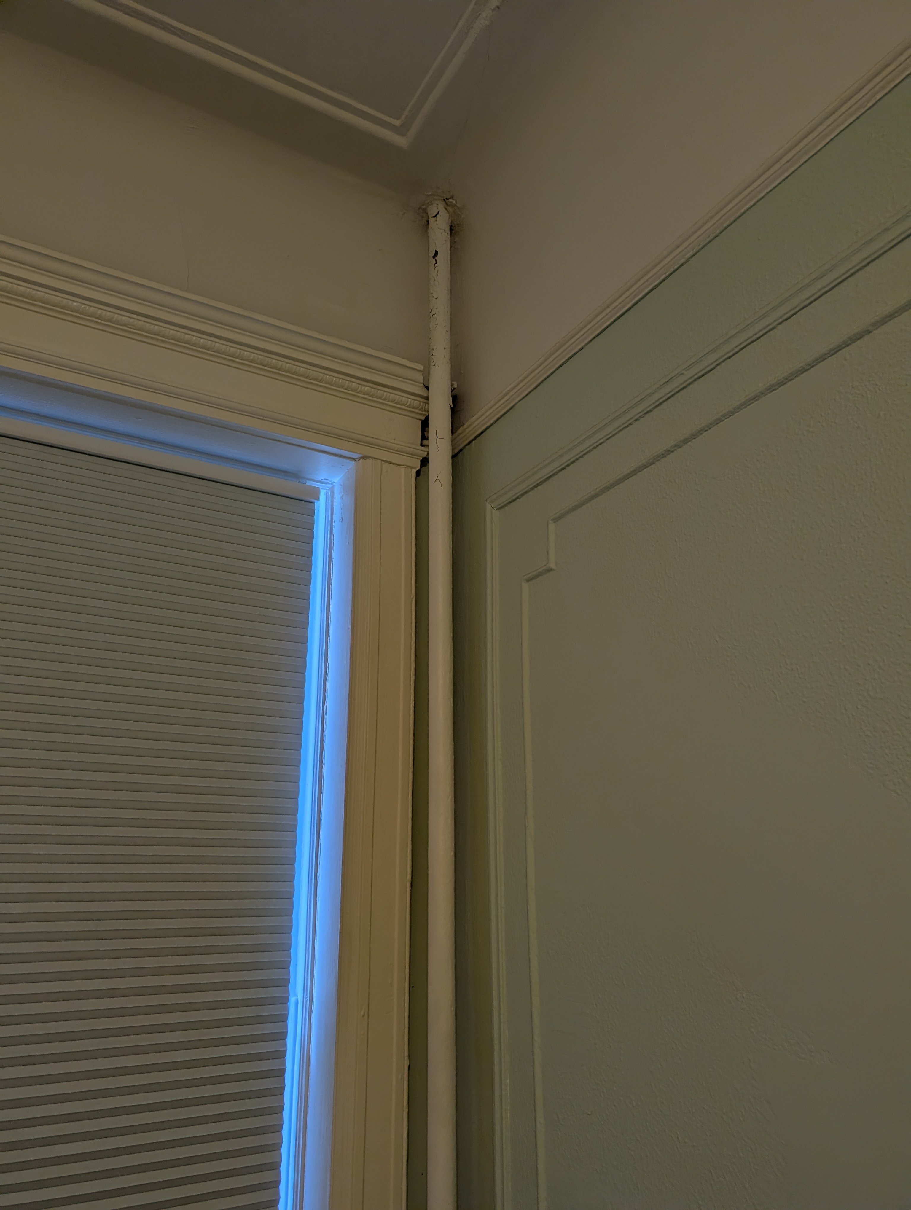

Hi - amateur/homeowner here. Our building has five risers. Three of those risers have obvious venting at the top of the riser on the top floor. Two do not have obvious riser vents. Instead it seems the riser goes straight into the radiator.
Is that typical?
If so, what is the recommended venting strategy for these lines? Vent add if they were risers so they fill up at the same rate as the other lines?
Thanks!
Photos are of the top floor radiators and the riser directly below them

    What kind of looks like an insulated riser on the first photo is just a facet of the wall lit more brightly

    Riser vents and radiator vents really do two different things. Riser vents are like main vents — only for the riser, of course. What they do is help steam get to the radiator quickly so it starts heating. Radiator vents, on the other hand, control how fast the steam can get into the radiator, and thus can (within limits) control how much heat the radiator will put out.
    Now risers are often short and relatively small diameter, so venting them fast is often not required — so vents on the risers are often left off. But in tall buildings or buildings with long risers for some reason, they can be helpful.

    Pitching radiators won't help. The vents are possibly faulty, or your pressure is too high, or both.
    Getting steam to fill all mains and risers before very much steam gets into radiators is a good goal.

    If you make the top floor radiators do all the venting for the risers then those radiators will get hot very early and the top floor will probably be overheated. It would be better to find someplace on the riser or where the supply valve is on those radiators to add a vent for the riser alone.
