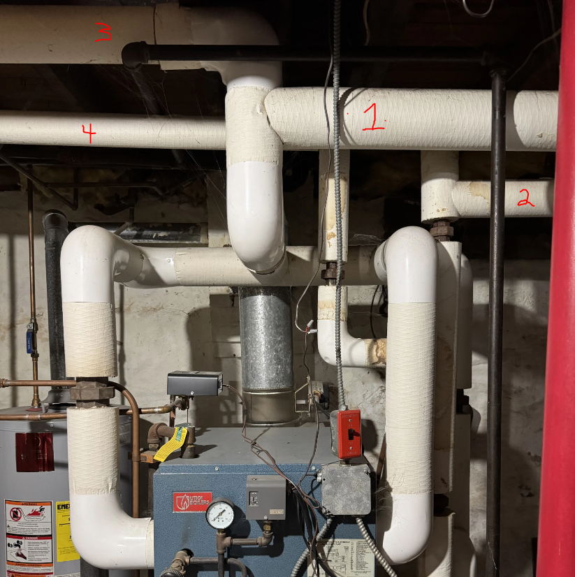

Hi! Just bought a house with my wife with steam heat. Not 100% unfamiliar with how it operates, but the venting situation is where I get hung up.

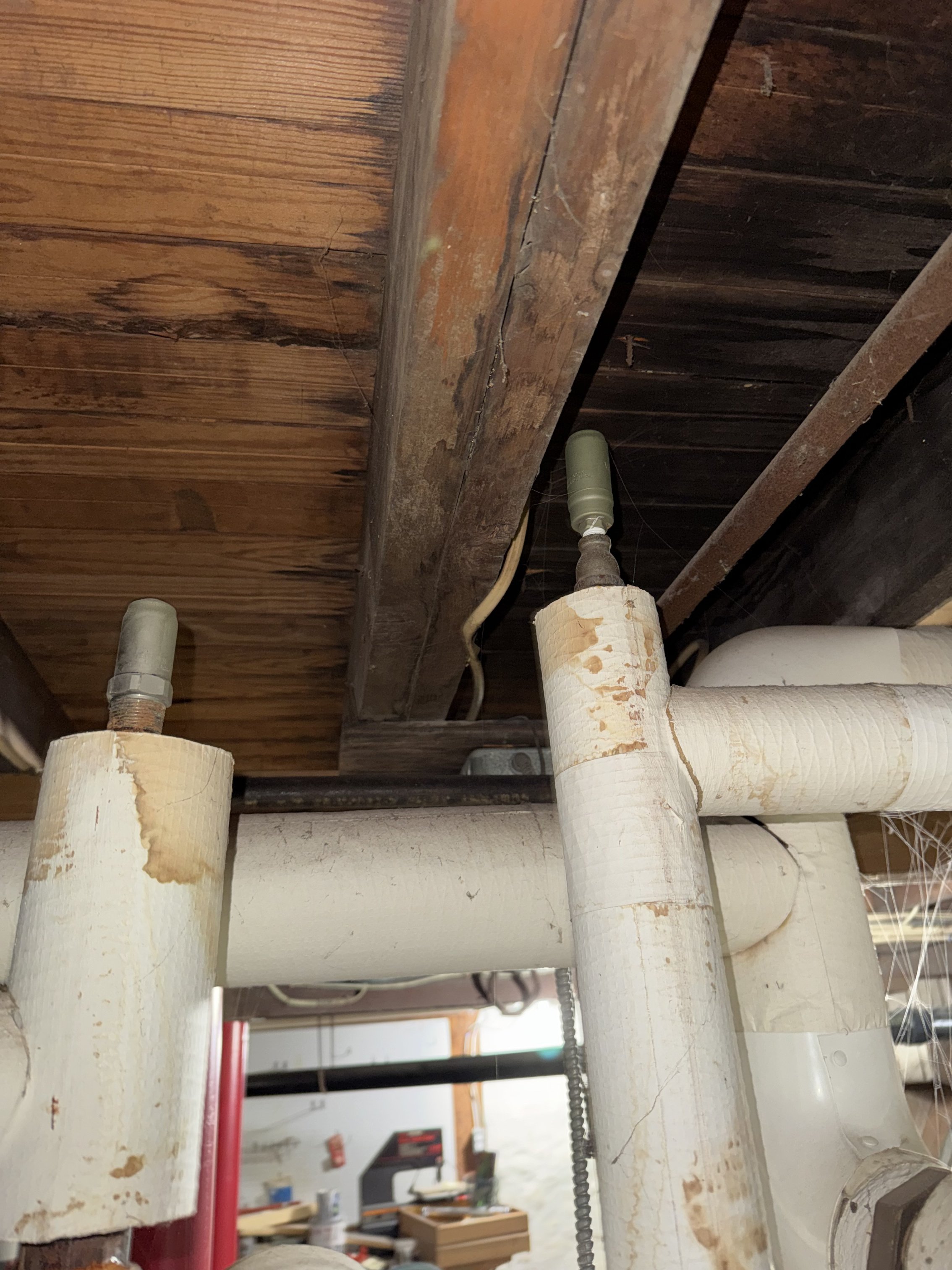

Been reading a lot about going with faster main vents and then slower vents at the actual radiators. Went down in the basement to see how the mains were vented and found this:
Obviously there is steam making everything moist in the right section, but wasn’t sure if there was really anything I could install to remedy that or if I need to somehow redesign the pipes.
Also, the left vent whines the whole time it’s on, the opposite side of it does have a line of rusty water so it’s a bit corroded, the right vent with the dark water stain area doesn’t make any indication it’s doing anything at all no hissing, whining, gurgling.
Just curious if there are any solutions for the inevitable rot in that area I need to redesign out, and/or what main vents would be best to replace these with.
    Those are pretty anemic vents even when they are working. It looks, however, as though they were assembled with tape, so replacing them with new ones shouldn't be that hard. I'd suggest Gorton #2s.

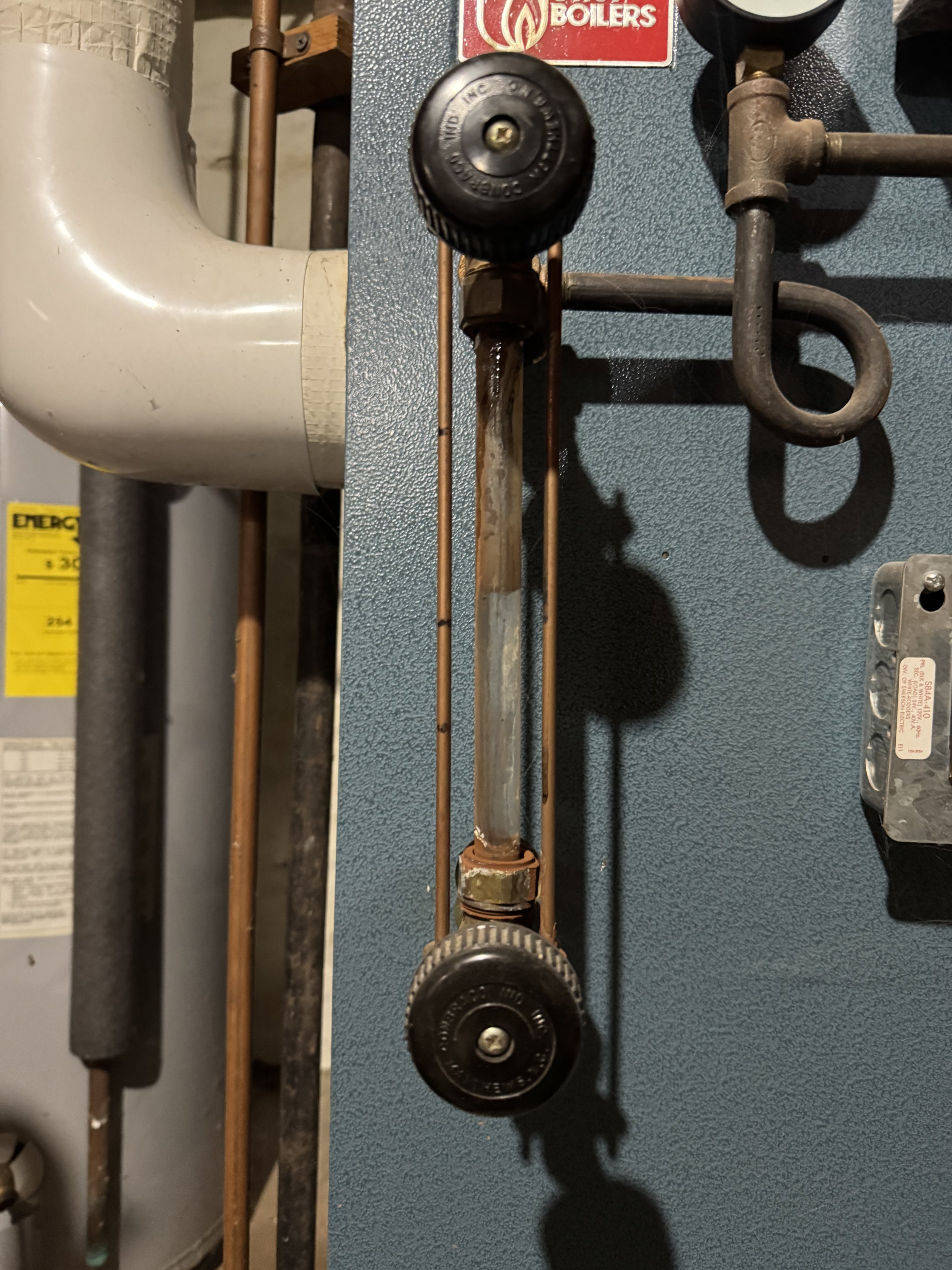

    siteglass so we see the water, when the boiler is firing, does the water level bounce much? more than an inch? does water wash down inside the glass from the upper fitting? both point at poor water quality, and could lead to some of the issues you wrote of, good that you see the level between the markings,

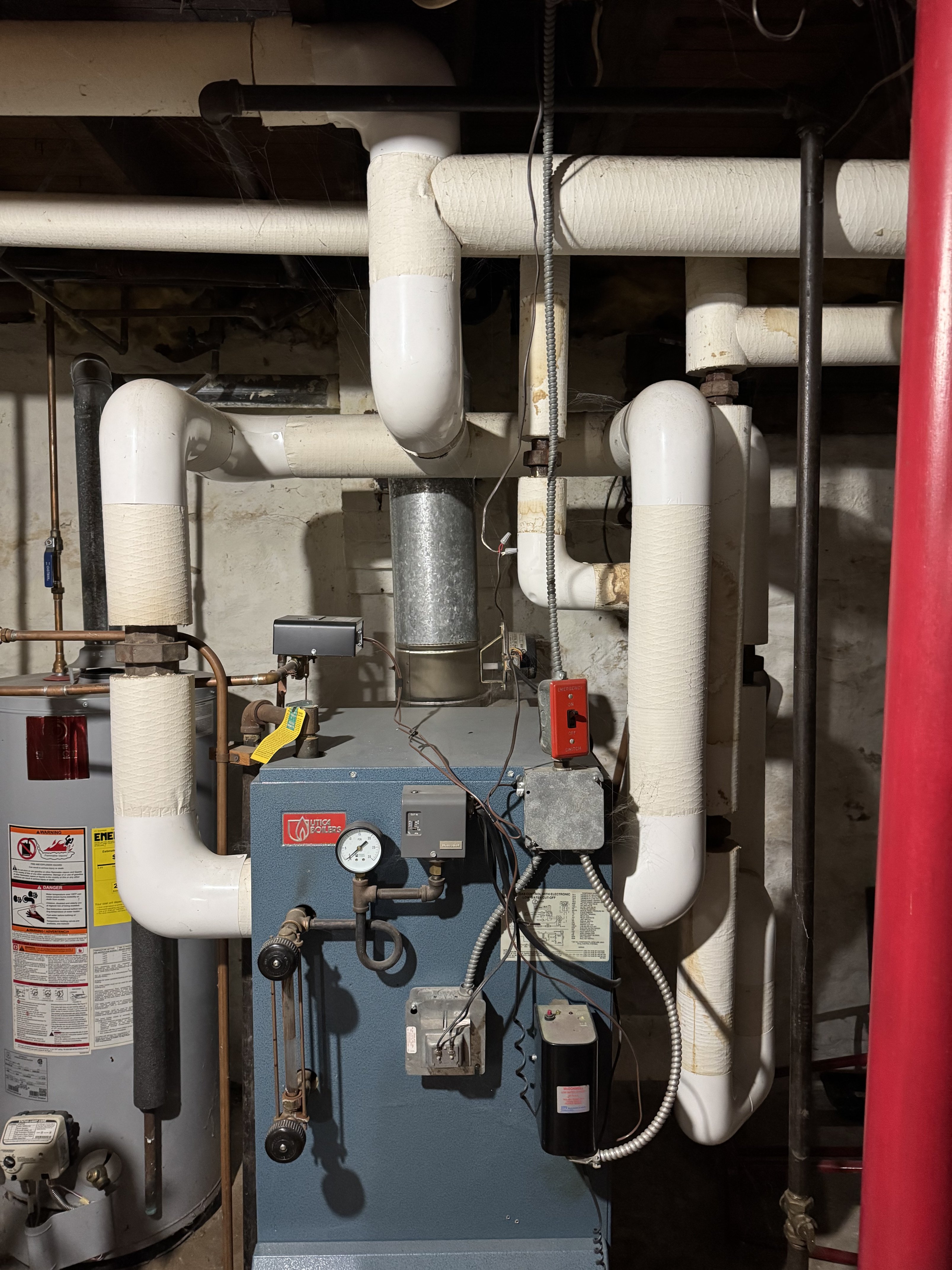

    attaching images of all devices attached to the boiler.
    someone mentioned the length of the mains as well. It’s about 8’ of total pipe before it reaches the vents. After that if say about 20’ until it reaches the closest radiator.
    hope any of that helps!

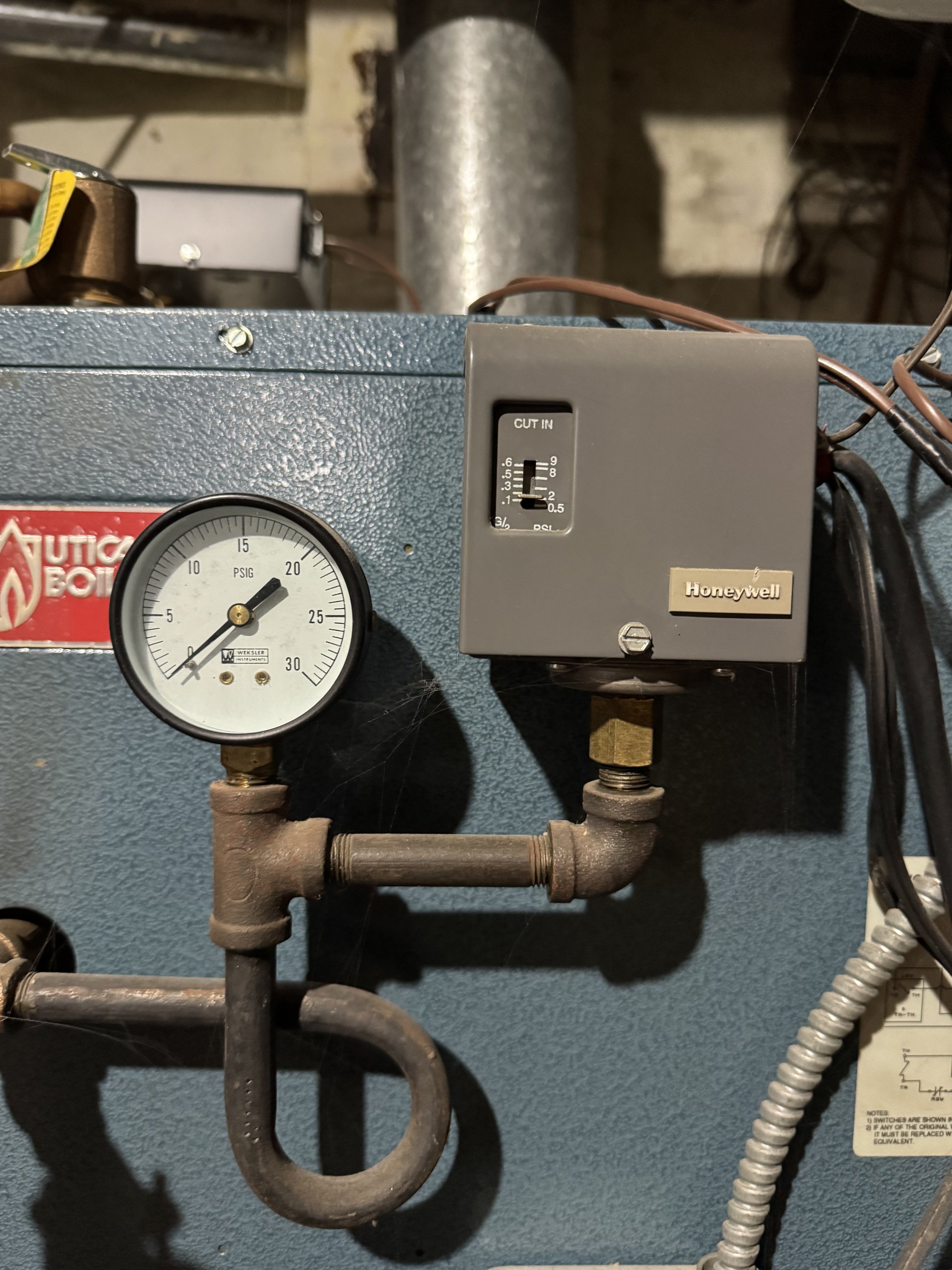

    your pressuretrol (the gray box). is set too high. right now it's set to around 2-3psi (plus 1psi of internal differential). this means your ptrol wont shut down your boiler until around 4psi (assuming it s working correctly in the first place). those are very easy control devices. you can set/fix it yourself.
    do yourself a HUGE favour and install 0-5psi gauge right under your ptrol.

    yeah, dial the Ptrol down as low as it goes, don't go past when you start to feel a resistance, make sure the dial inside is set to 1, 1 points forward,
    that 1st siteglass picture does look like it's washing over, and oiley/dirty, does it bounce much? do you have a skim port? a capped pipe sticking out the back, or sides? or a plugged port we don't see?

    Thanks for the video! Very informative. I can set this as described but what should I aim for? .5? ~1? Definitely do want to get the alternate gauge!

    Will dig into this more later in the week but appreciate the insight. To answer the question on the glass specifically, believe that the oily spill over is a remnant of an old issue as the water level stays pretty constant. As far as the ports and or caps, not sure but will take more of a look.

    "Obviously there is steam making everything moist in the right section, but wasn’t sure if there was really anything I could install to remedy that or if I need to somehow redesign the pipes."
    If that is referring to steam/vapor constantly spewing out of the vent on the right, making the surrounding area moist, then that doesn't sound right - the vent may have failed open and if so should be replaced. That happened to me a month in to the heating season in the house I moved in to last year - it was also accompanied by an uptick in the water feeder adding water.

    Please measure the total length of main pipe #1 from the T above the boiler to where it transitions into the return pipe #2 out at the end. Also tell us it's pipe pipe size (2", 2.5", 3"…?). Do same for main pipe #3. Also tell us the lengths and pipe sizes of the returns (#2 and #4). All these pipes need to be evacuated of air by the advancing steam and this will dictate the best main vent sizing you need. Your pipes look pretty well insulated so you may need to take some off to get measurements or you can estimate assuming you have insulation with a wall thickness of 1" to get the pipes OD and then from pipe sizing charts figure out the actual nominal pipe size from a schedule 40 pipe chart like https://www.engineeringtoolbox.com/ansi-steel-pipes-d_305.html.
  • you set cut in at 0.5 and differential inside at 1.

    I know the near boiler piping is not what is being asked about, but is that the equalizer on the R side of photo or is there no equalizer and that is the 2nd supply from the boiler? Also, the supply to the main is not supposed to be horizontal; supposed to be either a 45deg upward or 90 deg upward.
    So hard to tell what one is looking at with only one view!
