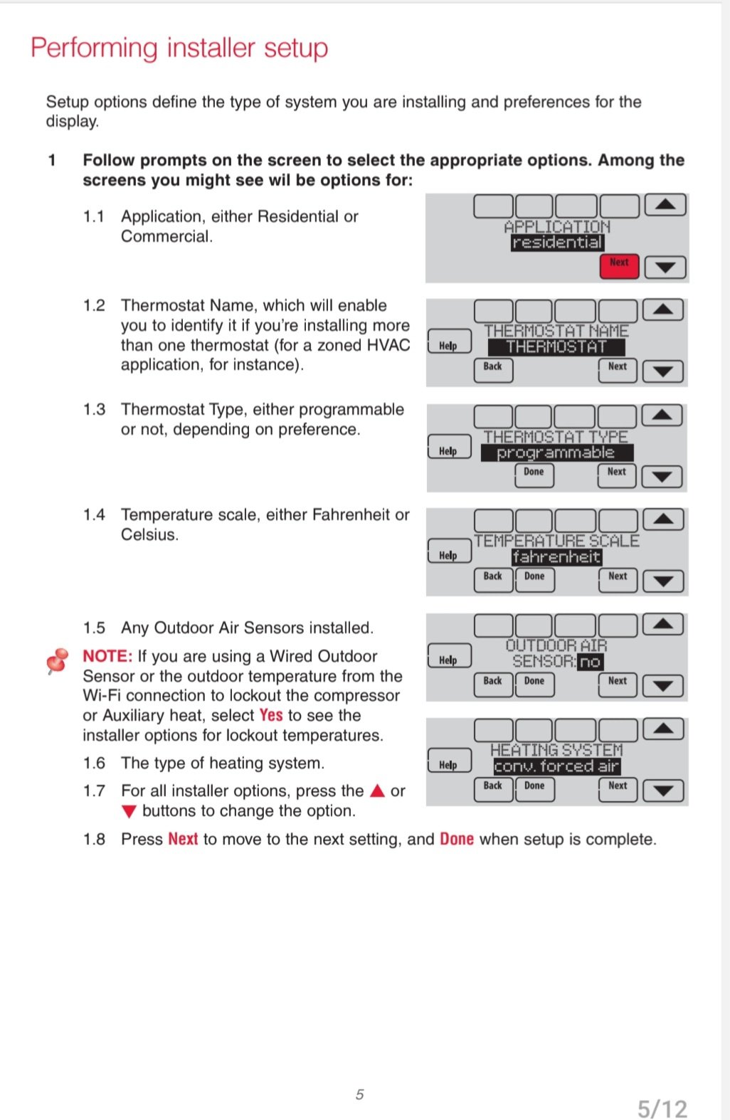

    HVACNUT Posts: 7,746
    1.5 is YES?
    1.6 is STEAM?

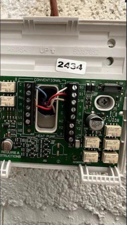

    The information should include photos of the wire connections to the thermostat subbase and the wire connections at the boiler.
  • honeywell vision pro 8000 set at 73 reaches set temp shuts down for 5 minutes and calls for heat even though the temp still reads 73. yes i did set the thermostat heat system to "conv./forced air" also set the the sensor temp to wire and not the actual thermostat for temp. Also set the differential +1 and then +2. also removing thermostat from the wall it does shut down the boiler

  • its heat only no A/C i tried the cycles per option but i don't see any difference I have 3 wires from the boiler and 2 wires from the sensor
    pecmsg Posts: 7,613
    Why is there a wire on O/B? That's for a heat pump reversing valve.

    Heat pump terminal designations on the outside, conventional on the inside. It's landed on W1, with R & C; and a remote sensor. That's a multi stage stat, so make sure it's configured for one stage of heat. I'm not sure if having several heat stages makes the first stage operate differently. There may be a "hydronic" or "boiler" setting in addition to the "conventional forced air" setting, if so try that.
