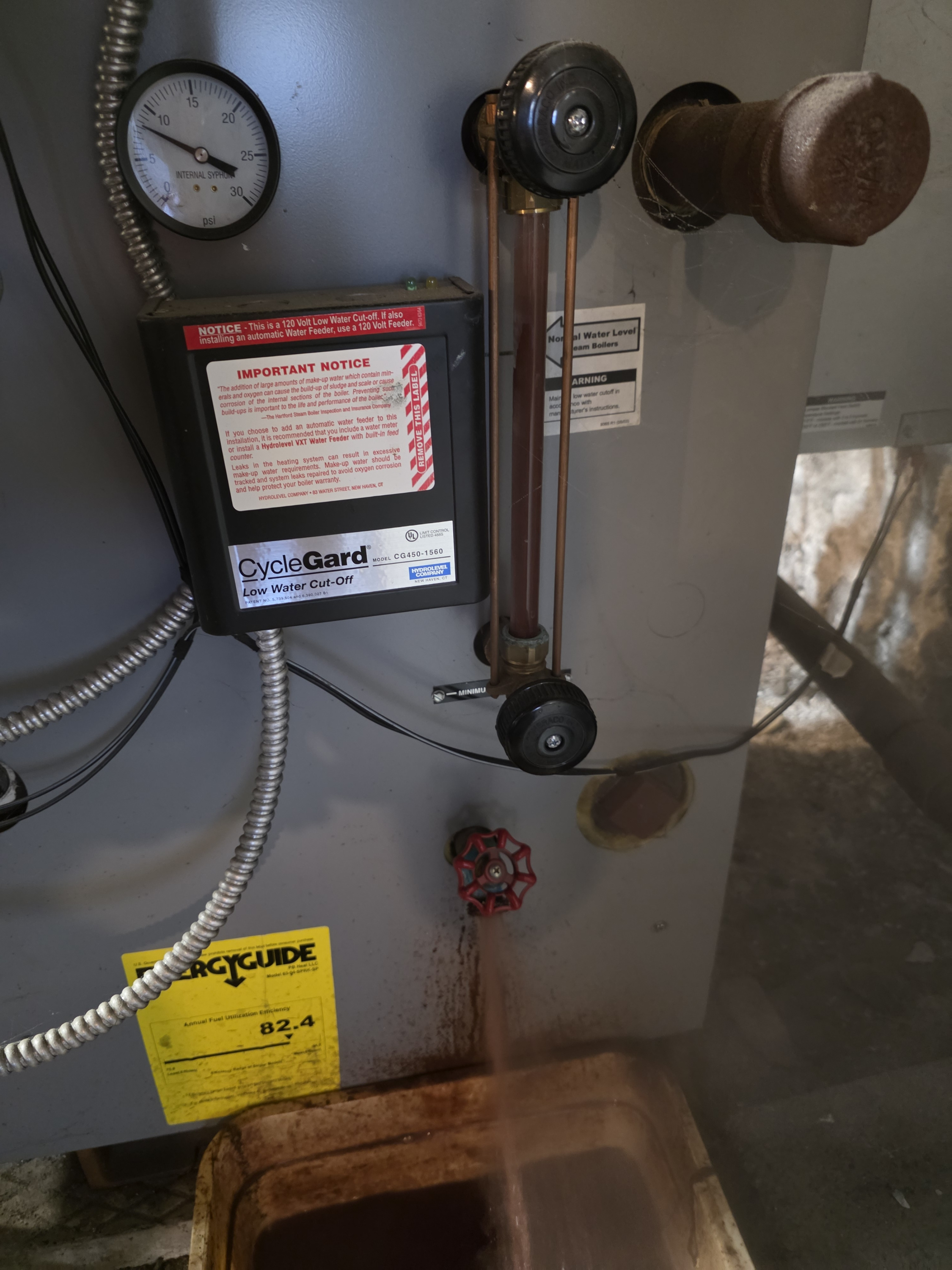

Hi, a few questions here - with this extreme cold my system has been running almost nonstop just keeping up in this old house. I've always had a little whistle or whoosh from some of the radiators, but this week I've noticed them being extra loud and some even 'sputtery'.

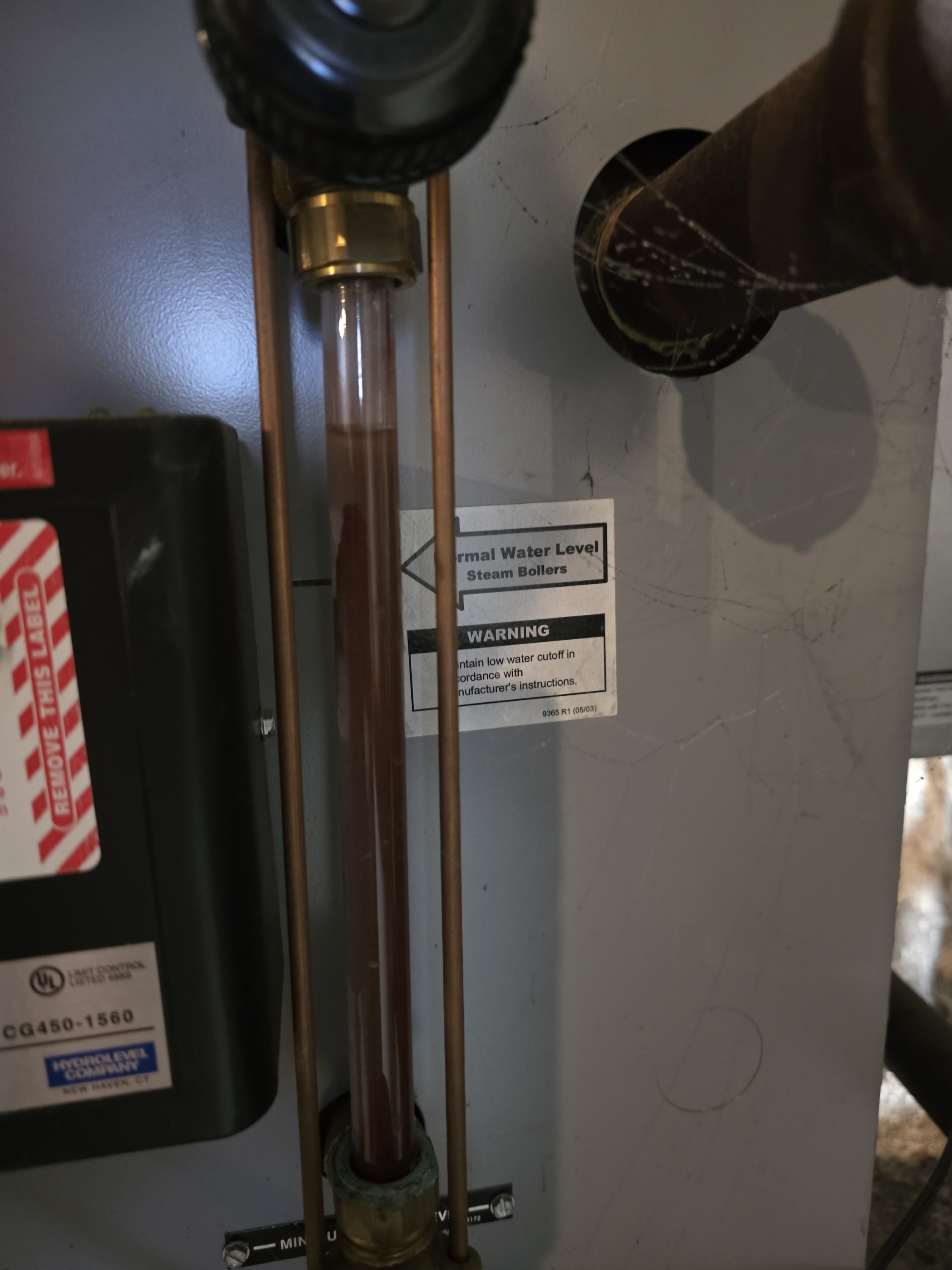

I checked my water level, and alarmingly it seems to be full - I dumped a couple of gallons, a bit of it rusty and then full clear, and it still looks full. I don't want to keep dumping out water, but I'm also concerned. It's a manual feed and I haven't done any top offs in a while, unless someone else in the house has been without my knowledge.
What should I be doing for my next steps? Thanks in advance, this forum is great.
    Dump enough water so that the steaming water level in the boiler is slightly above the center of the sight glass..
    But… first make sure that that sight glass is really full, not completely empty! It isn't always obvious!
    The manual feed valve may not be closing completely…

    Or the autofeed solenoid valve (if you have an autofeed—it sounds like you don't but I leave this here for completion's sake) may be leaking by.
    Or if you heat your domestic hot water with a coil in your boiler, that coil may have a leak.
    This issue is important to solve because you definitely don't want your steam system full of water.

    Thanks for the quick reply! I'm pretty sure it isn't low, my lwco works last time I checked. I do have a manual fill lever, which is off but I'll check closely and let out some more water.
    ethicalpaul Posts: 9,076
    Great action shot of draining in progress, let us know what you discover!

    I've got it down to a little above optimal so that I can monitor over the next few days. I'm hoping it was just a mistake (although fiancee swears she hasn't added water since December).
    I would say I dumped about 5 of those basins, so we'll see if those radiators quiet down a bit.
