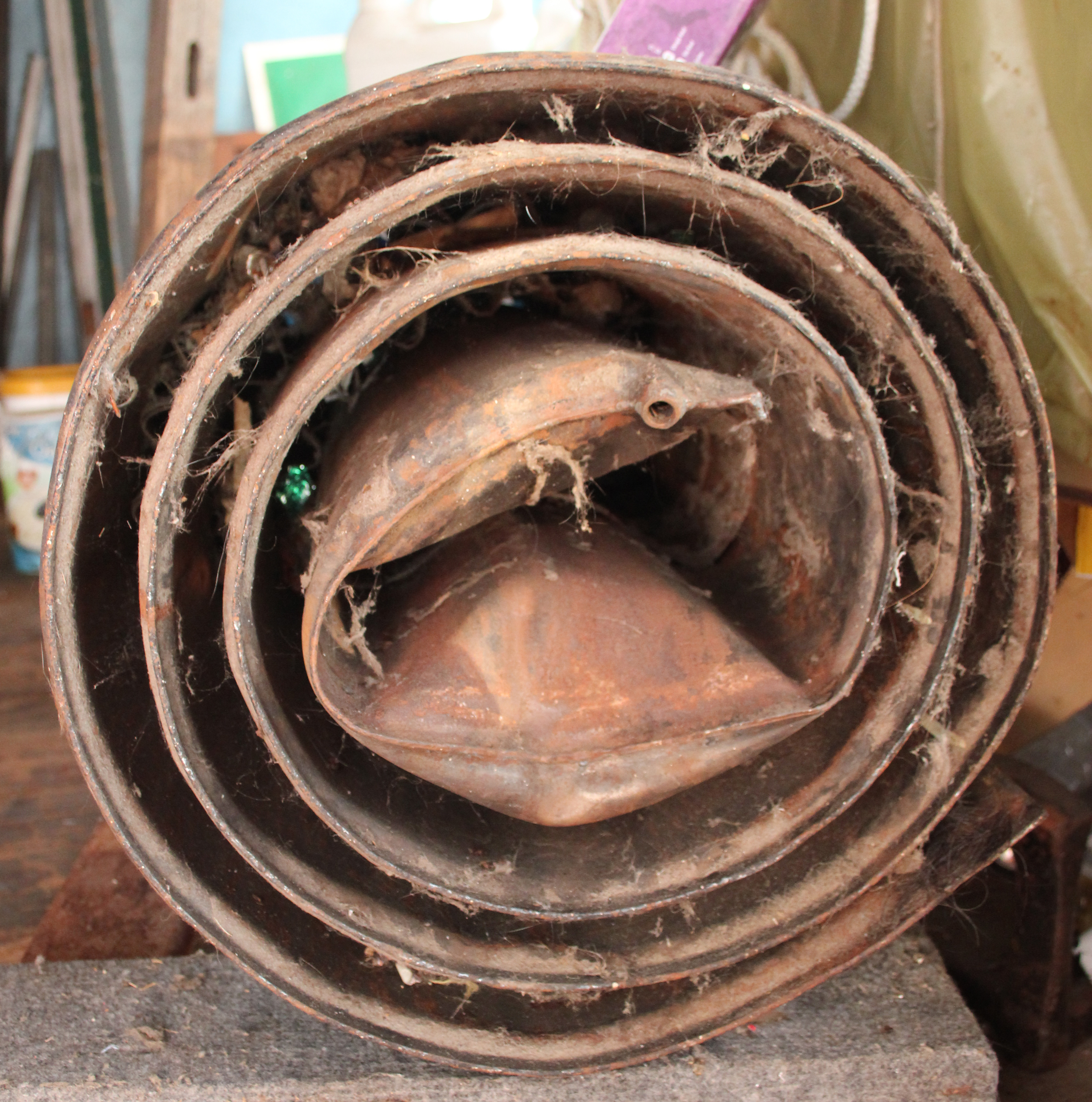

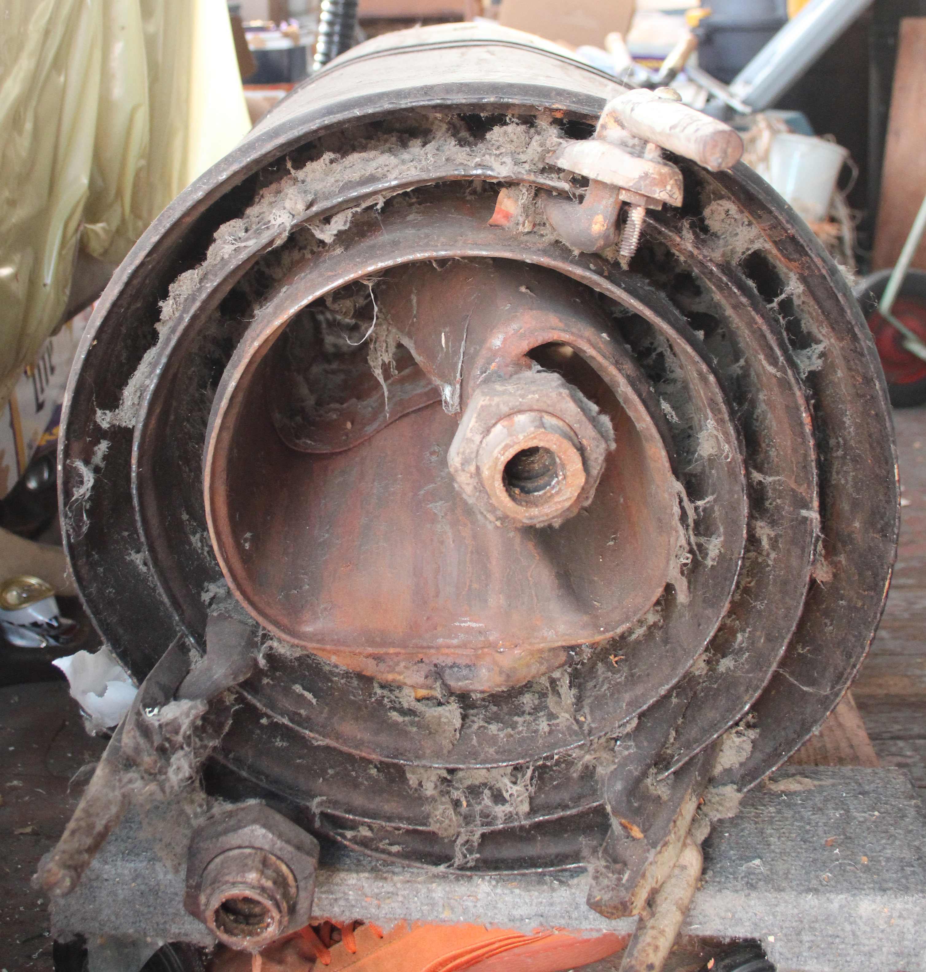

The gravity boilers in my duplex are 103-years-old this year. The boilers and the gas conversions installed in the '60s are working well. The problem I'm having is with the radiators.
The original radiators are not cast iron. They are coiled tubular steel about 30" high. The coils range in diameter from 10.75" to 14."
Over the years, some of them have rusted through and have distorted too much to be welded. The smaller ones in the rear of each unit are still working but the larger ones have had to be removed. We're using fans to bring heat to the front of each floor.
Upgrading the heating and electrical systems in this building will cost more than it's presently worth; complicated with my being 88-years-old.
Are there any panel units that can replace these old radiators? I've seen some tubular cast iron radiators but, including shipping, they cost more than three times that of panel radiators. I need 4 of them.

    Pictures?

    pix please!
    Kind of looks like copper to me but pictures can be deceiving.
    I think it will be difficult to come up with a rating on those units. Never seen anything like it.
    @Steamhead ?
    looks like a rolled up mattress radiator, looks like steel or sheet iron to me because it is rusty. if you can't find a spec for it, using geometry or calculus to find the surface of it assuming it is just a 2 sides rolled up rectangle will probably get you close enough.

    I've seen something on these but can't find it quickly. Since this is a low-mass type of heat emitter, it would be well to stay with something similar. Possibly a convector such as Beacon-Morris makes.
    We might get an idea of its output by looking at the size of the pipes feeding it. Given its age, I'm thinking the water originally circulated by gravity, so we'd go to the design info of a gravity system.
