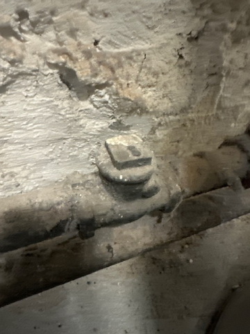

- Drained the boiler from the lowest boiler drain and from the wet return hose connection.
- Discharge water was extremely dirty, indicating heavy sediment/sludge in the boiler and/or return piping.
- Performed multiple fill-and-flush cycles to remove as much debris as possible.

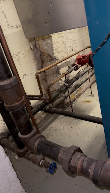

Return Piping Inspection
- Visible return piping near the boiler appeared properly pitched with no obvious sags.
- Access to the wet return is extremely limited due to tight spacing between the brick wall, boiler, and domestic hot water tank, making inspection, cleaning, or replacement difficult without disassembly.

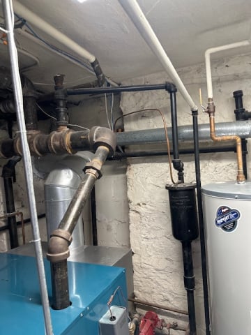

Next Step and Question
We are scheduled to return to open and clean the wet return piping.
If cleaning or replacing the wet return does not resolve the issue, what other causes should we be focusing on?
- Traps?
- Boiler piping issues?
- Control interaction (LWCO, feeder, vaporstat)?
- Other less obvious two-pipe steam system faults?

- There shouldnt be a mud loop on a 2 pipe boiler, but mud loops usually keep the wet return from getting jammed up. Where is that mud loop tied in?
- Disconnect mud loop wiring and lock it up, see if the boiler does the same thing on first fire.
