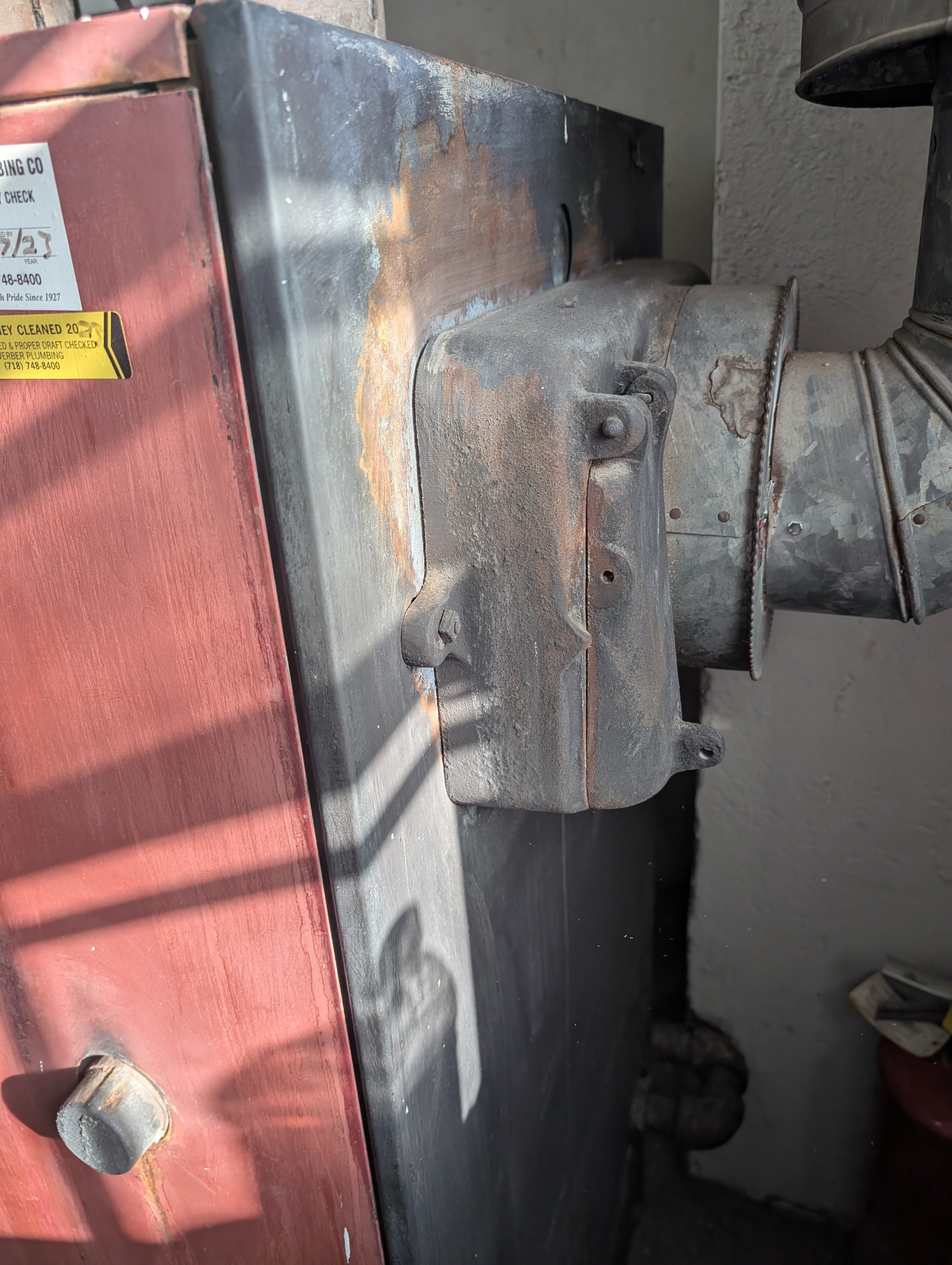

I have an original coal-era cast-iron steam boiler in a 1925 Brooklyn house, converted to natural gas. It’s a one-pipe steam system with a pressuretrol on a pigtail, sight glass, and manual water feed (no automatic feeder). The boiler still has the original coal-era vent/cap on top.
Current issue
Steam is coming out of the old vent on top of the boiler. I believe this may have happened in the past (possibly during very cold spells), but under more typical Brooklyn winter temperatures I haven’t really noticed it.
Here’s what I’m seeing
  • The steam sometimes sputters (steam with water droplets)
  • Steam from that vent only occurs while the boiler is firing
  • The steam stops completely when the burner shuts off
  • Some radiator air vents vent small amounts of steam when this is happening
  • Boiler water level in the sight glass remains stable
  • The boiler continues to heat the house
  • The issue is more noticeable during very cold weather with long run times

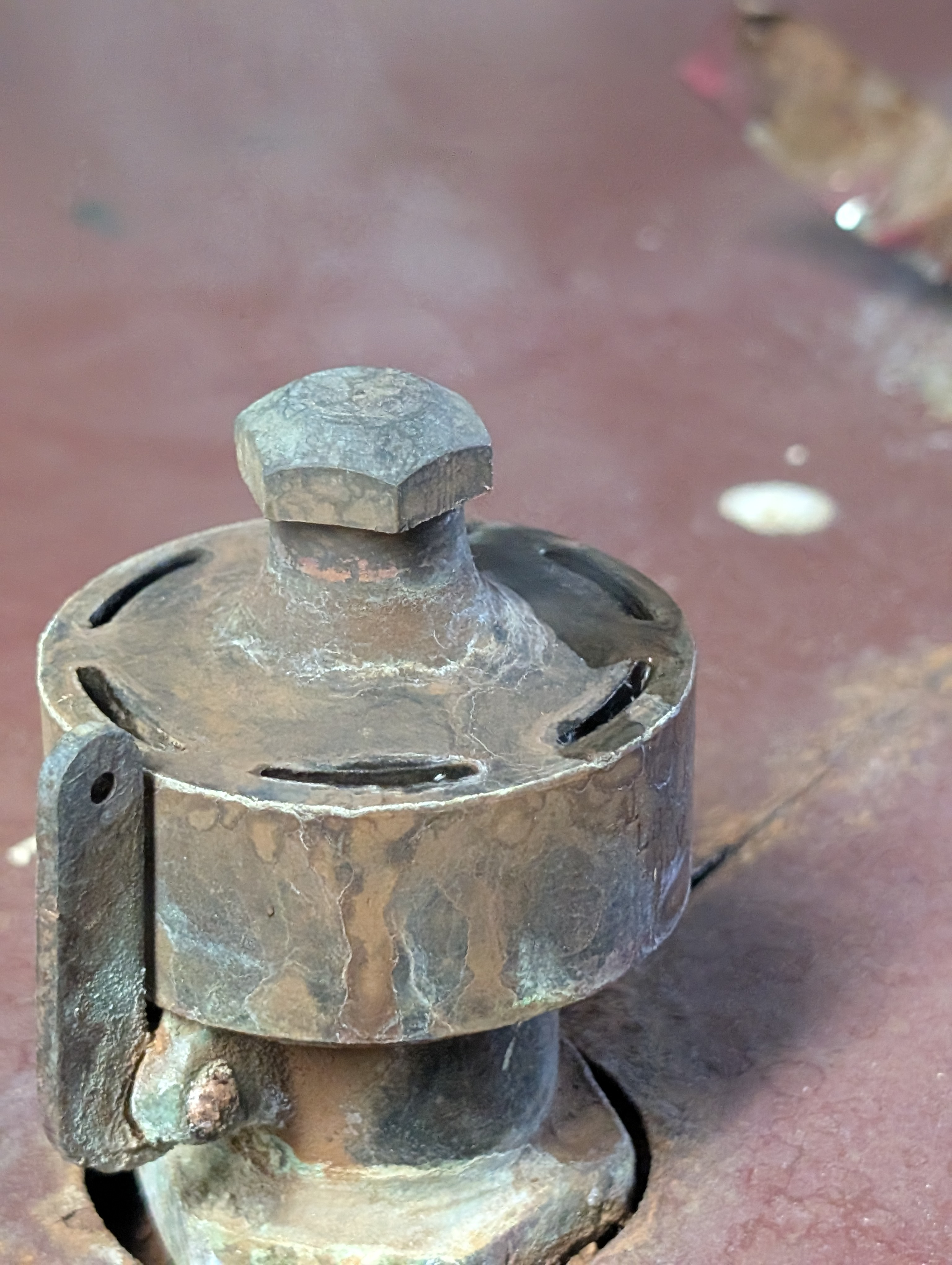

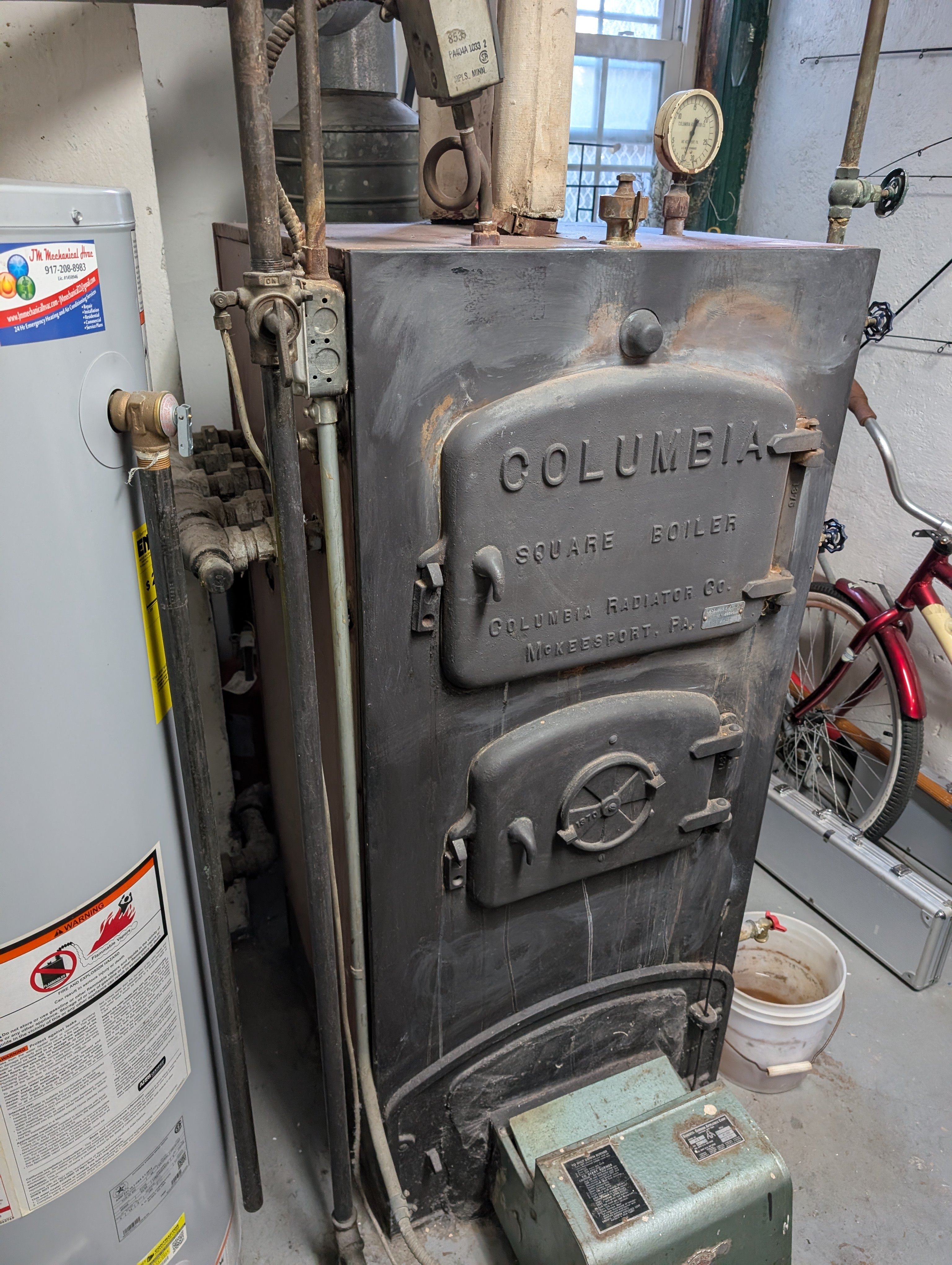

    It's likely that the old relief valve is finally failing. It's also likely that the leaky vents are are failing or gunked up. It's possible the boiler is making too much pressure which will compound the problems. Your pressure trol looks fine but I'd get the pigtail cleaned or replaced. From what you've posted I see nothing alarming.

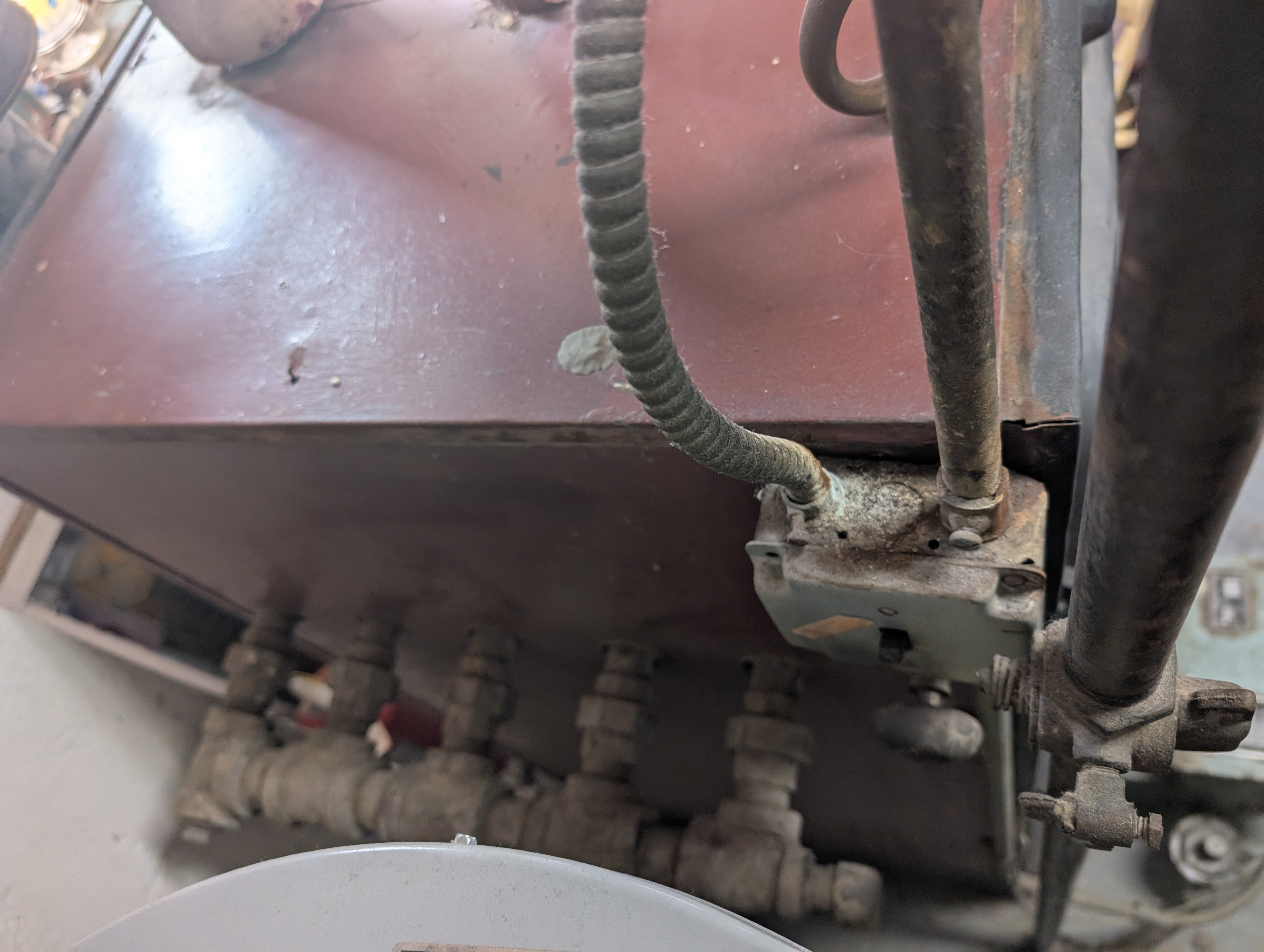

    New relief valve, clean/replace pigtail and check connection into boiler to make sure it is clear. Also set and adjust/clean pressure control to cut off the burner at 1.5psi.
    Maybe a new pressure gauge as well.

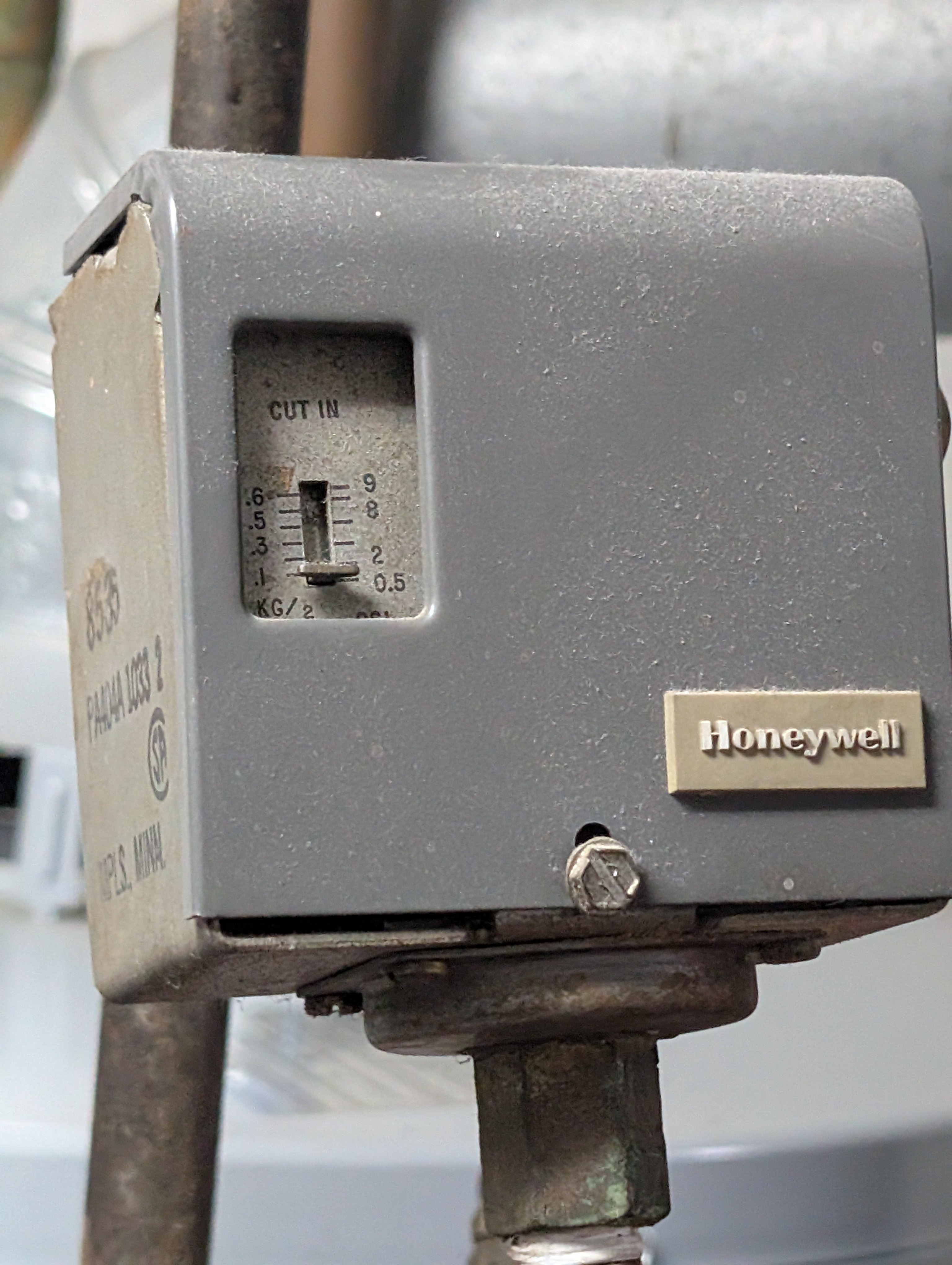

    i bet that pressuretrol is old enough to have a mercury switch instead of the far inferior microswitch.
    it could be over pressurizing and the relief valve is doing its job or it could be the relief valve failed.
    like others said, check the pigtail is clear and maybe check the gauge and replace the ancient relief valve with a modern version piped to within 6" of the floor

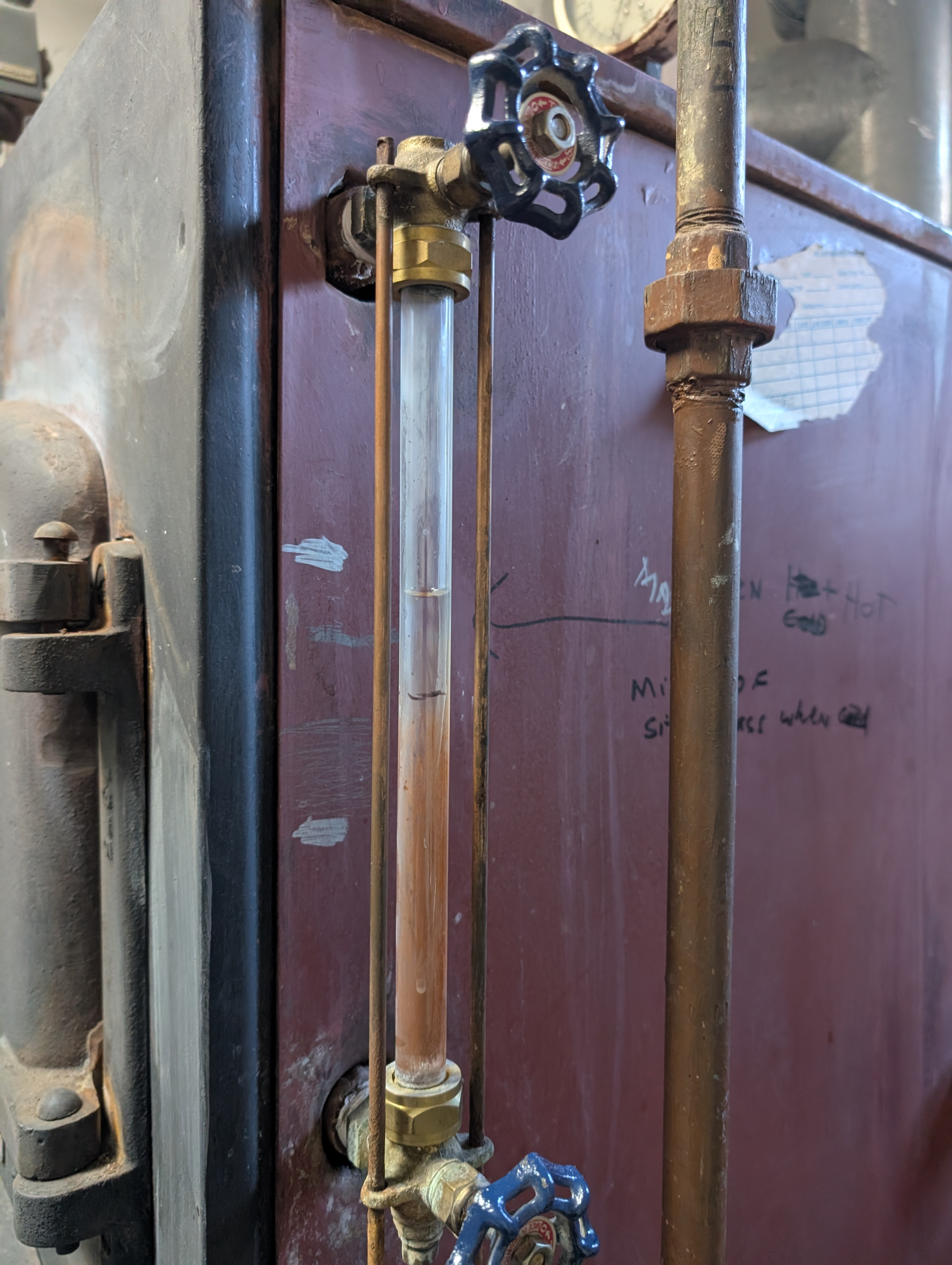

    actually, first flood the boiler and make sure water doesn't come dripping out of the boiler itself. it could be the boiler has a hole in it and it is just coming out the jacket where there is a hole for the relief valve.

    The PA404A never had a mercury switch. Not the original pressure control. The original would have had mercury. The safety valve is original as well as the pressure gauge.
    But more important there is another safety control missing (or at least it is not in the pictures)

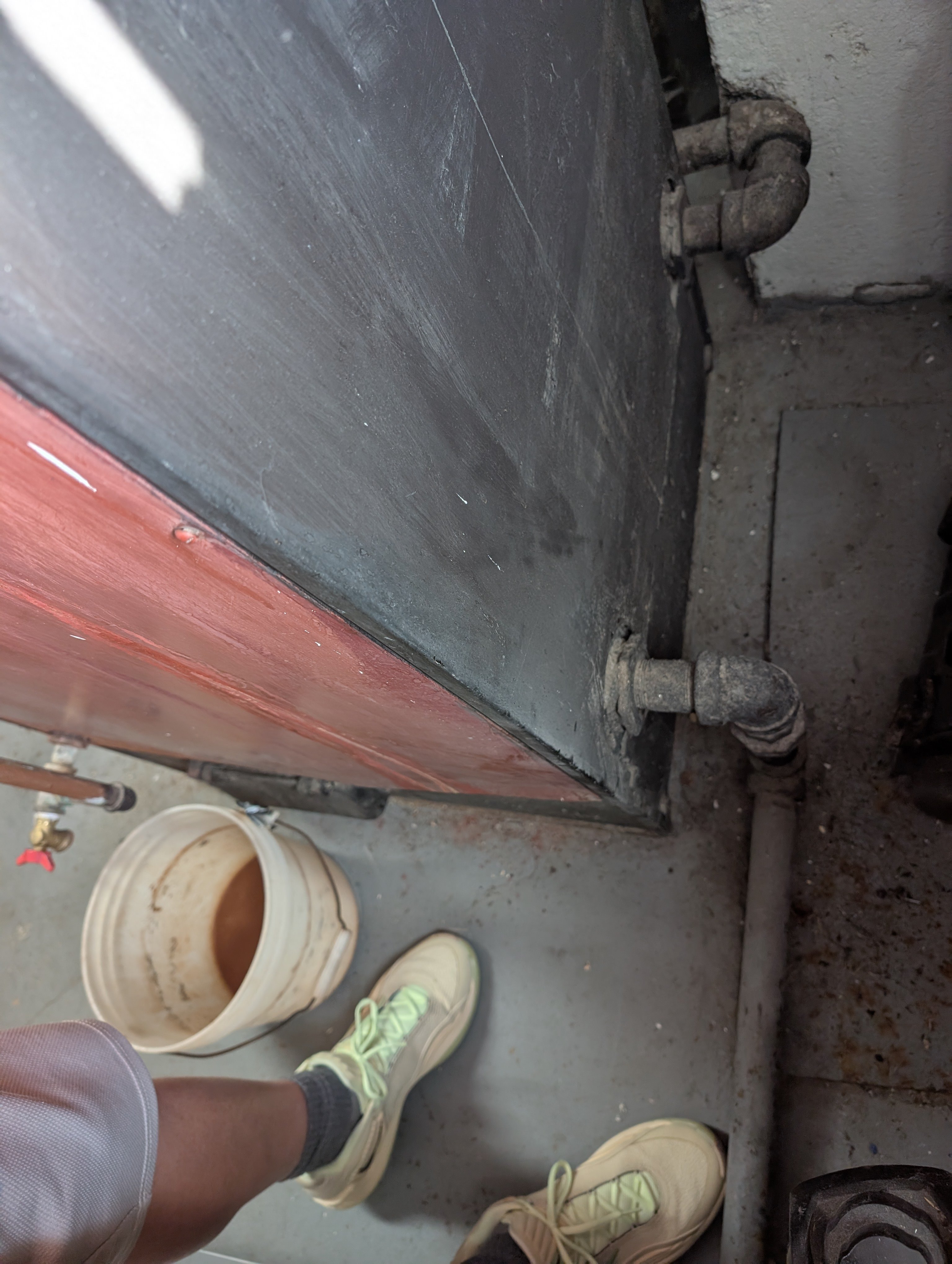

    Not only do i not see a LWCO, where is all the near boiler piping, behind it?

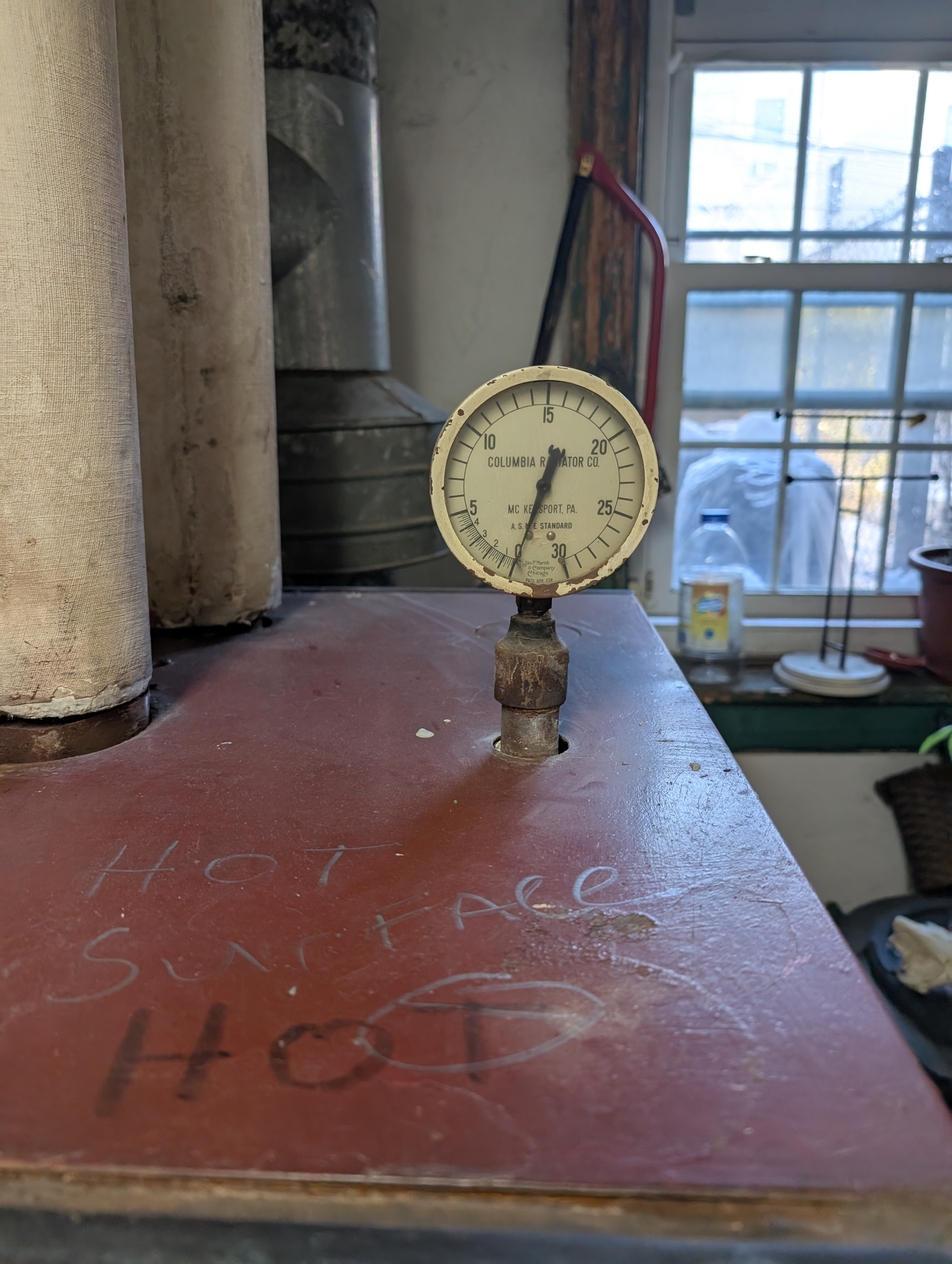

    That is an original Marsh instruments steam pressure gauge, if anything I would only replace it with another Marsh Instruments pressure gauge. The Marsh Instruments Company has always made high quality pressure gauges. It would be worth calling the company and asking if they would recalibrate and pressure test this gauge for you if you are concerned.
    I have a Marsh instruments triple gauge for my coal stoker boiler and I sleep very well at night because I know I have a high quality pressure gauge. Your current pressure gauge could be used on the new boiler too if and when you replace that beautiful hand fed coal boiler.

    30psi gauges are required by code…they must read 2x the pressure relief valve rating (15psi). They are notorious for being very inaccurate at the low end of the readout. Best thing to do would be to install a Tee with two gauges…. a 0-30psi to make insurance happy, and a 0-3 or 0-5psi one so you can actually read what pressure you are operating at.
    You can do all this work yourself, you only need a couple of wrenches.
    For cleaning the pressuretrol:
    1. Turn off the power to the boiler.
    2. Remove the cover on the pressuretrol and disconnect the two wires and the conduit.
    3. Remove the pressuretrol by screwing the entire assembly lefty-loosey :) from the nut on the bottom.
    4. Run a large zip-tie or flexible pipe brush through the pigtail to clean it out.
    5. Reassemble in reverse order with some Teflon tape added to the threads on the pigtail.
    The pressure relief valve should also be replaced, they are a maintenance item.
    Don't be in too much of a rush to replace this piece of history. A new one will heat the building the same way….but it will likely be much more efficient and have some fuel savings associated with it. But it will cost some big coin to start saving on fuel.
    It may not be a bad idea to retrofit a LWCO to this beast for safety reasons if it is even possible. If a plug exists somewhere near or just below the bottom of the site glass it can be removed and a probe-type LWCO can be added.

    If it is properly sized it shouldn't build much pressure under normal operating conditions. You could upgrade to a vaporstat instead of a pressuretrol which limits the pressure to a lower maximum than a pressuretrol.

    Does it even have 24v for a probe LWCO? I assumed it was millivolt, can retrofit a 67G at the gauge cocks.
