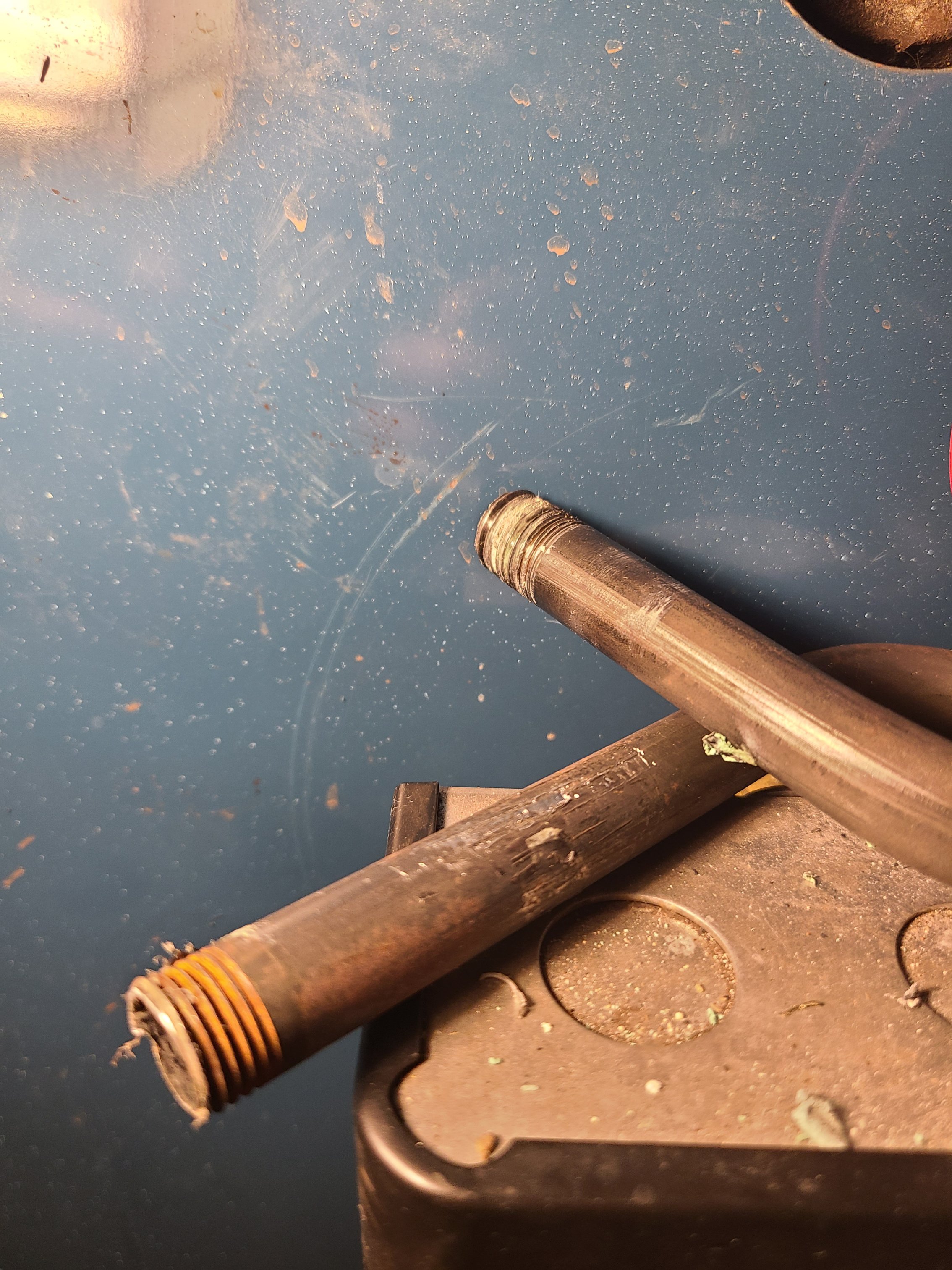

  • Vaporstat was not obstructed. Pressuretrol wasn't either. Pressure gauges were bouncing.

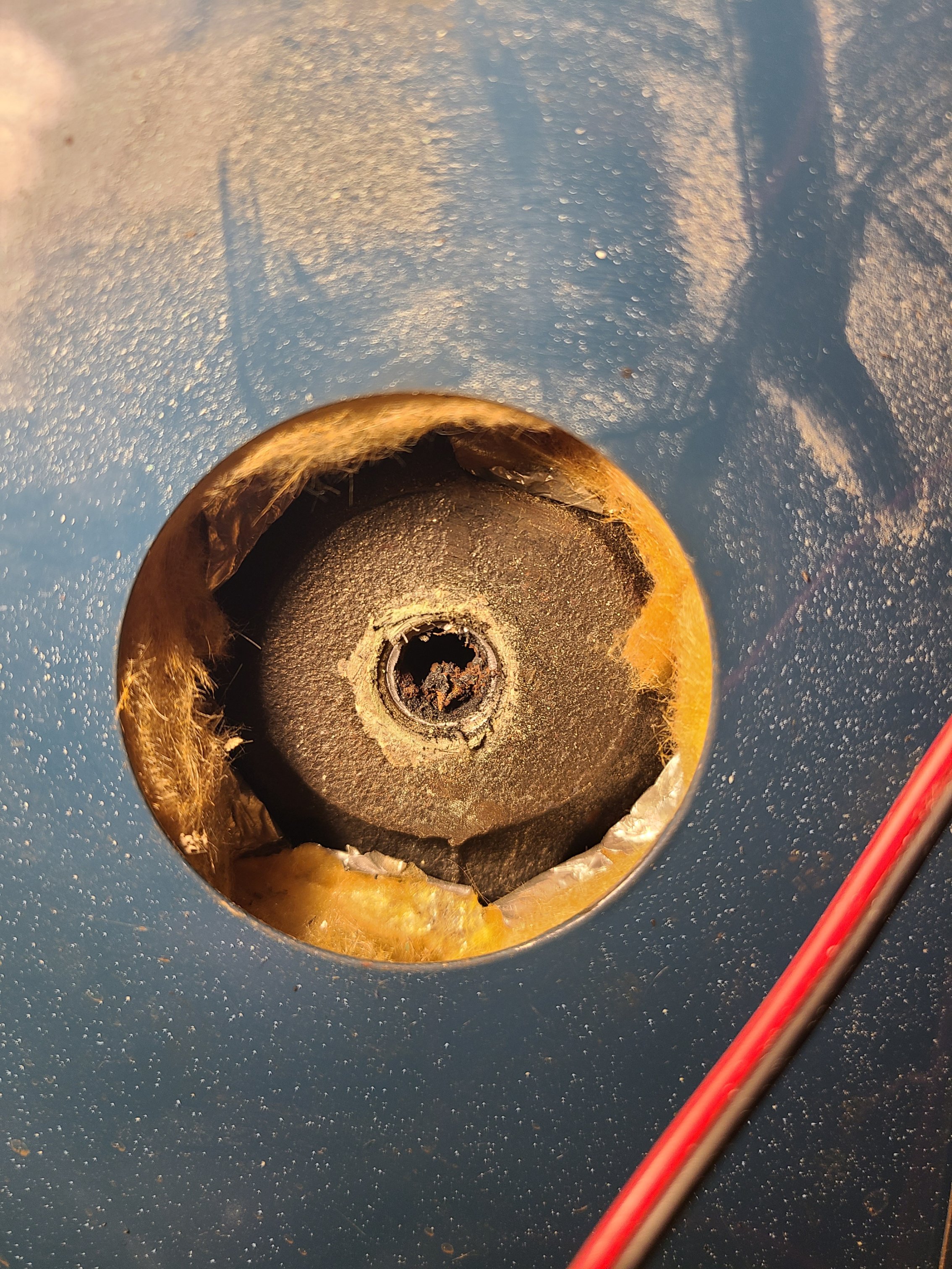

    The steel pigtail broke off with a little tapping and a little torque.
    Now what?
    Best methods for getting that out?
    Drain first, penetrating oil or no?

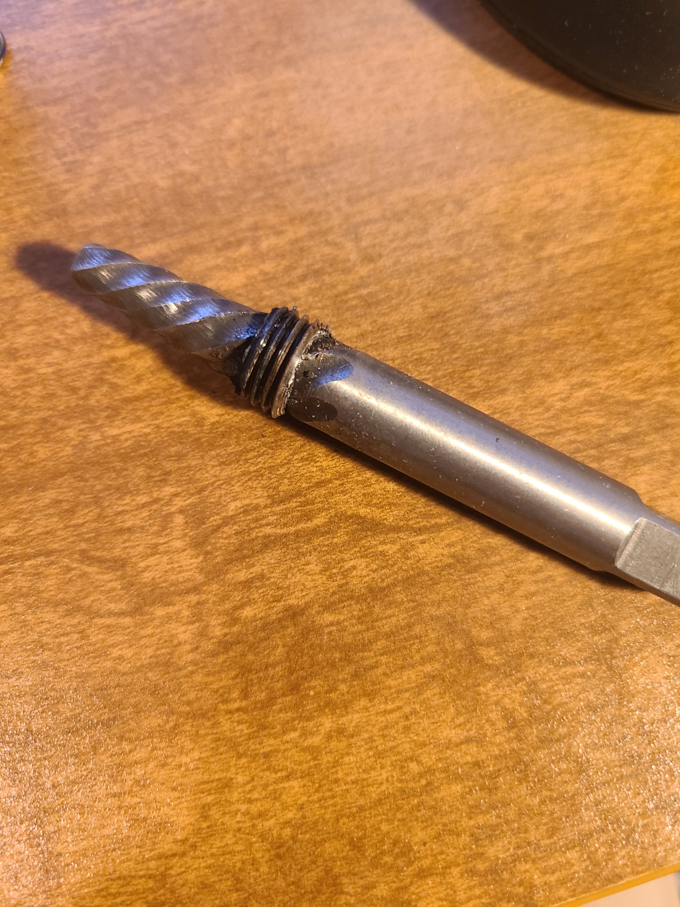

    Harbor Freight screw extractor worked. It'll be a cold night but ill sleep better knowing now all I need is a new pigtail in the morning.
    Just stick the vapor stat on with a 1/4" nipple and elbow. Not having a pigtail for one night won't harm the control
    Just make sure the control works and the boiler stops on pressure. For some reason you pressure is too high causing your issues.

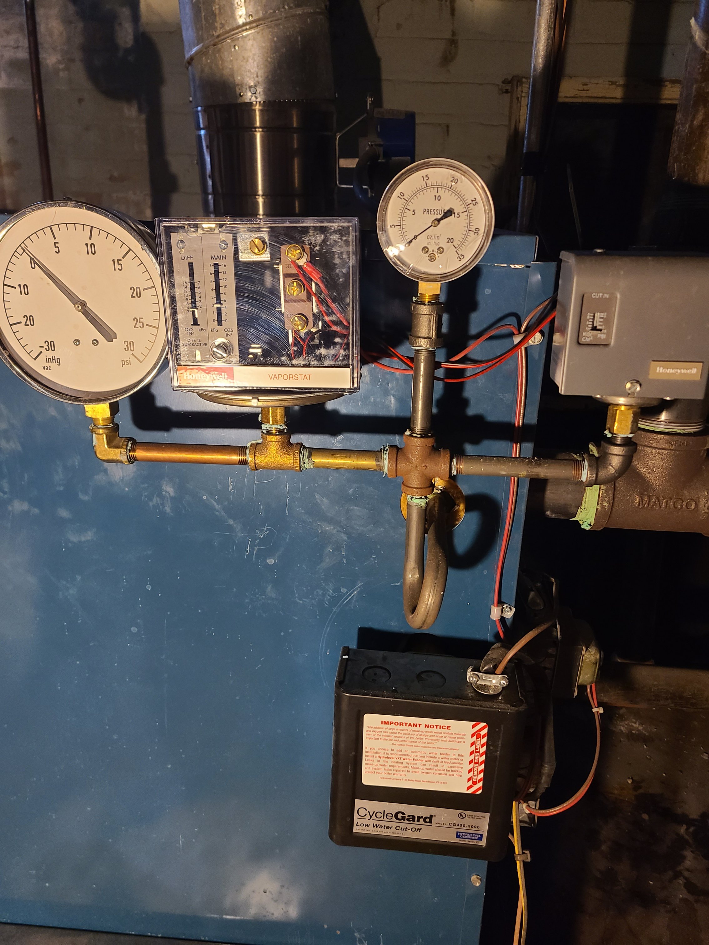

    Questions:
    The Vaporstat is designed to break the connection between the Line and the Load when the pressure reaches the Main setting. (in this case about 4 OZs/IN2) - Correct?
    The Pressuretrol (PA404A Additive Diff) is also designed to break the connection between Line and Load when pressure reaches the setting (set near 0.5 PSI). - Correct?
    There is a remote temp sensor installed on the main line out near the main vent (about as far from the boiler as possible) that is supposed to allow the boiler to continue to fire until the main gets to a certain temperature where the sensor is installed (to reduce short cycling).
    That should mean the temp sensor is Making the connection until the desired temp is reached, then Breaks the connection to allow the Vaporstat to manage the boiler. - Sound right?
    Boiler is shutting off at what could be 45-50 OZs/IN2 on the small gauge and about 3 PSI on the big "useless" gauge. Seems to be in the ballpark of 16oz per PSI.
    Question is: what device is cutting off the load at this point and why is the Vaporstat not keeping the pressure at 4 OZ?
    Does it make sense that the remote temp sensor has failed and is not "Breaking" the connection when temp is achieved? Thereby continuing to over-ride the Vaporstat until the Presuretrol takes over?
    Photos
    Line is connected to Vaporstat "R" terminal
    Load is connected to Pressuretrol "Left" terminal (I can't find a diagram or label for the Pressuretrol terminals)
    Remote Temp Sensor is connected to Vaporstat "R" terminal - therefore getting Line current. and also connected to Vaporstat "B" terminal (if sensor failed in a closed position - transferring Line to "B" terminal constantly)
    Vaporstat and Pressuretrol are connected by a double/joined black/red wire (twisted together) from Vaporstat "B" to Pressuretrol "Right" terminal.
    If Remote Temp Sensor has failed in a closed position - Line power is then being transferred from Vaporstat "B" to Pressuretrol "Right" terminal. (if failed is closed - which seems odd but possible)

  • neilc
    neilc Posts: 3,213
    you have too many wires on the Vstat,
    and the Ptrol, is that forked connector on/or off it's screw? a clearer picture there(??)
    the Vstat, what's the second pair of wire doing? nothing in the control / safety circuit should be wired parallel, it should be series wired, one wire in, one wire back out, to the next safety/control device in the circuit, or draw out and post what's doing there,
    and if you have a remote sensor, keeping the thing running, loose it, that's why your Ptrol / Vstat aren't controlling pressure,

  • 4GenPlumber
    4GenPlumber Posts: 176
    Agreed, by wiring a remote sensor parallel, you are giving the circuit a route to bypass the vaporstat. Take out the remote sensor(send Pic of sensor anyway).
  • 4GenPlumber
    Sorry, you already said you did that. To test, eliminate all redundancies. Use vaporstat as your only pressure control, fire the system. Stay and watch. If it passes the cut out, you have your answer. Disconnect one lead if it passes, you may have other bypasses wired in to your burner circuit (dont know why, dont understand the remote sensor either though).

    Apparently the pigtail/steam siphon was plugged. I have no idea what was shutting off the boiler. Maybe some steam pressure was getting to the Pressuretrol but not as much as was actually being generated.
