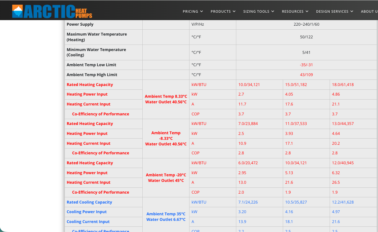

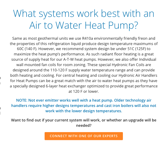

    Unless your heat emitters can cover the heating load on the design, -21F?? day, with 120F SWT, I would say no. That 70K load is a bit high also.
    Here is some info from Arctic on their cold climate models. A2WHP manufacturers have become a bit more realistic on how their systems can or cannot replace a boiler.
    Screenshot 2026-01-25 at 9.30.40 AM.png Screenshot 2026-01-25 at 9.32.19 AM.png

    Heat pumps work best when the differential temperature between heat absorbed and heat released is smaller. So an air to water heat pump really wants to use lower hot water temperatures than your underfloor system is probably designed for.
    Your underfloor system also probably won't be particularly useful for AC :) So to get AC you are talking about adding ductwork or air handlers to the first floor in addition to adding the heat pump.
    At that point you might as well consider completely separate heating and AC systems.
    I know that I sound like a broken record on this, but I think you will be best served with a fuel burner for heat and minisplits for air conditioning, and if the minisplits give you some shoulder season heat then that is a freebie.
