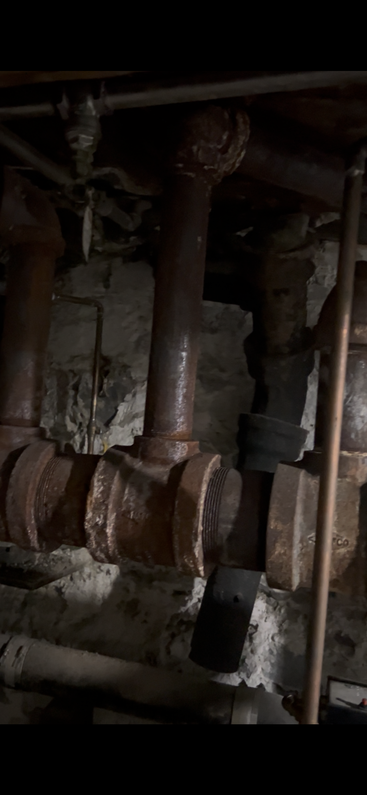

I have a Weil McLean, where there’s one riser coming out of the boiler and then it splits up into 3 mains. Radiators on one of the mains barely heats up. There seems to be no pressure building in the system. It never cuts out and the pressure gauge never shows any pressure. Is the issue the 3 mains? Is there an easy fix?
Photos from farther back and with more light would be better.
You can try slowing the radiators that do get hot in order to send more steam to the ones that aren't getting enough.
But keep in mind there could be failed vents at play, or sagged suppy pipes, things like that.
Yes, better pics from farther back, please.

is this boiler a coal conversion or is that a header from the previous boiler that wasn't removed and re-piped properly?
Do you know if you have any main vents? If so where are they and can you send photos of those as well. They should be at the ends of the mains just after the last takeoff to a radiator, or, perhaps they are back closer to the boiler. Take care of @EdTheHeaterMan 's requests first.
If you have a steam system then a properly working system won't show much if any pressure at all on the 0-30psi gage. Is this a new system to you or has it worked without this issue before and now recently it has the issue?
