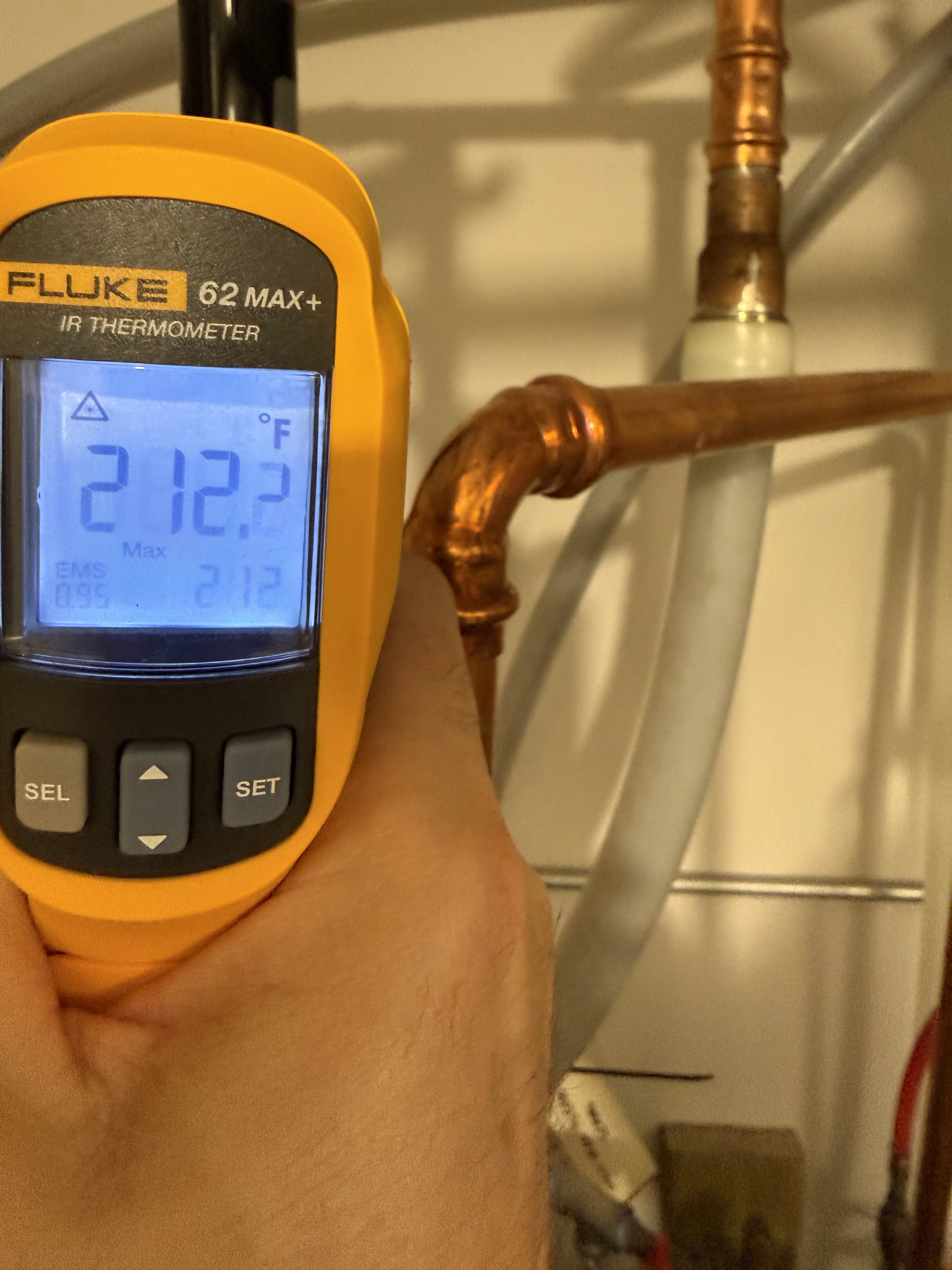

    hot_rod Posts: 28,708
    Having an electronic controller on a brass body with 240•°F water flowing would make me nervous, I suggest not trying that :)
    It would be good to find the data sheet on that thermostatic valve to determine it's capability and limitation. The DN numbers are usually an indicator of European origin. Any name on the knob?
    The valve obviously needs a cold return to blend the 220° water down to 140°. A temperature gauge on all 3 ports would give you some info to work with. It's hard to troubleshoot a valve like that without some data. Temperature for sure, flow would be handy to know also. That you may estimate based on the pump and the loop it is flowing through
    Even an inexpensive strap on temperature gauge would be accurate enough. Most VOM meters have temperature heads for reading two temperatures if you own a meter of some sort.

    I was thinking coming off the 1 1/4” pex with a Tee and installing a gauge like this:
    I actually ordered one of these a couple days ago and waiting for it to get to Home Depot to pick up

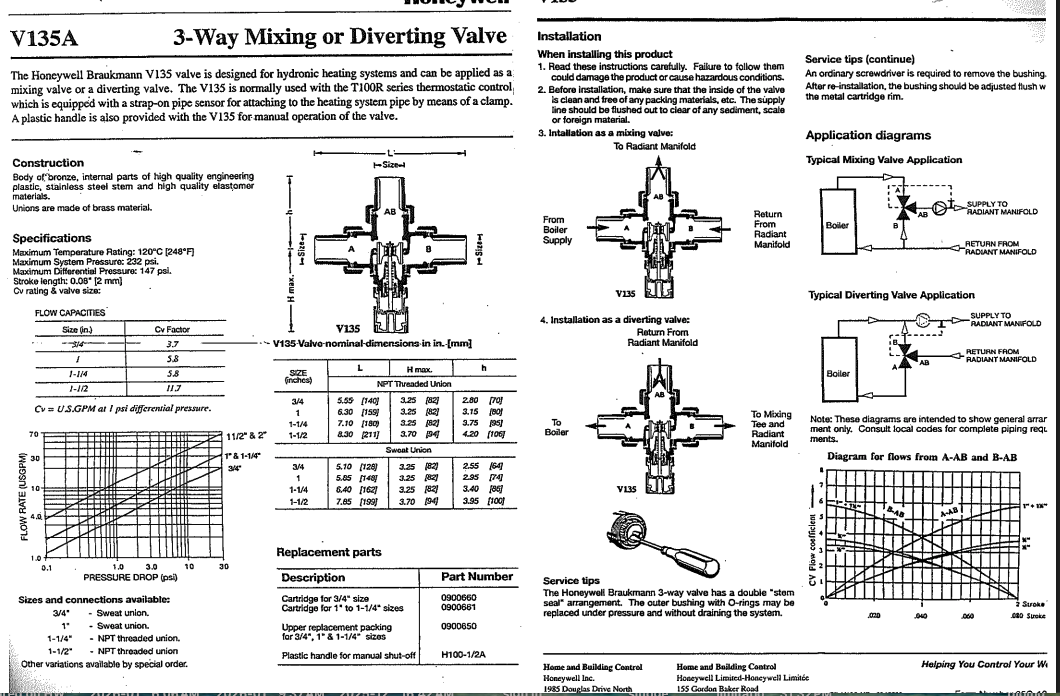

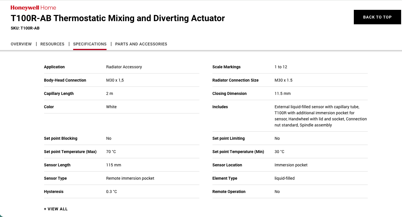

    If you have this valve, as far as I can see it needs to have some sort of actuator attached to the top if you want it to sense and respond to temperature.
    If not it is just a manual valve that can be set with the white knob adjustment.
    SO it can be a thermostatically controlled valve if the T100R/RS is attached.
    You need to confirm exactly which valve or combination you have.
    If it is just the manual valve, the YOU are the thermostatic actuator :)

    Is the actuator hiding in the box/package somewhere? I'm looking for @GroundUp insight if this actuator is required. He seems to have experience with this model. But it seems like the actuator would solve your current issue.
    https://www.supplyhouse.com/Honeywell-Home-T100R1012-Valve-Actuator-with-Remote-Sensor-86-158F
    In terms of your boiler short cycling bursts just to find the wood boiler is active.... What is the central control for your heating system?

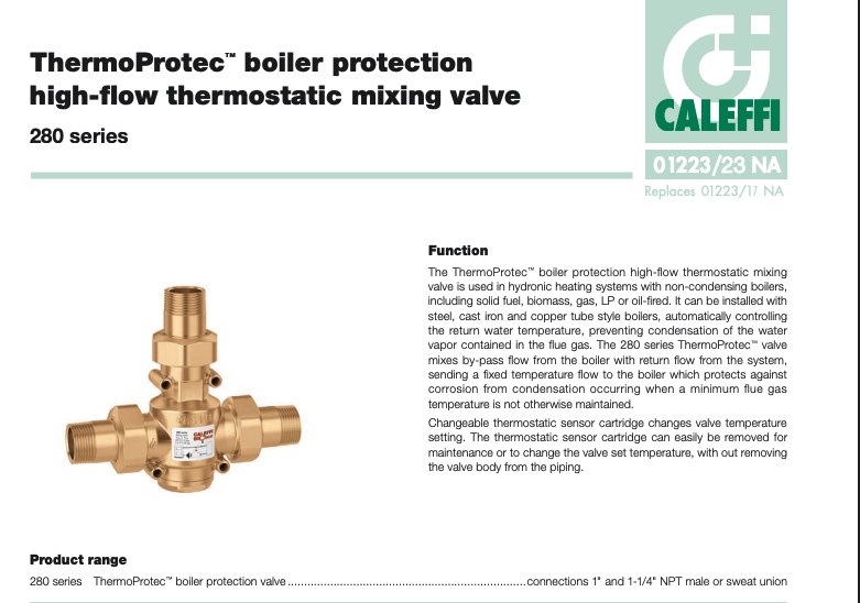

    The connection thread on a valve like that is pretty universal, various types or brands of actuators could bve used. Adapters are used for snap on type actuators like some Danfoss models.
    This would generally be a separate component, not boxed with the valve body.

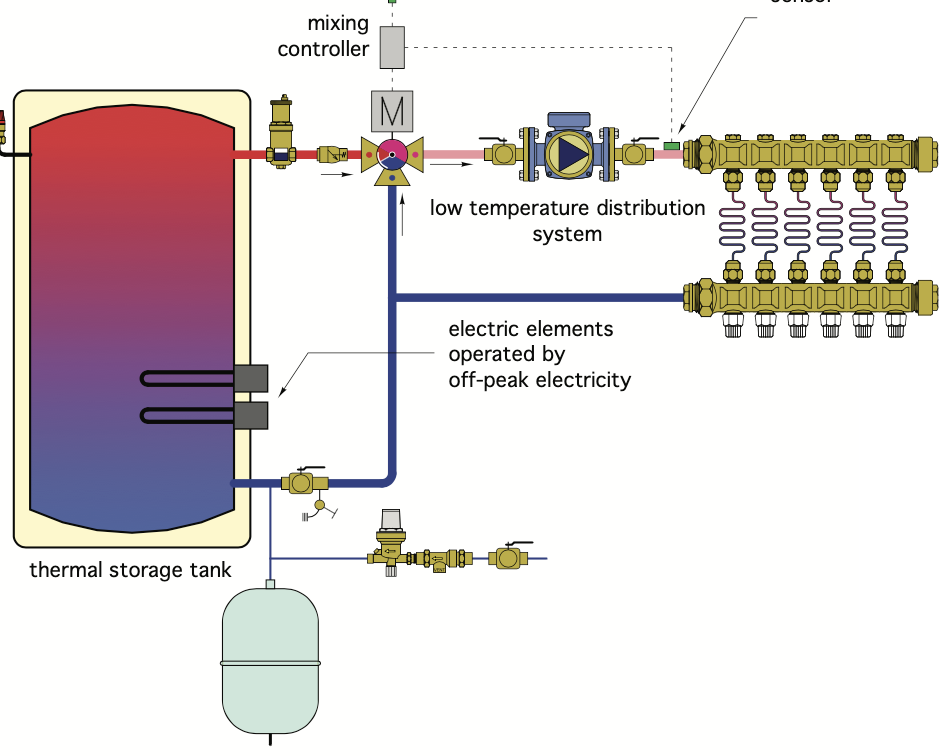

    There are so many different ways to control a hybrid system like that from simple to no so simple. It gets complicated blending various boilers and the various control they have, or may not have in your case :)
    I like to use a differential controller as it measures temperatures in two locations to make a decision.
    Here is an example close to your system, ignore the DHW component.
    You have some good components, you just need better control of them, better decision making controls. IF you want to optimize the system performance and efficiency.
    You propane boiler may have a high limit sensor, sometimes those are a manual reset style, a red button pops up to indicate it has tripped. You manual would tell you what the high limit protection is.
    Ideally, properly piped, the LP boiler would never see that temperature. It would only kick in when the return drops to say 120° The back up LP takes over only if or when the "big boy" has dropped off, cooled down to your lowest useable temperature.
    Think of the wood boiler as just a big storage vessel. The very best way to use that energy is to just "sip" off the volume (gpm) and temperature you need to get the job done.
    As such, pulling off that big storage with an ODR controlled device, be it a valve or pump, is the way you maximize the use of that big storage vessel.
    The very best place to store you energy is in the unburned firewood 🤗.

    The sensor goes downstream of the mix valve, so it sees the mixed temperature. Only the valve H port should see 200°F, the red line on the left of the valve in this case.
    Here is how a remote sensor is typically placed on the mix pipe 12- 24" away from the valve. This assures that the return and supply from the M port has blended to get an accurate reading.
    A mixing valve will always, must always have hotter water entering the H port, of course.
    There are better valves for that application. A fixed temperature thermostatic valve would be better suited, no need to fiddle with it, just select the temperature you want at the mix port and it adjusts accordingly.
    If your goal is to have a two stage mixing system? I don't think you are adding much efficiency by mixing from 200 to 170, then 170 to 120 or whatever the final goal is. The system will pull from the tank whatever flow and temperature it needs to mix to the final desired temperature and btu rate. The 200° stays in the big tank until it is needed.
    That valve and separate actuator seems like a complicated and $$ way to go about .
    This valve developed specifically for the wood boiler industry, has a high flow rate, simple installation. temperature gauge wells at all 3 ports to monitor what it is doing. It is generally used as return temperature protection, but can also be used in a diverting function.t

    The HW spec sheet on this specific actuator shows a a 158° mix max and a .3C differential.
    The M-30 X 1.5 is a common thread size, you might find different temperature range actuators from other brands, although 70C is hotter than most I have worked with. Caleffi is 120f max.

    The V 135 is a simple basic liner action 3 way valve, fairly low Cv. There is no temperature sensing component inside. It ships with a plastic "manual" knob. Here is an older cut sheet showing how it works inside.
    Any M-30 head could be added. These are options that could control that valve, typically used as radiator control. Three of these are, based on air temperature, or the top one with remote sensors strap on a pipe or radiator. I believe this is the type, T100R-AB, HW will supply.

    Thought I’d share after doing a little experimenting with this Fluke that I picked up today.
    Amazed at the efficiency of this 100 plate heat exchanger that someone recommended to me on here. Badger piping supply in Central Wisconsin.
    First pic is of the temp of the water being supplied out of the wood boiler. Second pic is the temp of the water headed towards the thermostatic mixing valve after it returned from the house floors and went through the house side of the heat exchanger. No wonder I’m getting such hot water across the room , I was expecting at least a 20F loss.
    wood boiler side a fairly short loop with 3/4” copper. House side 1” that expands into 1 1/4” pex to travel across room.
    Gauge seems very accurate - evidenced by when the flashing lights would go out on the Taco valves based on dip switch setting Max)
    I did watch the supply side of the Taco I-valves (what taco valves sending to the manifolds). It appears that they reset themselves after each cycle. Call for heat, flashing green lights and initially I get some pretty hot water heading towards the manifolds. Taco valves continue flashing as they adjust down to less than 130F (max based on dip switch settings) , and then the flashing lights go out.
    nice to have this gauge so I can see exactly what’s going on….
