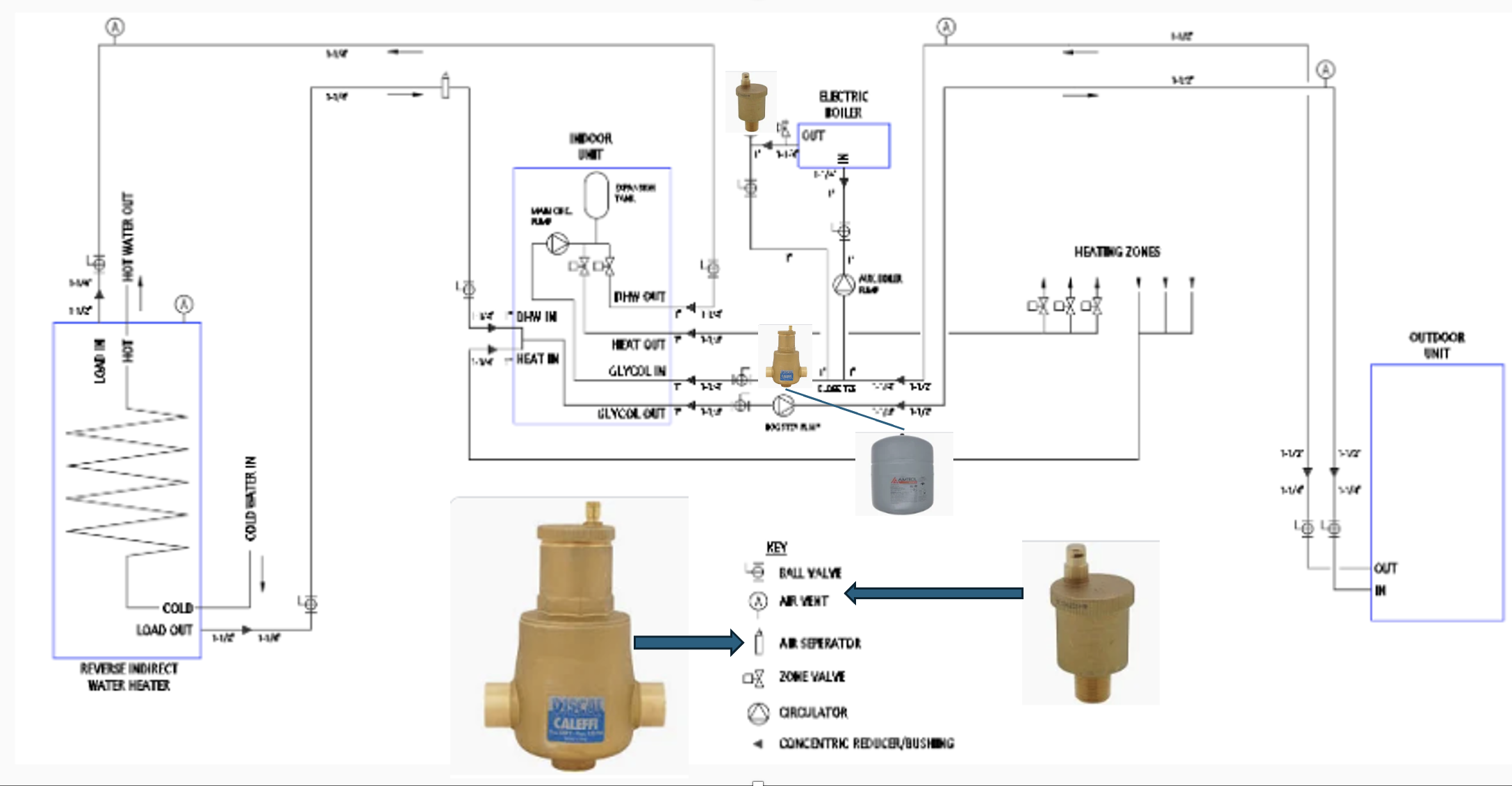

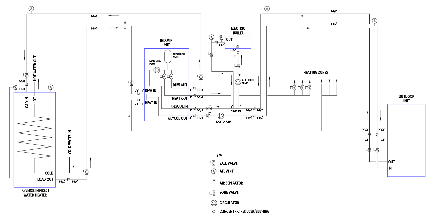

I'm installing an Entertech AWHP system. My layout is as follows:
(edit: updated drawing)
The install manual shows installing the provided 1-1/4" Taco 49-125C-2 air separator on the glycol return from the heat zones. I moved it to the return from the indirect water heater as I figure that will be circulating year round vs. just during heating season.
Because of space constraints, the runs from the indoor to outdoor unit, and from the indoor unit to the indirect tank all need to run at ceiling height. Am I correct in my understaning that only one air seperator is required per system, but I need to add an air vent (Taco Hy-Vent or similar) at every other high point i'm creating? If so, is a tee with a vent enough, or is a air scoop required for each vent?
Bonus question; Other then the heating zones, all the piping is Propress copper. The tank has threaded black iron stubs. Are dielectric unions required? I've read conflicting guidance on the subject.
Thanks.
    hot_rod Posts: 28,705
    There are a few ways you could do this. I put my air purger right at the outdoor module.
    In your case adding one here covers the HP, electric boiler, and indirect best. You wantb the air sep at the hottest point in the system. I'd like to see the expansion tank connected here also.Then both the boiler an HP pump would be pumping away., but.
    The expansion tank in the indoor module may not be large enough to handle all the piping? Plus use a glycol derate if you size a new one.
    If you do upsize the exp tank, connect it to the air separator at this location, then the boiler pump and hP pump is pumping away. I'd add a relief valve there also so if the boiler is valved off the HP still has a pressure relief function. My Viessmann HP wants a relief at the outdoor units also, incase it gets valved off.
    Put a float/ auto vent at high points like the boiler, use a good ball valve below it for easy service.
    Looks like you are running the entire system with glycol. I used a plate HX at the indoor module, so only the HP loop has glycol. Glycol is an expensive, somewhat messy fluid. It has been know to leak (green fuzz) around press fittings from time to time.
    Yes you can screw the propress adapters onto the black nipples, although some installers like to have unions on and tank or boiler connection.

    The 80gal indirect tank is included with the system from Entertech. The 50' of 1-1/2" loop pipe is from the chart in the manual. I'm hoping, they did the math correct on the integral expansion tank.
    I like the idea of the plate exchanger as 100 gallons of glycol mix isn't cheep. Unfortunately, the indoor unit is completely integrated into the heating and DHW loops, so not sure how I would separate out the loops.
    I'd be all for replumbing so the outdoor unit just keeps the indoor tank hot through a heat exchanger, then take heating load (minimal in my case) off the spare taps in the tank (buffer tank style).
    Enertech says that's not efficient and wants to drive the heating loops directly from the outside unit upon heating call, shifting flow away from the DHW loop.

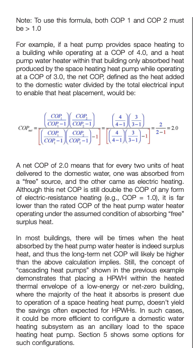

    Cascading heat pumps may not be more efficient then using the indirect, depending if there is "free heat" available. Here is the math for a 3 COP HPWH in a space heated by a 4 COP heat pump
    Screenshot 2026-01-21 at 1.56.40 PM.png Screenshot 2026-01-21 at 1.57.16 PM.png
