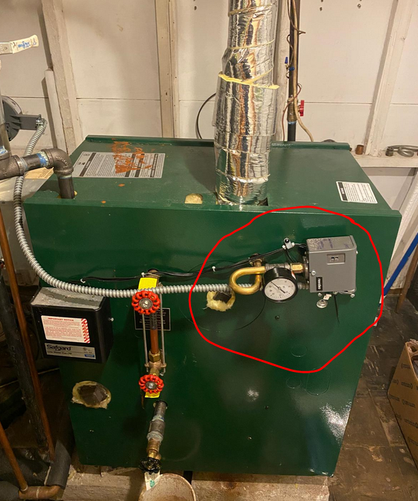

The boiler looks almost new. Its a williamson boiler 100K BTU Steam gas fired.
Noticed that pressure guage is almost horizontal and the pressure cut off is set at 8 PSI. Wonder why this is horizontal, is it ok to have it like this ( see picture). I can certainly adjust the cutoff to 2 PSI by adjusting the cutoff valve. Also the radiator vents are hissing loudly and am told the steam is kind of pushing hard to get in the radiator. Usually with steam systems there shall be little to no hiss on the vents, isnt it.
Does williamson ship boiler like this and did the installer forgot to change it to vertical, does the position have any affect given the pg tail ( looop) is there.
Please advise.
TIA.

    That is not the factory installed position. I bet the installer had no clue. Can you take a few steps back and tank another picture so we can see the pipes that connect to the steam main. I bet you that they are all wrong.
    When it is operating, are there any problems with noise, or unbalanced heating of the building?

    I agree with you Ed, the installer had no clue as to what he was doing. The water in the sight glass is horrible.
    Another clue was the sloppy install of the BX cable from the damper to the pressuretrol.

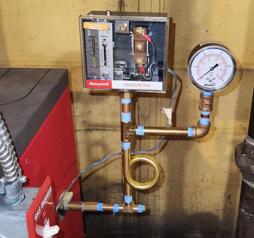

    The pigtail to the pressuretrol pipe should be vertical like this. Water is trapped in the bottom half of the pigtail to protect the pressuretrol and gauge from the steam. The way yours is it won't trap water.

    I would guess the installer had no clue. In my 53 years in the business I have never seen a pressure control mounted like that.
    But I don't think you can blame the installer for the wiring between the pressure control and the damper that is likely a factory whip.
    I too would like to see more of the piping. Looks like some copper on the return which may be ok
    And in the meantime see if you can turn the pigtail and pressure control so that it is correctly oriented — and dial the cutout pressure down to 1 psig.

  • If i just turn the control counter clockwise to orient it correctly would it be fine.
  • How much should the gauge be set at.. I know there is a screw at the top to adjust the cut out pressure, what should that pressure be.
    The gauge? Just measures. The pressuretrol — the blue-grey box — does have a screw at the top, and it should be turned to set the index a bit below 2.
    109A_5 Posts: 4,759
    The screw at the top should be adjusted so the indicator on the front should be just at the bottom of the scale, about 0.5 PSI. Take the cover off and the white knob inside should be set to 1, the number 1 faces the front.
    If the pressuretrol does not work reliably at those settings raise the 0.5 maybe a 1/2 turn at a time and re-test.
    109A_5 Posts: 4,759
    Turning the pigtail back 90 degrees may work fine. However that is usually not best practice with tapered pipe threads. Watch for leaks over time.
    My bad above. @109A_5 above is correct — the index should be set down to just above the 0.5 mark.

    assuming there is water left in the pigtail. it is prob pretty empty in thst current position
    ethicalpaul Posts: 9,076
    Water will fill the pigtail after it is oriented correctly, from the condensation of steam within it
