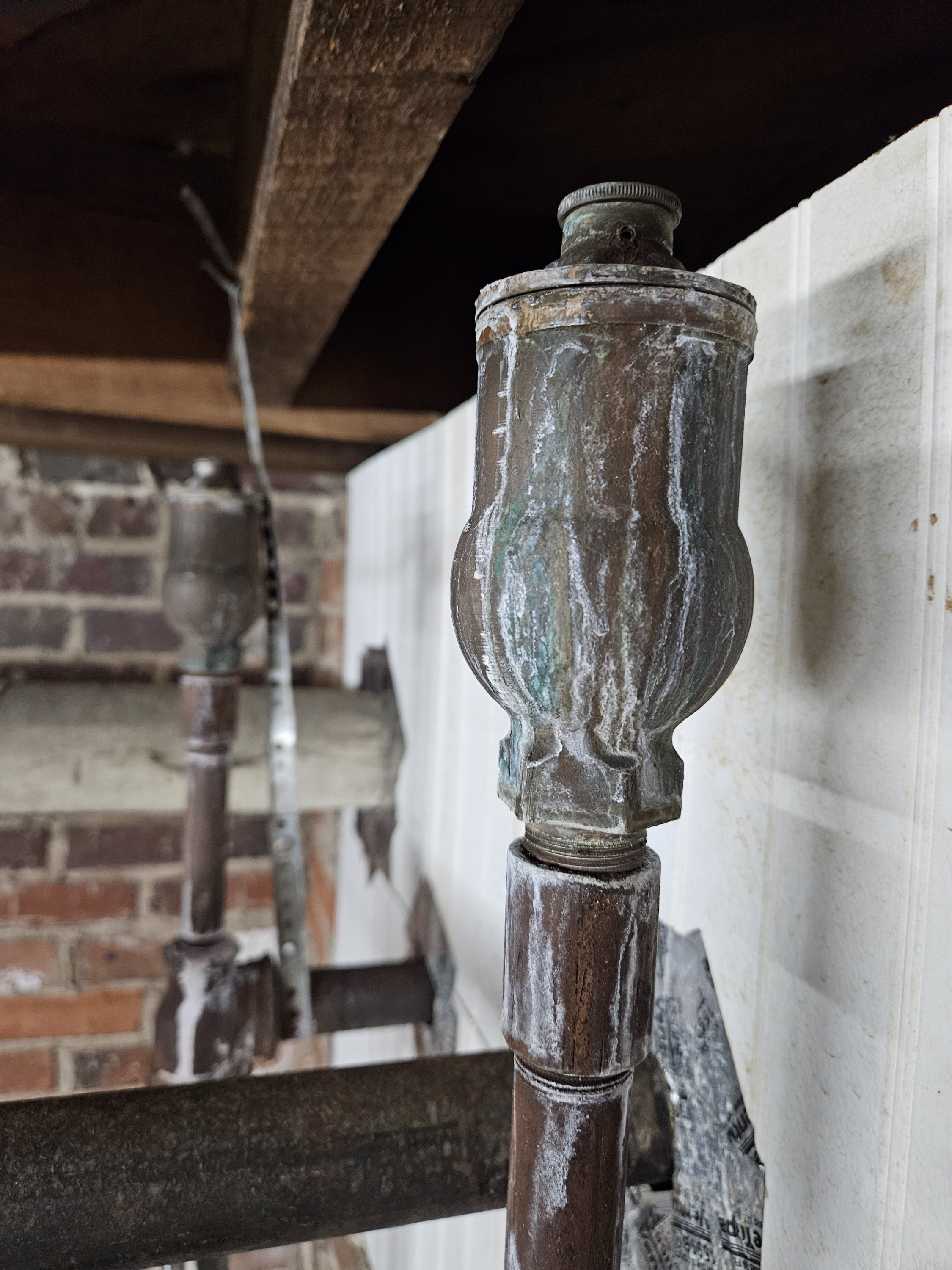

I have a Warren Webster type R two pipe steam system. The air vents in the basement are gurgling and the boiler water seems to be discharging out of them. We have 13 radiators and about six are now not getting hot. I have replaced the steam traps in the radiators with the Tunstal steam traps. Definitely helped. Now the air vents on the returns are being problematic. What is the best fix for these things? The system is 95 years old. The boiler was replaced in the sixties but works great at creating steam and pressure. The system runs between 1.5 and 2.5 psi.

    The vents are probably toast. Just replace them with Gorton #2s.
    Then before anything else gets ruined, get a vapourstat to control the system pressure. Your system should run at between 4 OUNCES per square inch and 8 OUNCES. Half a pound. 1.5 to 2.5 psig is way too high and will cause the system to work poorly if at all (may be why some of your radiators aren't heating).

    I ordered two Gorton air vents. The pressure gauge on top of the boiler has no markings for what scale it measures. The pressutrol on the side is dialed down as low as it can go for cut in and cutout pressure. The boiler seems to get the pressure up in about twenty minutes from a cold start then cycles on and off in two minute intervals to maintain pressure.

    I replaced the dry return air vents with the Gordon #2. No more gurgling and spitting.
    I replaced the Pressurtrol with the Vaporstat. I am now running between 4oz and 8oz of pressure.
    I also removed the air vent on top of the steam trap by the boiler. My understanding is that was to take care of any vacuum in the system from the coal days.
    All of the radiators are now getting hot. The boiler is now short cycling, on for 30 seconds off for 30 seconds. I guess that is due to the pressure being so low on the Vaporstat. The water level is also all over the sight glass. In the previous picture it is down to the cutoff level but will shortly rise again. Not sure why is happening with the low system pressure. Also I am not sure if I should replace the air vent on top of steam trap with a Gordon #2, a Hoffman main air vent or a plug with a a couple of holes in it?
    The vent in the middle of the lower picture is what I took off the steam trap by the boiler.
