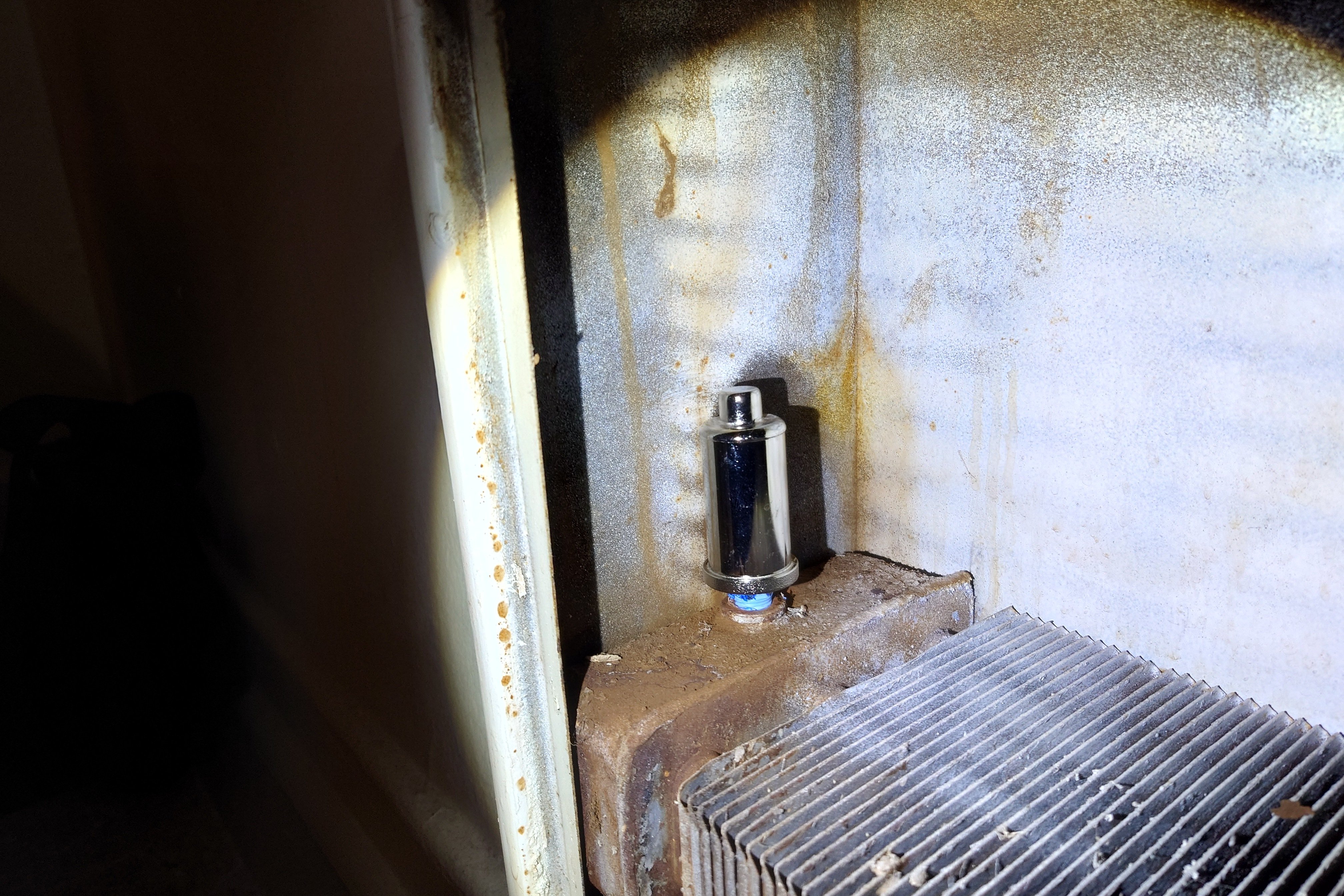

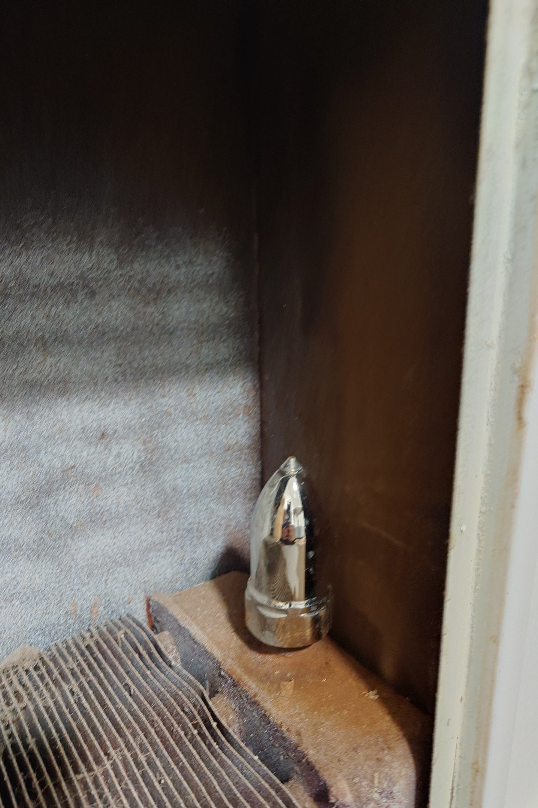

I'm living in an apartment that uses steam heating with one pipe radiators. I've never had steam heating before, so I don't really know what to expect from it. With that said, dealing with it in this apartment has been a bit of a saga; the whole system has gone down more than once this winter.
Speaking of, it went down last weekend (Jan 9th) and it was apparently fixed the following Monday (the 12th). I still wasn't getting heat and when a maintenance guy came they ended up replacing all of the air vents (? Steam Bulbs? See bellow.) That fixed the heat issue, but afterwards, the radiators began hissing and spitting much louder than they were before and for much longer. More importantly, this caused as significant increase in humidity in my apartment, to the point where it when up to and above 80% humidity multiple times and the only way to deal with that is keeping my windows open, which can cause things to get too cold between cycles.
Today, the maintenance guy came back and basically said there was nothing he could do, because the system is supposed to work by cycling steam into the apartment to heat it, so this is normal behavior. If I want to do something about it, apparently I need to complain to the front office and hope they, maybe, send a specialist.
That doesn't seem correct to me, primarily because 80% humidity is insane, but maybe I'm wrong. Could you help me understand what is reasonable to expect from this system. If it's not this, what might be going wrong and how could I explain this to maintenance and/or the front desk?
If it helps, here are some pictures of the parts that were replaced and one of the radiators:
These are the things that got replaced. I'm pretty sure most of the radiators in my apartment have the conical versions, while only the largest has the cylindrical one.

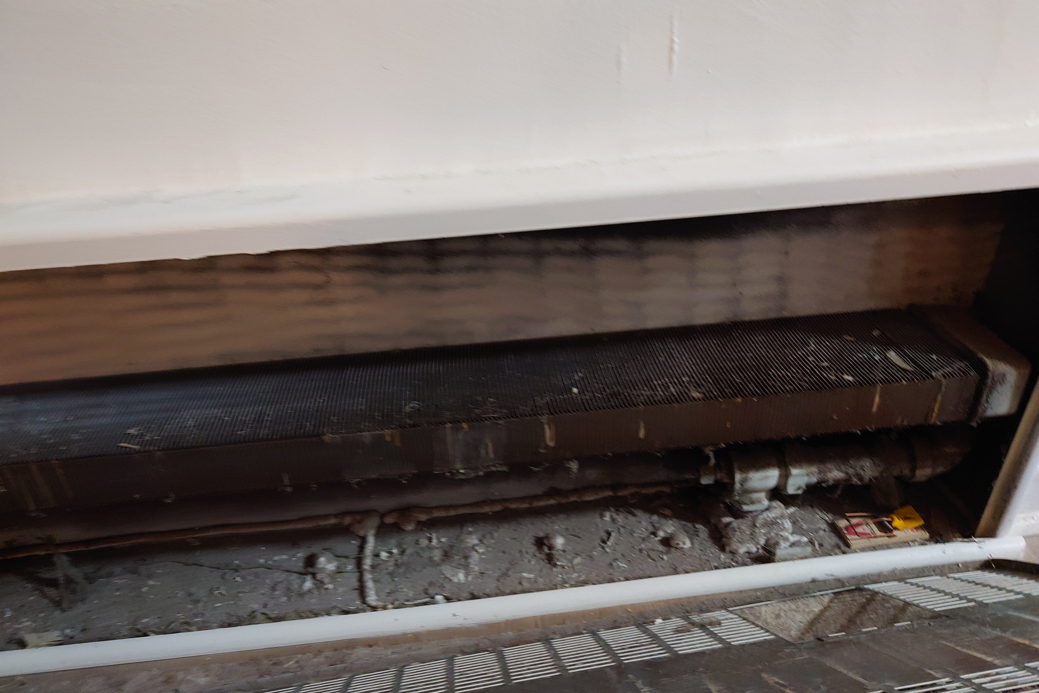

And here's a picture of that long radiator.

    The air vents they installed may be defective and leaking steam resulting in your high humidity problem. Try holding a mirror over the air vents when when is actively running and see if it fogs. Keep your hand away from the vents because if they are leaking that steam may burn you like a tea kettle would.
    EpsilonRose
  • I don't have a hand mirror, so I just used a spoon and it didn't so much fog up as become visibly wet.
    either way the vent is leaking a lot. could be new vents that are bad or excessive pressure settings at the boiler.
    EpsilonRose
  • Makes sense. Is there any thing I could show them to convince maintenance/management that it's not supposed to work this way and get them on the right track to figuring out what's wrong? I have the feeling that they don't have the best grasp on how to properly maintain the system.
  • Vents, even straight out of the box, often malfunction. Their manufacturing tolerances are low.
    High humidity = a vent (or a bunch of vents) that doesn't close when steam reaches it.
    The steam heats the radiators (inside) and those radiators heat the space. There should be no steam in your space.
    For what it's wort, i've made a series of videos about steam vents (and their high failure rate) on my youtube channel. (in my signature).
    EpsilonRoseRobert_H
  • I'll give them a look. Is there anything you can do to fix the vents if they're the issue, or are you stuck replacing them until you get a set that work?
  • stuck replacing them until they work.
    My bet is they are running the boiler pressure higher than the air vent rating and they don't have a clue. They just probably replace the boiler every 5 years from excessive make up water.

    Clarify for the front desk or maintenance guy that the air vents on the radiators are supposed to let air out only until the point that steam reaches the vent at which time the vent is supposed to close. No steam should ever enter the room from a steam heating system. If it is, the vent is not working.
    If they want to understand why the vents may not be working have them come to this site and maybe we can figure it out together. Not sure where you live but maybe you could convince them to bring in a steam expert, one from the listings on this site.
