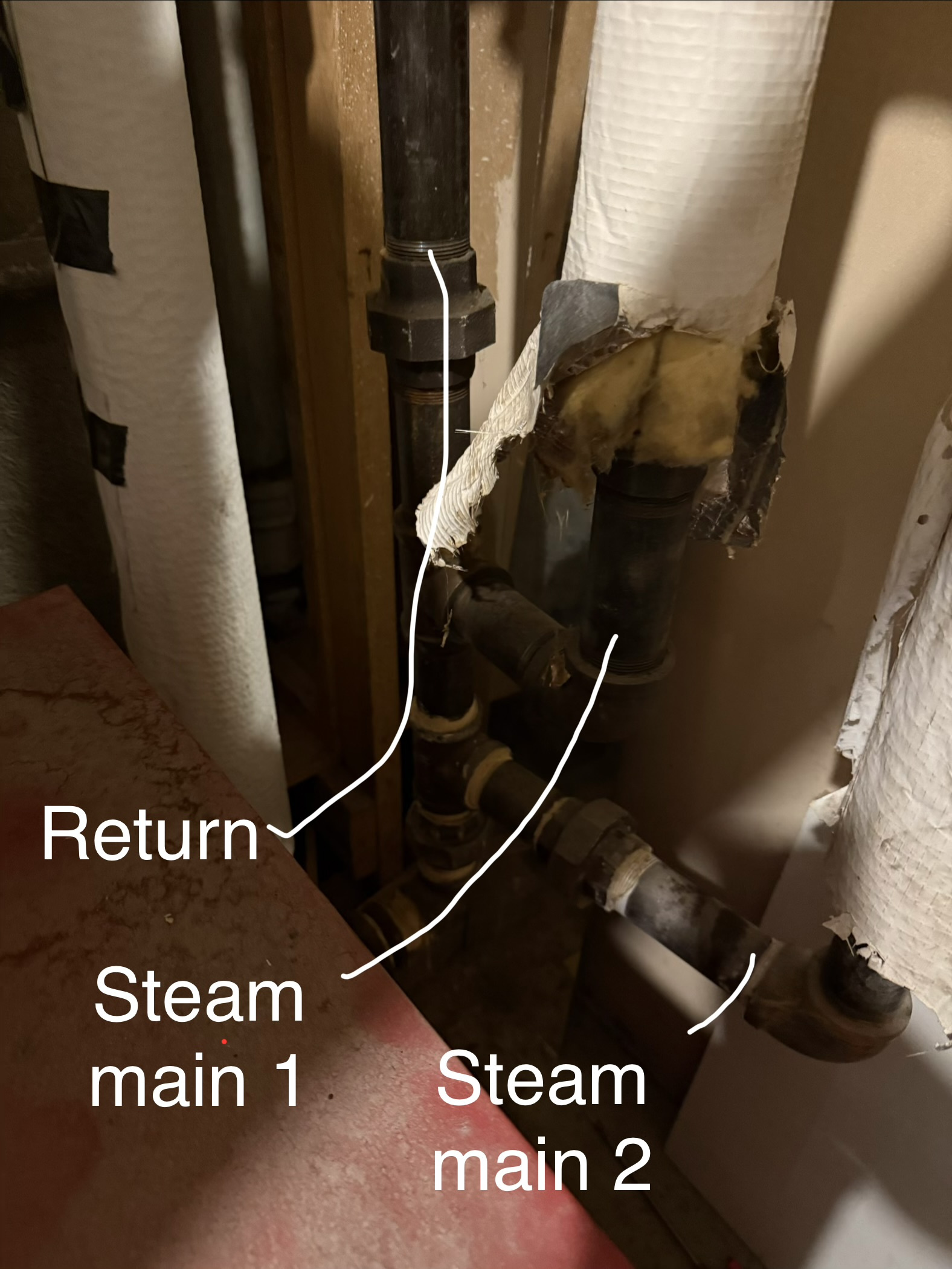

Working with a technician to rework the return (Dry and drip returns for two steam legs) at the boiler. Question I have (have not asked technician yet); Can the pipe size of the steam drip returns be reduced from the 2 inch it currently is to say 1 or 1.5 inch? Example:

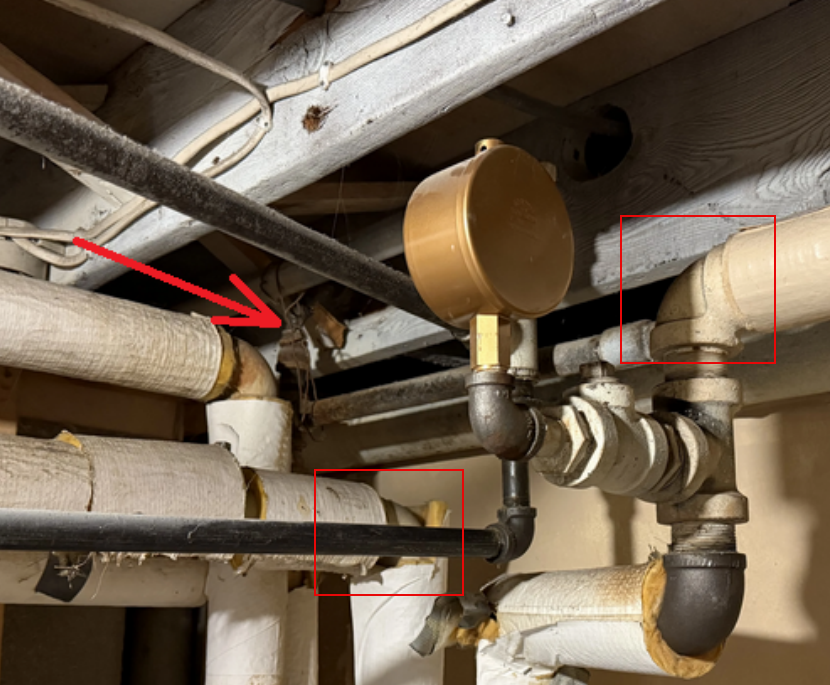

The picture above 'Steam main 1' and 'Steam main 2' are the ends of each of the steam mains (drip return(s) I believe is correct nomenclature?). Can these pipes be reduced in size from their 2 inch current size to either 1 or 1.5 inch at the ceiling above the boiler? Example:
The red squares are the end of steam legs above the boiler. Can these be reduced to 1 or 1.5 inch via an elbow change at the ceiling? The lines will then be brought down to the floor, joined with the dry return then connected to the equalizer at 2 inches below water line to make the Hartford loop. Or do the lines need to remain 2 inch to the floor?

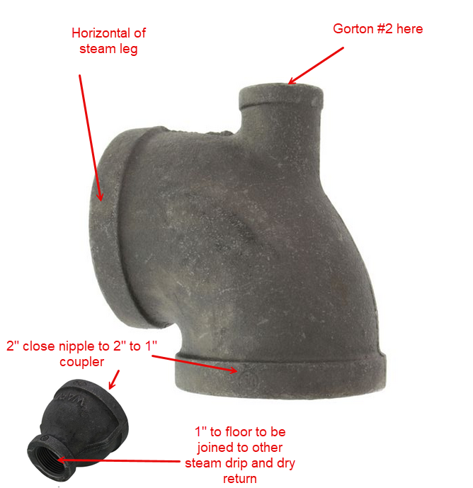

    Here is a visual of what I'm thinking:
    The elbow would be rotated 90 degrees so that the gorton #2 would be vertical not sideways (couldn't get vendor picture to rotate ;)

    mattmia2 Member Posts: 17,902
    1" would have no problem carrying the condensate, the only concern i might have is with it clogging over time. you can use copper once you are below the water line. I'll let the experts comment on what size is needed to keep it from clogging. A tee and a cap or valve at the bottom to flush it would be good too.
    Jamie Hall Member Posts: 27,697
    1" might do in a pinch. I'd rather see them reduced to inch and a half, with the reduction in the vertical.
    And as someone @mattmia2 suggested, I'd connect all four lines together very near floor level with what is essentially a manifold with an extra T and a plug at each end to make it easy to clean out.
    The FOUR lines are "Steam" line 1 (dry return from one steam main), "stearm" main 2 (dry return from the other steam main),"Return", and the line back up to the boiler inlet.
    markmarlatt
    1" is more than enough to drip a 2" main. Copper is ok only below the boiler waterline if that helps. When you come out of the tee for your vent I like to raise the vent up as high as possible to keep water out of the vent.
    It might be simpler to put a 2 x 2 x vent size tee on the end of the 2" main then a nipple and a 2 x 1" 90 degree elbow for the drop
