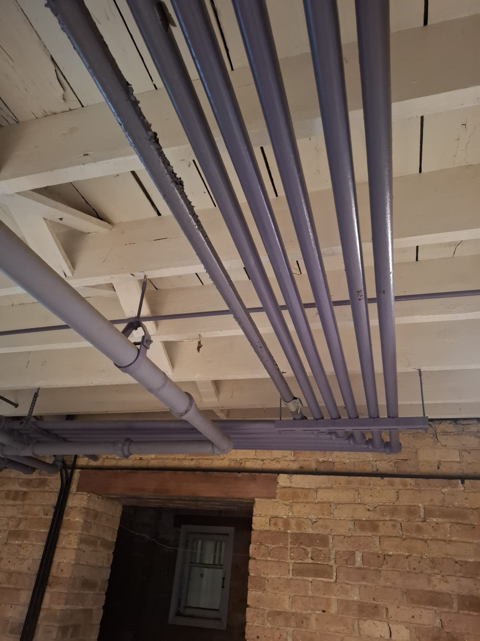

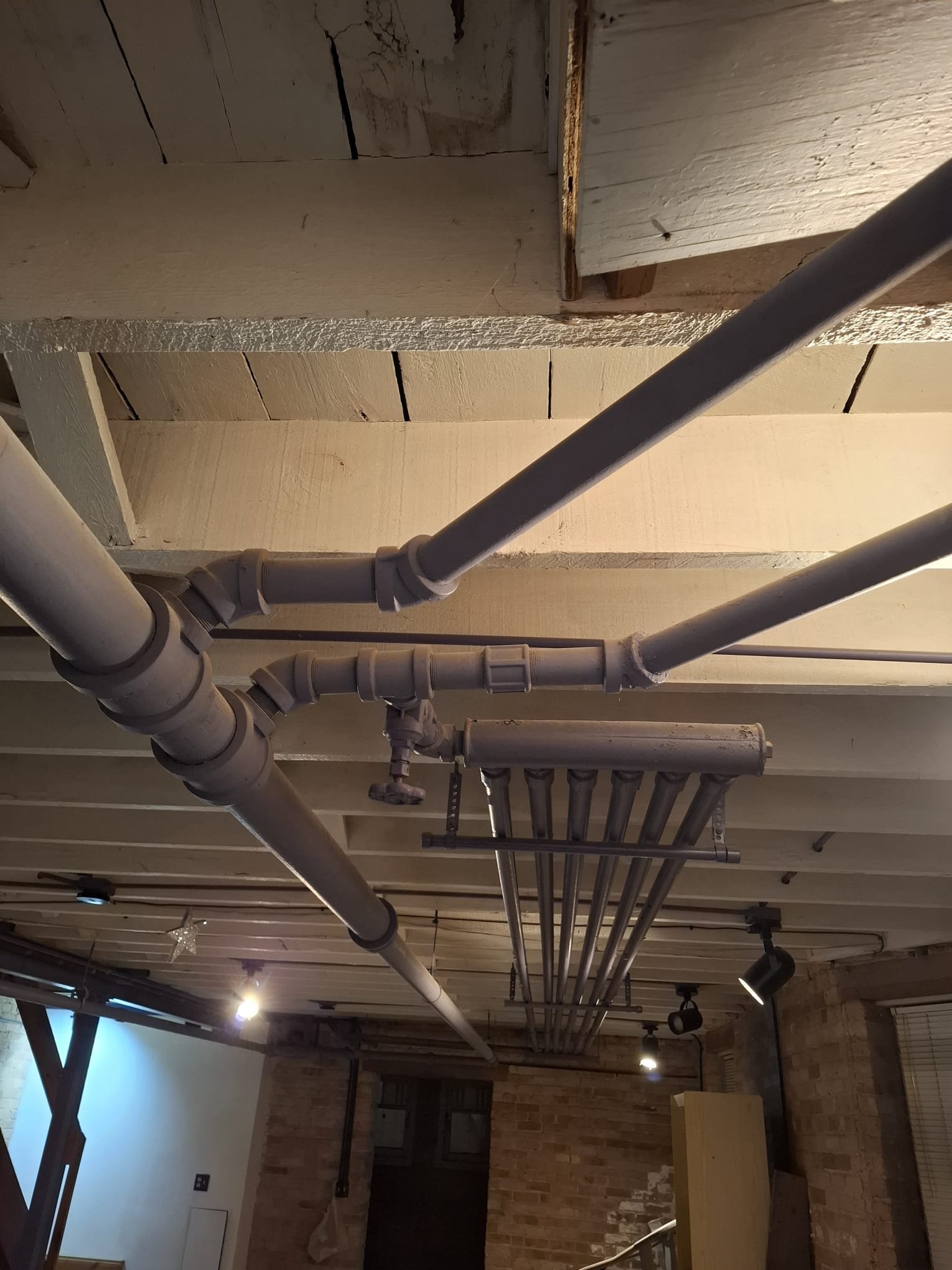

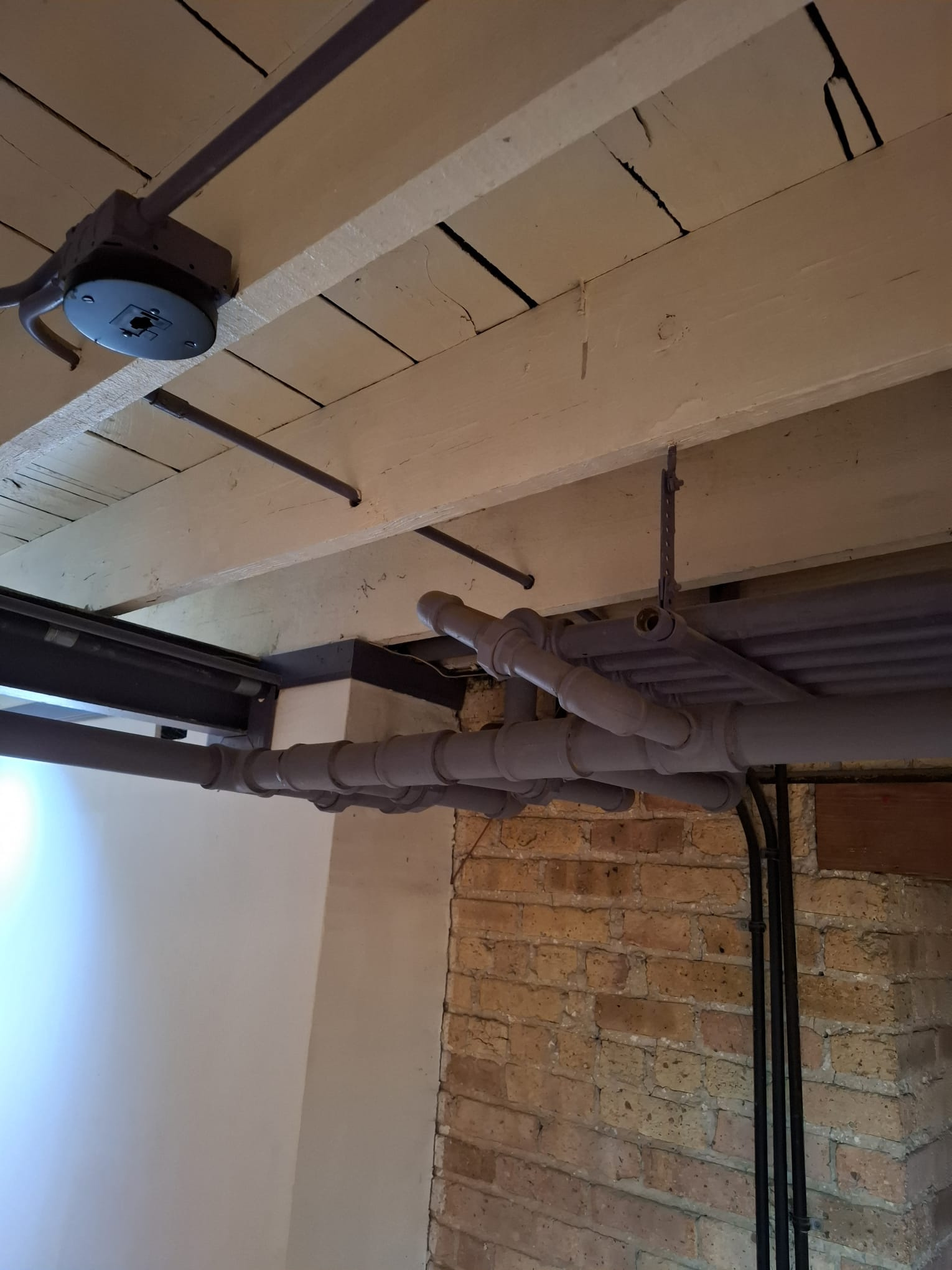

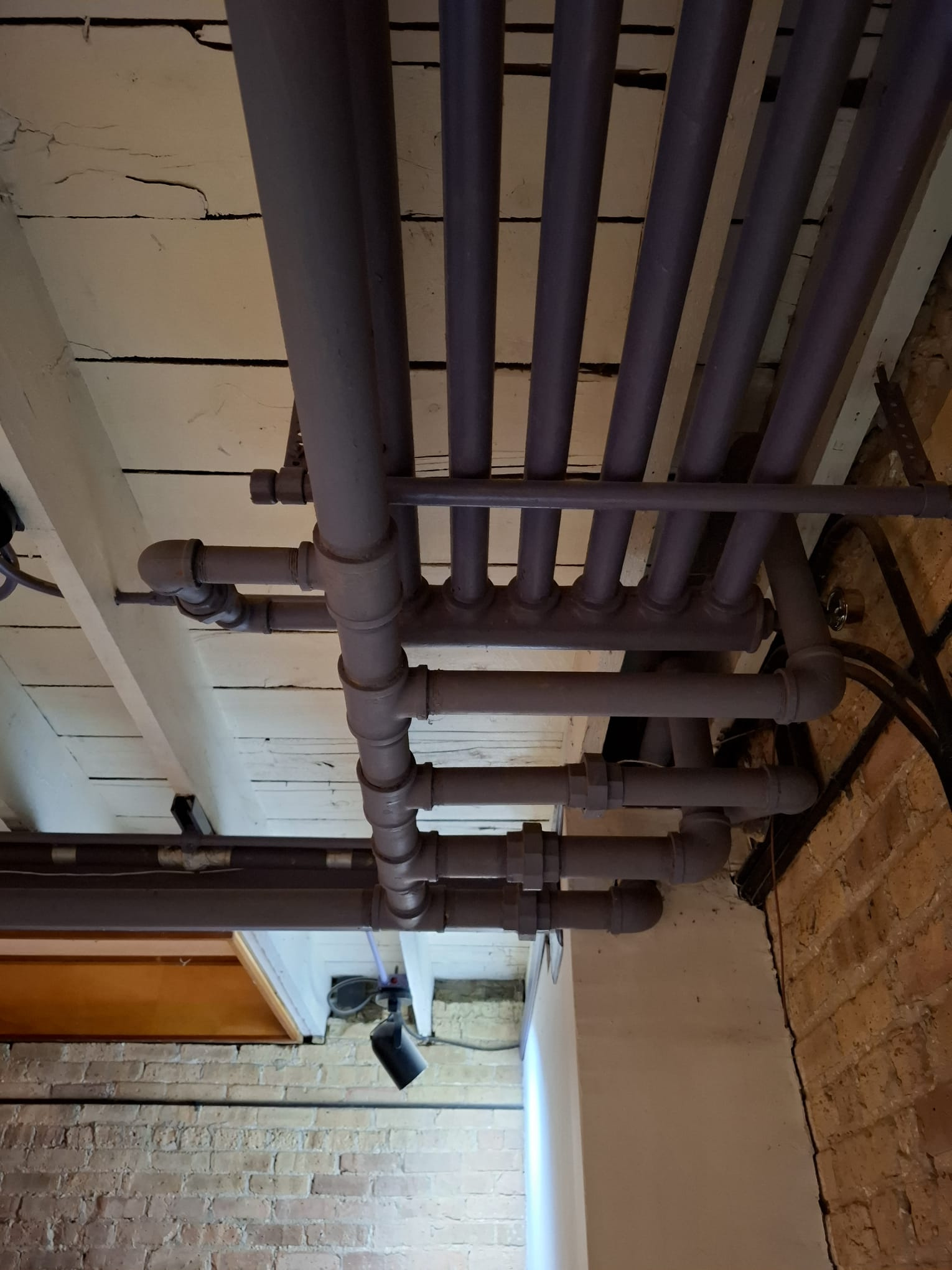

Came across that set in the building, as far as I can understand one side feed/supply to those organ pipes, its kind hard for me to wrap around that bridge from the main to the vent side,
Its one of the 'loops' on classic C shape 3 stories 6pack apt building, also 19in 14x6 rads above wont getting enough heat even without vents,
Celling Rad 1.jpeg Celling Rad2.jpeg Celling Rad3.jpeg Celling Rad4.jpeg Celling Rad 4a.jpeg
Supply side is getting warm, and the top on the vent side, middle is cold,
2 of those T are supply for directly above 2 'puppies' 3rd goes to 2nd & 3rd florr 'puppies' and 4th for small corner 4 sections rads on 2nd & 3rd,

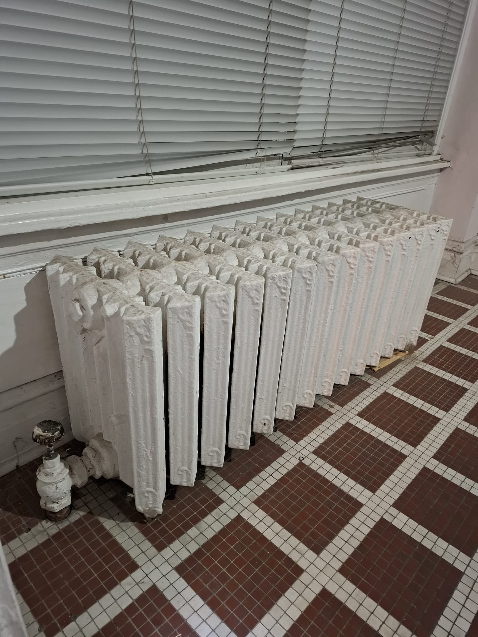

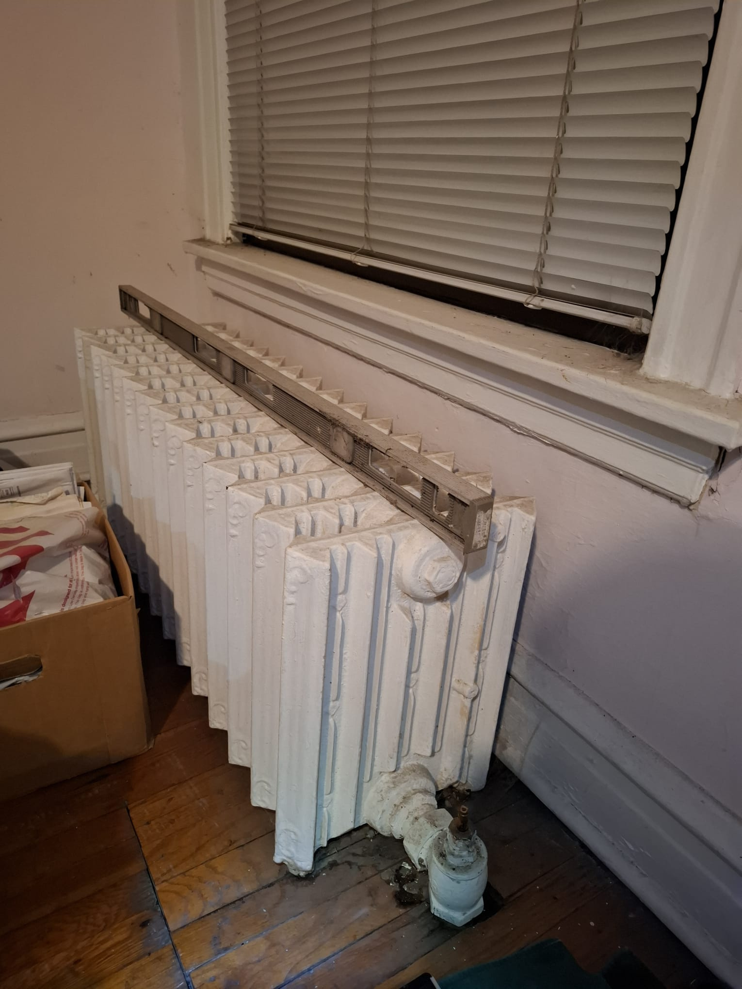

Below are the puppies:

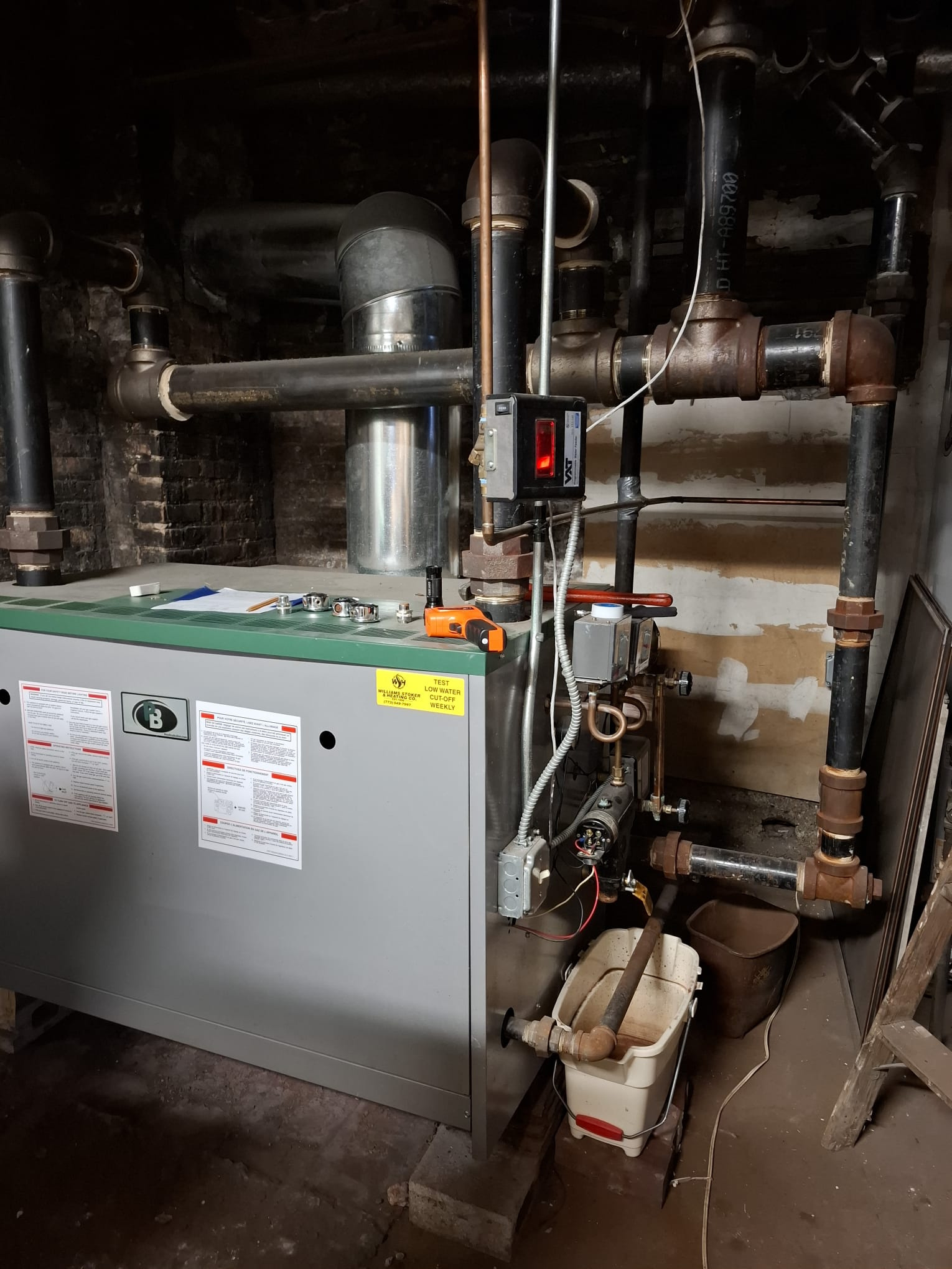

My main concern is Puppies are not getting hot, 1hr15min cycle, dry return is coming hot, main is not insulated coming throu boiler room part, i shimmed Puppies for slop, new Mist-o and Valverine, but it doesnt matter vents or no vents, next thing tonight I will close the pipes off, there is only one supply valve on the feed side and union on the vent side (shall I disconnect it too)?

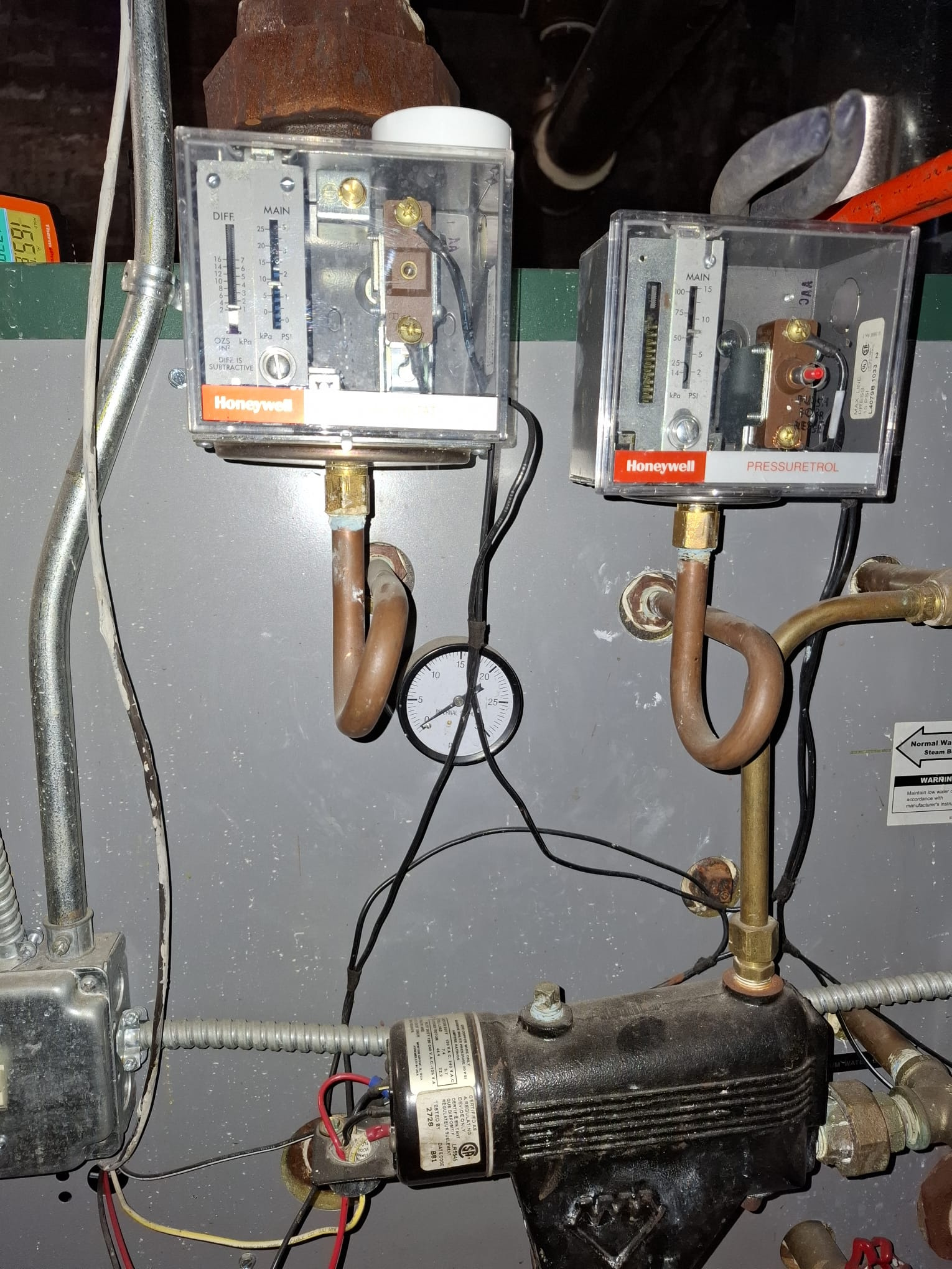

Yes - 1 pipe, dry return, 575BTU Peerless 5yo, Looks like guys installed it and run away in the middle of the job, all pipes bare, vents upside down or painted or sideways, some rads closed up, gauge improper, didnt check the pigtails will clean them up tomorrow, cout off was cleaned up weekly at least,

    Looks to me like steam is heading up the return end & closing the vent before all the air is expelled. That doesn't look like much vent for all that piping, either.

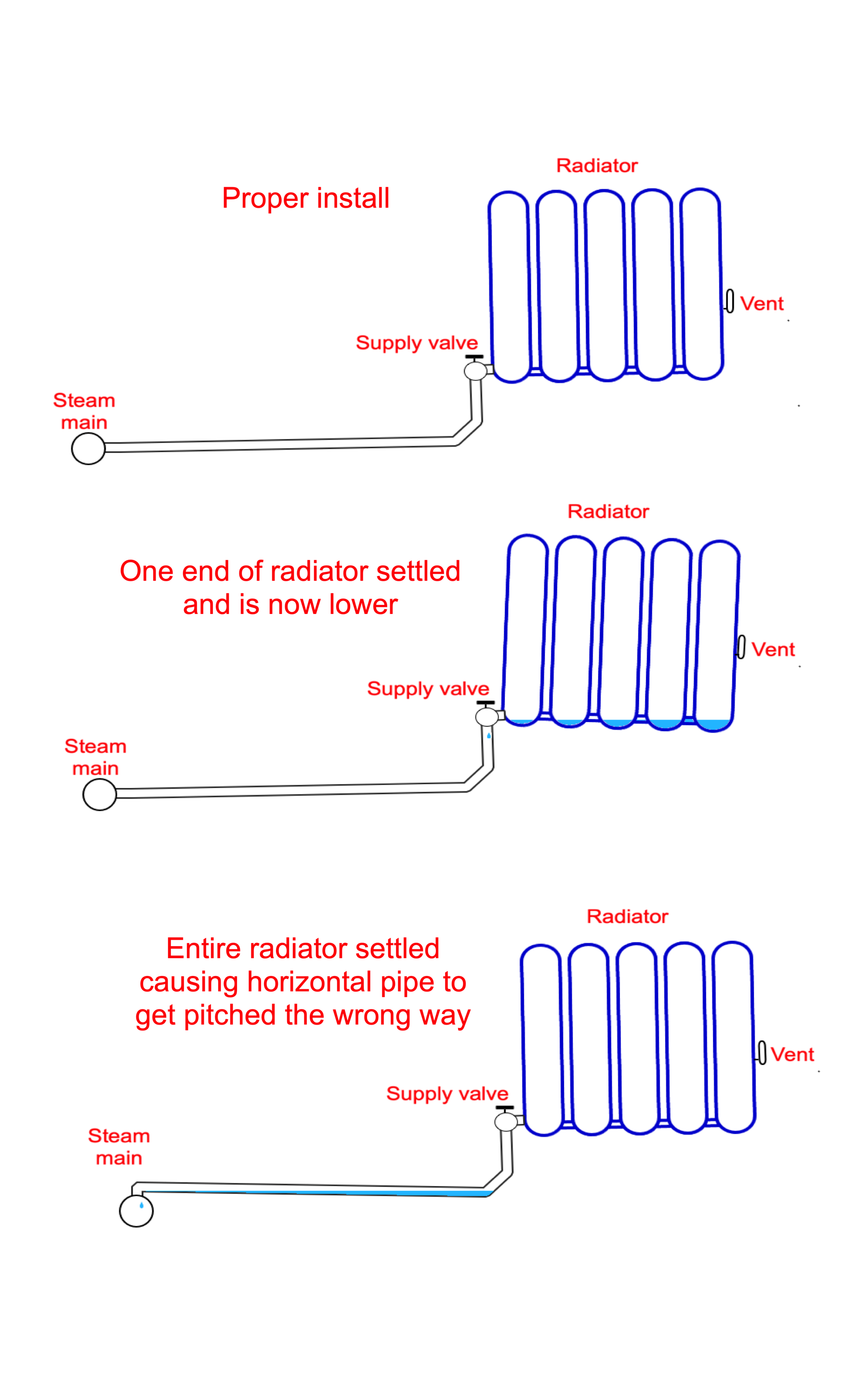

    Here is an illustration that shows that condensate (water) can get trapped in a pipe or radiator that has settled.
    This is not always a problem as you can see in @ethicalpaul's video below. But it can be a problem in some cases. Paul's video shows that the built up condensate falling into a bucket will have no problem. But the experiment fails to show what will happen if the condensate drips onto a hot steam pipe.
    Consider this:  In the video the water in the bucket is room temperature but as the condensate and steam pass into the bucket the water in the bucket gets too hot really fast.  When you heat water it expands and that may cause the condensate in the bottom of that radiator to expand and burp a significant droplet or two of water to heat a hot steam pipe and flash into steam causing a minor explosion. You see, water turning into steam expands to 1700 times its liquid size.  Dynamite on the other hand only expands about 970 times its solid size and that always makes a bang, even if it is just a fire cracker size.

    does the end of the main have pitch? Does it have venting? the main could be holding condensate where those tees branch off horizontally if it doesn't have pitch. Is it parallel flow or counterflow?
    Could be a bunch of valves that came apart internally too but since it is several radiator that is rather low on the list.
    That pipe radiator isn't going to heat but that shouldn't be the problem with the other radiators. Actually, if the pipe radiator does heat other than a little at the ends, that means you problem is water in the main.
    The pipe radiator can be fixed by adding a water seal at the end with the vent to keep steam from the main from coming in through the return and closing the vent.
    EDIT: By moving the vent to the low end and putting a water seal at that end. Looks like the vent is at the high end which is wrong. Supply and vent need to be at opposite ends and return needs a water seal.
