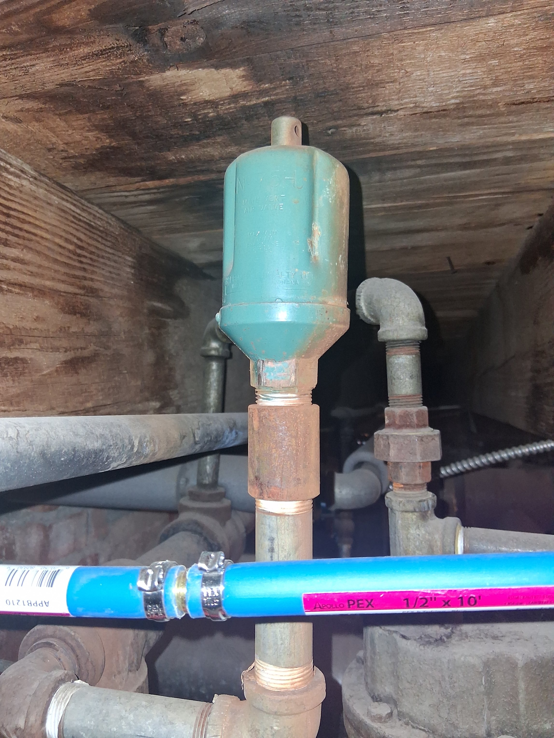

Good morning. This vent on a friend's, 2pipe steam, boiler seems to be stuck open. Can it be replaced with a gorton #2?
Bryant 245-8, 430k btu, 2-pipe steam in a 1930s 6-unit 1-story apt building in the NM mountains. 26 radiators 3800sqf
    ethicalpaul Posts: 9,076
    Yes, just be aware the Gorton #2 has a 1/2" male connection and is quite large so you might need to adjust your riser there

    He could use a Gorton #4 if he wanted to, but he asked about the #2
    It would depend on how much venting he needs. It is my opinion that in many of the cases where people are using one or even 3 Gorton #2, a #1 would be good enough, but it's that kind of thinking that makes people click the "LOL" button on my posts without providing any evidence that I'm wrong.

    Looks like the only vent in his mains, and only one crossover near the boiler. A #1, 2 or 4...I don't care either way, the #2 seems to be the popular choice in here

    I’ve never felt as free as the day I replaced all my big mouths with #1s.

    Interesting.. why?

    I'll give my answer—it was because they take forever and a lot of steam to close, they don't stay closed, and they fail open real quick (in my experience)

    Yeah, I was losing a significant amount of water due to them taking g forever to heat up and close. With the #1s I lose almost nothing. I haven’t noticed any difference in performance or efficiency.

    Thanks, it's on a return line so #1 should be fine.
    The radiator it's attached to hasn't been heating up.

    @guzzinerd , if that's the only vent in the system, use the #2. In that case it has to vent the mains as well as the radiators.
