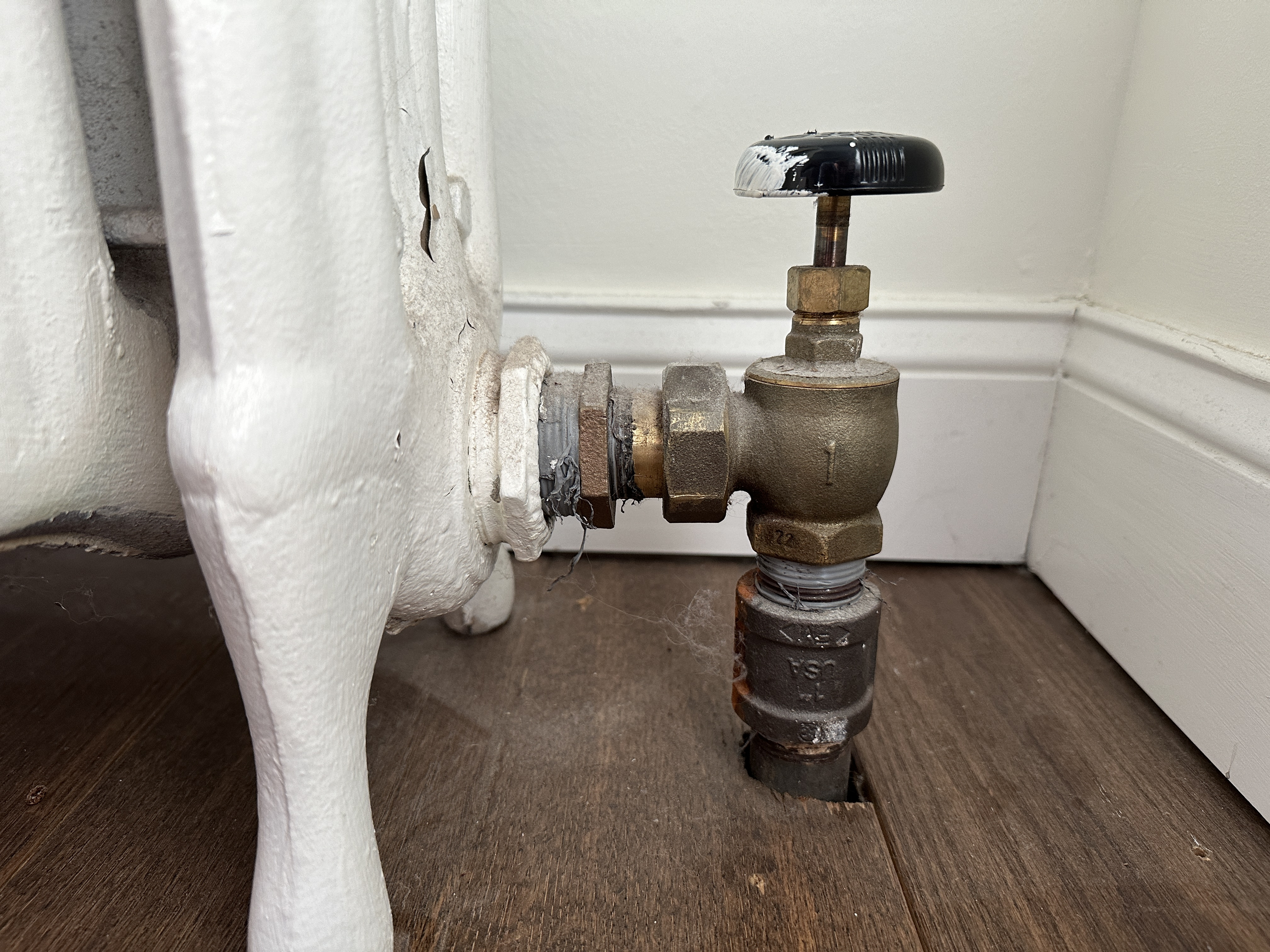

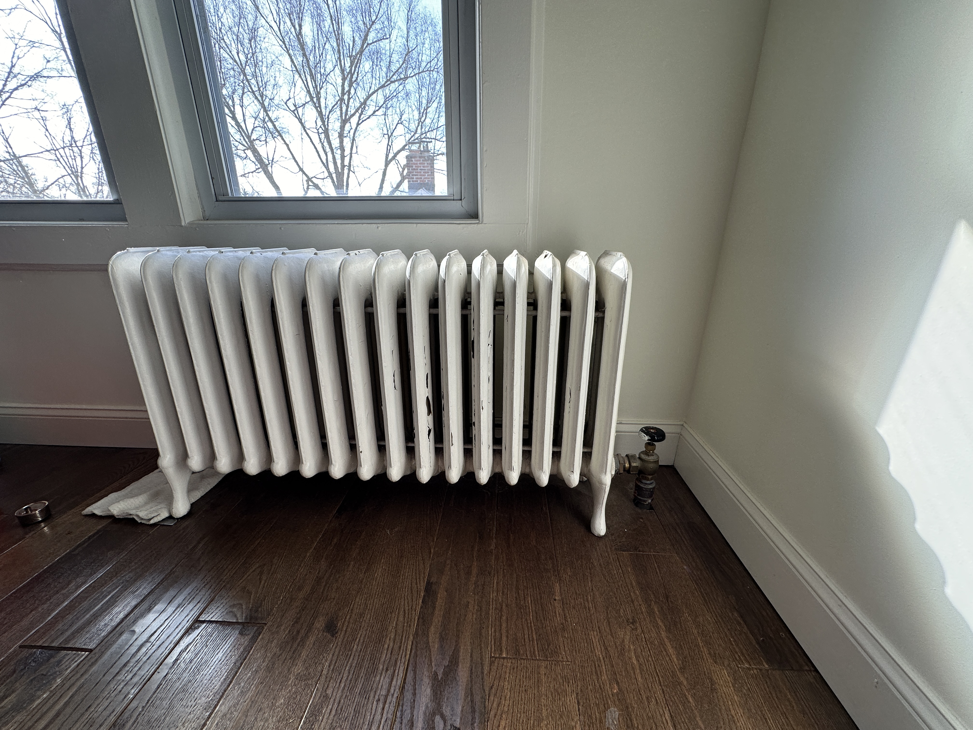

I have an attic radiator that has always had an issue with condensate sloshing and spitting from the air vent depending on what style of vent is on the radiator.
I’ve never bothered to address this because the attic is being used as storage at the moment but I want to fix it this spring once we are out of the heating season.
Basically what happens is the radiator heats and when it heats up about mid way, it starts sloshing badly, audibly, sounds like waves. At this point, if I let it continue heating and I have a Gorton on there, it’ll start spraying water out the vent. If I have an adjustable Hoffman on there, it’ll close when the condensate hits it (by design) but then the riser sounds like someone flushed a toilet as the condensate drains down.
I’ve been noodling on this for 3 years now and not attempting anything because I’m not quite sure where to start but I think it might be one of these two issues and was wondering if anyone thinks I’m way off base.
  1. Previous owners put in new hardwood flooring which is about 3/4” tall. Presumedly the radiator was sitting atop subfloor so whoever did the flooring added a coupling and a close nipple before the valve. My thought is this is potentially pushing the runout downward causing a back pitch towards the valve side vs the riser. Reasons I don’t think it’s this is that runout would probably fill with condensate much sooner than when the radiator gets halfway hot.
  2. This is a big radiator, 16 sections, on a 1” valve and runout/riser. Additionally, there’s a reducing bushing on the radiator spud which would in my mind effectively raise the drain point of the radiator causing it to always retain some condensate. Additionally, I’m wondering if because this is such a big radiator on a 1” pipe, it simply generates way too much condensate to properly evacuate through a 1” pipe as steam is simultaneously trying to enter. I’m curious if anyone thinks there’s any validity to this line of thinking or sizing calculations that could confirm it.
I have a spare radiator in my basement that I may try hooking up, I think it’s 8 sections, maybe smaller, I’m going off of memory, but I don’t want to go through the trouble of lugging this thing up three flights of stairs if the radiator size isn’t the issue.

    I would disagree about the pitch. You can't really change the pitch anyway, pipe doesn't bend that easily. Additionally, I have proven that radiator pitch doesn't matter.
    The issue I see here is that is a lot of radiator for a 1" valve. Also make sure the valve is fully open. Also make sure the valve doesn't have rusted parts that have fallen down inside it partially blocking the backward flow of condensate.
    If your other radiator is smaller give it a try. Or even easier, cover the radiator with a blanket and see if it is better.
    My upstairs radiators that are on a 1" valve are about 20 EDR. That one is substantially larger and the steam is fighting to get past the returning condensate.
    That's my best suggestion from here.

    Disconnect the radiator at the spud/valve union. See if the valve/piping wants to move vertically by using some leverage and see if it moves vertically easily. If so you probably have a sagging horizontal section under the floor.
    If you need to readjust things, good time to use a valve that is the same size as the radiator.

    I'm not sure what you're saying there, but if you aren't having any banging I think for me that would rule out water being trapped by bad pitch in the runout. And if the water level is reasonably steady that rules out the boiler having serious carryover problems that would throw water all the way up into the system.
    So for me that leaves
    • Problem with radiator valve not being fully open, or being partially blocked due to rusted out internal parts (can be verified by opening the union and sliding the radiator away to look inside valve).
    • Radiator valve is just too small for that radiator (can be rectified by reducing "size" of radiator by covering partially with a blanket or installing smaller radiator).
    I think you'll have trouble putting a larger valve on there because the riser is 1" and you probably don't want to repipe that. How does the existing radiator perform to heat that space?

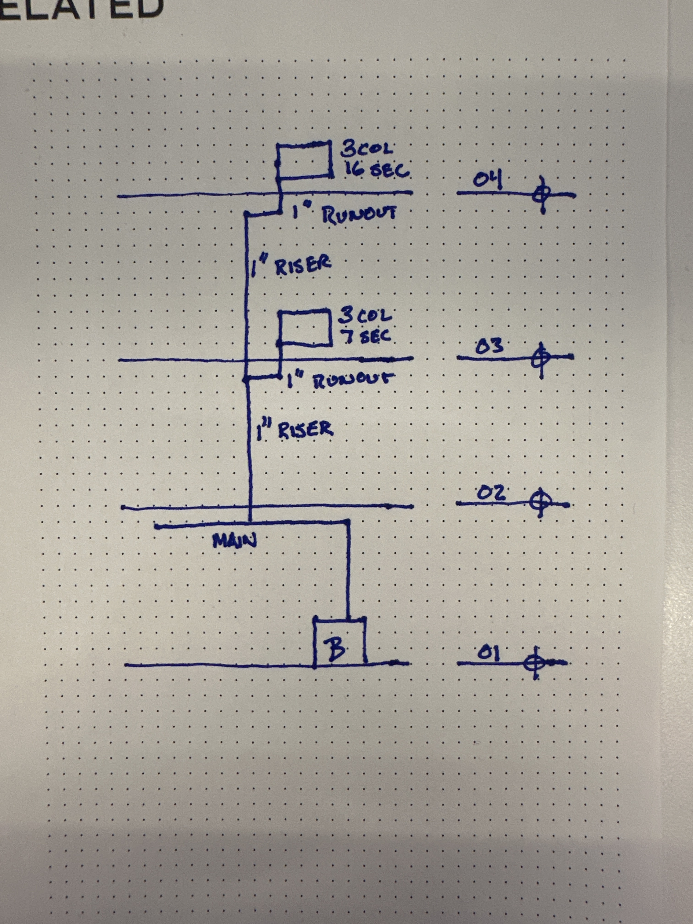

    how does the runnout get there, is there just one long pipe up from the basement or does it branch off of something else? I'm thinking the runout could be trapping condensate that the air pushes in to the radiator as it vents out so it is air rather than steam pushing it around so you're not getting hammer. I'd try raising the riser by shimming under the radiator and see what that does.
    you could do something creative with a reducer under the valve where that coupling is now to use a larger valve.
    If i were to change something with the piping instead of making the runout bigger I would bring a second return pipe down and set that radiator up as 2 pipe air vent. That long riser to the radiator is potentially problematic no matter what and making it 2 pipe fixes some of those problems.
    if the velocity of the steam is pulling some water along with it from someplace it is trapped the slow vent will fix that, it will keep it from spitting. The fact that is still sloshes makes me think that there is water trapped somewhere in the runout though(or the velocity of the steam is such that it is keeping the condensate from draining once the whole radiator is consuming steam).
    i'm kind of thinking out loud here but if you open up the main somewhere and put a shop vac on the runout if you start sucking up significant water, water is trapped in the runout somewhere.
  • Small pipe diameter (as Paul has pointed out) AND uninsulated pipe somewhere under the floor leads to a big fight between steam and condensate (thus sound of the waterfall/toilet flushing).

    That is a 16 section, three column radiator, right? If it is 22 inches high, at 3 ft.² per section that is 48 ft.².
    According to TLAOSH, a 1 inch one pipe steam riser has a capacity of 45 ft.². However, a 1 inch horizontal runout to that riser, without a separate drip, has a capacity of only 28 ft.², and a 1 inch one pipe steam radiator valve has a capacity of only 20 ft.² because the steam and condensate must pass through a small opening in opposite directions.
    If a smaller radiator will heat the room adequately, that is your best bet. The suggestion above of testing this by covering much of the existing radiator with a blanket, which will reduce the effective size, is a good one.
    Changing the valve to 1 1/4" will certainly help and would not require changing the 1 inch riser, just a 1" to 1 1/4" adapter in place of the existing riser coupler and removal of the bushing at the radiator.
    Bburd
    Burnham says a 1" runout is only good for 25EDR and that is if the horizontal run is 8' or less
  • Yes, 16 section 3 column. I don’t think it’s original to the house because all my radiators are made by US Radiator, this one is not. It was probably swapped when the attic was converted to a living space some time ago.
    I’ll test the blanket over the radiator to see if it solves the problem. I do have a spare 10 section 3 column radiator in the basement which I’m assuming was the original one for the attic because I don’t have any missing radiators or evidence that one was removed anywhere else in my house.

    My best guess based on what I can see is a riser from the basement that picks up a bedroom radiator on the 3rd floor and then the attic radiator on the 4th floor. (I’m counting the basement as the 1st floor)
    it’s a 1 inch riser and the bedroom radiator is a 7 section 3 column.
    both are on a single 1" runout?
  • Miringanes
    Miringanes Posts: 27
    edited January 13
    This is what it does. I’m pretty sure the riser is 1” but maybe it’s 1-1/4”. All the piping through the floor to the radiators are 1” on this particular run. Piping is within the walls and ceiling so it’s hard to tell. The riser off the main is smaller than the adjacent riser so I’m assuming it’s 1”
