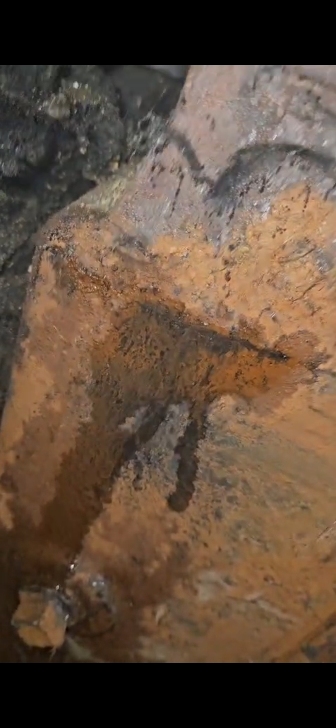

Using epoxy on a crack on the crown of a cast iron steam boiler
Joseph_4
Posts: 324
Hi. I have a customer with a crack on one section of their cast iron steam boiler.. Has anyone successfully sealed with epoxy or high temp caulking?
Thx
Joe
1
There's epoxy and there's epoxy. Better luck with expensive stuff.
can you post a wide shot? i have used epoxy and metal plates to replace holes in my boiler. if this is outside of burner cavity, then you can use JB Weld Water. don't bother with very expensive stuff (i've tried both).
