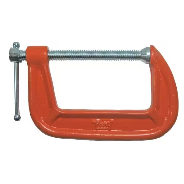

    I like the hose clamp idea….but if that doesn't work maybe try a C-Clamp at the top and bottom of the nut to close the gap in the crack? You can get a small one for $2-3 at your local hardware store.
