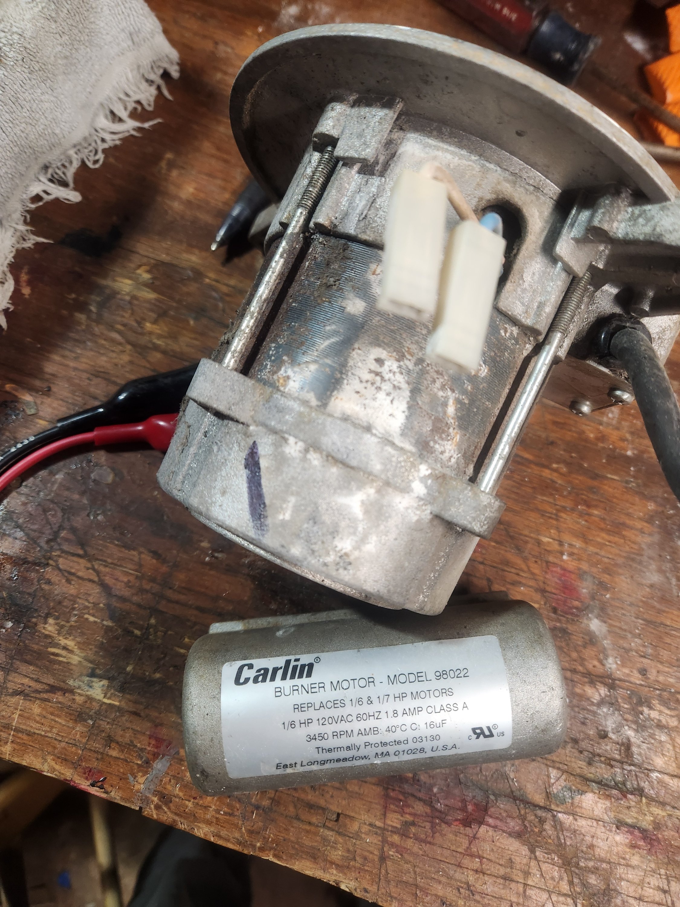

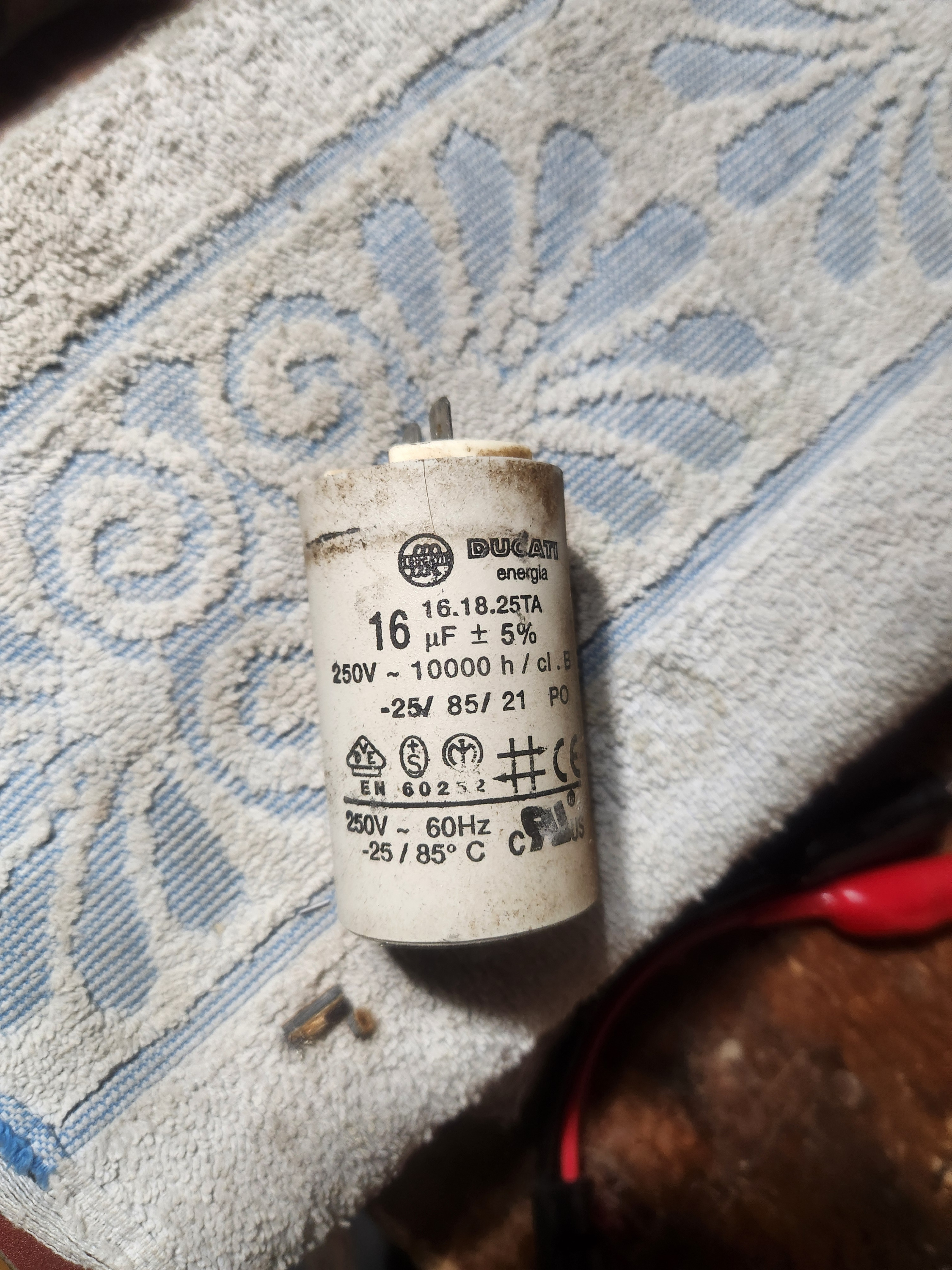

I have a few Carlin motors with bad capacitors. These are the older PSC motors with the round capacitor PN#98022CAP which appears to be discontinued. Does anyone know of a source for a substitute?

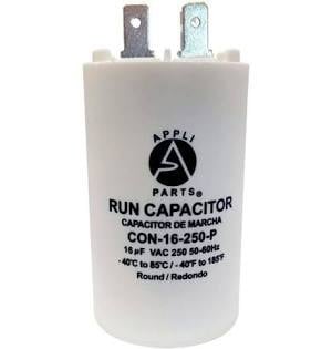

that's the closest match I have found yet (you found). Figures its at walmart 🙄
What I have found so far, that fit the numbers are "run" capacitors.
That is specified as a "run" Cap. however, Carlin says "The Carlin PSC Motor utilizes a capacitor to assist startup and run of the motor."

That way Carlin is the only company that you can get that from. You can get Run Capacitors anywhere they sell capacitors, but you can only get the original Carlin part from someone that may have some old stock laying around somewhere.
