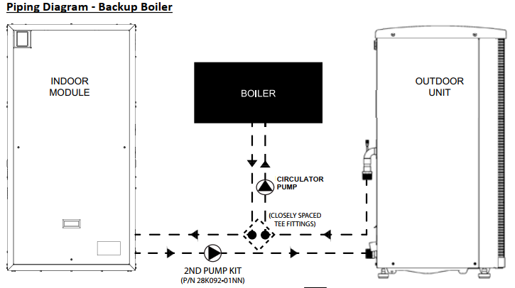

On the glycol loop I'm installing a 9KW Thermolec backup electric boiler on a secondary loop via closely spaced tees from the main 1-1/2" glycol loop.
What is the proper relief valve to add to the output of the electric boiler? The manual only calls out a "safety valve". I think I only need pressure relief, not a T&P?
If it matters, the output of the boiler is on the side (horizontal), 1-1/2" FPT. I need to convert to 1" for the secondary loop piping.

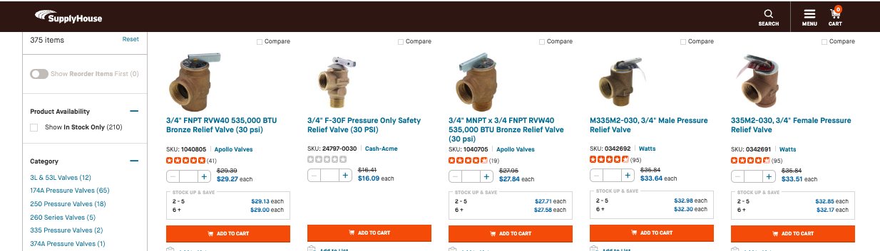

    Usually pressure and BTU capacity is how you would size a hydronic relief valve.

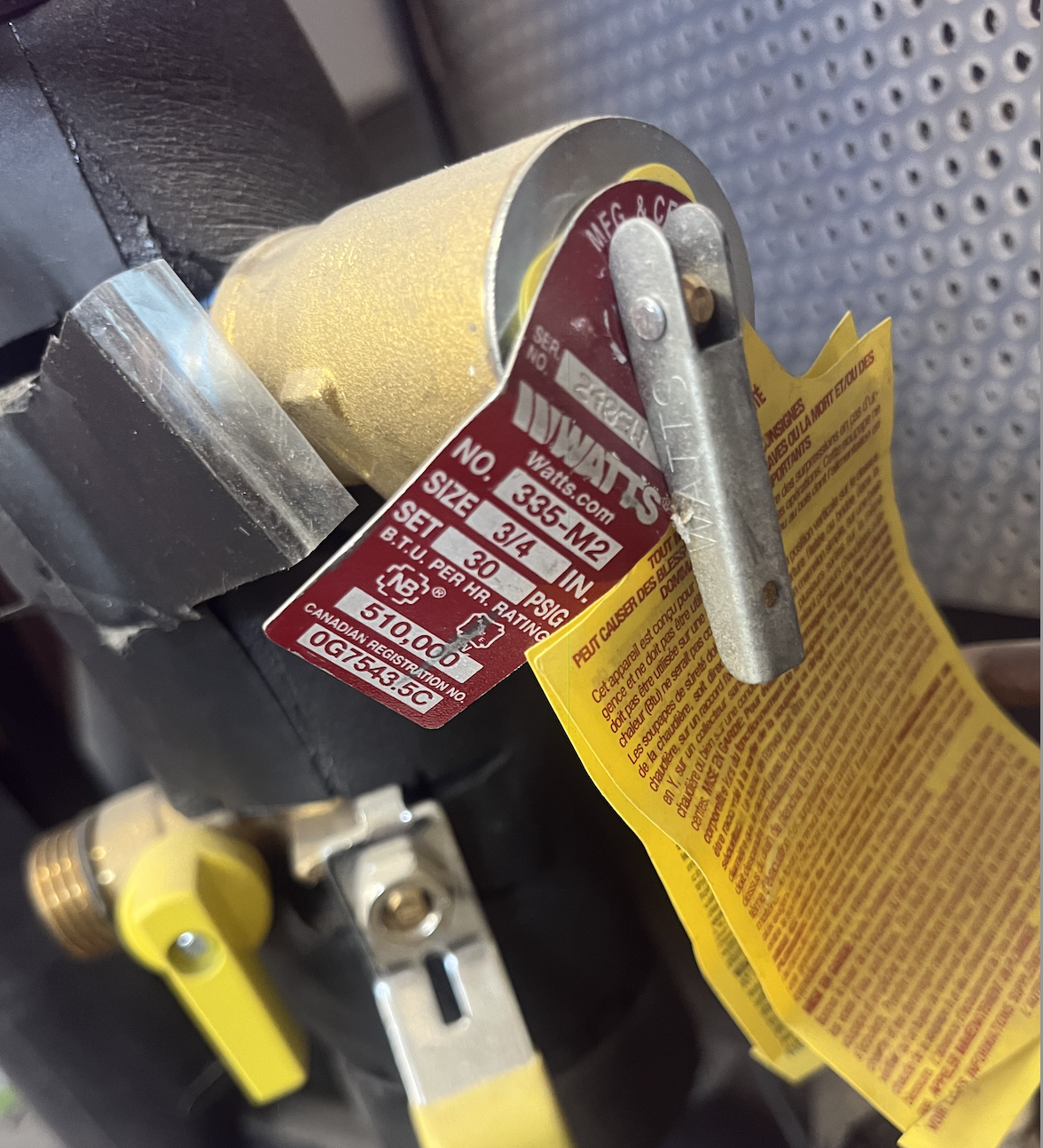

    This is the valve that shipped with my Viessmann Vitocal HP. Is has a 6 KW back up element built into the indoor module. The BTU capacity is probably a bit on the high side :)

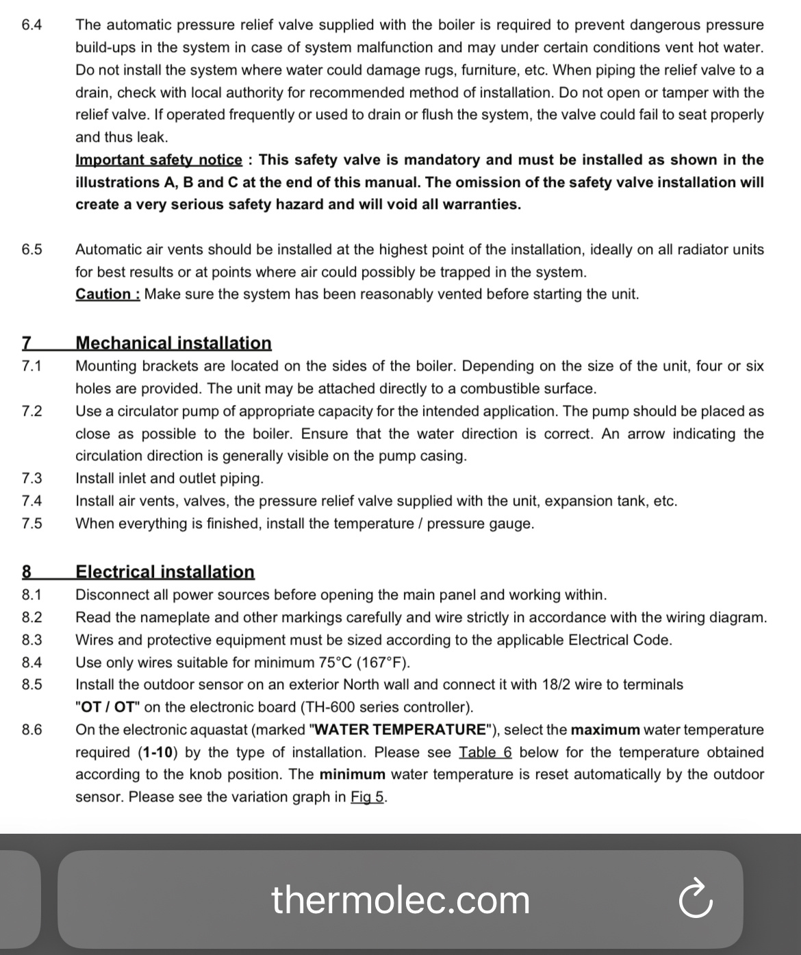

    30psi is recommended by monobloc manual.
    I don't think teperaturenis required on an electric boiler.. Water heater, yes. temo, I don't think so…
    mattmia2kcoppSuperTechGGross
    The temp of a t&p valve is too close to the operating temp of an electric boiler, a hot spot could easily cause it to blow off so as far as I know boilers require a pressure only relief valve.
    If it is an electric boiler it should be shipped with the valve or at the least the mfg should tell you what to use and how it should be installed.
    Seems to me a lot of liability for the boiler mfg not to provide a valve.
    Its been a very long time since boilers and water heater were shipped without relief valves.

    Well, I feel stupid now.
    Indeed there was a 30psi relief valve provided with the unit. It had fallen out of the box during unpacking and I missed it.
    Thanks for pointing that out.
    It happens. Glad you found it.
    Some wouldn't have thought they needed a relief valve so your way ahead of the game. There are no stupid questions especially when it comes to a safety control

    This is an Enertech system. The manual suggests a 30psi relief valve if required by local codes, but does not say its mandatory (page 25).
    The backup electric boiler is connected as shown:

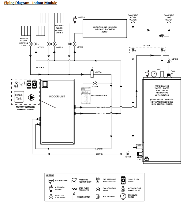

    The DHW is via a 80Gal. Turbomax reverse indirect hot water tank. It's not shown on the drawing below, but the tank did come with a 30psi pressure relief for the storage tank (glycol side). I'll be adding a T&P to the DHW side:
    hot_rod Posts: 28,704
    One determining factor would be if the component can be isolated off from common piping that has the relief, it should have a dedicated pressure relief device.
    The Vitocal came with relief valves and fittings, installation manual shows a valve on the indoor and outdoor units. They seem pretty clear about installing relief valves.
    Relief valves protect your investment and they are fairly inexpensive. Plenty of choices out there.
    Also be sure to include the glycol % when sizing the expansion tank.
