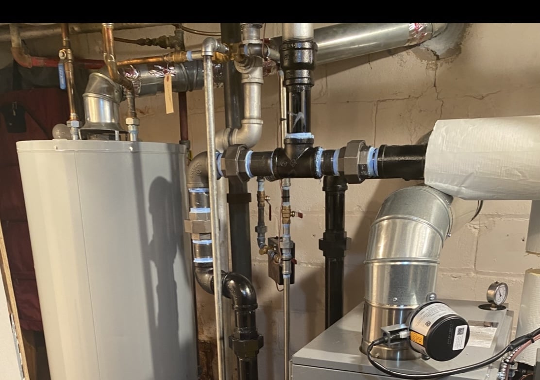

Two supply tapping

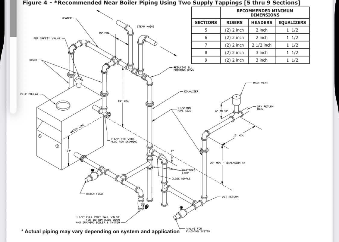

Near boiler pipping installation instruction shows two riser tapping to main. Contractor only installed a single riser to main. Utica technical was contacted - they said that the boiler is designed to have two risers - one riser should not be used. Please. advise

    the installer was unable to read and follow the installation manual. hope you haven't paid them yet.
    might be ok, we need to see a couple pictures from different angles, especially both sides. might be a header arranged in a U.
    make sure the pipe sizes follow the manual and that the order of the risers from the boiler, the risers to the building steam main(s) and the connection to the equalizer are in the order show in the manual too.

    how many sections is your boiler/what is the model?
  • magewick
    magewick Posts: 32
    5 sections
    Model IUD-1605HSID
    Is your model # correct?
    All you or your installer has to do is read the manual that comes with the boiler. They show the piping diagram.
    Follow the diagram for pipe sizes and riser, equalizer and steam supply piping. It's very simple.

    What is everyone's thoughts about the outer jacket (paper?) of the pipe insulation resting against the flue pipe?
    Since this is a new install I feel it needs to at least be made to meet the manufacture's minimum requirements which it currently does not.

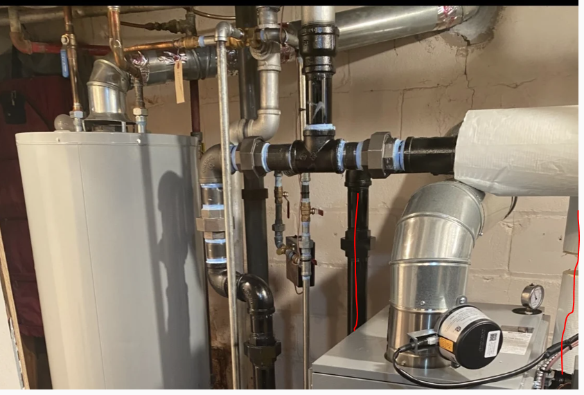

    We might need a better picture here, I think I see 2 risers (marked in red). Can you take a picture further back so we can more clearly see all the piping?

    I think @KC_Jones may be right, the header is arranged in a u right along the back, to the front then to the left but it is hard to see here. If the pipe sizes are ok, then it is ok.
    The guy that piped it didn't have a clue or he owns a supply house.
    I count no less than 5 unions and there is probably another one on the RH insulated riser making it 6.
    All you need is 3.
    If I had done that with 6 unions, they would have tossed me out of the union

    @magewick , it's wrong. Have them repipe it according to the diagram.
    Semi-retired
    that's what i thought but I think it might be correct and in a big u that we can't see from the camera angle
    It looks like they had the boiler connections correct (assuming right size which you should check) in this post then thy added that loop in the equalizer to get the main connection correct:
    also note that this is a vapor system.

    I agree but he does say there's only one. Hopefully he'll come back to clarify.
    And galvanized pipe for makeup water?
