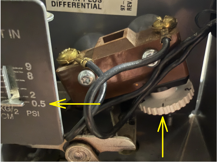

    5 psig is WAY too high. Picture, please, of the pressure control device. Also, has the pigtail to it been cleaned?

  • Pressuretrol is set at 2;2 pigtail and Pressuretrol are both new gauge is tapped into the top of the boiler all radiators are open and hot
    If the pressuretrol is set to cut out at 2 but the pressure still goes up to 5, something is quite wrong. The pressuretrol might be out of calibration — most of them are — but that far out would be odd. One has to wonder… is it properly wired in?

    If you have a PA404 Pressuretrol it should be set like this picture, however you may have other issues if the pressure is actually going up to 5psig.
