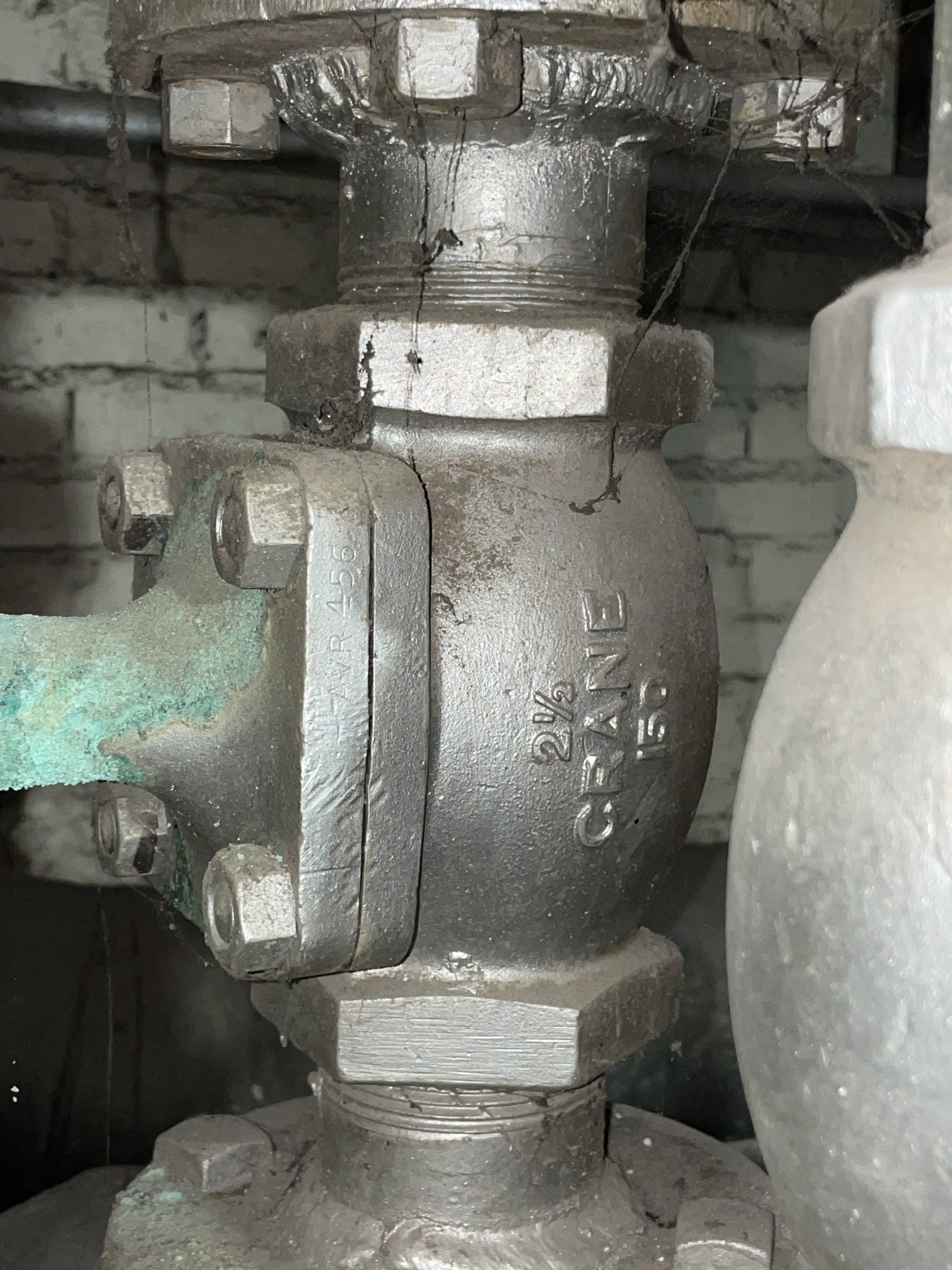

hi, I’m new to this kind of thing and don’t know where to turn to considering the age of the furnace. The valves on top of my parents old coal burning furnace are both leaking and I need to figure out how to replace them. I’m in the Pittsburgh, PA area. I’d like to do it myself but if it’s going to involve plumbing work then I know I’ll need professional help with it. Any recommendations would be great.

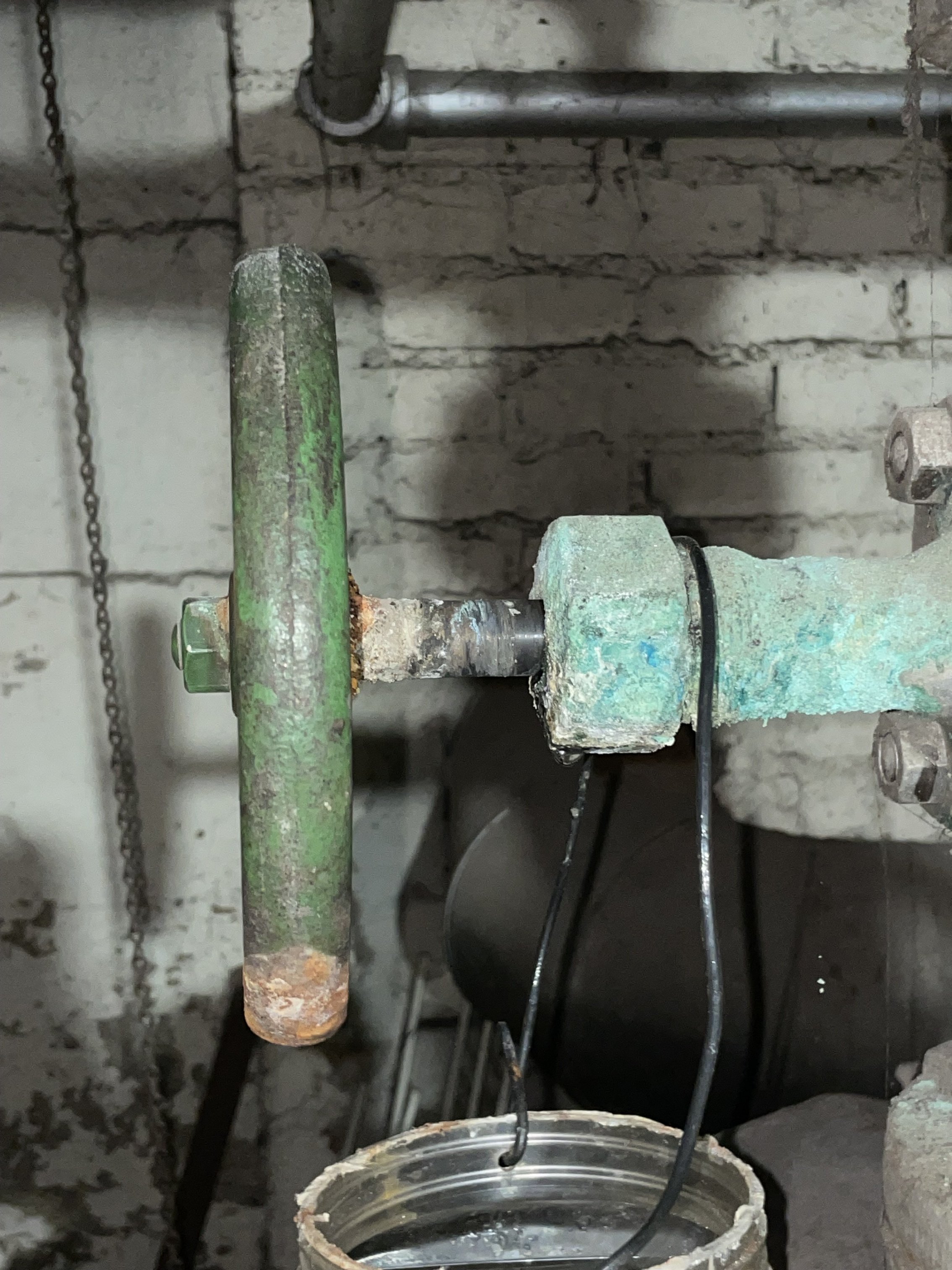

    Mercy. Why do they need replacing? If it's the stem leaking, that can be repacked — although getting the packing nut loose may be rather a job. If it's that they don't shut off, then…
    Yeah. You're going to need help.

    From your picture, the valve appears to be leaking from the packing nut or packing gland.
    First, try tightening the nut. If that doesn't work, you can repack the gland.
    When you tighten the nut, it will compress the packing around the valve stem and should stop the leak.

    Also, a safety precaution. Do this with no pressure on the system. Since you are not a pro, I would advise that you do this when the boiler has no pressure and the boiler is off.

  • Thanks for the input folks! I’ll try tightening the nut, if that doesn’t work then most likely I’ll have to just call someone in.
    @Hollywogg I would suggest putting some penetrating oil on those nuts a couple of times a day for a few days. If you can shut the boiler down it would be better so the oil doesn't burn off. Then put a wrench on the nut and try to loosen and tighten working it back and forth. If you get it to move snug it up and see if the leak stops. If it doesn't you can back the nut off all the way and add some string packing or get some help.

    Before you attempt to tighten the packing gland nut please be sure to close the valve for one turn to prevent
    damaging the stem.

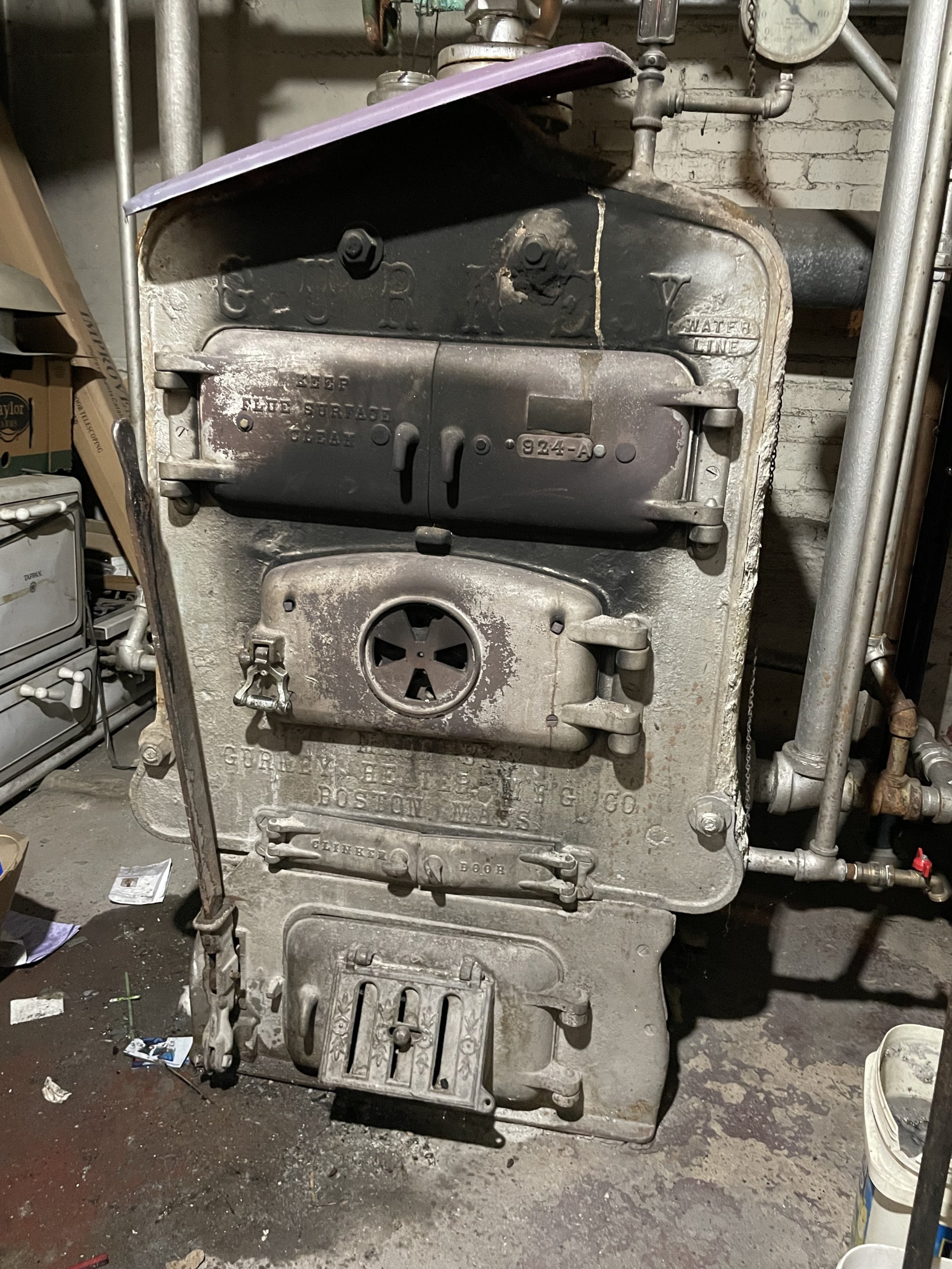

    Are they burning Anthracite Stove Coal or Bituminous stove coal?
    You have rocking coal grates in that beautiful Gurney coal boiler.
    How many floors in your parents home?
    Is there an open to air expansion tank in the attic?
    Please take more pictures of the boiler and around the boiler and the stove pipe and air controls on the rear of the boiler.
    Please take pictures of the radiators in the home.
    Is there an open to air expansion tank in the attic or the third floor? Please take a picture of it and its piping.
