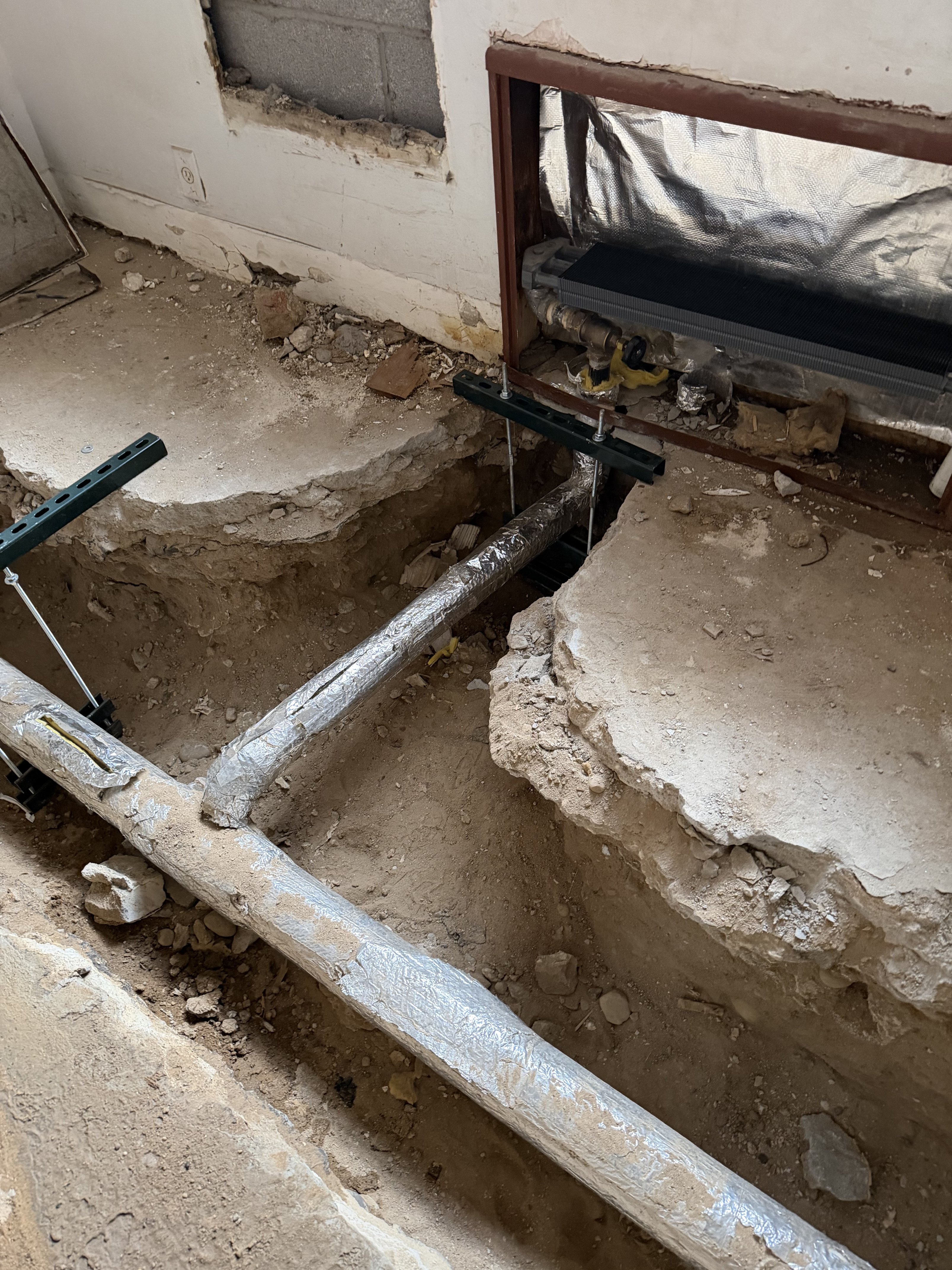

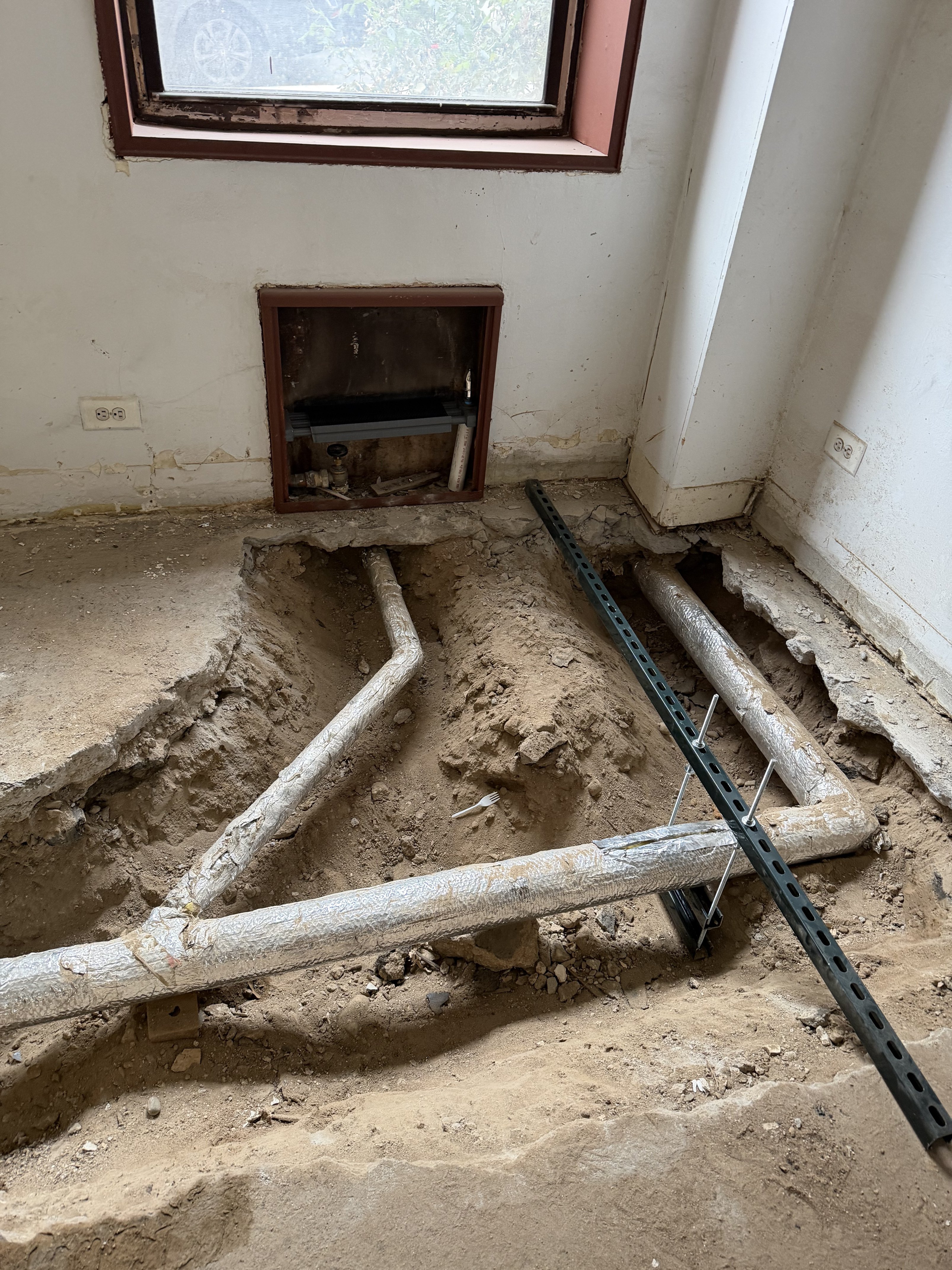

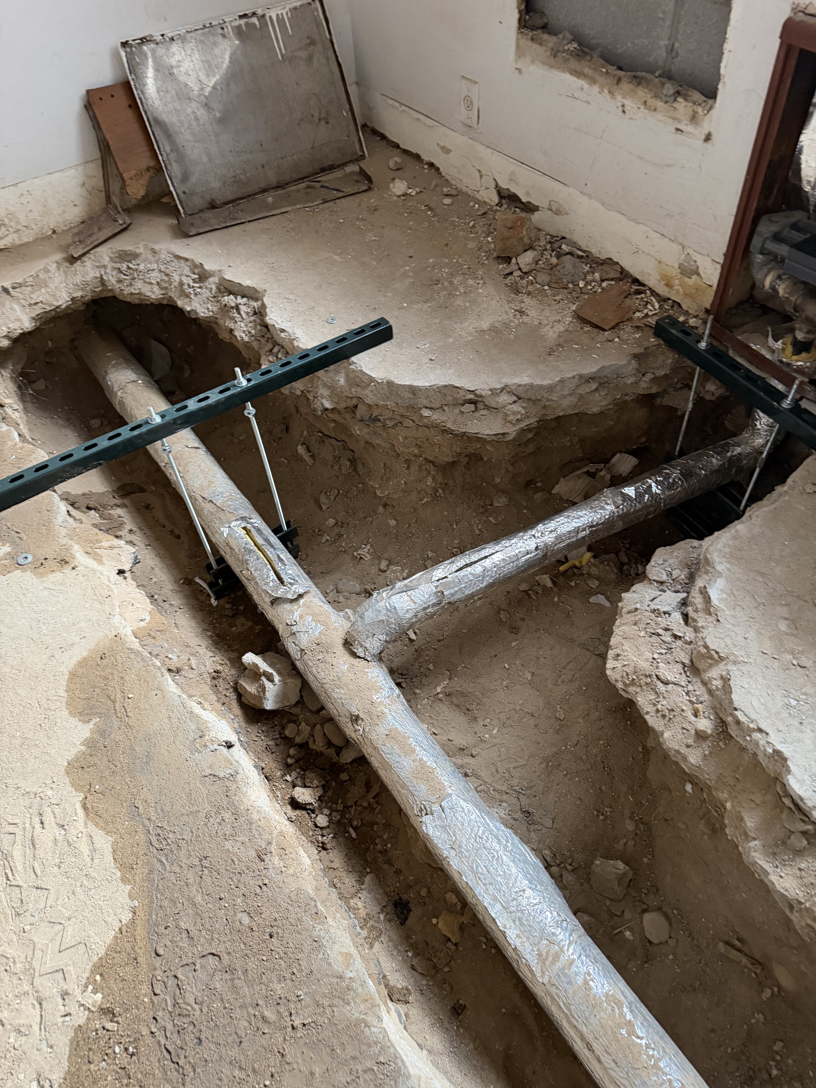

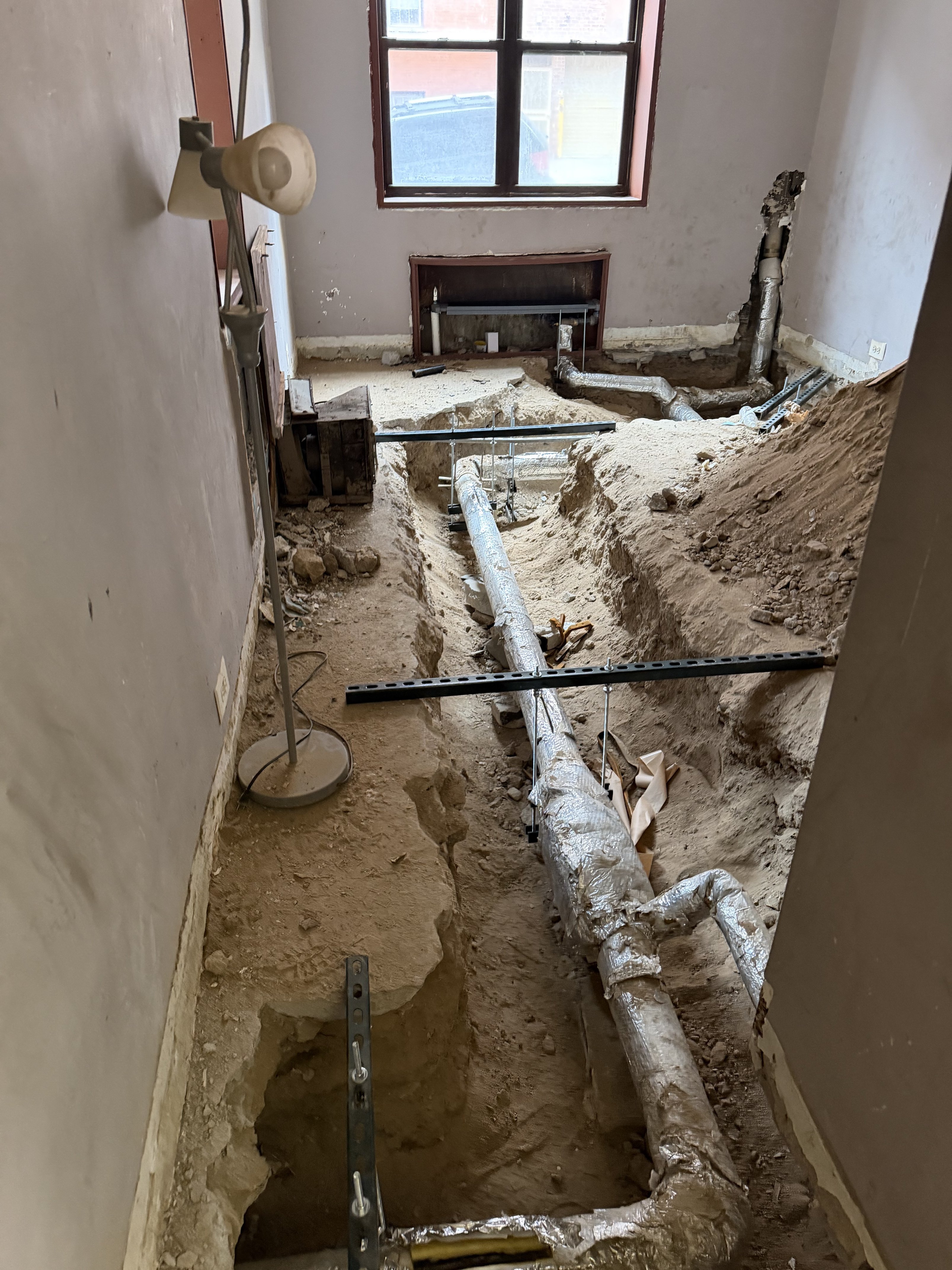

Good morning. We’re experiencing ongoing issues with one steam line that continues to bang. We excavated and exposed the piping, and the plumbing company corrected the pitch, but the problem is still occurring. It appears to be isolated to a single riser—water begins to discharge from it, and shortly after, the banging starts. Any suggestions or insight would be appreciated.

    You have several rads pictured and what looks like a riser in the corner. Which one is banging or is it all of them? Difficult fix in a basement.
  • the first picture radiator is the one that Water starts spitting out and then a few seconds later the next room starts violently banging
  • and the riser that it’s connected to is the only riser in the building banging on the top apartments as well

    That pipe has to pitch back counterflow to somewhere it can drain can you show the supply pipe? You can't put steam down under a floor without having a way for water to get out.
    There has to be a pit in the floor or a condensate pump or drop to a lower elevation or something. Is the boiler at a lower level? Water has to be able to drain from that pipe somehow. Something is missing.
    The other option is to feed steam overhead and convert the old pipe to a return

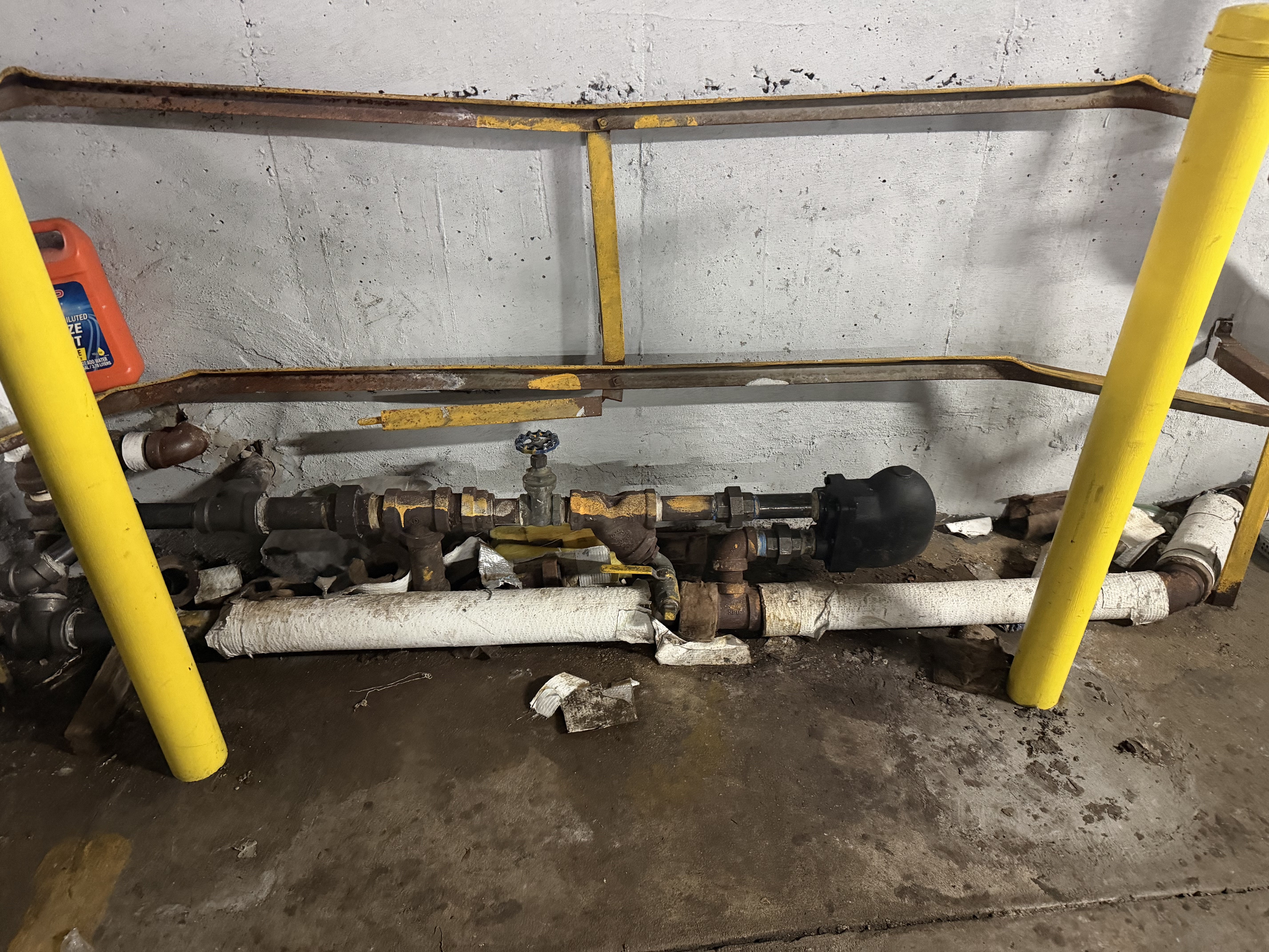

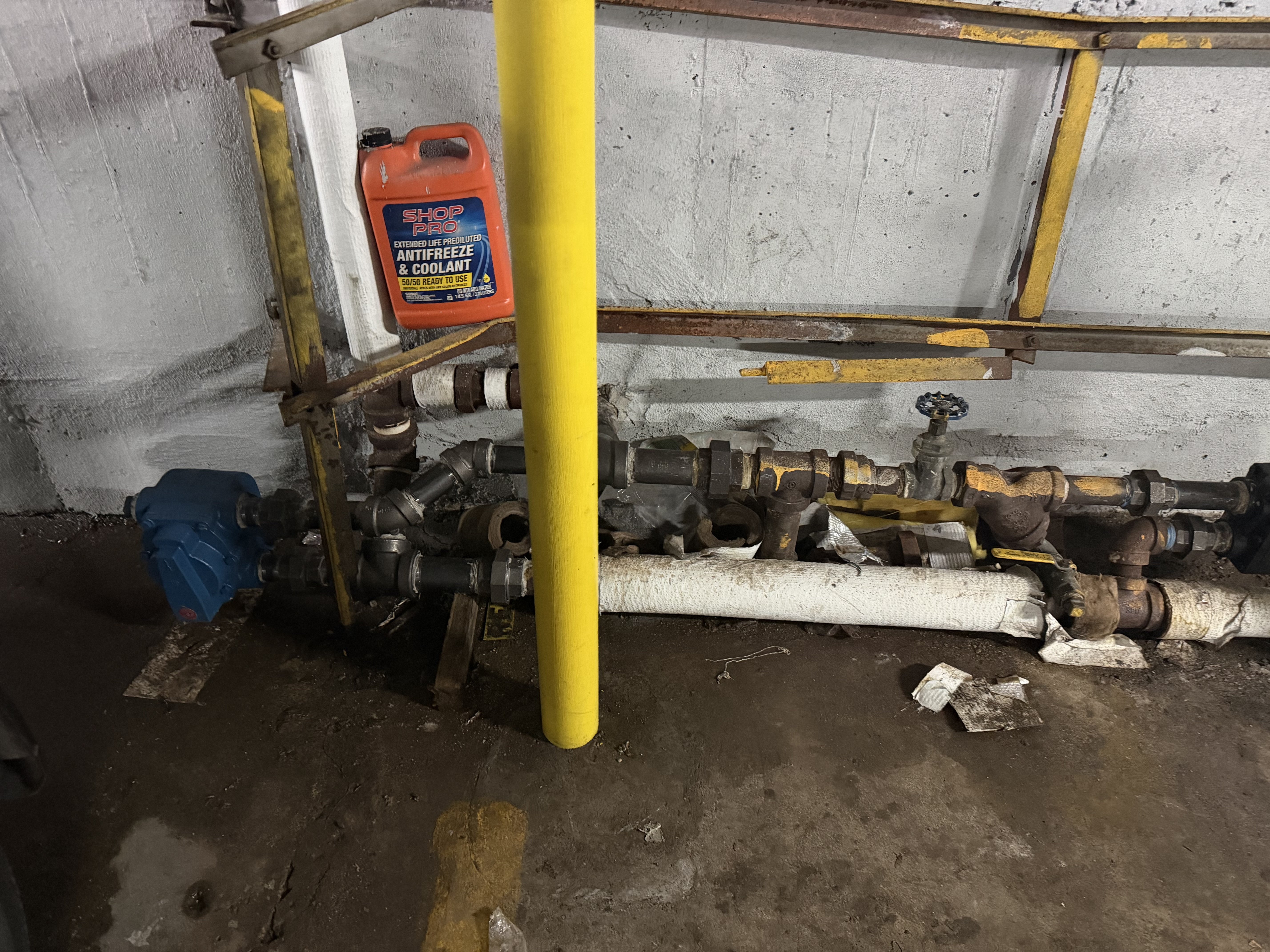

    I would be helpful to see where that supply comes from. There must be a lower level where the boiler lives.
    Its steam so the water has to drain (or be pumped ) back to the boiler. If we can't see it we can't help.

    I'd need a complete piping plan — elevations and connections — from the boiler to … whatever that arrangement is above… to the convectors. To even figure out what might have been intended to work, never mind figure out what to do about it.

    Where is the boiler ? I'm thinking that floor is about at grade, cars seen through the windows.
    Is the system Parallel flow or Counter-flow, I'm thinking the main does not have enough pitch to properly drain the condensate.

  • We need elevations and pitches from boiler following thru each listed component all the way to the convectors.
