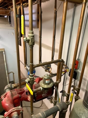

Hi Guys - after resolving this 2 zone hot water issue recently
for the last 4-5 days there's a new problem. When either zone shuts down there's a big Wham bang bang bang in the system that sounds like the pipes are rattling. By the boiler it's very quiet but in the living spaces it's loud enough to wake us up at night. This morning it dawned on me that maybe it's the expansion tank. I pushed the schrader valve and only got air. I checked with a pressure gauge and it fizzled out as if that was the last air. No water came out.
I have to get a bike pump and get it back to 12PSI to match the regulator pressure, but two questions:
1. Since the system is self filling, I imagine it has taken in more water over time as the air pressure has dropped and the diaphragm expanded to the air side. So what happens when I pump up the pressure to 12PSI - won't the diaphragm be pressurized but the tank still full of too much water? If so, how do I get the excess water out?
2. This fix is needed regardless, but does it make sense as a solution to the banging issue or would that be something else?
Thank you!

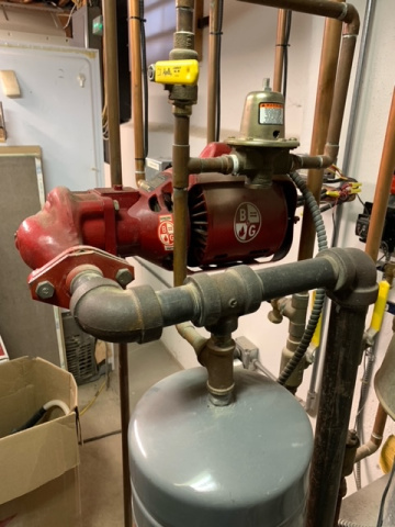

    @Jamie Hall and @Big Ed_4 - two different opinions on filling the tank.
    There is no complete isolation of the tank. I can isolate the fresh water feed, but not the system from draining back through the main supply from the boiler to the pump.
    Further thoughts?

    FYI - there is a backflow preventer and a boiler drain valve.
    I'm not clear on 1 part now:
    The expansion tank is below the the pipe that exits the boiler to the pump. Isn't the only way to clear water from the expansion tank to pressurize it with air to push the water up and out?
    The expansion tank says it has a max of 100PSI working pressure, so can't I use like 40PSI to push the water out of the tank, then drop the pressure back to 12PSI?

    Hi, As long as you're going to the effort, why not put a shut off and drain between the tank and system? After that, future service will be simple. 😸
    EBEBRATT-Ed
    I agree with @Larry Weingarten
    The fact that the tank lost its air charge may mean you need a new tank. Sometime in the future you will.
    Shut off the city water
    Your going to have to drain the boiler and then fill and rebleed the system.
    I don't see valve to isolate the boiler from the system so you may have to drain everything.
    When drained take the tank off it may be heavy if it is waterlogged. When you get the tank off repressure it.
    Install a 1/2" close nipple and a 1/2" threaded ball valve on the existing tee. Then put another 1/2" close nipple in the ball valve with another 1/2" tee. Put the expansion tank on the new tee. Put a 1/2" boiler drain valve in the new tee.
    See attached drawing.

    Thanks for all the help here. This is what happened:
    I locked out the boiler to minimize draining, then drained some water. I filled the tank with 20 PSI but the schrader valve was leaking. I unscrewed it and only half came out. That left me no alternative but to remove the tank. I fished out the other half, replaced the valve and filled it with 13.5 PSI because my boiler pressure gauge is stuck on 15PSI. I reinstalled the tank, filled and bled the system, checked for leaks, then ran the heat. The banging is gone and a small bang when the system starts is gone too. I guess we didn't realize that wasn't normal since its been doing it all season.
    I realize the tank is old, but money's tight so this got us quiet heat for hopefully the rest of the season. If the banging comes back, I know what I need.
    Also, I didn't install a valve because I would have had to cut pipe and do a bunch of changes to fit one in, even though it's a good idea.
