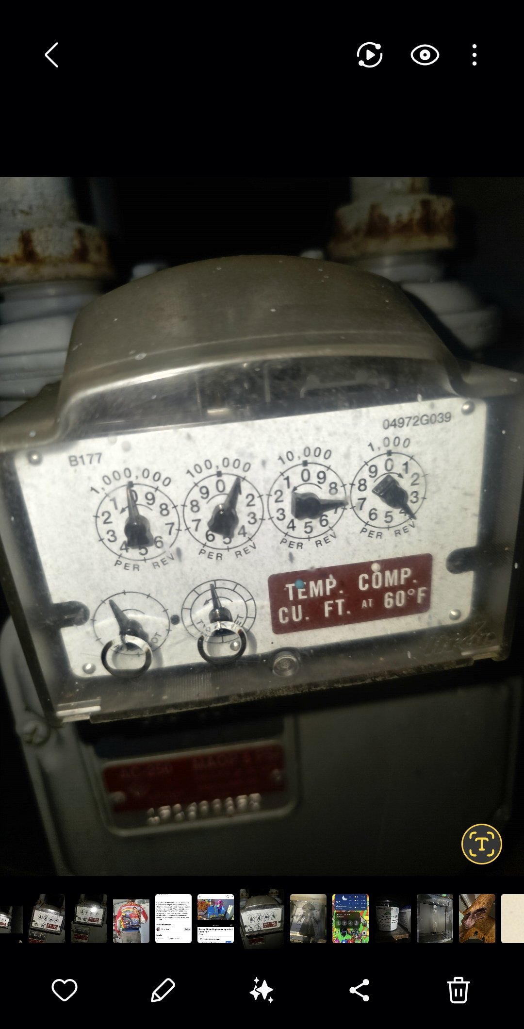

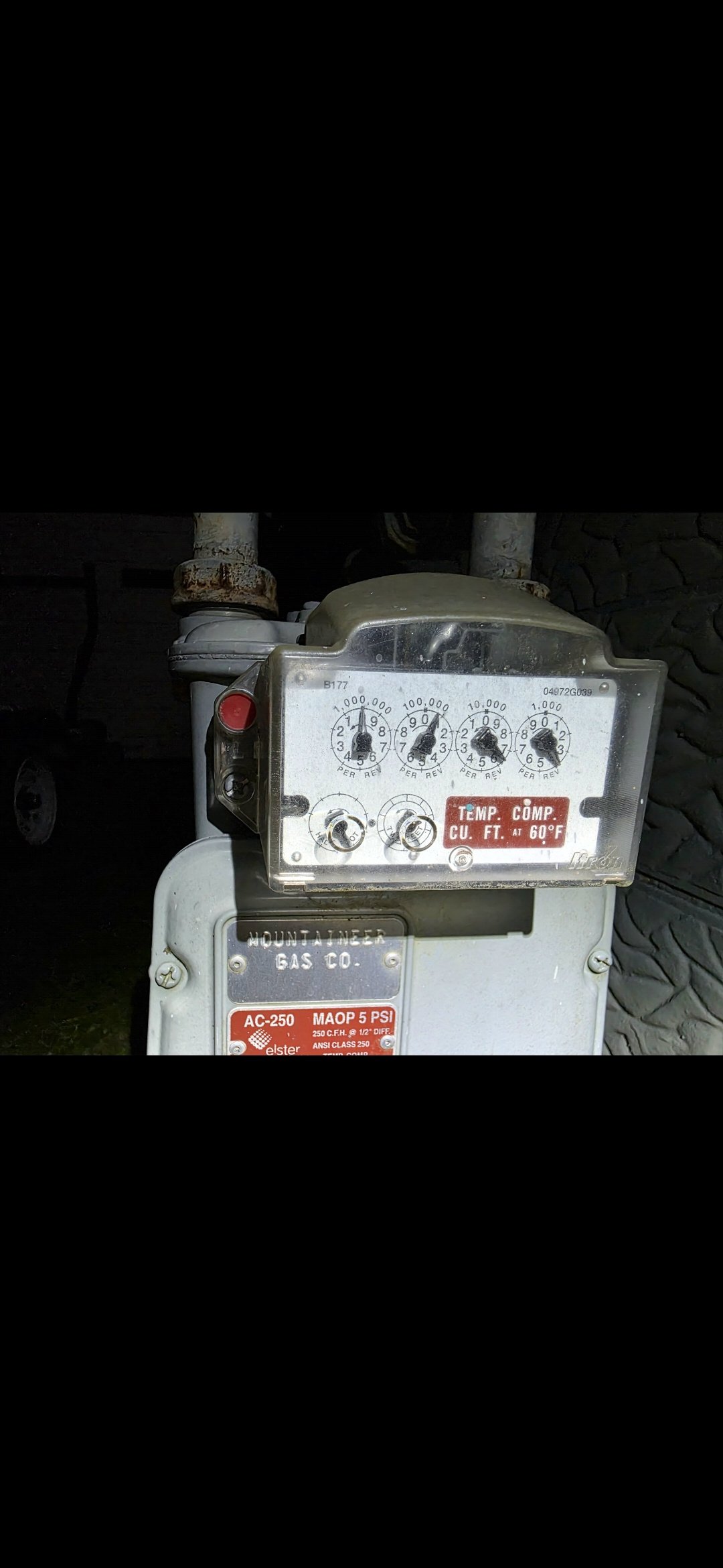

Screenshot_20251222_070905_Gallery.jpg Screenshot_20251222_070901_Gallery.jpg

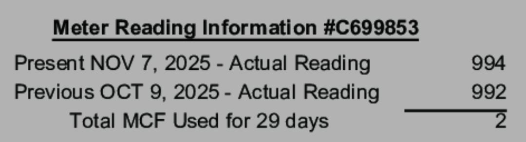

So here my meter from on night if use with my boiler system reinstall. The low last night around 22 degrees. The top photo was taken around 8:30pm and 2nd was was around 620 am. Trying figure out which is more efficient. Hear a photo of my meter before I started with the boiler this was on Saturday. The other photos were on Sunday and Monday.
Hear is the reading nov and oct to see how long they are between readings

    There's not nearly enough information to answer your question.
    The other problem is you're not looking at efficiency, you're looking to see what's cheaper to run. Also, the fireplace is heating one area, and the boiler is heating the entire building.
    Chances are, the fireplace is going to lose regardless.
    What kind of fireplace is it? Where does it get it's combustion air from?

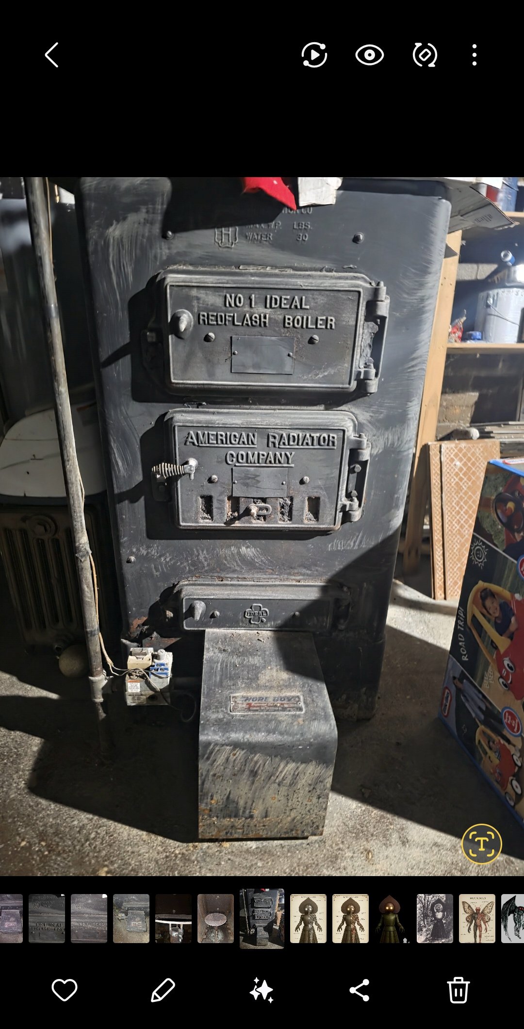

    What kind of boiler do you have?
  • Yeay mostly seeing which is cheaper. They both heat about the same and keep the whole house around the same temp. Im mostly looking to see if that boiler usage is crazy high or just average. The is an inefficient coal model thats is a gravity system thats been converted to natural gas. The biggest different is the gas fire place will change in flame size for temp and cut off some time but for the most part they run constantly. The boiler however takes alot to heat up but then it shuts off.

    The boiler is going to win in the efficiency game and the comfort game in the end. The fire place is a reasonable though inefficient t space heater while the boiler is designed to make the whole house comfortable. If the boiler is truly a gravity system the radiators can be adjusted for each space.

    A fire place is a hole in the wall. It provides heat but pulls in a lot of outside air which is cold and needs to be reheated. The boiler brings in less outside air and is more efficient. However, your boiler and burner are old and the efficiency may be around 60% at best.

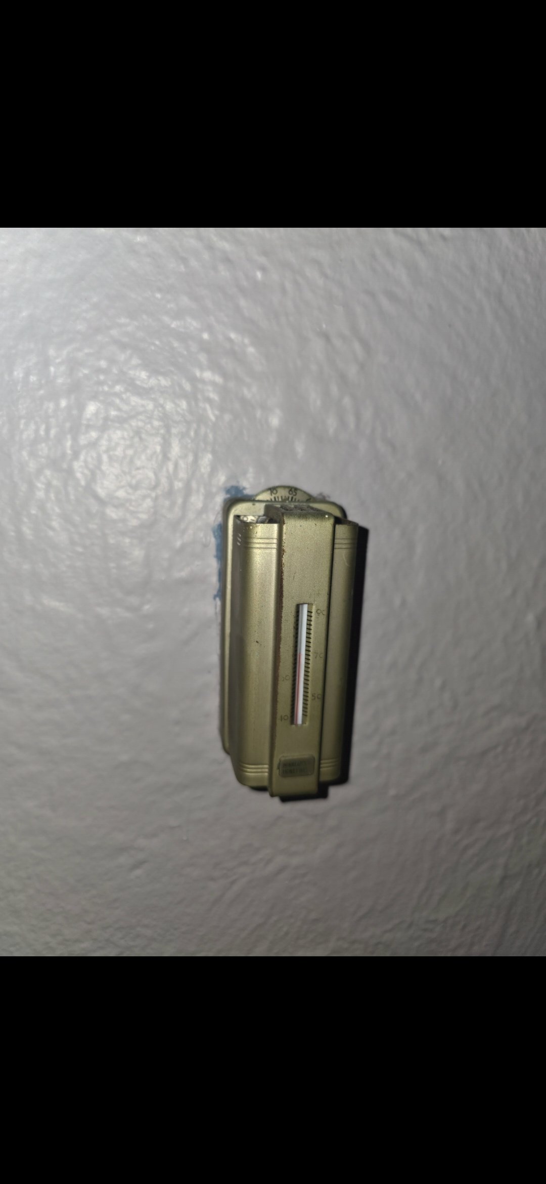

    What thermostat is being used for the boiler? Does it have an anticipator setting? The right thermostat with the right CPH on a gravity system would be much cheaper than the fireplaces.
    "The boiler however takes alot to heat up but then shuts off."
    "The radiator from the boiler are running 120 to 130."
    If the aquastat is set to 130, raise it to 180. Set the correctly anticipated thermostat to your comfort level, and don't touch it until spring.
    This is thermostat I have now. On the pipe that coming out the boiler there is device that set to 200 i think is the other thing you mentioned. Its wire to the same spot as the thermostat.

    You posted a week or so if I recall. Something about the boiler and fire place debate. I think the recommendation was to replace the burner? I don't know much about that burner btu surely there are other far more efficient gas burners that could be retrofit to that boiler. The boiler appears to be functional although with some outdated features. There's always a rock and a hard place. Updating the boiler will in the long run be more efficient and likely more comfortable. But I will cost some, while the space heaters are doing the job now. It's a cost benefit thing I guess. We hate to see a nice old hydronic system gathering dust.
  • Yeah posted trying to see about what all need to upgrade and I might be able change out burner by next winter. The system is heating every evenly thru out the house and didnt have much work to get it back up and running. Ill be honest I dont see me being able to do full swap for some time. If i would swap the boiler what would be a good one that will still work with the radiator

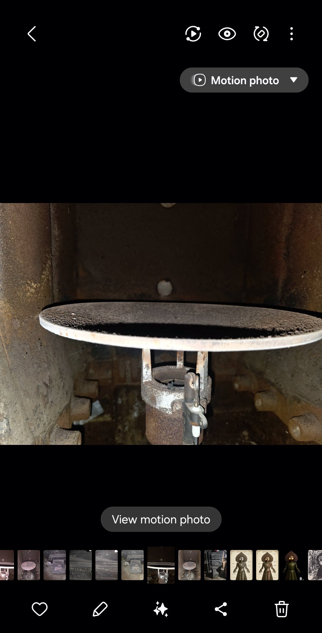

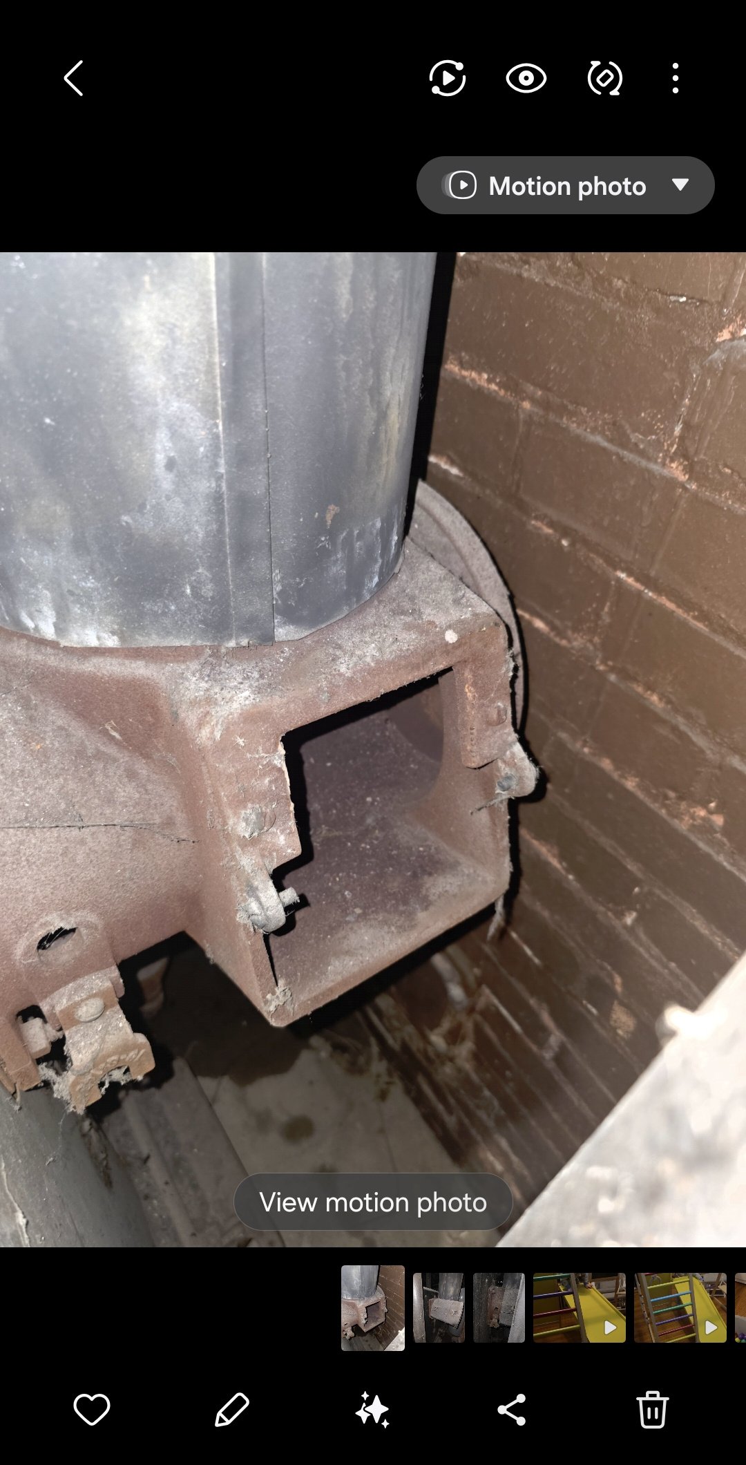

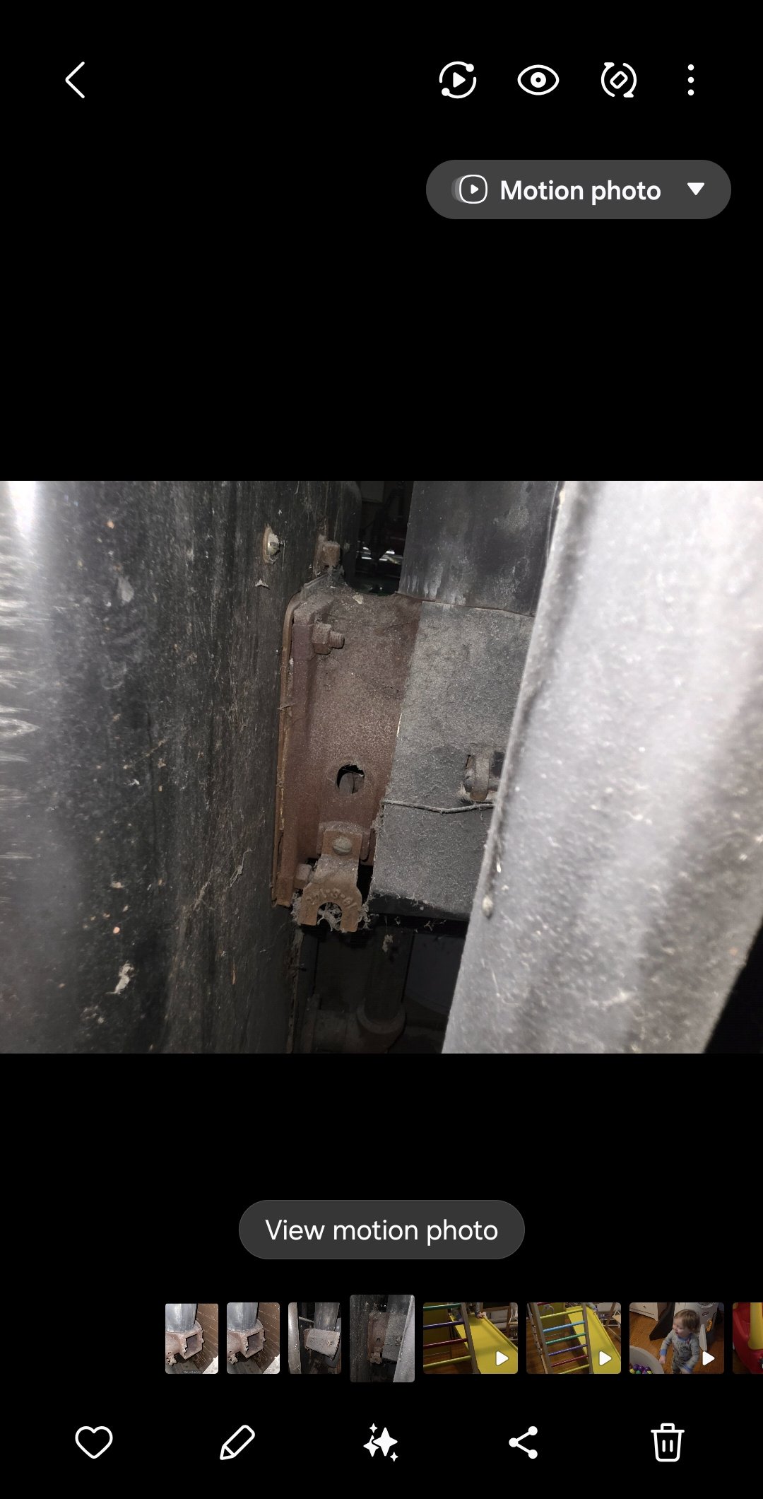

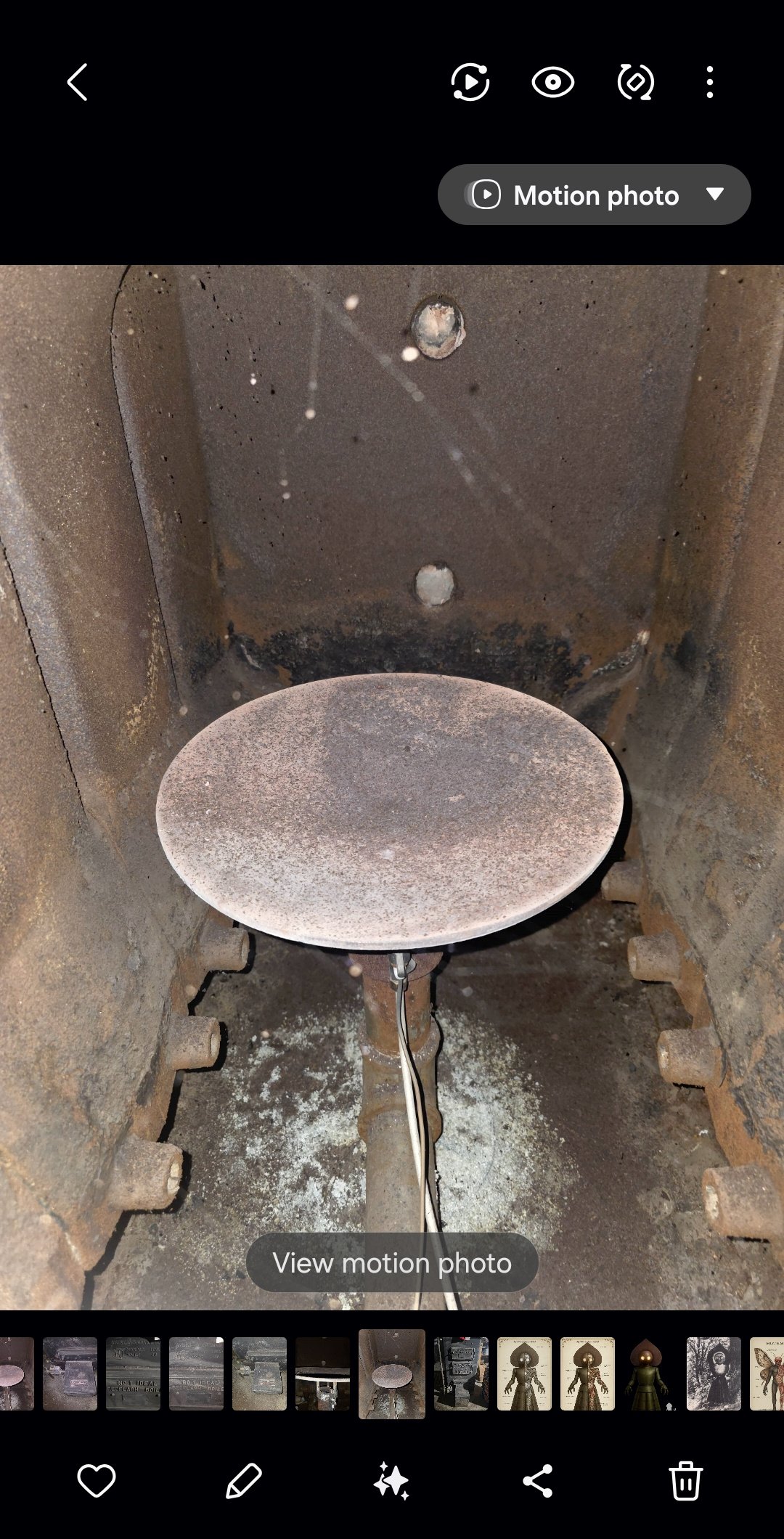

  • Screenshot_20251226_075302_Gallery.jpg Screenshot_20251226_075254_Gallery.jpg
    HHow Could I cover this hole. Found out that this wasn't sealed at all. Also the little hole does it need sealed also. It looks like maybe a place for a damper. Doubt i can find any orginal pieces
  • Grallert
    Grallert Posts: 1,237
    The big opening was a draft regulator and the small hole was likely a damper. These were removed when the boiler was converted from coal to gas. These will be addressed when a modern burner is installed.
  • So with current burner should plug up both of them
  • Grallert
    Maybe. Let the installer determine that after a combustion test.
  • Any ideas in the mean time cause im using this now as my main heat source. Been working fine but the way the previous people had it seals wasn't safe at all. They used a no trespassing sign with wire to block it
  • Grallert
    "They used a no trespassing sign with wire to block it" I think that would be fine for the time being if your chimney is clear. that boiler will be making enough heat that there should be a vacuum at both of those openings. With the boiler running you can check this with a candle. Hold a lit candle to the opening and you'll see the flame get pulled inwards toward the opening. Try with the boiler off for a while, I bet you'll see a draft as well.
    Get a co detector and put it down there.
  • I did a dust check on earlier and saw it was sucking air into it pretty strong. Im definitely gonna pick up co detectors after work. My previous one in the bed room hit its end of life today. That what had me checking all this cause i was scared I had hive levels of co. Found out it was just at the end of its life
  • Grallert
    I would imagine that flue would suck your hat right off, especially while the boiler is running.

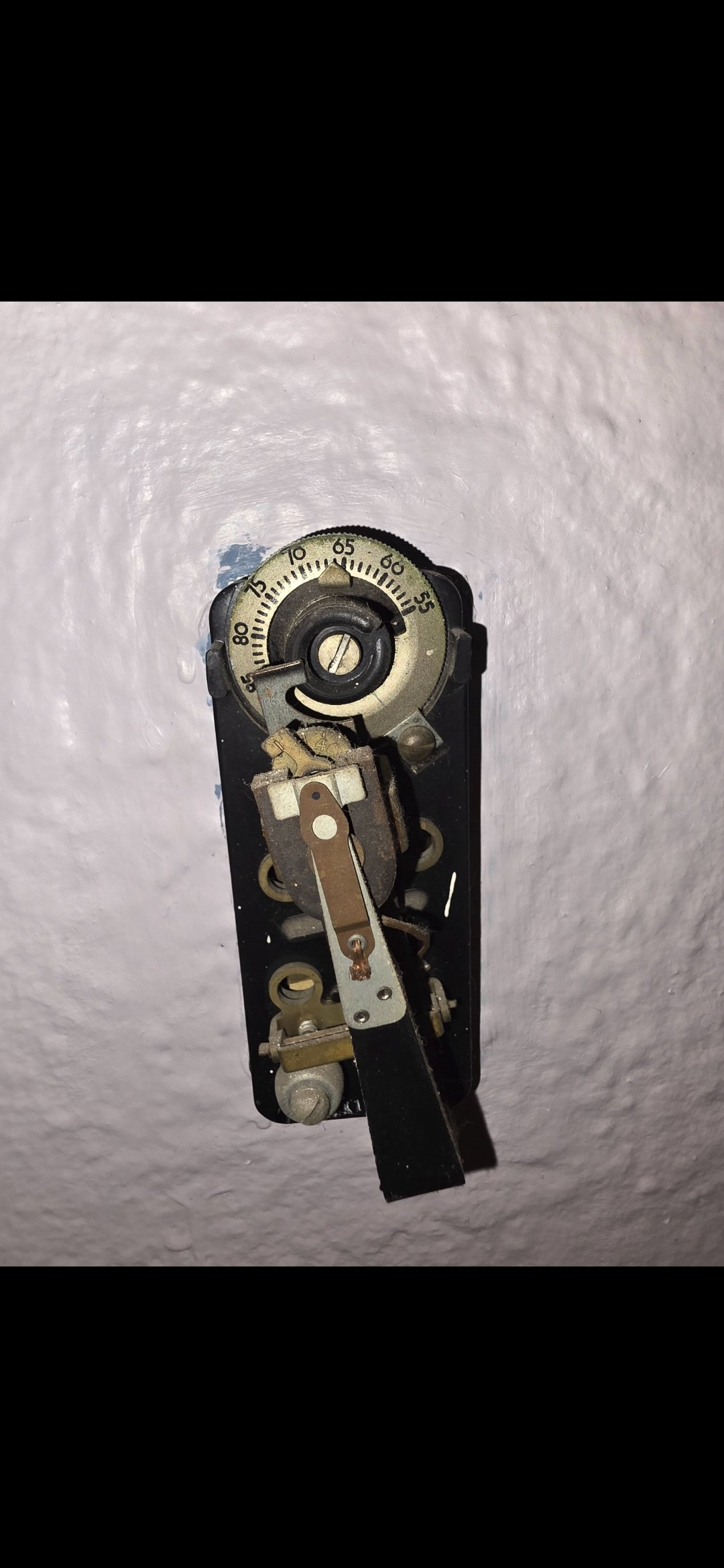

  • Another random question this is my thermostat
    Whats the small dial for.
    HVACNUT Posts: 7,784
    Yes, most reputable thermostat manufacturers supply plastic wall anchors and screws in the box. That's plaster, so pre drill with a masonary bit. You supply the pocket level. Set CPH to 1.

  • Hi, I think the small dial you refer to, just under the main dial, is called the anticipator. It's used to regulate heating cycles and prevent overheating. 😰
    Yours, Larry
    PeteA
  • Benjikittens
    Benjikittens Posts: 42
    edited January 1
    Ive never had one of those how would I set it
  • Grallert
    You very likely don't have to worry about that setting at this point. That anticipator is there to adjust/ prevent over or under shooting the thermostat set point.
