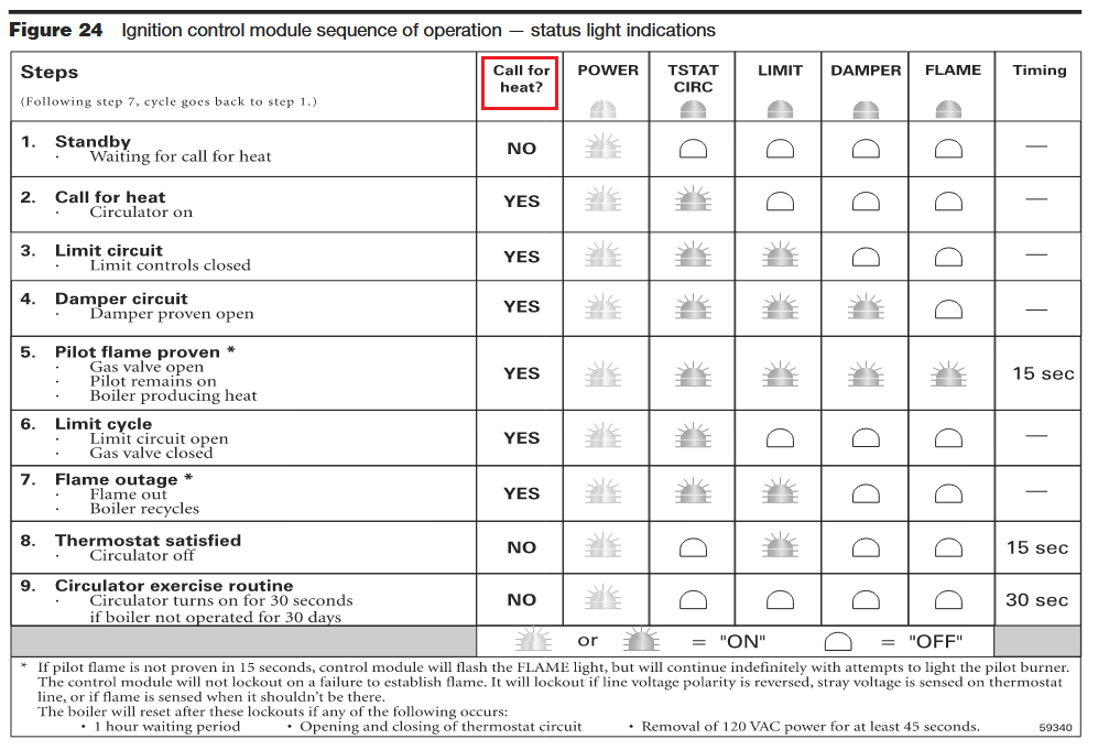

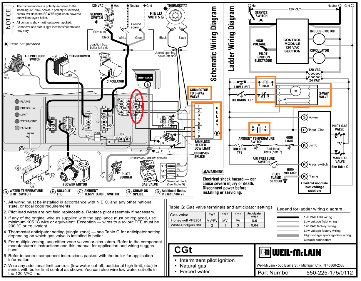

    What LEDs are presently on with the circulator constantly running?
    109A_5 Posts: 4,759
    edited December 2025
    Sounds like the 3-Way valve. Since its End Switch can directly produce a call for heat.

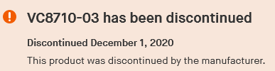

    Seems the Honeywell VC8710-03 has been discontinued and that is just the actuator not the actual valve.
    Seems the replacement actuator is " 3-Way Valve Actuator for CGT Boilers, 635-100-023 "
    https://www.supplyhouse.com/Weil-McLain-635-100-023-3-Way-Valve-Actuator-for-CGT-Boilers
    However if the actual valve is sticking just changing the actuator may never help.

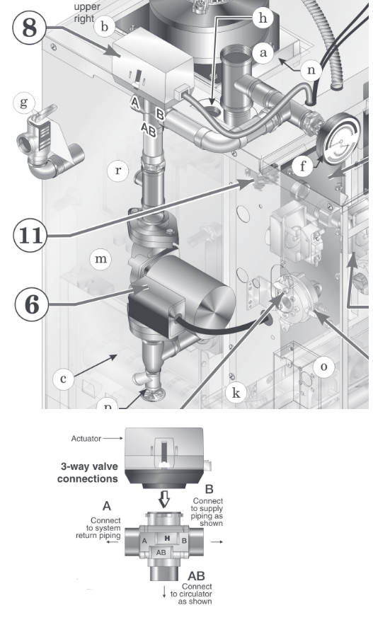

    Not the board, this time. It 8s the 3 way valve itself stuck on open. New one Worked a couple of months, then failed again.
    109A_5 Posts: 4,759
    Was the guts of the 3-way valve ever been changed, or just the actuator ?
    If this was my boiler and the 3-Way valve (assembly) is a chronic failure but the boiler and the DHW all works fine, I'd get rid of the 3-Way valve and use two Zone Valves a Normally Open and a Normally Closed to replace the 3-Way valve, probably way more reliable.

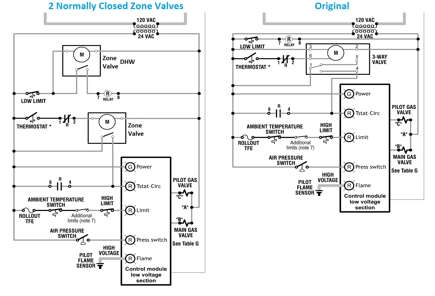

    Well you certainly could use two Normally Closed zone valves, it just complicates the wiring a bit, since you need to prove the zone valve that is used for the 'open' part of the 3-Way valve (DHW) has actually opened before the burner fires. Not really a big deal if you can do control wiring.
    It appears the original 3-Way valve does use its End Switch for the space heating mode.
    Personally I think the CGt is a failed design as far as the 3-Way valve is concerned. They have updated the 3-Way valve assembly and it appears folks are still having issues. You could try another brand of 3-Way valve, not sure about compatibility. You could also go the route of separate DHW production, but to me with a bit of ingenuity the CGt could be made more reliable and still be used as a Combi.
    109A_5 Posts: 4,759
    edited February 6
    With two Normally Closed zone valves.
    If the building actually has other zone valves the Normally Closed zone valve for space heat at the boiler is kind of redundant.

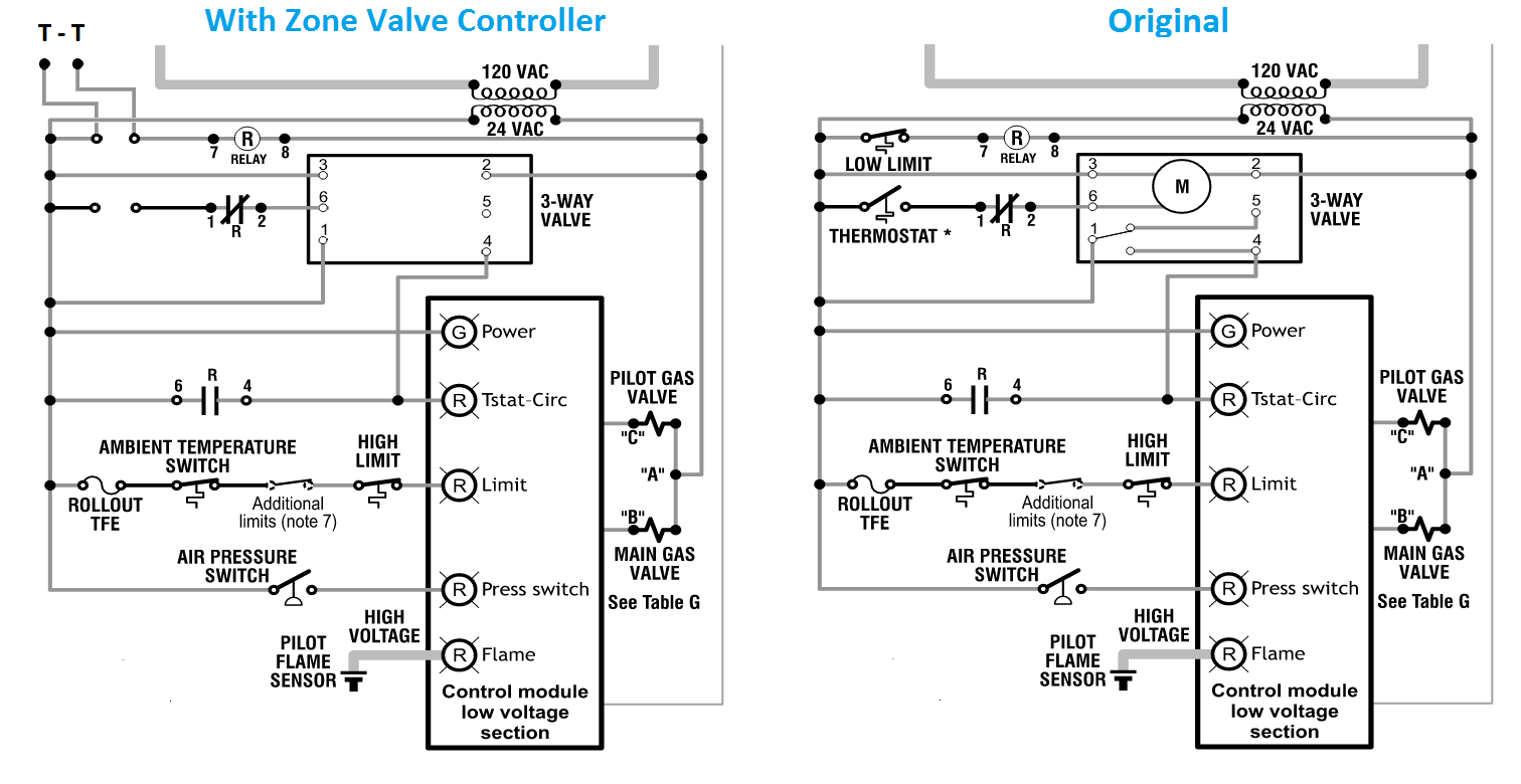

    Instead of modifying the boiler's control wiring it may be simpler to just use a zone valve controller.
  • epmiller
    epmiller Posts: 61
    @hot_rod Not to hijack the thread but with my limited exposure to N/O zone valves, why do you say they don't last as long? I just had to make up a '3-way' assembly for a system using Taco Zone Sentry valves (one already existing) and I can't see why the added N/O valve will not last as long. My only complaint is that the end switch doesn't have NO contacts.
    109A_5 Posts: 4,759
    edited February 7
    Building off of " Instead of modifying the boiler's control wiring it may be simpler to just use a zone valve controller ".
    Remove the 3-Way valve.
    Add two Normally Closed zone valves. Or just one for DHW boiler circulation if other space heat zone valve(s) exist.
    Add a zone controller, if needed, if one does not already exist.
    Disconnect the wires from the boiler's Low Limit switch, the wires become the Boiler's T-T to the zone valve controller's X-X (Isolated End Switch).
    The boiler's Low Limit switch is wired to the zone valve controller's DHW priority input. DHW priority is set to active.
    The space heat thermostat(s) and space heat zone valve(s) are connected to the other zone controller zones.
    The system behaves like an Indirect tank is being used with zone valves, however there is no Indirect tank. Just boiler only circulation for DHW priority and the original thermostat(s) control the space heat zone valve(s).
    It should have the same reliability as any other zone valve system with Normally Closed zone valves.

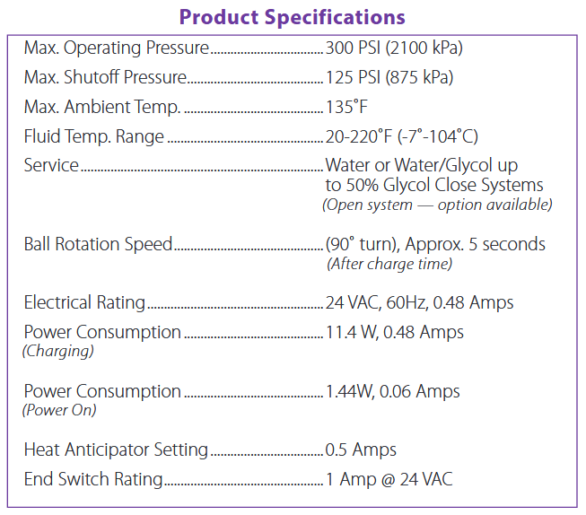

    That Taco is a capacitor discharge valve I believe ? Does it have any power consumption in either open or closed position? Or just when it travels?

    Yes, Taco Zone Sentry valves only consume power when they are moving. So I'm not going to concern myself about a reduced lifespan for my situation. I can easily see why a standard spring return valve that is constantly powered to hold it open would not last as long. I'd hate to install a spring return valve in a constant ON state given all the power it would consume just holding it in the "normal" state.

    I think you would find with Normally Open valve, the valve is actually Open even when it is in its box from the supply house, electrically connected to nothing. The spring return actually opens the valve. When it is powered it closes the valve.
    Normally Open is the quiescent state or when inactive.
    Taco Zone Sentry are a different technology than a conventional zone valve. Still they still consume power to keep them in the non-quiescent state.

    epmiller Posts: 61
    @109A_5 thanks for that spec sheet on the Zone Sentry valve. Somehow I didn't find all those details about power consumption when operating. I still have no worries about how I used the valve in the installation, it only gets called once or twice a day during the heating season for about 15 minutes. Pretty low power drain.
