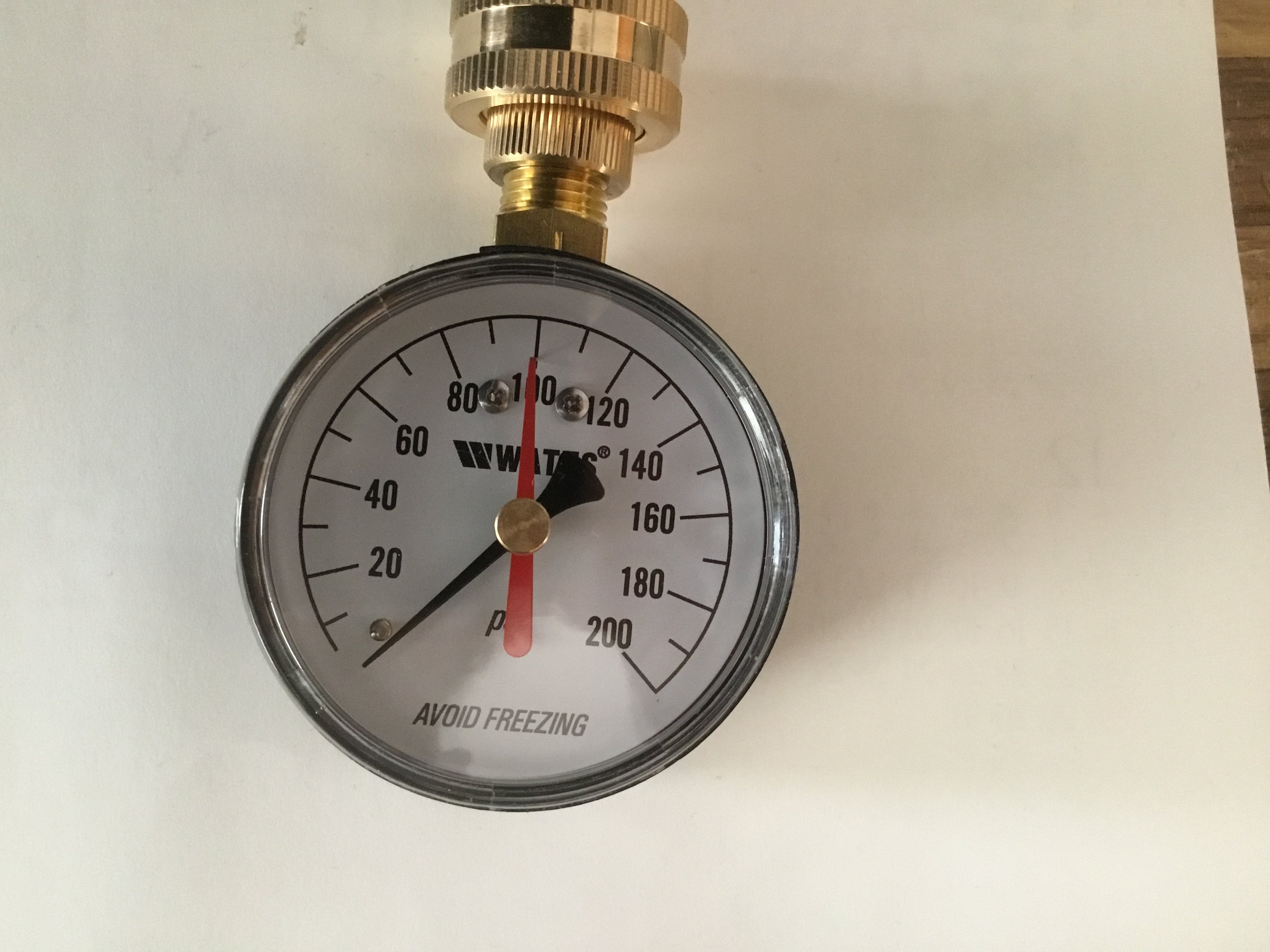

I had a domestic hot water heater problem, and was advised it was a good idea to get a lazy pressure gauge so I could check maximum pressure coming into our building from my city water. It is a $15 part, so instead of ordering from a site with $100 minimum order and fairly slow shipping, I held my nose and looked on Amazon, where I was pleased to see a Watts gauge which I ordered and arrived quickly.
But when I looked at the gauge it sure looks defective to me: the black pointer is on the wrong side of the brass zero pin. So any pressure will be stuck registering zero. Hopefully that is obvious from my picture.
So did I really get a defective gauge from Watts? I don’t want to hook it up if it won’t serve any purpose.
  • Yup. Put a claim into Amazon with that picture and get a new one. If Amazon doesn't want that one back, you could try to fix it yourself. Take off the screws in the back loosen it up an pop the needle over to the other side. Doesn't mean it will work correctly but it might.
    I use that gauge, it works well.

    Yes , the needle is on the wrong side of the stop . Unscrew the plastic face and move the needle over …. I have a few of that dead needle gauge , they don't last in my truck .

    you can pop off the cover and carefully lift the needle back to the right side.
    hot_rod Posts: 28,708
    The plastic top should pop off with a pocket knife, but I would put in for a return.

    Thanks, if it was out of my toolbox I would mess with it, but don’t think I should have to fix a brand new tool before it’s been used once. As mike said, maybe worth it if they don’t want this one back.

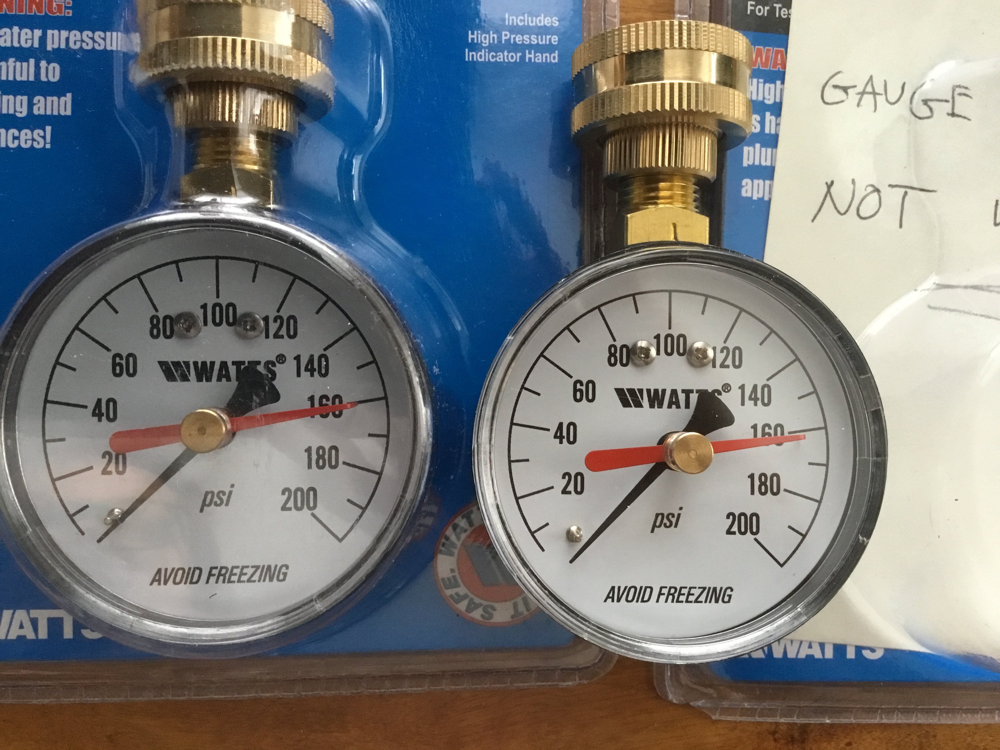

    Well they want it back, which is fine, so I ordered a replacement rather than a refund. Planned to return the first one when replacement arrived. Note this is coming from the “Watts store” on Amazon, not some unnamed seller. The replacement arrived, and look what they sent. First shipment on right, replacement on left. Exactly the same problem. Am I crazy and this is the way it should be manufactured? Or has the quality control at Watts gone completely out the window and they are no longer able to ship working products?

    I bought that same exact gauge from Amazon a few years ago, back when the assemblers knew which side of the pin to put the pointer on. 😂

    Apparently your post office likes to throw the packages against the wall before they deliver them!
    A similar thing happened to several of us who ordered Gorton #1 vents
    that may be from shipping that the needle jumped the pin. Or it froze and the Bourdon tube expanded and pushed the needle
    Regardless, I would not trust it even if you jumped the needle over the pin.

    I gave up on Amazon as they don't scrutinize their vendors. I've returned stuff and the replacement was a used return by someone else.
    Ask for your money back (a credit) and go buy one at one of the box stores or return it to Amazon and choose another gauge manufacturer.
